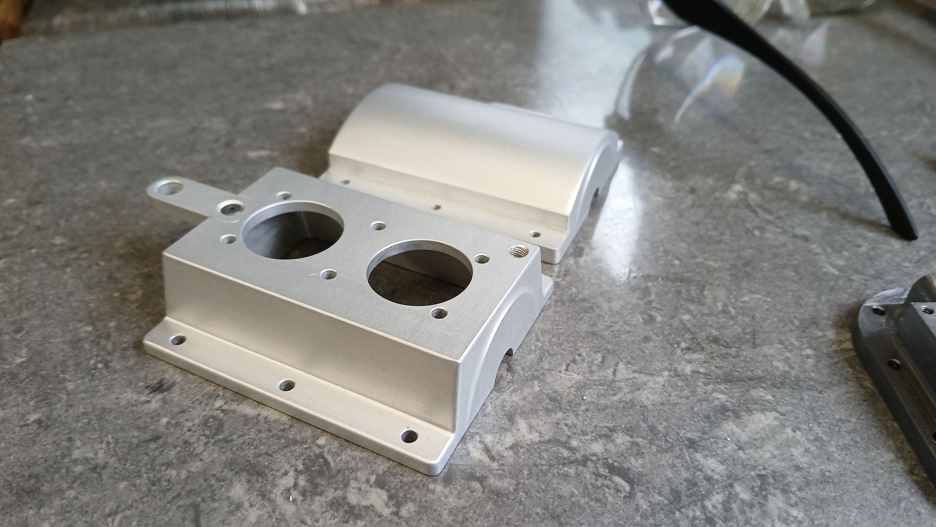

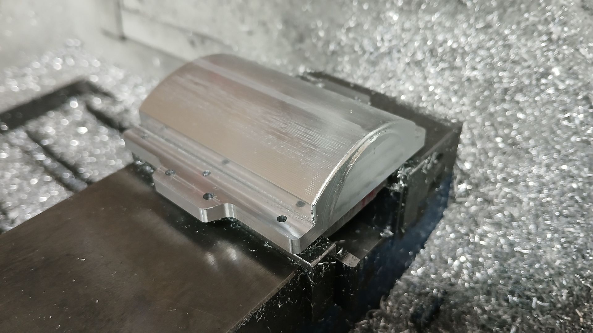

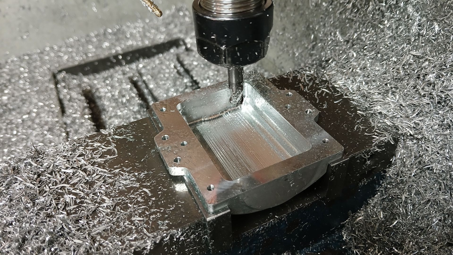

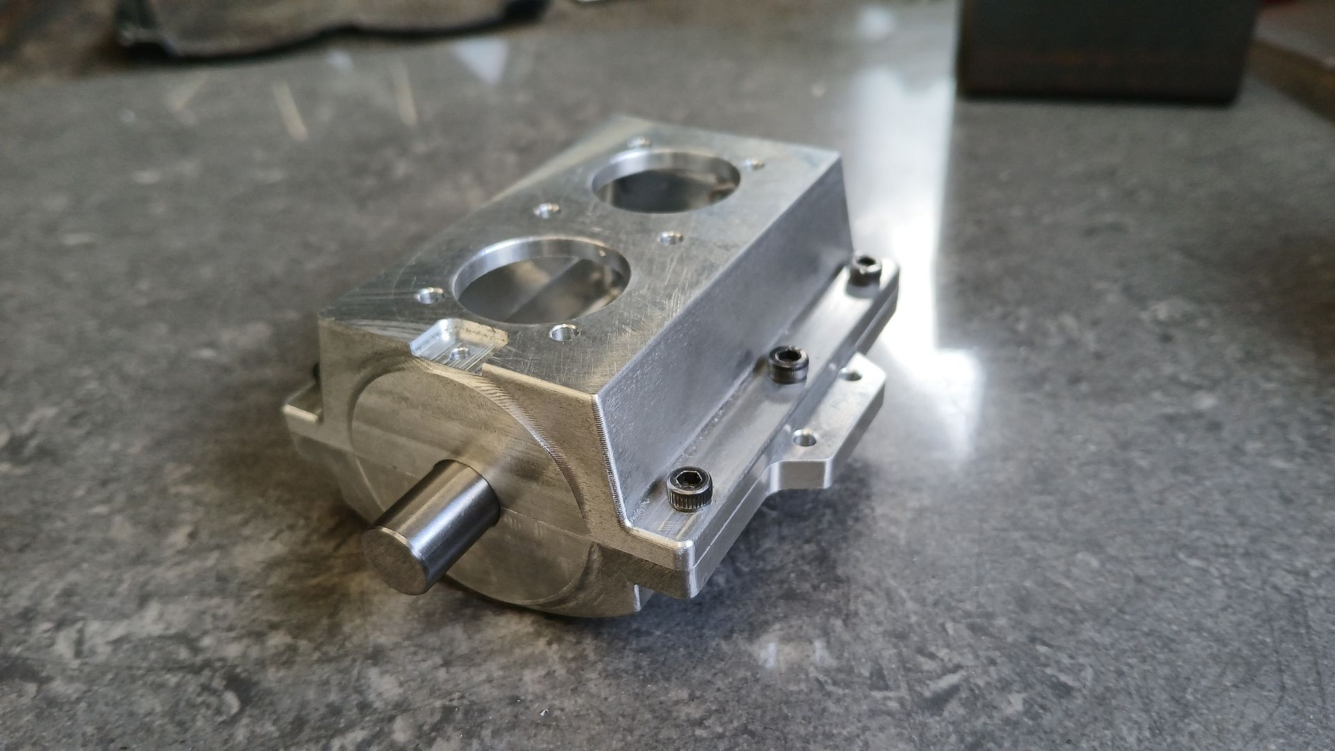

The Lower half of the crankcase was machined in much the same way as the top. Starting out with an Adaptive roughing pass and then a parallel finish path as the Curve was fairly shallow which meant the horizontal stepovers were fairly constant along the circumference of the arc
Then turned the other way up to hollow it out. I nearly came a cropper as I selected the finishing path for the top half but heard the cutter taking heavier cuts than it should and stopped well before it cut right through.

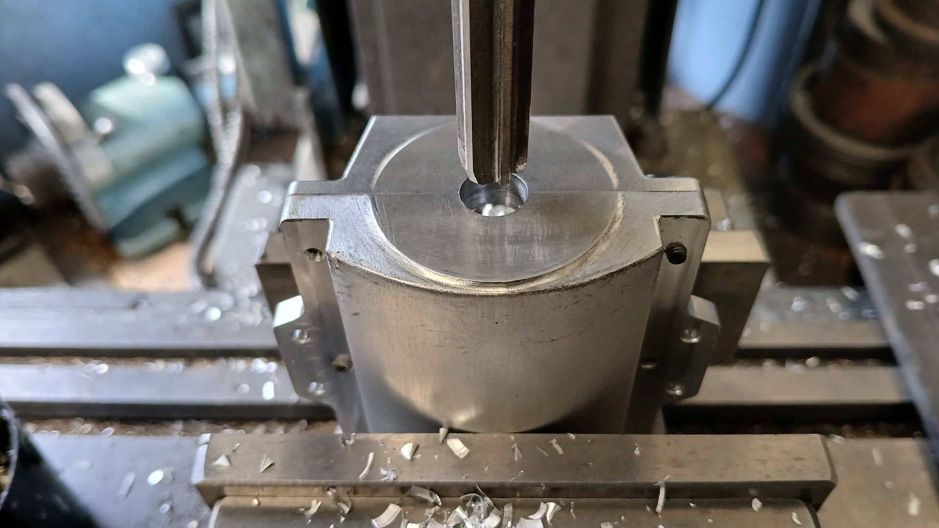

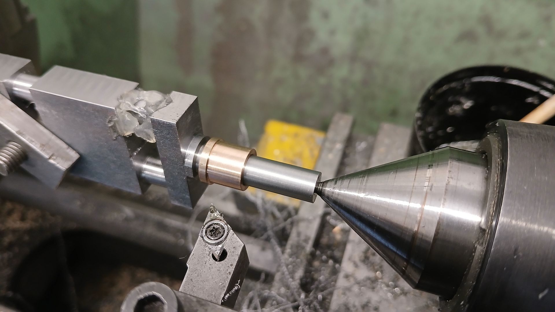

After power tapping the various holes using the tapping feature of the manual mill the two halves were screwed together, drilled and then reamed 10mm. The original has the crank running in the iron castings but I made up some bronze bearings as I did not want to run the crank in this grade of aluminium (6062)
As I drilled and reamed from each end it was reasuring to have a 10mm ground HSS rod rotate freely within the two holes. You can also see a shallow recess in the top surface, this is to locate the lower camshaft support and there is a similar one in the top of the cylinders.

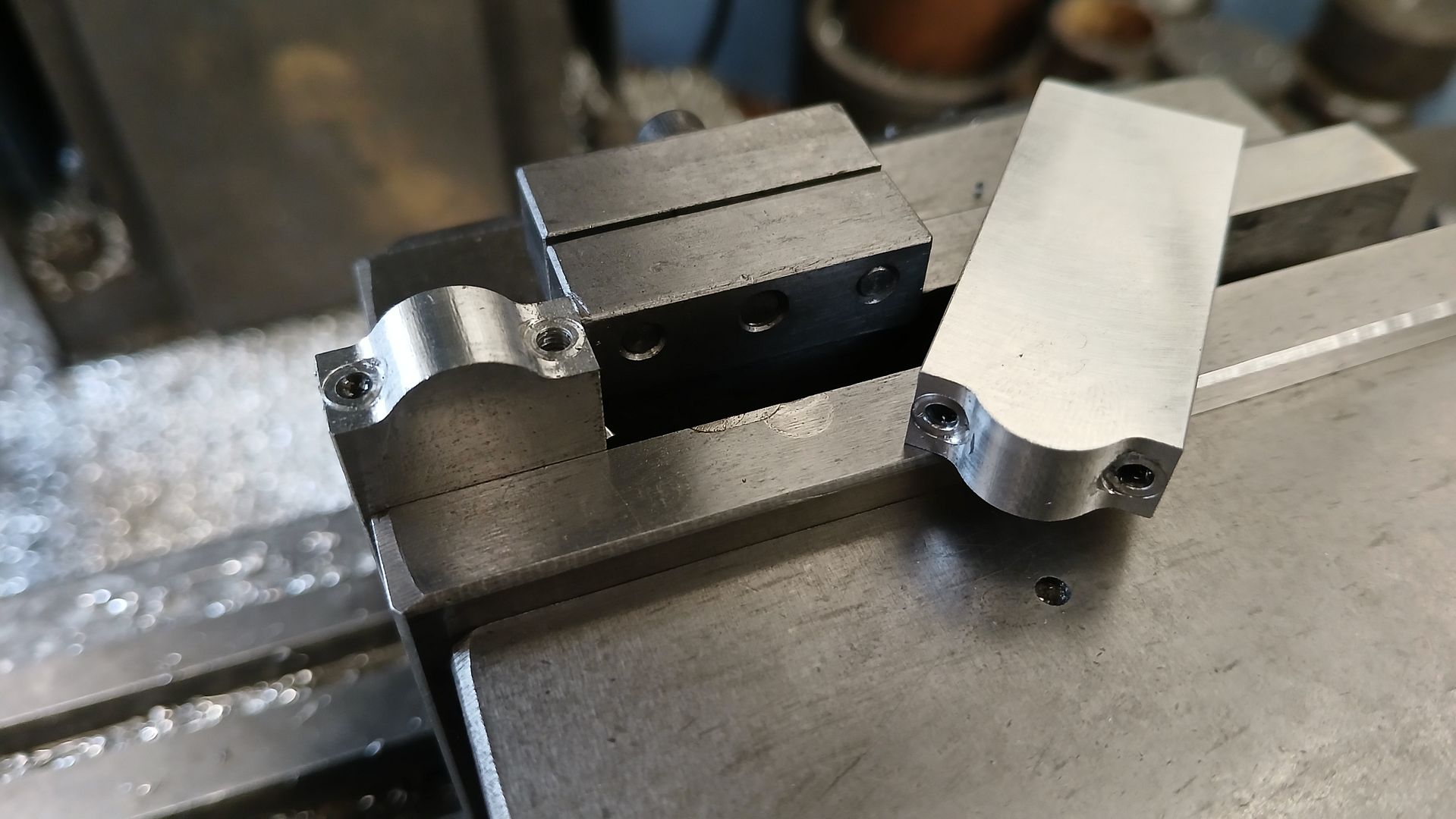

The two camshaft brackets were milled to size and screwed to their respective parts, the shaft position established and the lower one reamed 6mm for a bronze bush. I then fitted the cylinders and with the mill spindle still in the same location ream the top cast iron bracket 4mm as the shaft will run directly in the iron, there is a bit to come off the top.

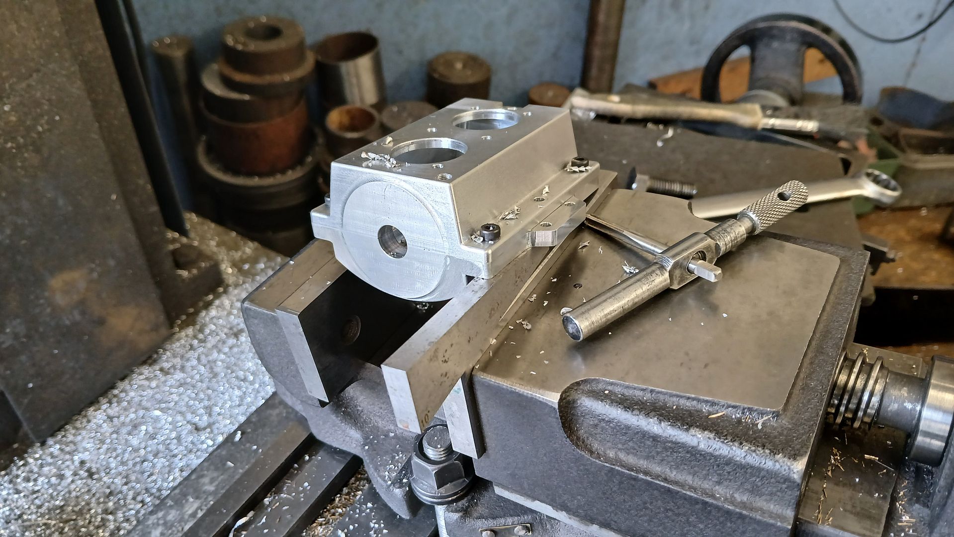

The last bit of machining was to drill and tap M4 fine for the drain plug and filler spout, as this is angled at 10degrees in two directions, I set it at 10deg in the vice and then tilted the vice at 10deg. Started the hole with a 4mm milling cutter then drilled 3.5mm before tapping.
After a bit of hand work to remove any fine machining marks the two halves were bead blasted to give a nice even satin finish.

Hang on, there's only one 'wedge' providing the 10 deg angle on top of the vice, is there a shorter one hidden from view or was that enough support? I don't understand where most of these parts fit in the scheme of things but it's fascinating to see how you make them!
  • Posts: 11306
Re: Stuart? MTB 1M
« Reply #19 on: June 10, 2025, 06:55:31 am »
The grip of the vice was really enough, I just left the loose wedge in place just in case and took it gently.

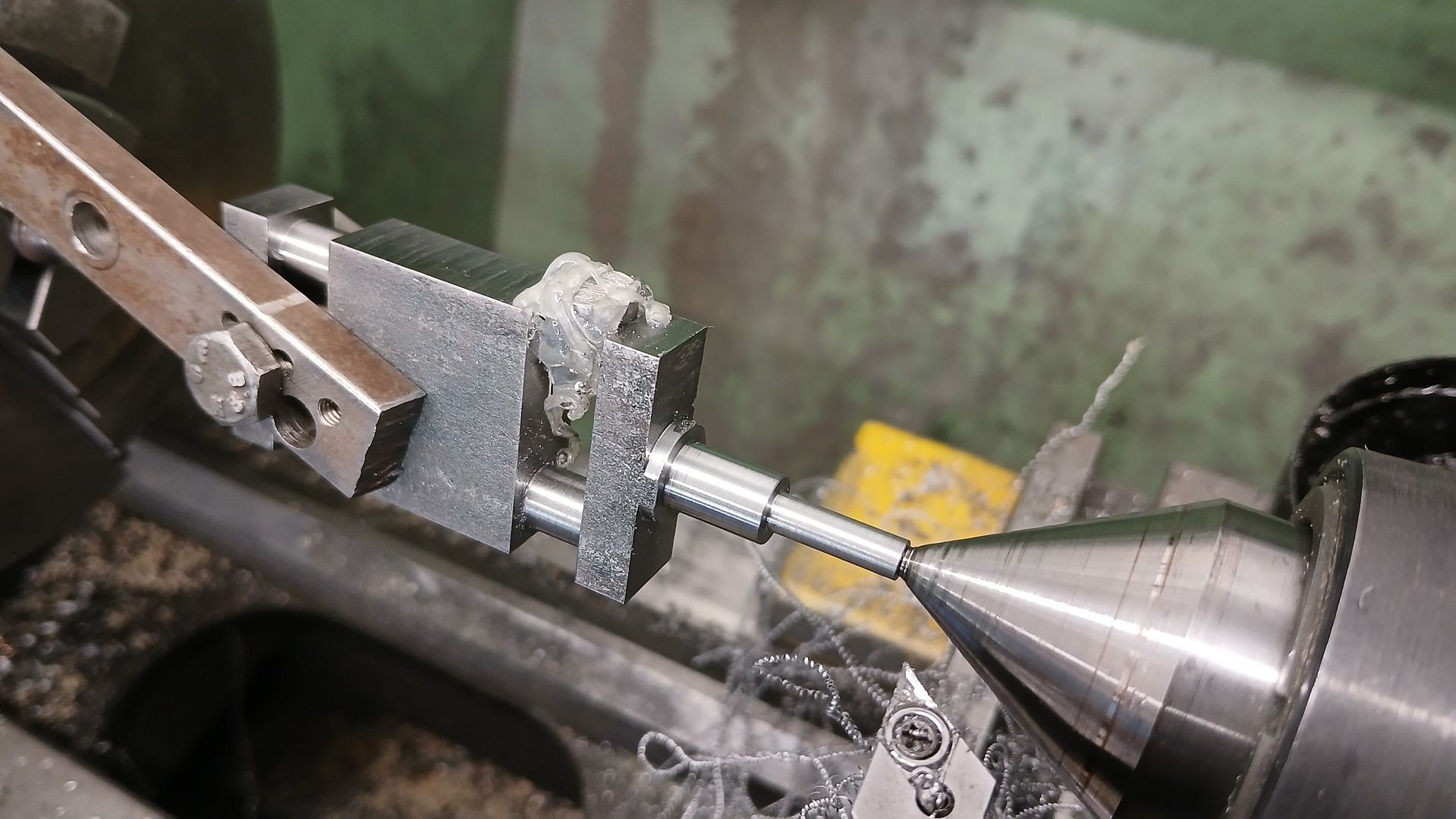

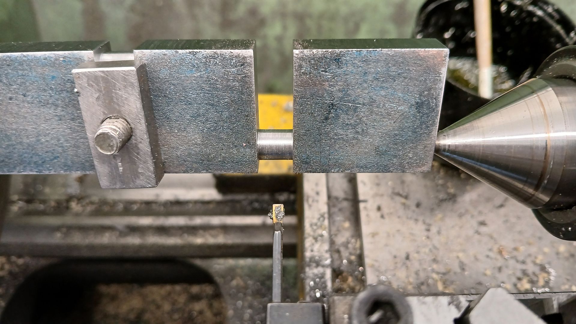

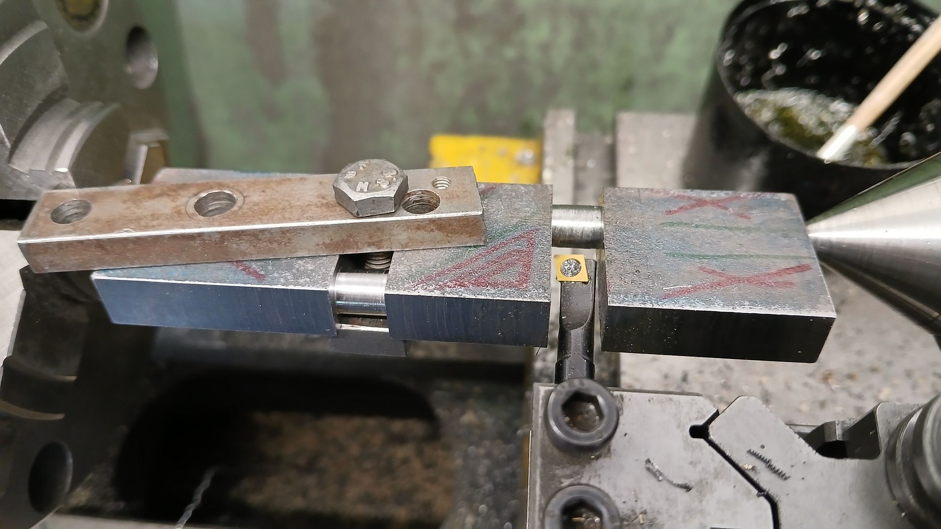

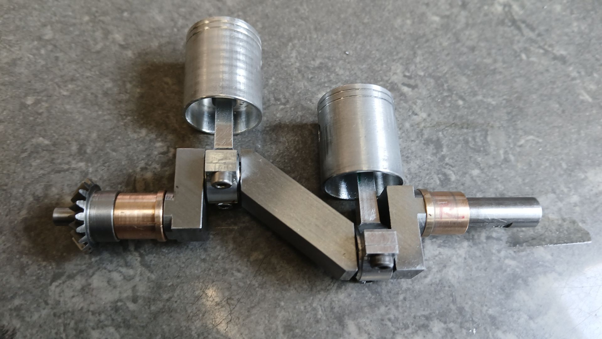

With the crankcase complete it was time to start filling it. The crankshaft started life as a piece of 10x30 hot rolled steel which after a pickle to remove the mill scale was reduced to 10x28 and the ends milled square so that three ctr drill holes could be added to each end. Doing each pin in turn I milled out most of the waste then used a parting tool to turn the pin to 0.1mm oversize. I then used a small boring bar with a CCMT 04 insert to machine the sides of the webs, first as shown then mounted upside down and with the lathe running in reverse to do the opposite side
The pin was then taken down to final size of 7mm dia with a parting tool moving side to side while gently feeding in, quick polish with emery cloth on a stick to complete.
Now that the outer two ctr drill holes were no longer needed the waste was sawn away so that the end of the shaft could be taken down to the required 7mm which was checked using the previously made bronze bearing.
Similar for the other end which also needed to be reduced to 4mm to suit the bevel gear.

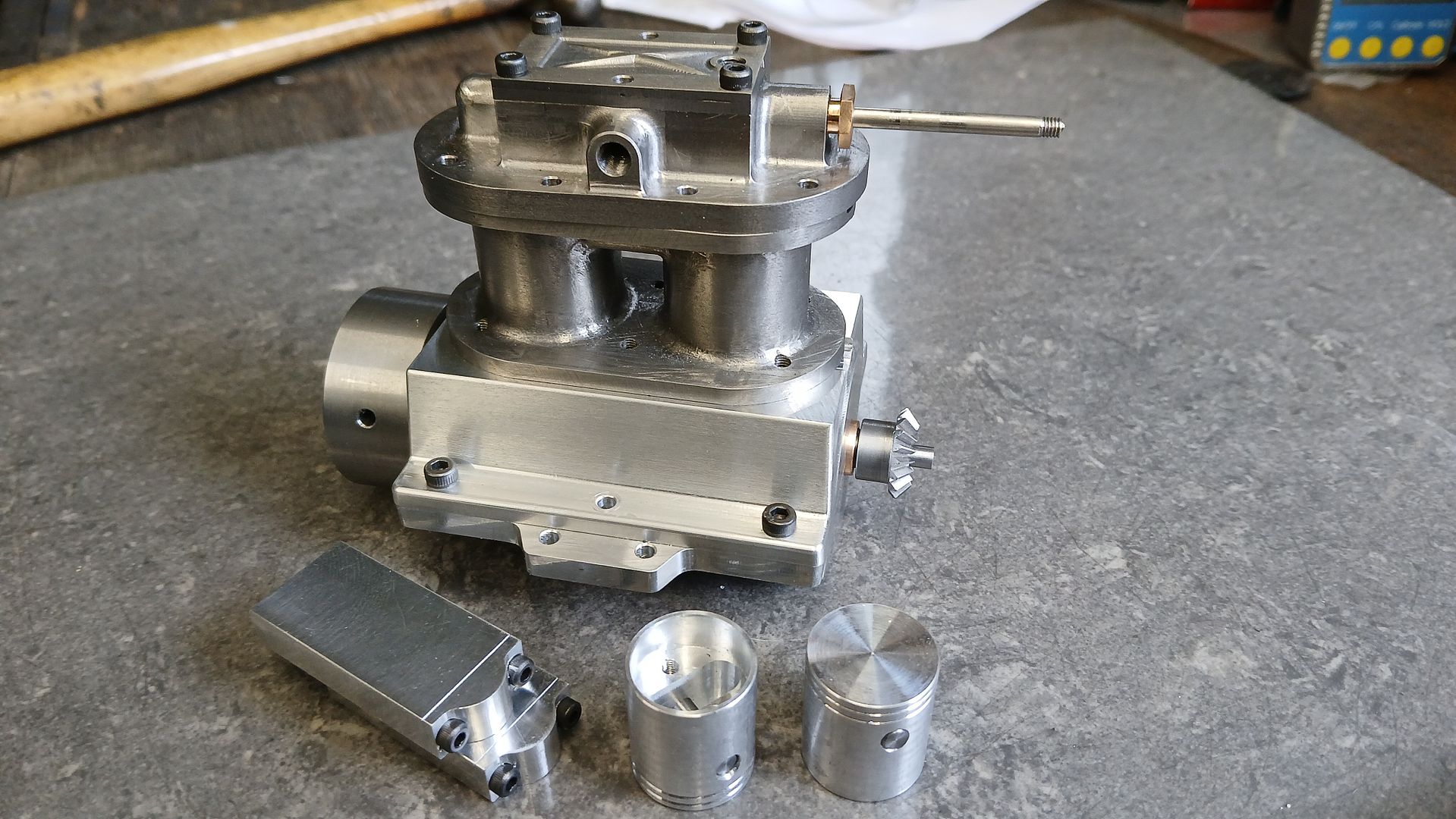

Pistons were fairly straightforward turning and then milling the pocket for teh conrod, then drilling and reaming at right angles for the wrist pin.

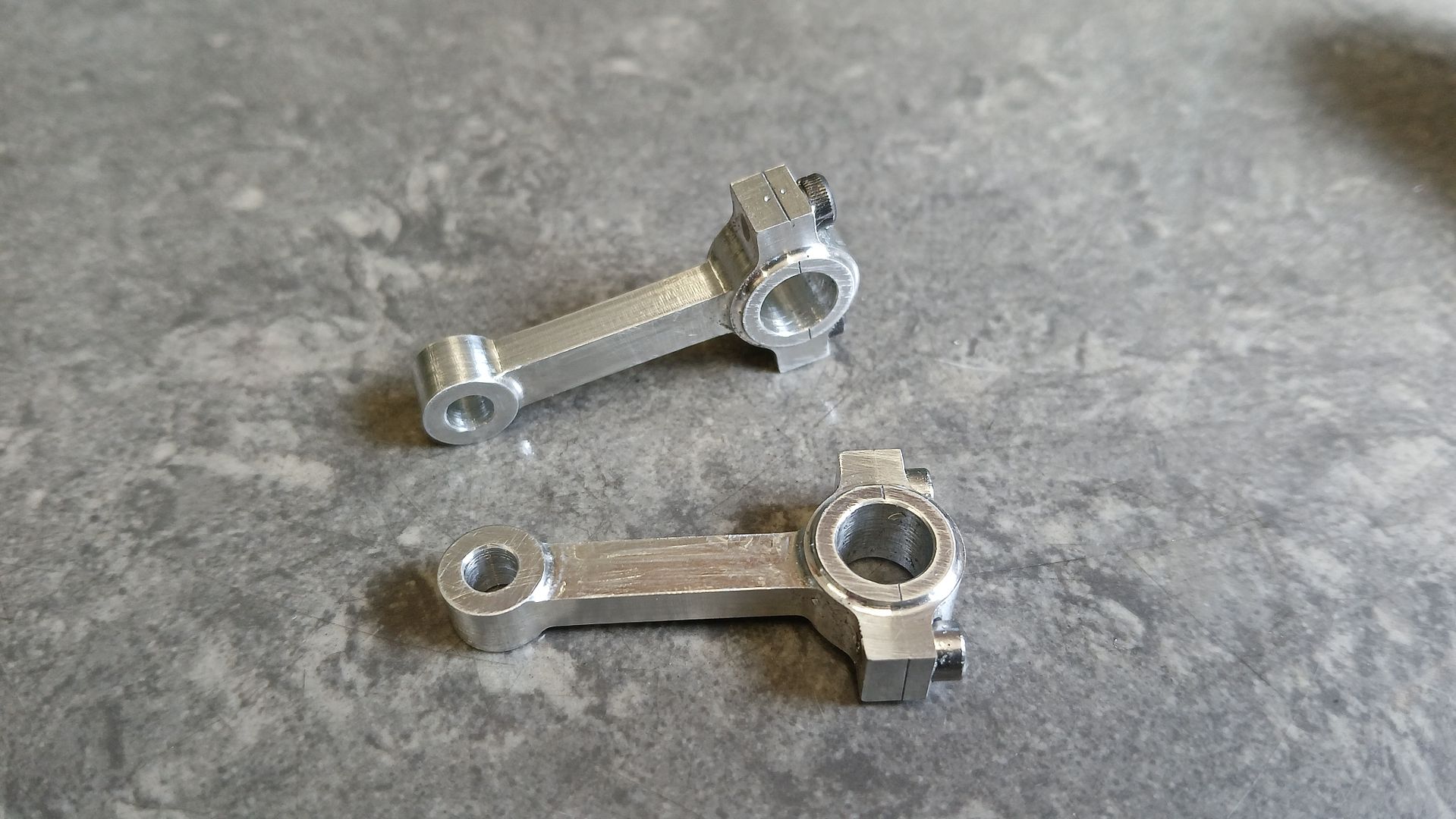

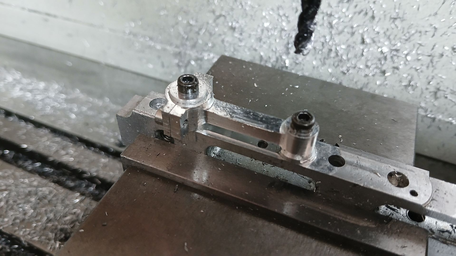

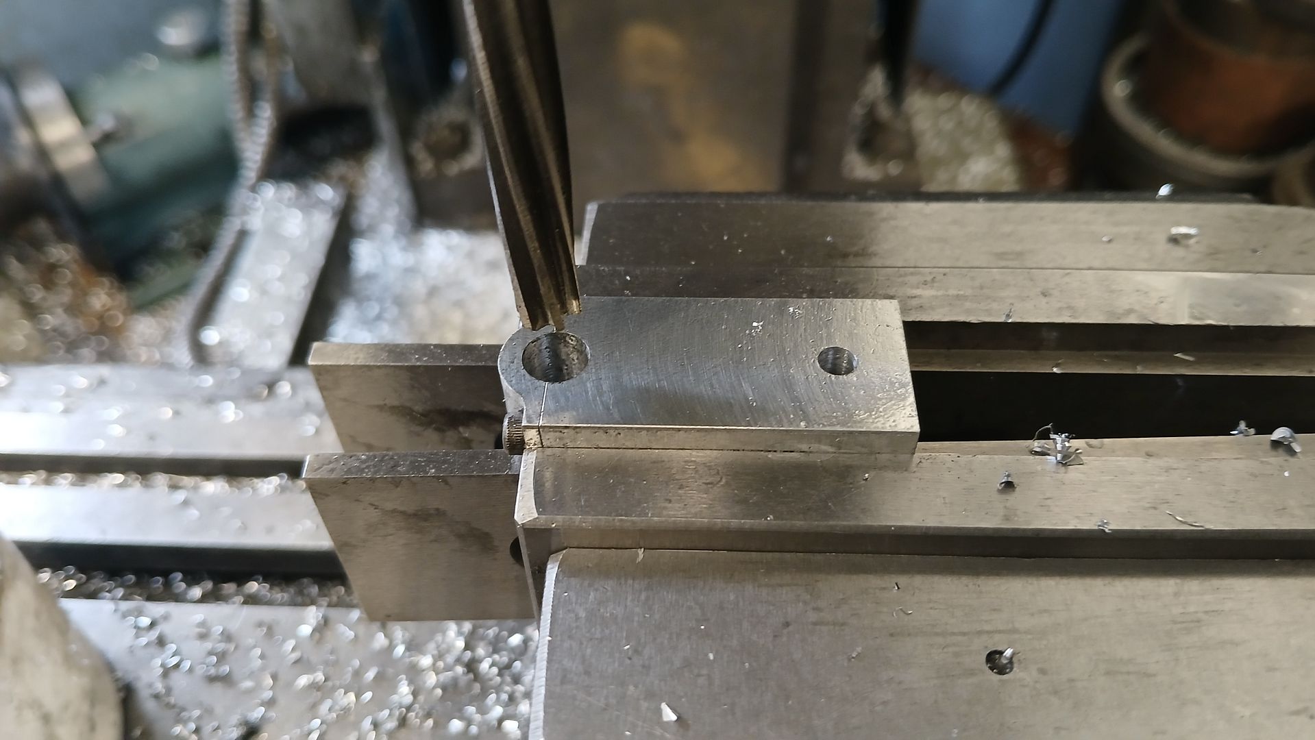

Some 20mm dia 2014 aluminium was milled to a rectangular section to make the conrods from. First job was the shape one end and then drill and tap for the big end bolts
Then the caps were sawn off. Not sure what I did but the cut was a bit nearer the end than I intended. Wrist pins can also bee seen here and the tapped holes for 3mm grub screws to keep them from moving sideways and marking the bore.
Holes were then drilled and reamed
Before final shaping on the CNC

The crankshaft shape with its diagonal central web is quite common across the Stuart enclosed engines and also the compressor. And it was your couple of threads that got me thinking of making this engine. You can also take the blame for the next one too.

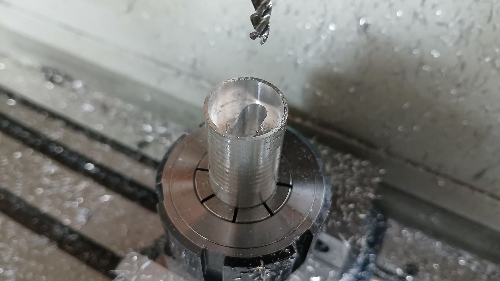

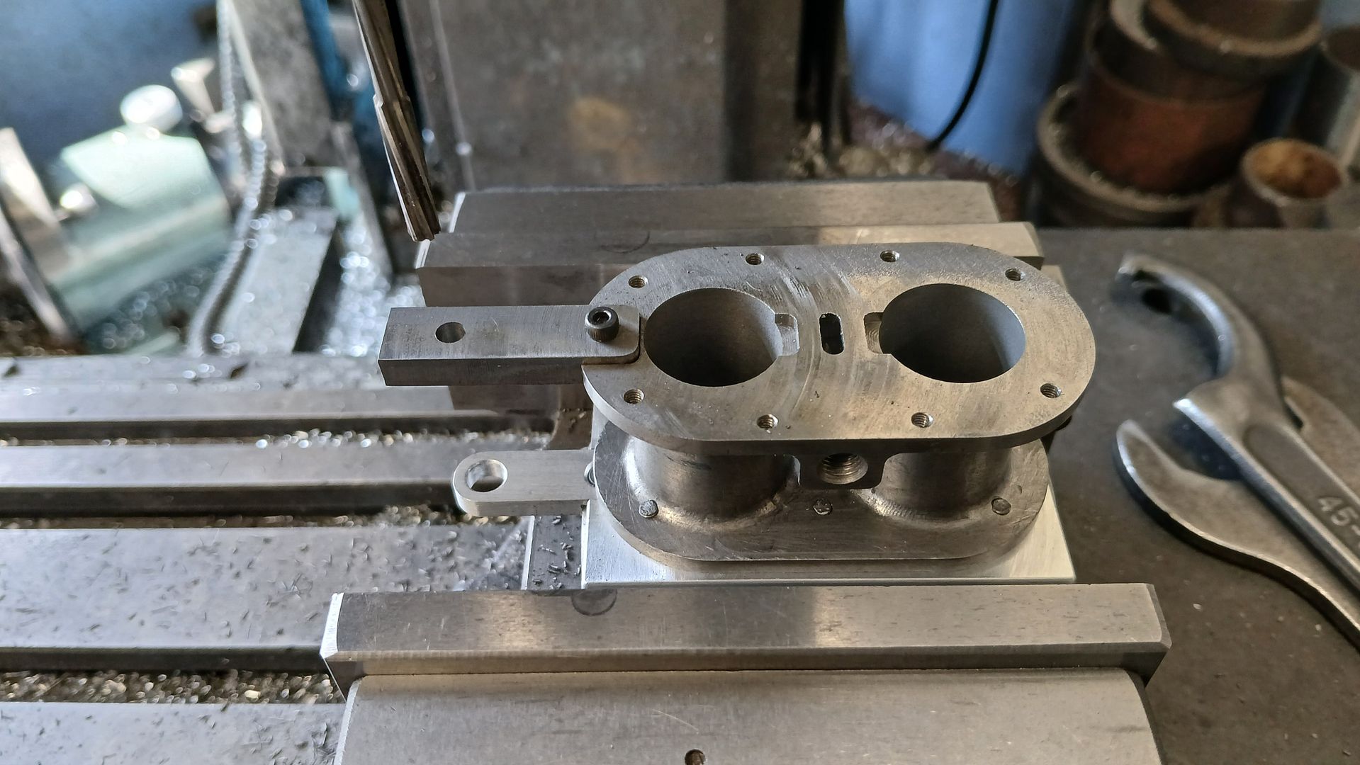

I did not take any photos of the valve, its nut or rod as they are nothing special and just like you find on any slide valve steam engine. The Scotch yoke that drives the valve rod was machined onto the end of some round bar, sawn off and then milled down to the final 5mm thickness before drilling and tapping for the valve rod.
As the eccentric drive pin has quite a short throw and would clash with the vertical shaft I chose to turn the pin and disc as one piece and then Loctite the 4mm silver steel shaft into a shallow hole rather than inserting one then trying to drill and ream an overlapping hole.
The photos of original engines seem to all show them assembled with screws so I machined up a batch of Filister nead ones in M3 and M2.5 which completed all the machining save for a couple of plugs for the drain and valve chest oil hole and a capped tube to fill the crankcase with oil. The Aluminium crankcase halves were bead blasted and the "cast" surfaces of the iron parts given a coat of paint.
I only assembled the engine with a couple of drops of oil on the moving parts rather than filling the sump with oil so did not have the splash lubrication for test running. Also with no form of lubricator on the inlet I did not want to push my luck too far. But with a larger diameter inlet tube and 45psi on the regulator I was happy to stop the test at 3000rpm and expect the engine could go faster as I did not have the flow regulator fully open. Sorry the Tacho video did not come out but you should get an idea by the noise at the end of the video.
