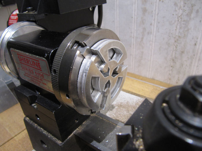

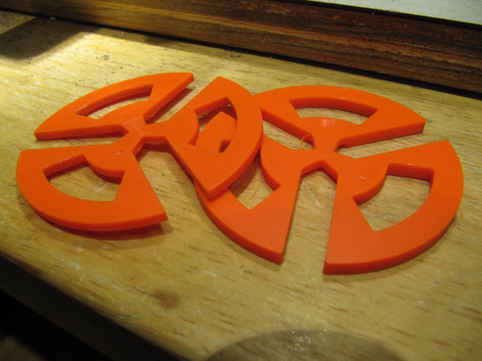

As Kim said, I  have had great luck with lathe spiders, since they span between the jaws, they are captive and cannot fly out like a simple bar can. I made mine in several thicknesses so they can be stacked to het different thickness parts out to the end of the jaws. They can be printed in plastic, or milled from aluminum. Very handy!
Here are the type I printed quite a while back - only drawback to plastic ones are that if the part gets hot it will soften the plastic. I also made some that have rings in the center with holes at the middle so I can drill through the part without destroying the spider.
and some aluminum ones that I had laser cut recently, threw them into a batch of other parts I was having cut. These two are different thicknesses - picked the thickness so I could stack two or three to get parts farther out in the jaws.
They dont have to be this complex a shape - even three arms joined at the center will work, just need to span the center hole of the chuck and be long enough so that even when the jaws are far out the spider cannot slide out the side. These, with the slots around the jaws, I think are the best, very little movement possible while spinning.

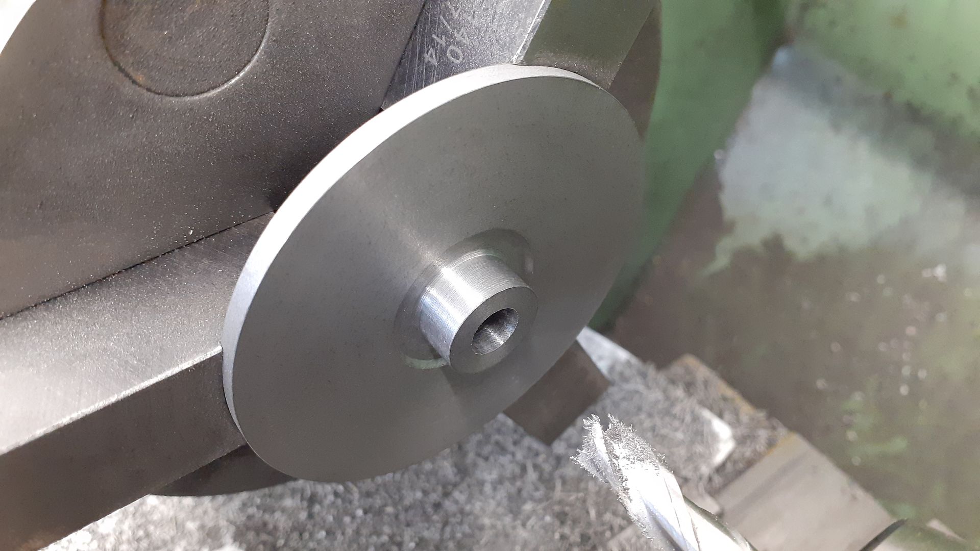

A small fixture plate can be held in a four jaw chuck and used as a faceplate.
This particular one measures 1.685 (42.79mm) x 3.000 (76.2mm) as it was made from scrap.  It is tapped with 10-32 holes.
The same idea can be accomplished with a round fixture plate held in a three jaw chuck.
-Bob

Bob, that's also a great idea although I'd have to come up with something which would allow me to drill right through. Thinking about it there could be some packing between the fixture plate and the part that would do just that or simply a rectangle with a suitably sized hole in the middle and a couple of threaded holes for clamping. I need to have a think about the most versatile simple design.

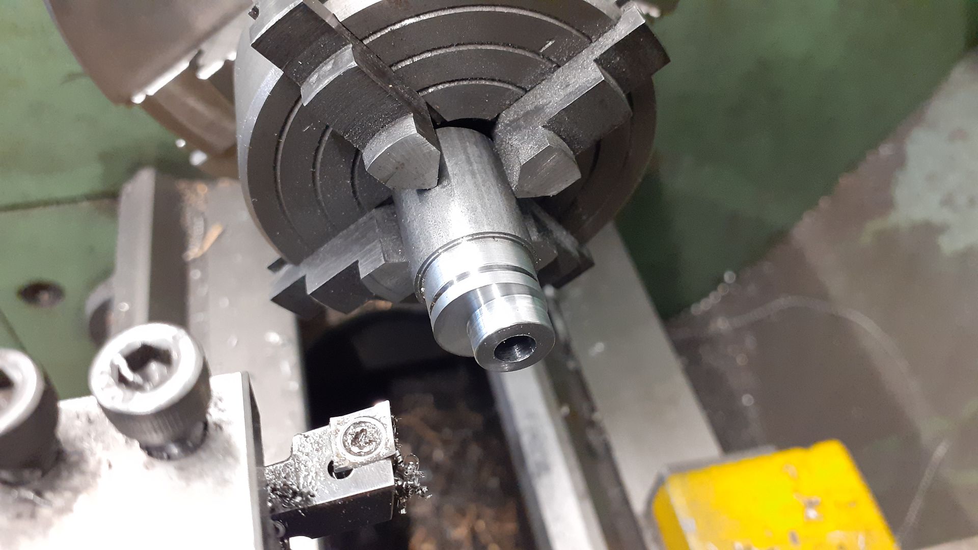

If it is something like the crank disc on your current engine then use a longer piece of bar which will tend to be lined up by the 4 jaws and put the hole in before sawing/parting off the disc. If you have collet blocks then small round items can be held in those and then the block offset in the 4-jaw. Both will save the jaws damaging a previously turned OD

I found a photo of me doing it while the part is still attached to the bar which you don't need extra tooling for.
