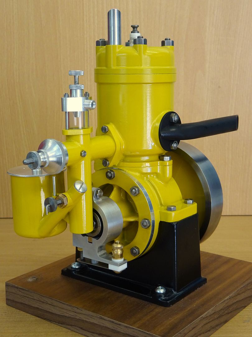

I had a similar problem with this Stuart Simplex and followed Jason's advice and made a new valve chest and cover with stud holes and dummy holes; it worked out great. Take a look at the cylinder below, it was in a terrible state!
