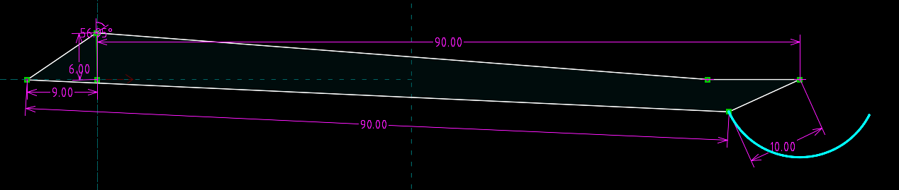

Right, after much frustration with the few online linkage simulators I figured out how to do it in Solvespace. I've settled on these essential dimensions which give around 90 degrees of valve rotation. I think I'll have to spot the position of the valve flats through the cylinder once all the parts are made and the valve pin set in the right position; even though I've got the co-ords of the traced arc from Solvespace and can work out the exact angle, I've got no way to mark that out on the valve. These dimensions give bags of room for a simple piston/wrist pin connection, and a short cylinder making manufacture easier (I might make it longer so the clevis doesn't pop out the end which gives a slightly vulgar appearance even to my blocky constructions!  :Lol:).

Looks like it is back to the original design with the eccentric "pin" approx 90deg from the crank pin which I have always said was needed to get the valve lever at it's extremes of movement when the crank is in the middle of it's movement.
Visually it will also look more interesting than what you posted yesterday as the conrod and valve rod will be moving out of phase with each other.
I would keep the wrist pin part of the piston full diameter, if you do want to reduce weight/friction take some out the middle as I showed. But I would make it as a simple cylinder first, the waist can always be added later. Keeping it short you don't get the extra guiding effect and the side loads are likely to increase friction!

Hi Paul, that’s much better.  I would suggest you now play with the valve rod length and the angle of the valve lever to get the lever at about 90 deg to the engine centreline at mid travel, and travel about equal distance each side of this line.   To get your valve timing right, you also need the crank driving the valve rod to be about 90 degrees to the crank connected to the piston.  I think this is the same as what Jason is saying.
This will give more symmetrical valve events, and avoid the extreme angle at one end of the stroke you show in the new drawing where the valve con rod is getting close to a straight line with the valve rocker arm.  This will reduce the maximum force in the rod, and so reduce the friction losses in the valve mechanism.
Looking forward to seeing firsts chips now you have refined your design.
MJM460
Thank you, this looks like it fits the bill:

No I was meaning that yesterday's sketches had both the crank pin and valve rod pin in the same place. Todays has the crank leading the valve by 90deg.
It is a lot better, I have altered my parts to your latest dimensions and this is how it moves.
Myself I would take the crank throw back up to the 8mm and also possibly reduce the valve from 9mm down to 8mm as it is possibly swinging a bit far but that will depend on the valve and ports. I think having the inlet dead centre of the head as shown in your sketch may give problems.
