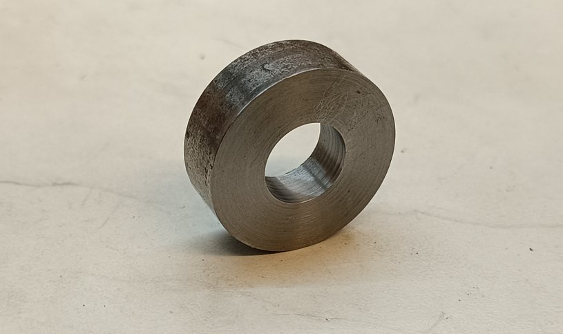

Decided to use an hour of 'shop time to practice something I have done for 10+ years: set up for an offset hole using a DTI, then drill and bore it using a new indexable tool. After drilling to 10mm, I started boring using very light cuts of no more than about 5 thou and while everything seemed to go ok and the final hole is accurate enough, cutting was accompanied by a very high pitched squealing and the finish looks like a knurled surface (!) although it feels pretty smooth.
This was 1/4" thick mild steel, a new carbide insert in a 8mm bar with an overhang around 10mm and tried with and without cutting oil and at low and medium speeds. I'm guessing this is chatter but I can't see where it's coming from unless its wobble caused by the offset. The only bars I've used in the past were the chunky type with welded on carbide tips.
Any suggestions/tips please?
(I didn't try at high speed as the piece was near the front of the jaws, not backed up and offset which seems like a recipe for disaster  :Lol:).

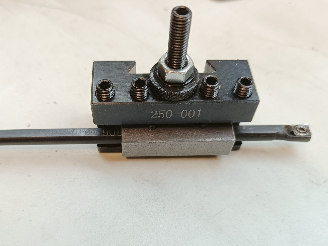

Can you show some pictures of your setup as you ran, bar holder, part in chuck, etc?
  • Posts: 421
Re: Boring Noise & Finish
« Reply #2 on: May 05, 2025, 03:00:27 PM »
I took the part out for the photo so I've just placed it back. I've just measured the tool overhang and it's more like 17mm so not excessive. The bar is held on the flat upper surface by the tool post screws.

A 8mm boring bar with a CCMT 06 tip can only bore a minimum hole diameter of 10.5mm (some brands say 11.0mm min). Below 10.5mm, the lower edge (corner) of the insert rubs on the work. This appears to be what's happening in your case.
You either want to start with a bigger hole or use a smaller diameter boring bar and insert.

Doh! I've just been and measured the bar - it's 6mm not 8mm (I think I had 8mm stuck in my head as I couldn't bore an 8mm hole with this bar even after shortening the screw that holds the insert - it's in one of my build threads but damned if I can find that post now!). So, the tool definitely wasn't rubbing.
Jason, I wonder if the noise or the finish could have been caused by the screws on the tool post? The holder I made for the bar has two grub screws on top which I haven't shortened ie they're proud of the holder's surface so they tend to get in the way of the tool post screws depending on how much of the bar is protruding. In this case two of the toolpost screws were on the holder  and two were touching the bar itself (not tightened down on it) which might have been causing some vibration.

... In this case two of the toolpost screws were on the holder  and two were touching the bar itself (not tightened down on it) which might have been causing some vibration.
Looking at my photo, I think I see what the problem is - I've set the bar's holder at the rear (right side of the tool post rather than the front so the two tool post screws in the photo are the ones toughing the bar, while all the support is at the back. I know why that's happened - I put the bar in the wrong way so I could check the height against a tail stock centre then flipped the tool around rather than the holder. In a nutshell, the tool was being held at the far right rather than the far left.  :facepalm2: :ShakeHead: :-[

Good find, hope that solves it! Sounds like that is the type of bar where the end near the insert necks down? If you can, get all four screws in the tool holder clamped onto the boring bar, if its long enough. Checking the height was one of the things I was about to suggest, sounds like you've already done that. I've found the height can make a big difference, too hight or too low messes up the cutter geometry.

I helps stop the bottom edge of the CCMT insert (not the boring bar) rubbing. Which is probably your problem all along.

However a CCMT insert will always rub in  a 10mm hole with whatever size boring bar you fit it in.
OK, maybe I was wrong; although there seemed to be enough clearance it's not at all easy to see. What's the best solution for a sub 10mm hole then, a round bar with a little 'pencil' of HSS through it held by a grub screw? I think I made one of those in the past.

I have a SELPR style holder that will cut from 7.5mm upwards but it does use a very small insert that is less than the usual CC** 06 size inserts.
I see you have the bars held directly by the toolpost screws. I though there might be a tendency for the tool to rotate if it wasn't centred under the screws so I made a holder from a bit of scrap steel with grub screws on top. The holder is probably too short though as it'll only allow two of the TP screws to contact (tightening the other two would tend to bend the bar downwards). Maybe that's part of the problem as well...

The flats on the bars should be enough to stop any rotation and will also set the bar at the optimum angle.

Your first picture shows a classic case of what's usually referred to as tool chatter Paul. Unfortunately the complete answer or cause isn't always simple, or in some cases have an easy solution since the cause might be due to varied or multiple reasons. Boring is particularly susceptible to it's creation for the obvious reasons of having to use a less than rigid and extended cutting tip position. Think of it as the boring bar being much like a tuning fork. While it's the most likely cause, that's still only one of possibly dozens of other reasons including parts within the machine tool itself, or even the parts being machined and there cross section or shape. So the cutting tool, machine or part itself may be part or even a combination of the causes. Then you start getting into the extremely complex frequency of vibration issues. https://www.secotools.com/article/120669?language=en And even that is very simplified.
Fortunately we only need a basic understanding of how it happens and what the causes could or might be. But even something as hard to diagnose as slightly out of adjustment spindle bearings could in some cases contribute to the issue. So in reality, there's no one single answer that applies in all cases. But let's suppose that the lathe has no other problems or shows that tool chatter when the more usual turning or facing tasks are being done. The first 3 items you can vary when boring are the rpm, feed rate and depth of cut will 'usually' but certainly not always move the tools shank to a different and non sympathetic frequency of vibration range. With boring, the rough rule of thumb is to first try reducing the rpm, and / or increase the feed rate. Increasing that depth of cut can sometimes also work. Fwiw, rarely does increasing the rpm, reducing the feed or depth of cut work. It's not impossible it won't, just less likely it will in most instances. Why that works? The boring bar is then being loaded differently and is then moved outside the tools natural frequency of vibration. (NFV)
When that doesn't work no matter what you try. The next step is to try to deaden that NFV. Something as simple as molding a piece of plumbers putty, plasticine or modeling clay to that extended tool shank, or even tightly wrapping it with a length of solder can sometimes work because it's then helping to absorb or deaden that vibrational frequency. Again there's too many variables for a single method to work in all cases. Even thin walled parts can also cause that chatter to show up. But sometimes something as simple as an elastic band or rubber cord wrapped around the parts O.D. might be enough. Excess or any clearances within the lathe slides can also be a partial contributor. For that reason locking any slide not actually being used may or may not help. Learning this cost me a lot of time to even figure out the correct search terms, and I still barely understand the basics. As you've found, you can almost always hear it happening once it starts, so that's your first indicator that some changes need to be made.
There's also no guarantees that it will only start with thin walled parts. I've personally seen it start to happen in the middle of a 12" long hollow shaft that had a wall thickness of over .625". Since I couldn't reduce the rpm anymore, increasing the feed rate in that case stopped it. But the middle 3" of that shaft had a different frequency of vibration than the two ends did simply due to the better head and tail stock support for the material type and part cross section I was turning.

Spent a little time boring a piece of random scrap steel (I think it's some nickel-steel variant judging by the shiny surface) with different RPM, feed rates, depth of cut and oil or no oil. I managed to avoid any vibration except when using high RPM when the finish was correspondingly poor. After lots of cuts I ended up with a finish I'm reasonably happy with; there are still some tool marks visible but the surface feels very smooth. Hopefully I should be able to get an even better finish using mild steel or brass.
