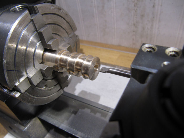

This mornings playtime made up the eccentrics for the crankshaft out of some bearing bronze. Centered up the bar, and turned in the grooves for the straps to ride in. Then offset the bar, drilled a starter shaft hole which was used for the tailstock live center, and turned the bosses. All was done with the parting tool.
Then bored out the shaft hole to final size
And parted off the two eccentrics. That left a stub on the bar which was turned to the same dial setting at the same time as the two eccentric grooves. I'll use this as a go-no-go gauge when boring out the straps. In the picture you can see the turning tool - that was just used to trim back the parted-off extra material from the second eccentric.

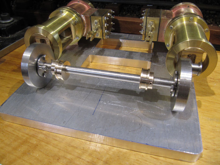

Then the eccentric bosses were drilled/tapped for set screws, and the parts assembled onto the crankshaft. Positions are approximate at this point.

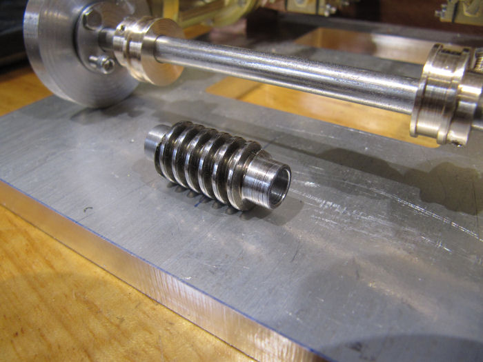

Then cut/drilled/turned the ends on a section of Acme threaded rod, 1/2"-8 pitch, which will go in the center of the crankshaft to drive the worm wheel above it, which will turn the control valve assembly when the engine is running.
I think the next parts will be the bearing blocks and bearings to hold the crankshaft. This is all progressing faster than I thought it would!   :cheers:

Wonderful eccentrics!  And that Acme threaded rod of yours sure sees a lot of action!  That's a great way to make those worm gears.  :ThumbsUp: :popcorn:

Kim, I've accumulated several diameters and pitches of the Acme threaded rod, with matching Acme taps, from 1/4" to 5/8" OD. As you say, a great way to make custom worm gear sets by hobbing with the taps.

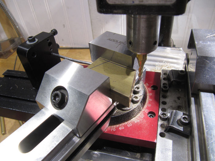

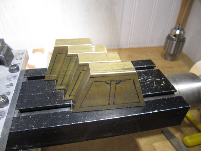

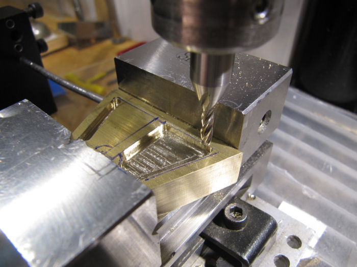

Today started in on the bearing support blocks. There are four of them, two surrounding the worm gear and two out by the crank disks. Cut down some 1-1/4" x 1/2" flat bar, and angled the ends:
Here they are all angled and to length, with the recess pattern sketched on. The final blocks will be 1.1" tall, so the top face will be milled down too.
Got a start on recessing the sides. One panel down, 15 to go! This will take a few sessions...

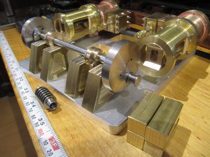

Another couple sessions and the bearing block bases have all the recesses done, and the top/bottom faces taken to dimension:
Next will start in on the caps...
