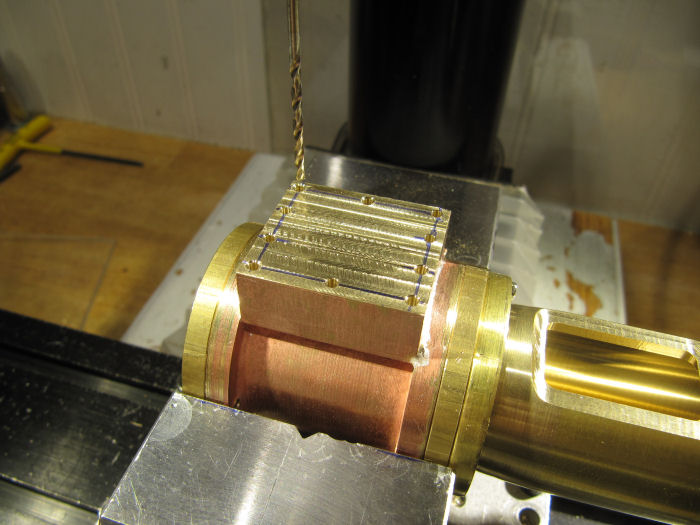

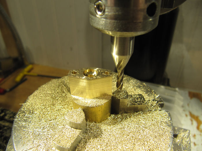

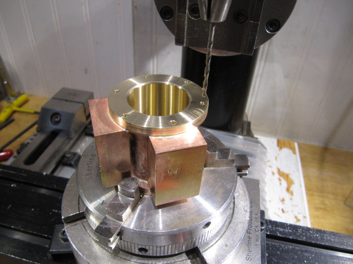

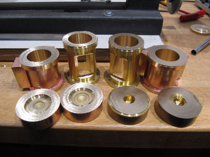

With the crank end of the cylinders complete, it was time to trim off the extra material on the outer ends of the parts. The bandsaw was used to cut the ends off.
Those cutoffs will be useful for something, wonder what?
The cut ends of the parts were trued up on the lathe, then back over to the mill to drill the mounting holes for the end caps:

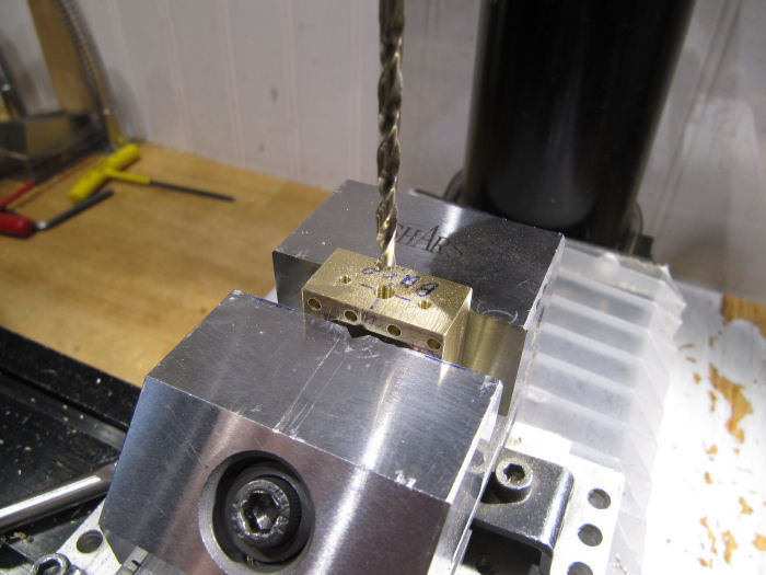

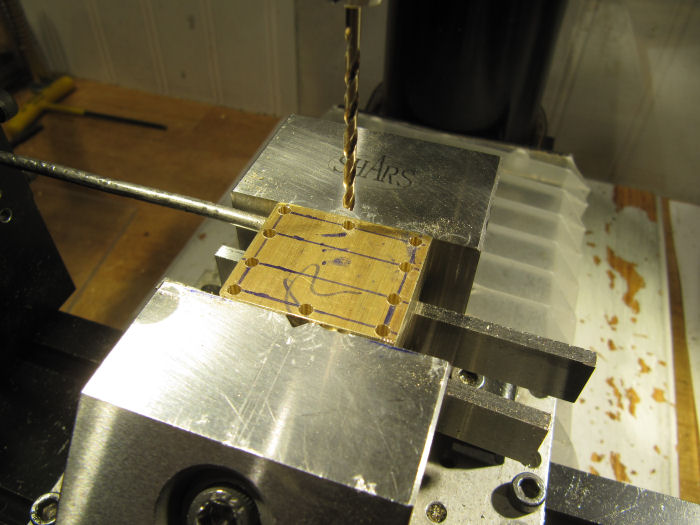

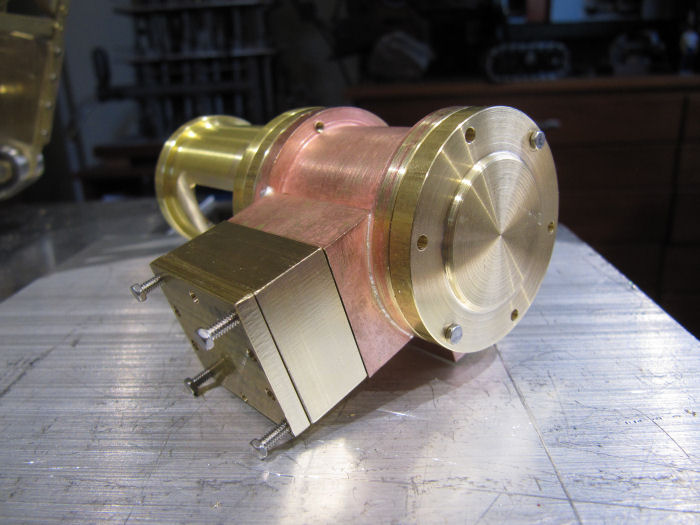

On to the steam chests! Blanks for the chests and lids were cut/trimmed to size, then laid out the bolt pattern to hold them together:
The center of the chest parts will get cut out next time. The same pattern was drilled into the steam chest bases on the cylinders, with a tap drill:
Here is the first one after getting the holes tapped...
One more to tap the holes on, then will start in on the rest of the shaping for the steam chests.The pipe connections to the throttle valve will all be in the steam chest base, so the only side hole needed on the steam chest itself is for the valve rod/gland on the end.

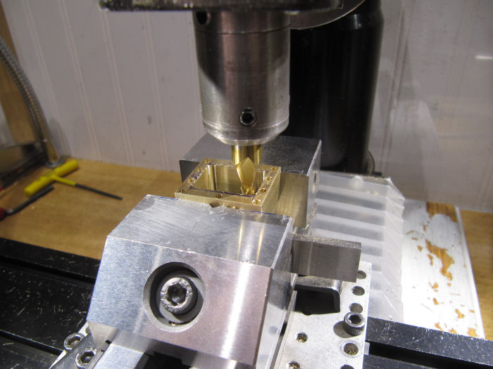

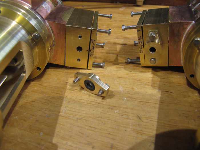

This morning I milled out the centers of the steam chest blocks:
then drilled the valve rod and gland screw holes
and made the two glands. The recess in the end around the valve rod hole is a close fit for an o-ring. After shaping, the two glands were parted off on the lathe.
Here one gland is bolted to the chest on the right, the other is on the table to show the o-ring:
Next I want to drill/tap the holes in the base blocks to hold the cylinders to the base plate, then will start in on all the ports/passages...
