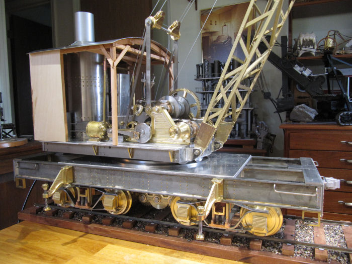

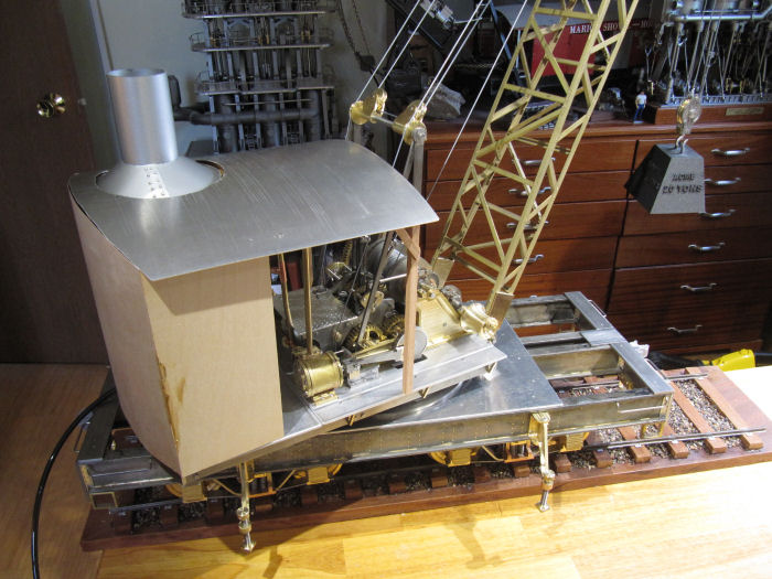

Hi all,
This model has been underway since last October, and its now complete! It is of an Ohio Locomotive Crane Company 20 ton crane, intended for use in factory settings. It is a self-propelled rail crane, with a single two-cylinder double-acting steam engine driving all the crane functions: travel, slew, boom tilt, and hoist cable. The engine runs in just one direction at all times, and they got forward/reverse movement on each output shaft through the use of two cone clutches on each shaft either side of a bevel gear- engaging one moved it in one direction, engaging the other moved it in the other direction. Here is a page from the company catalog, which also shows an optional steam shovel boom. Other options included clamshell buckets, drag line buckets, and a second winding drum.
Here are some pictures of the model:

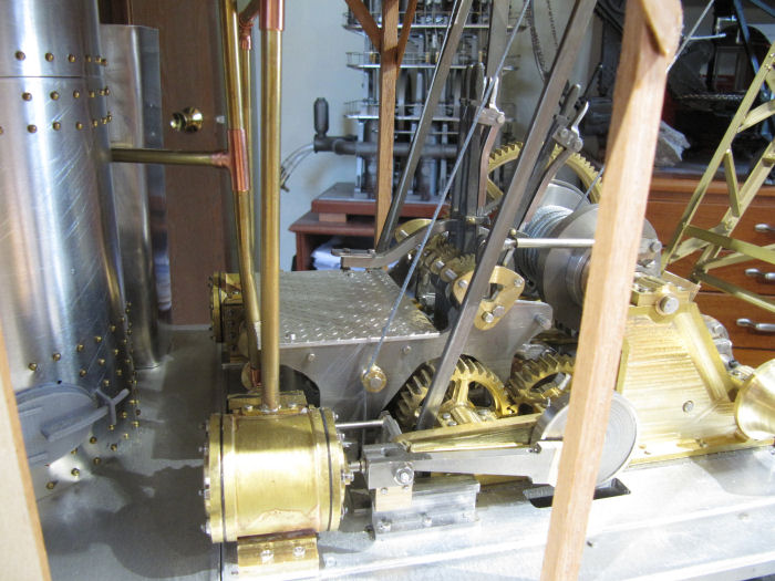

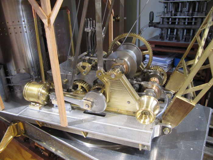

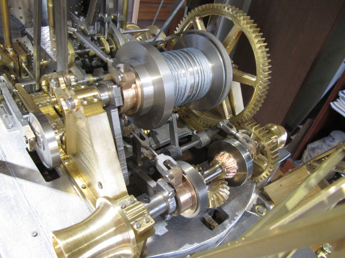

Here you can see some of the clutches. On the slew gear shaft at the front of the turntable, there is a cone clutch either side of the horizontal bevel gear, each clutch drum has a smaller bevel gear attached to it.  The gears on the right in the photo bring power from the engine to the horizontal shafts, and depending which clutch is engaged, the vertical output shaft gets turned in one direction or the other. The hoist drum shaft up above just has one clutch, with a brake band on the drum for lowering.

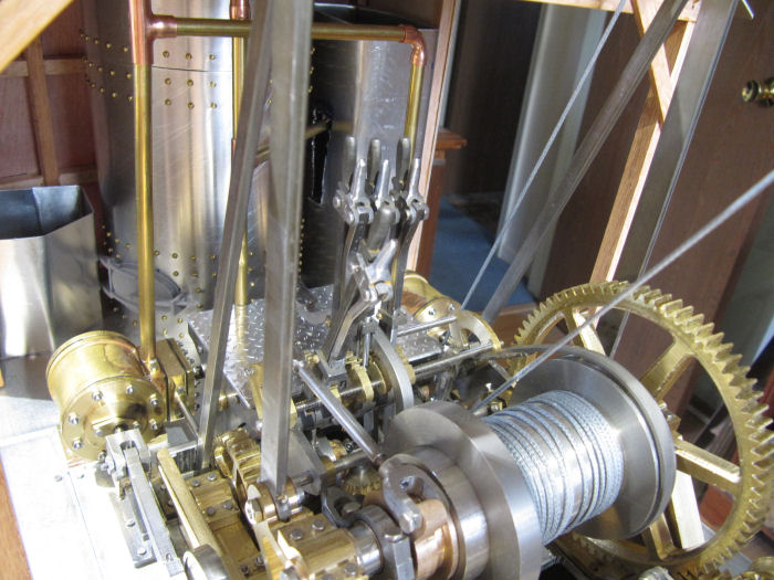

Here is the operator station, with four hand levers and one brake pedal. These levers control the travel, slew, hoist, and derrick (boom tilt) functions. Forward on the lever engages one clutch, back on the lever engages the other clutch on the same shaft. In the middle, both clutches are disengaged. Each lever has a latching handgrip that locks the lever in position against a quadrant at its base.
Another view of the operator station, plus the engine. There is one cylinder on each side, driving a common crankshaft.

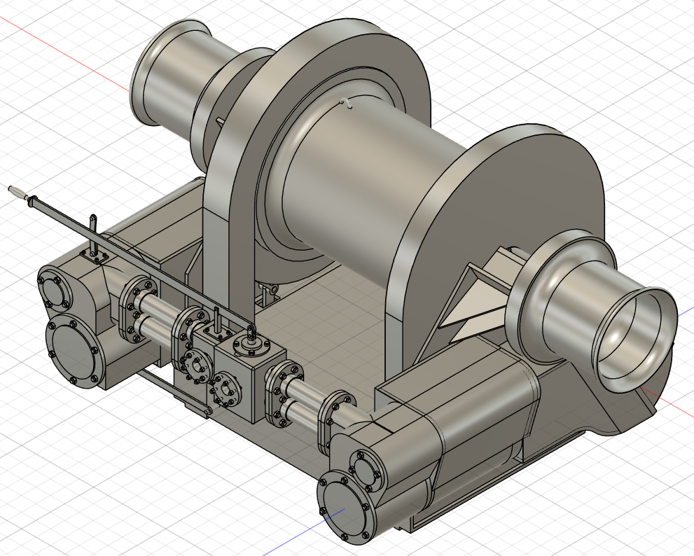

As for the next project, been giving that a lot of thought. The shop elves have been back in their lab seeing what they can invent:
I'm not sure what that one is (they are not sure either!) so I went back to my list of possible builds. The top six on the current list are:
One each of the different design slew/crowd engines I have design for, from these brand steam shovels: Thew, Erie, Marion, and Bucyrus. They are all similar, but have different arrangements for the valving and crankshafts:

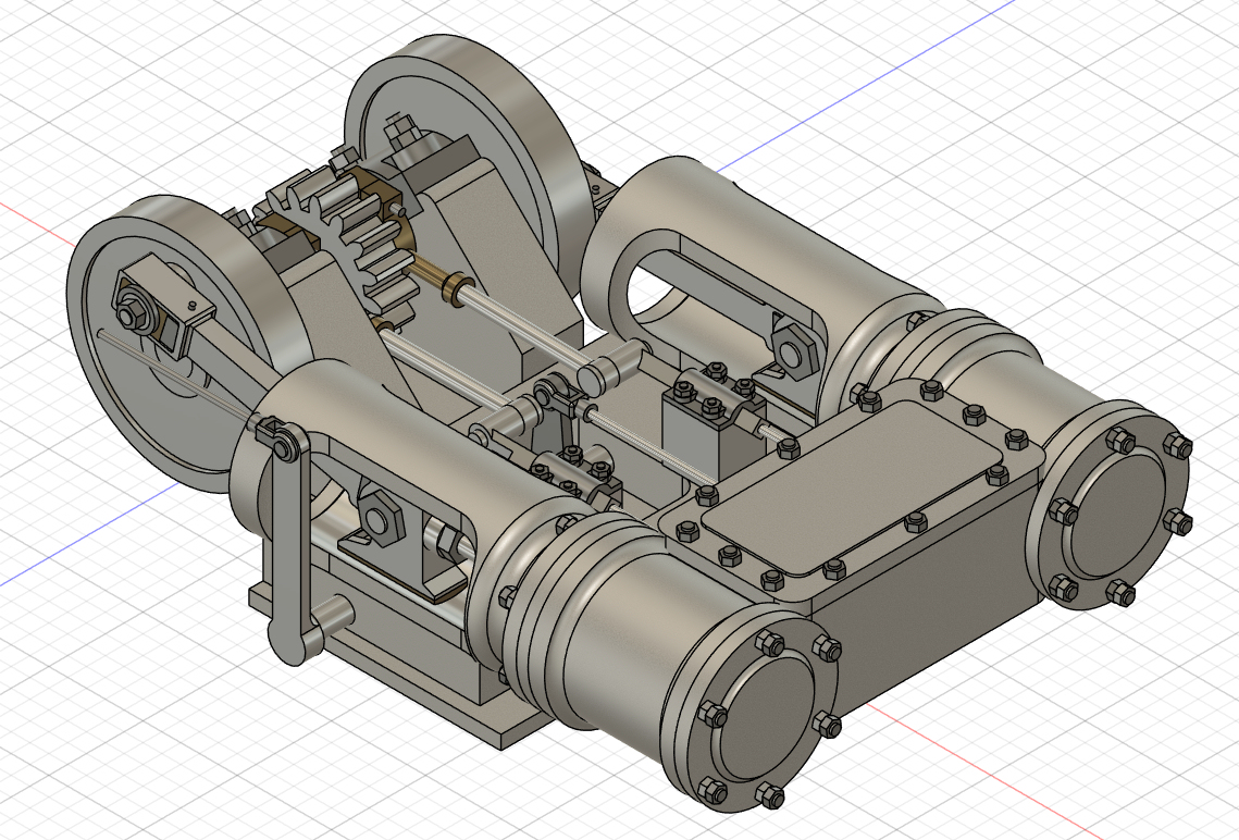

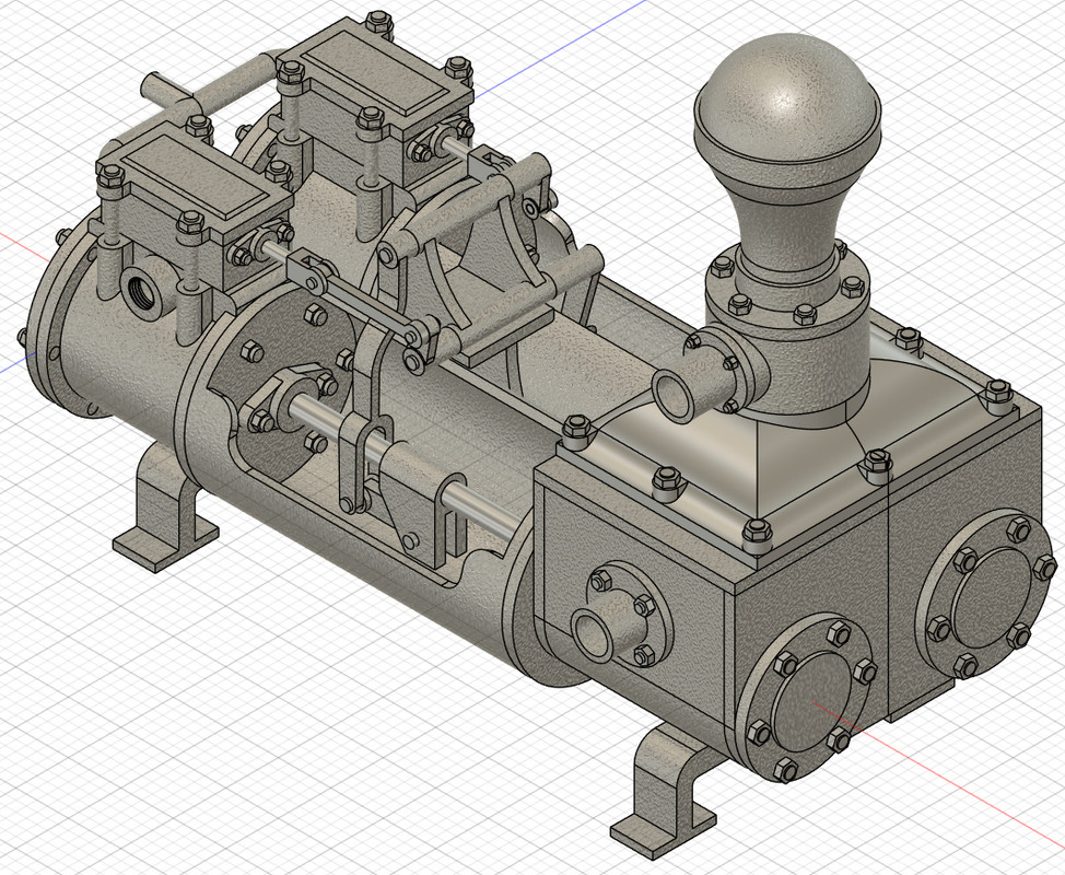

Another option is the Worthington Brewery Pump, a duplex pump variation that they made for breweries to pump beer between vats/kettles during the brewing process. The shop elves wanted to insist on this one, but I distracted them with a box of shiny bearings and they missed the final vote!   :Lol:
An engine that I drew up quite a while back was drawn from original Navy plans I found at the US National Archives, for the steering engine from the battleship Kearsarge. It would be a large engine, especially with all the other linkages/wheels, but they would not have to be there in the model. The gear train on this one is quite complex.

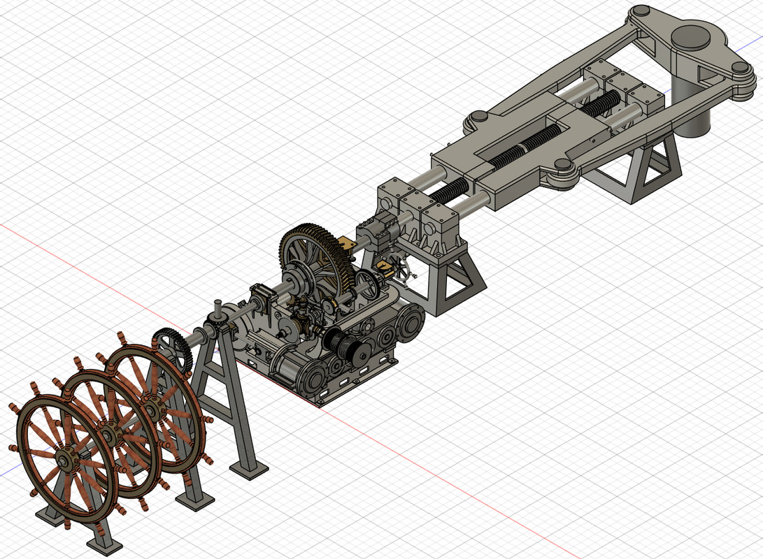

Recently I drew up this engine, a 7 cylinder steam radial with double acting cylinders. I have two versions of it, one with normal D valves that would run in one direction, the other has the 4-port/double layer slide valves like those in the slew/crowd steam shovel engines, which can be run in either direction with a second set of pipes and a control valve. This one would be quite fun!
Another one on the list was inspired by my cruise on the Liberty Ship in Baltimore not long ago, they had a flock of steam deck winches that look interesting. I found this design in an old patent from American Hoist And Derrick, and drew it up in CAD:

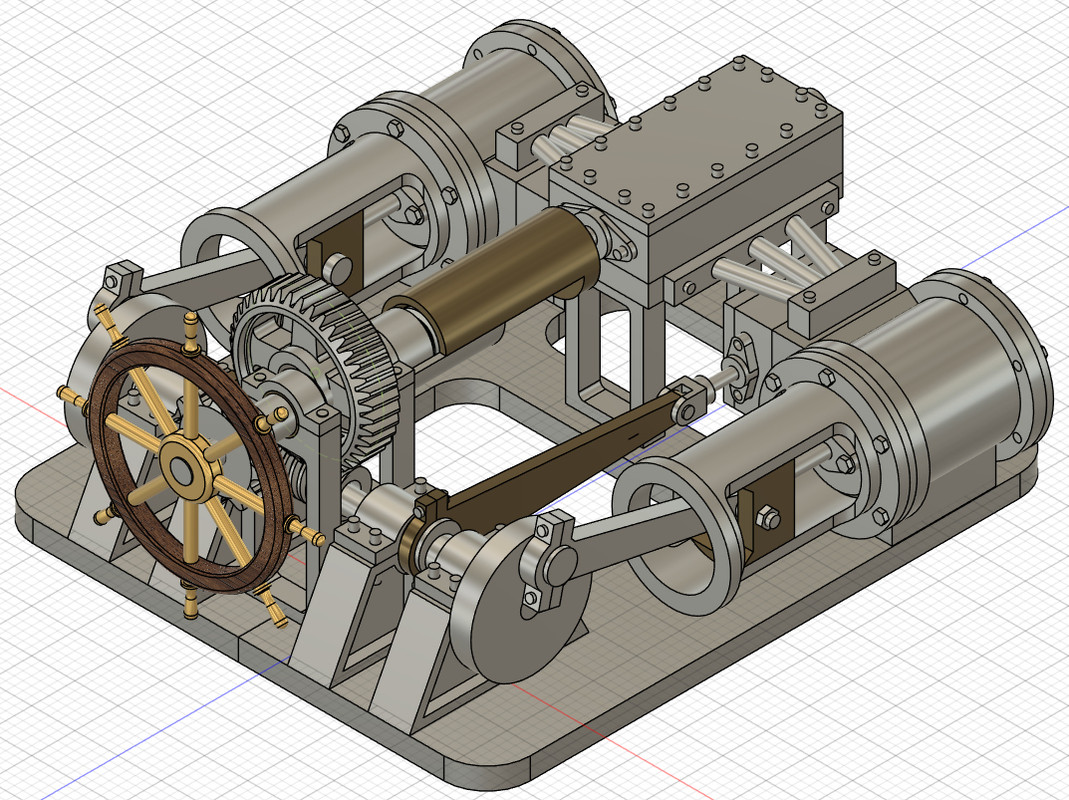

Finally there is this one, my own version of a steam steering engine. A couple years ago I built one based on the real one that Michael has, salvaged from a paddle steamer in Germany, that he very kindly supplied many pictures, measurements, drawings, and videos of. That one had the option for manual backup steering, and was a fairly complex design. This one that I have drawn recently is a more simplified design, based on ones used in Navy torpedo boats. It does not have a manual steering backup or a rudder position indicator (those were seperate items on those boats), and I've drawn it to use the 4-port slew/crowd engine valves so it also does not have piston valves. Its a nice compact model, the base is 6 inches on a side, with 1"x1" bore/stroke cylinders.
And the winner is.... The steering engine! Steering engines have intrigued me since I first saw one at the antique engine show at Mystic Seaport Museum, then built the one from Michaels original engine. There are many styles and sizes of them, and the feedback mechanism in them reminds me a lot of the radio-control servos, but are all mechanical rather than electronic. So, this build will start in a new thread today or tomorrow!   :whoohoo:
