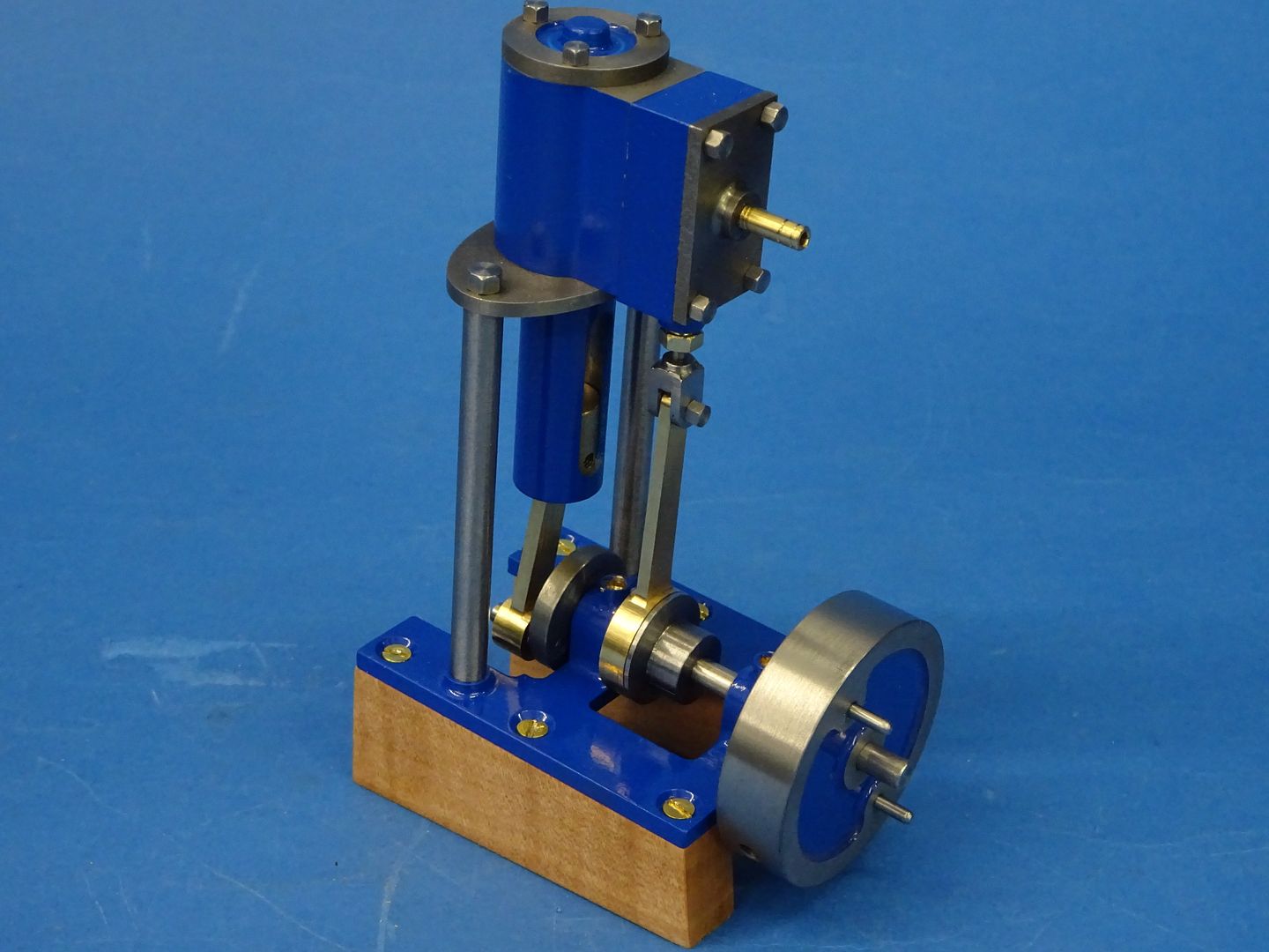

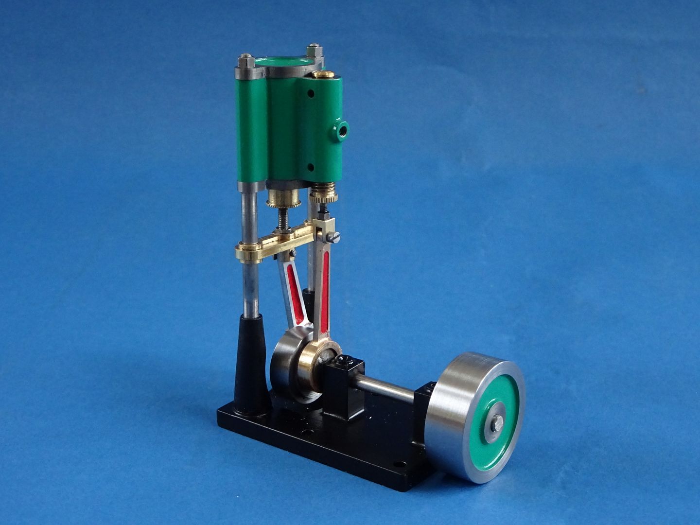

Yes looks like a piston alve. It would probably also run if you put the air into the single hole on the other side.
I've made a couple of two column small marine engines, one of which also uses the columns as the guide.
Gamages NDC, this will run if I put air into the two "exhaust" holes or the central "inlet"
Basset-Lowke Eclipse

They look great and yes a 2 column support doubling up as guides. Also the flywheels definitely look more in keeping with these type of engines both style and size wise. I'm going to machine and install a new one and set it on a larger wooden plinth

BTW, what does Gamages NDC mean?
Gamages was a store selling steam engines (amongst other things) in London, wasn't it?

Never really worked out what the NDC stood for. It is used for some engines to abreviate "non dead centre" but it is not that.
Original advert at the top of this thread

Oh, I like that Gamages engine - filed away the picture for future reference!
