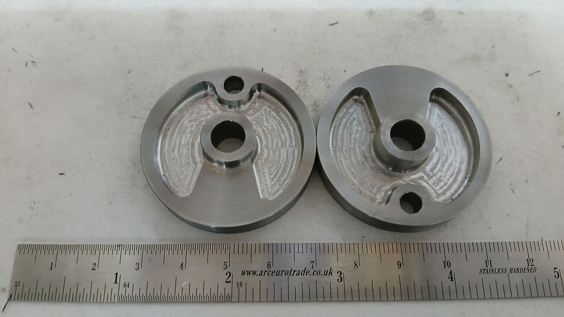

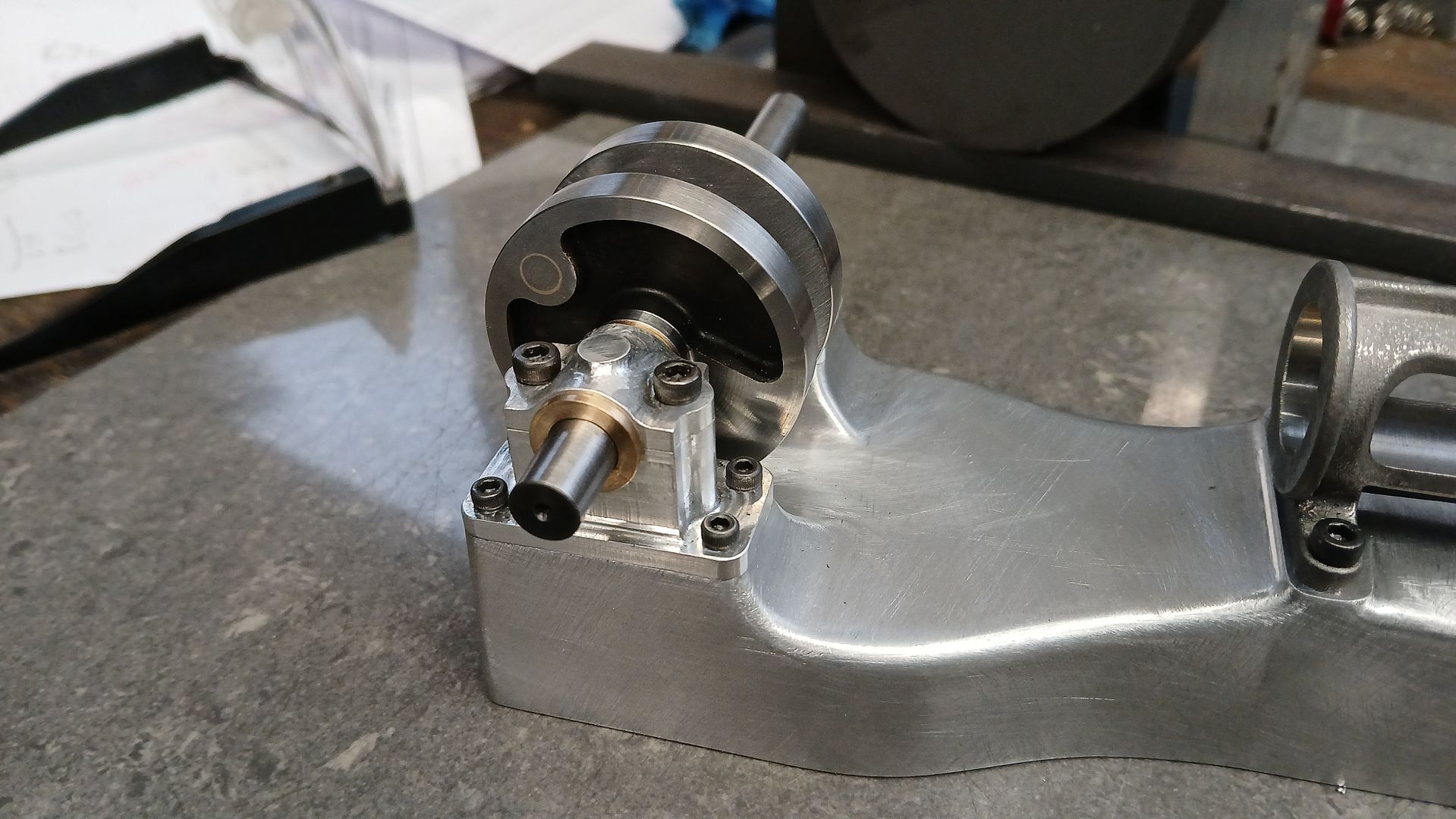

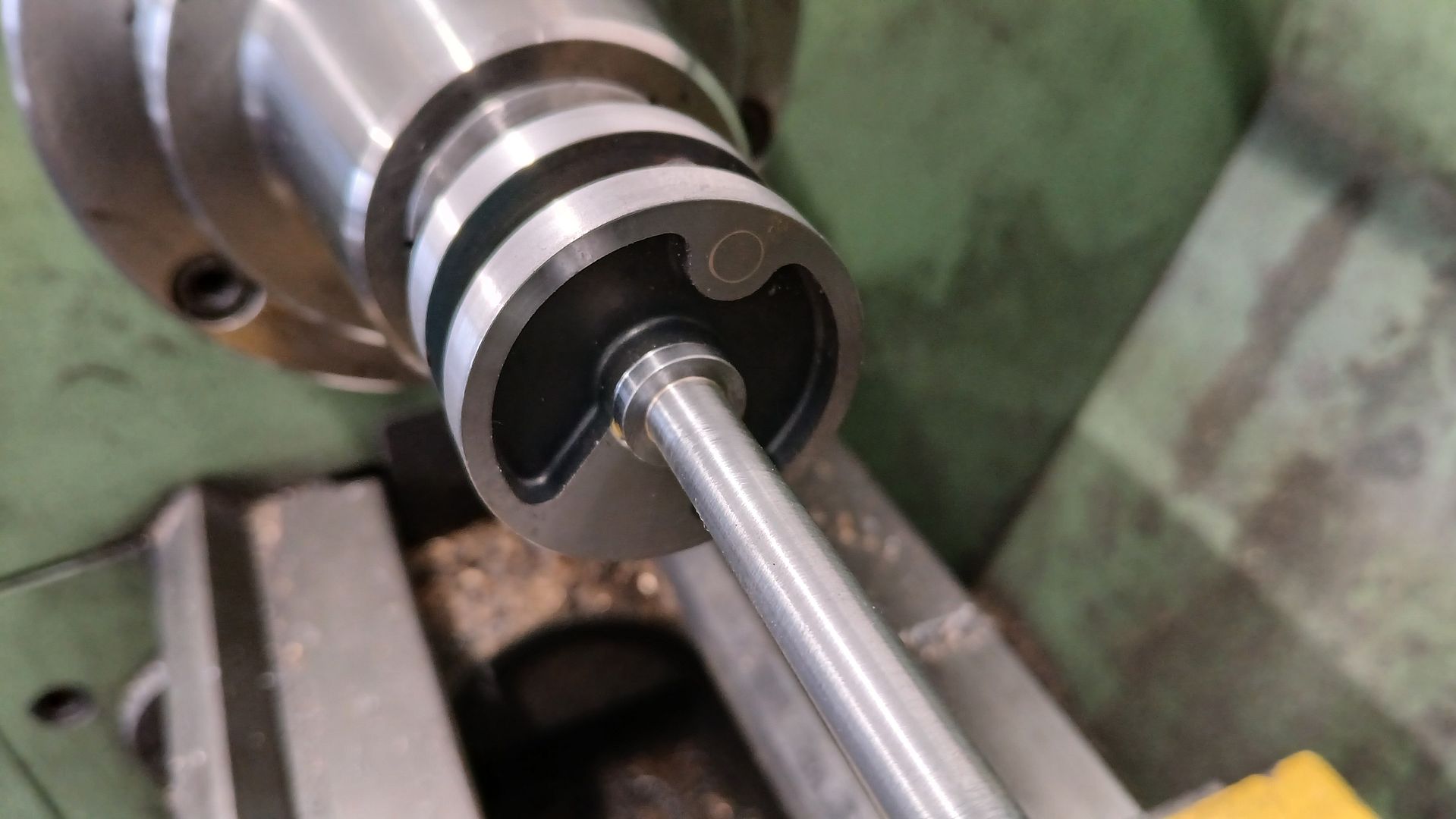

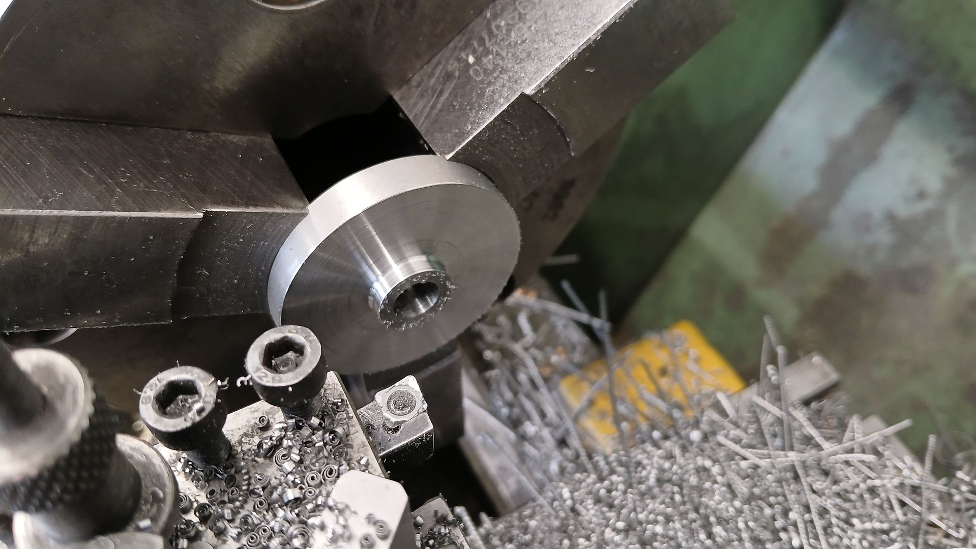

The original engines came with the two disc type crank webs as iron castings, the one I have based mine on would not turn over and one of the main reasons was that the crank had twisted at one or both of the crank pin to web joints. For this reason, I decided to make my webs from steel so that the whole crankshaft assembly could easily be silver soldered together.
The two webs were first turned, drilled and reamed 8mm on the lathe and made good use of a couple of bar ends. I used a CCGT 060208 insert to give a nice fillet to the internal corner.
The webs were then held in the 3-jaw chuck using soft jaws and the "cast" recess milled. The majority of the material was removed with a 4mm cutter using an adaptive tool path, this needed a bit of tweaking of the parameters to get the 4mm tool into the narrow gap but was done mostly by reducing the minimum cutting radius. That cutter is starting to loose it's edge I can hear a bit more noise and it left a small burr around the edge of the cut then changing to a cutter with a 1mm corner radius the bottom of the recess was finished with a horizontal path and lastly the edges of the recess done with a contour going round twice. At about 3.00 mins in you can see that the shaprper cutter removes the burr from the earlier adaptive op.
The usual methods of a full length shaft and pin with reduced ends were use to make the other bits from PGMS which was then silver soldered together before a quick clean up skim of the webs on the lathe before the middle if the crankshaft was cut away. Quite like the black oxide from heating that has been left in the recess
All seems to fit and go round as it should. I'm not going to fit a pulley on mine so just made the crankshaft on the near side a bit longer than is needed for the eccentric as it saves a bit of shelf space!
<a href="https://www.youtube.com/watch?v=UZ5pORpIRwk" target="_blank">http://www.youtube.com/watch?v=UZ5pORpIRwk</a>

They look soooo good! Is that black primer or finish you have applied to the recesses?
  • Posts: 11263
Re: Half Scale 1/4HP A J Weed Engine
« Reply #19 on: April 02, 2025, 06:02:45 PM »
It is just the oxide that formed on the crank when it was heated for soldering.

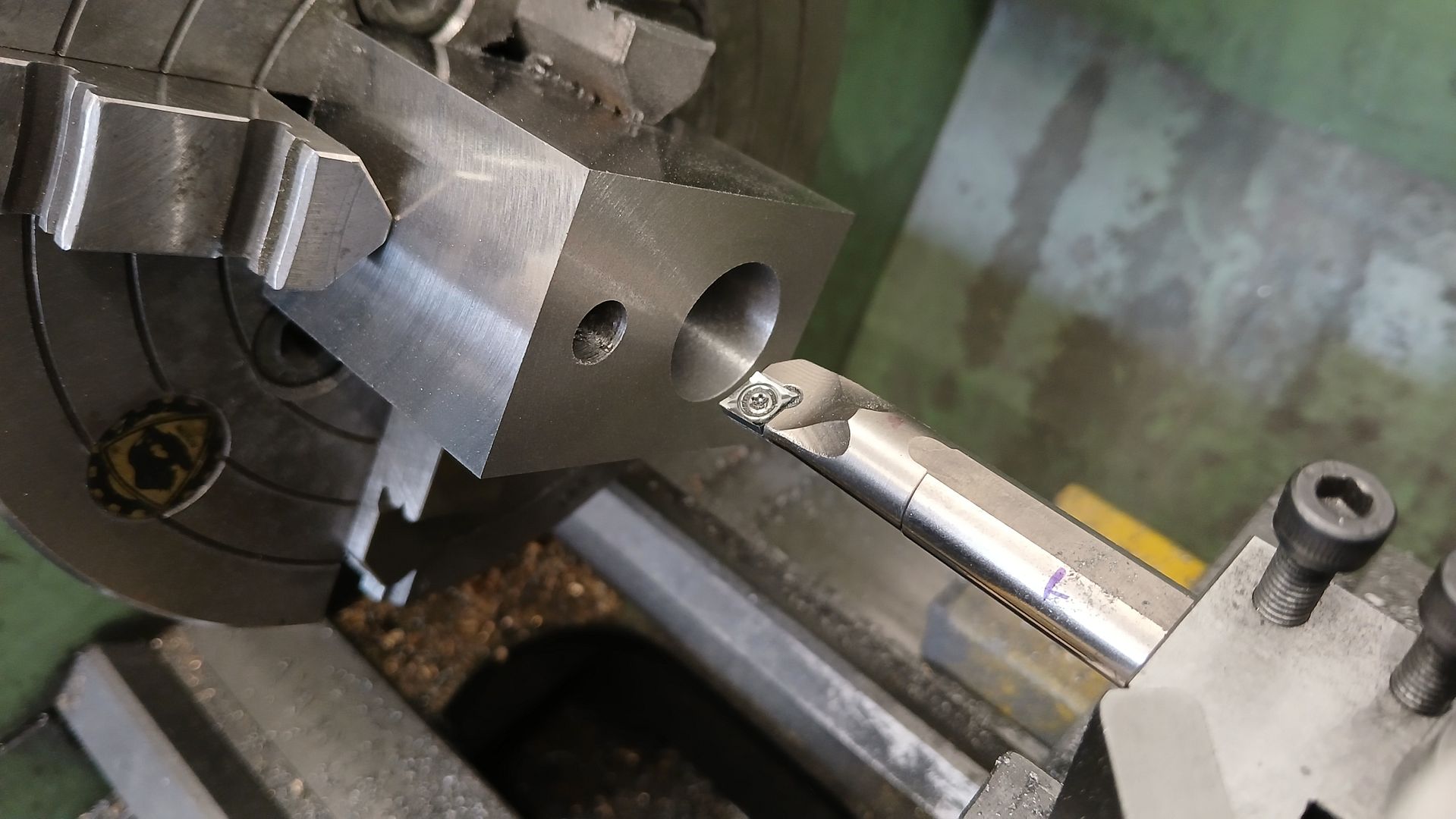

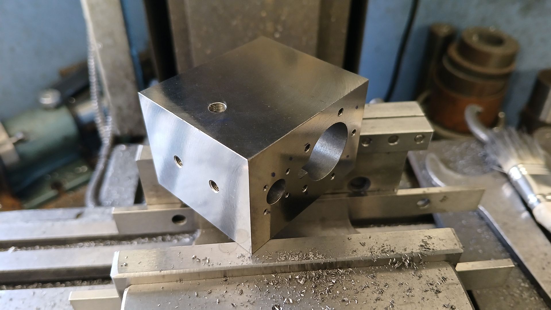

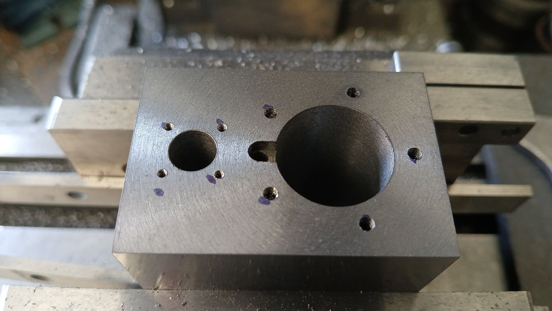

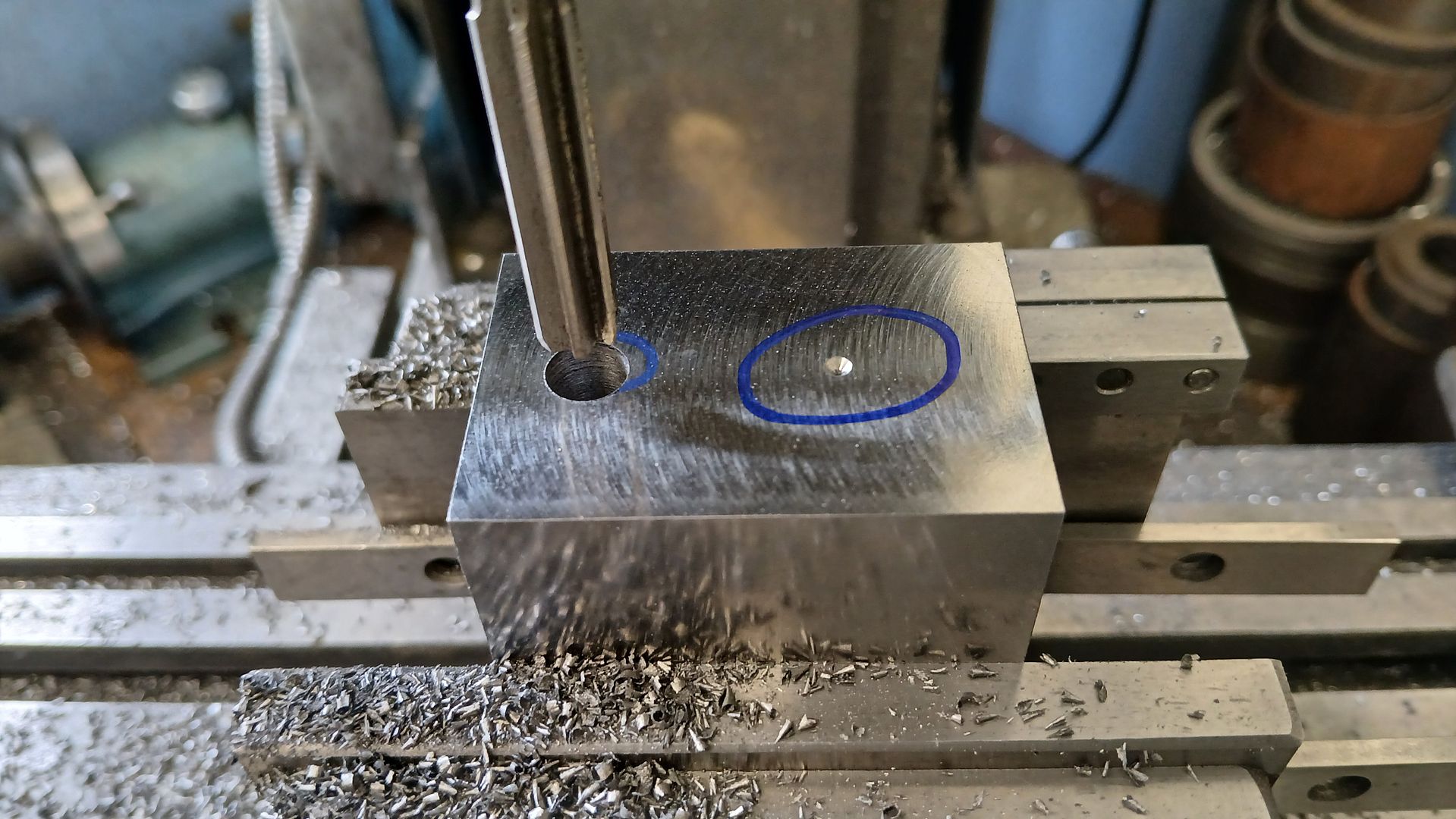

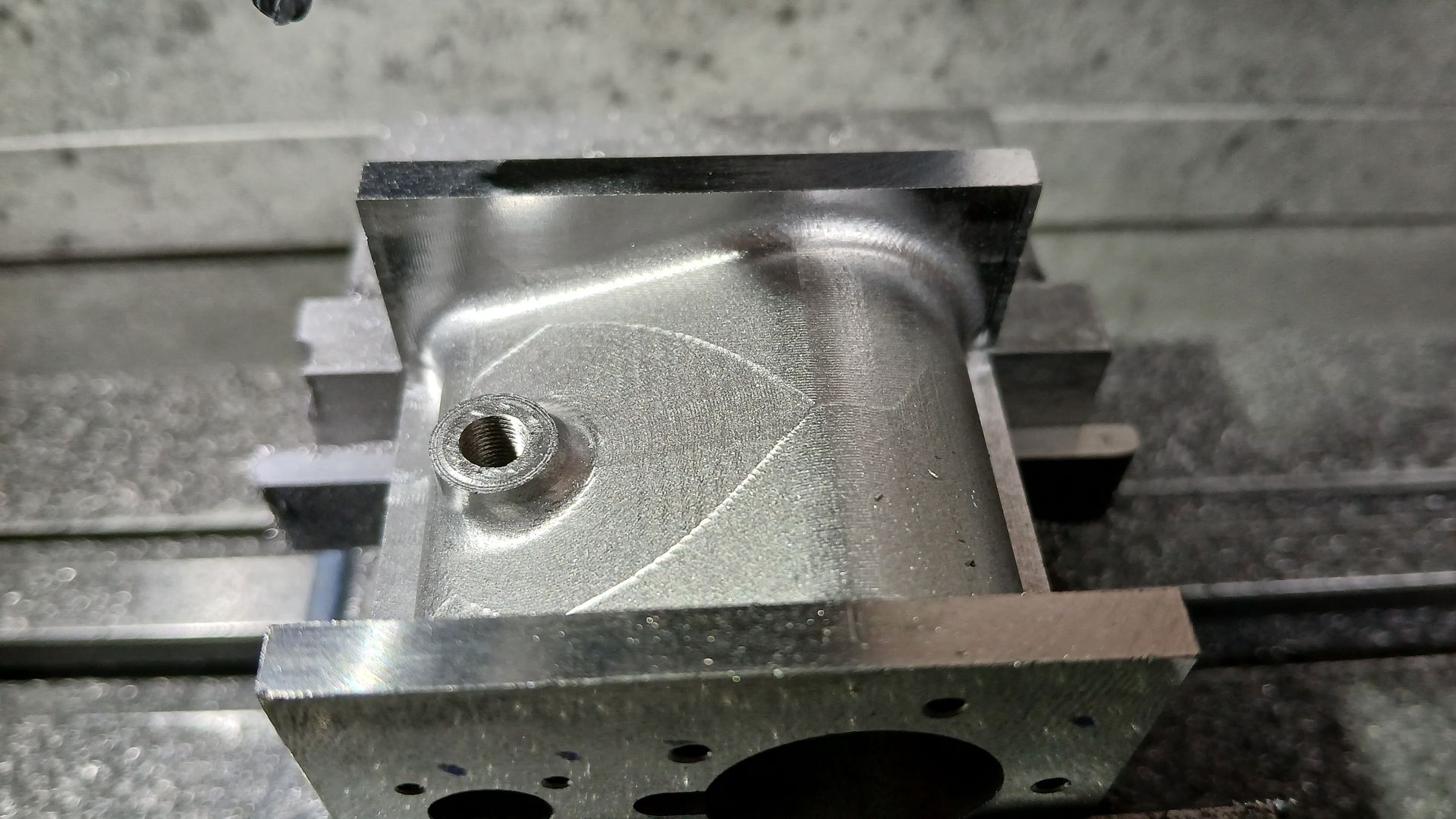

The Cylinder was cut from a block of cast iron. First I machined all the faces with a Shell mill fitted with inserts intended for Aluminium leaving 1mm on the sides, top, bottom and one end. This was then held in the mill vice and the ctr of the piston and valve bores spotted before drilling the valve hole 7.8mm and reaming out to 8mm.
Transfering it over to the 4-jaw the second spot mark was clocked true, the bore opened out with a couple of different size drills and then finish bored to 20mm. A also faced off this end where the piston rod goes at the same setting to ensure it was true to the bore.
While the cylinder was an easy to hold shape I did the rest of the details - tapped holes for cylinder and valve covers, steam passage and the notch to connect that to the cylinder. The other end was almost the same except it had a 4 hole pattern for the cylinder cover.
There was also a tappe dhole for the steam inlet and two holes to connect the valve chamber to the steam passages, the outer part of these holes is tapped M4 x 0.5 and will get plugged after the shaping has been done.

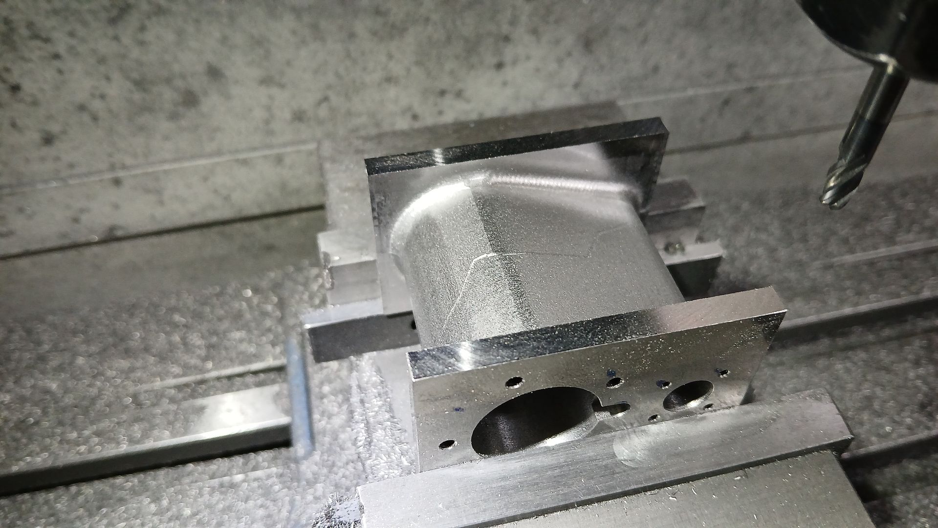

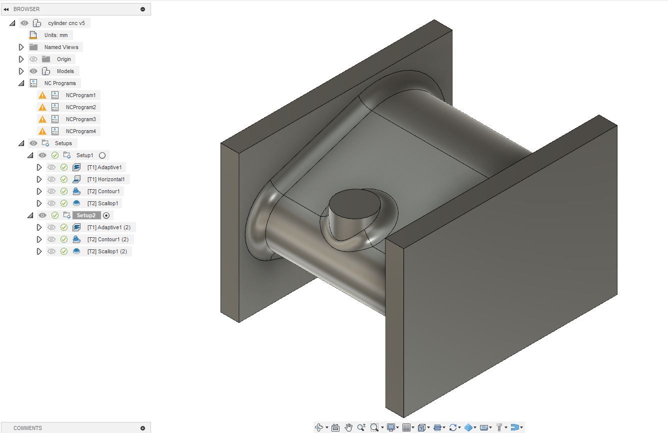

It was then onto the CNC to machine the "cast" shape of the cylinder. I did this in two stages, first the teardrop shape between the two flanges with the work horizontal and then the actual flanges with it held vertically.
The first part was done with an adaptive to remove the majority of the waste, a quick horizontal to finish the top of the inlet boss, a contour to remove metal from thinner flange faces so that the final scallop path did not drive the cutter into these vertical faces at full depth which was more than the flute length.
<a href="https://www.youtube.com/watch?v=jPMgmilgQfU" target="_blank">http://www.youtube.com/watch?v=jPMgmilgQfU</a>
The "Ace of Clubs" mark you can see on the surface is the result of a tiny bit of backlash in the Z axis and is where the cutter changes from a downward cut to going back up the other side or vice versa. Probably less than 0.025mm (1thou).
I will cover the rest of the cylinder in the next update.

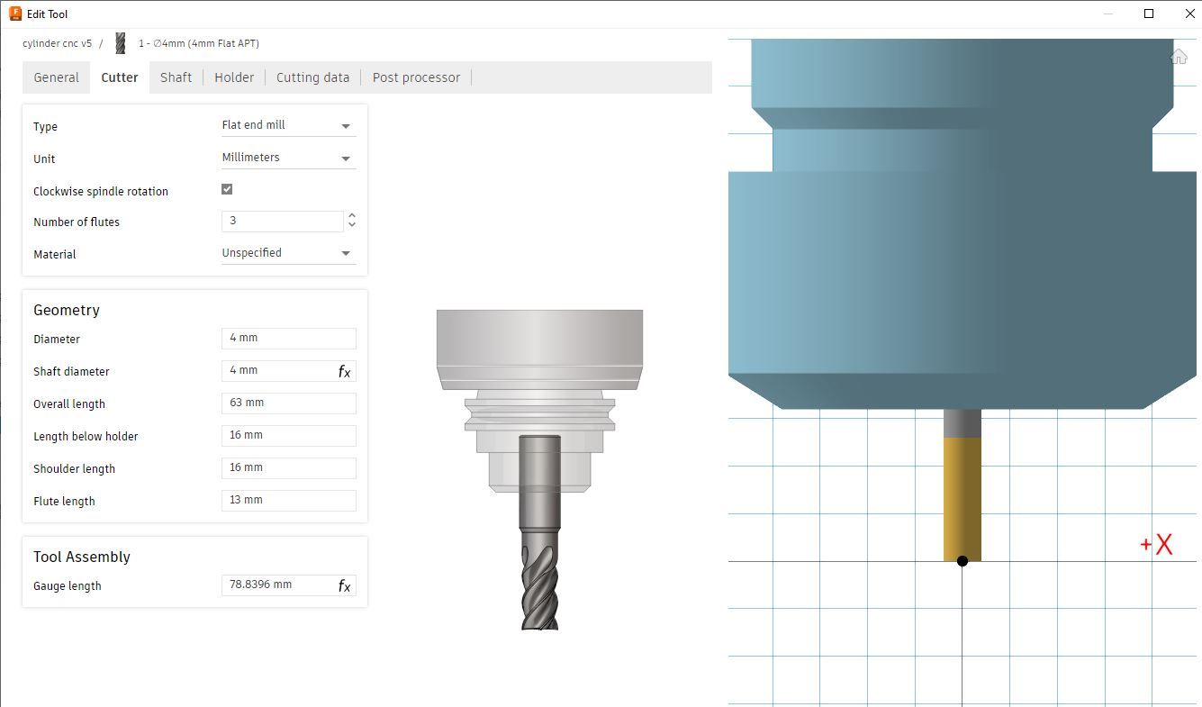

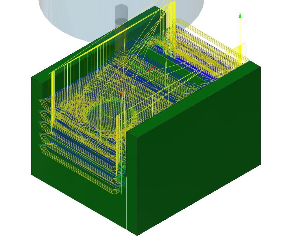

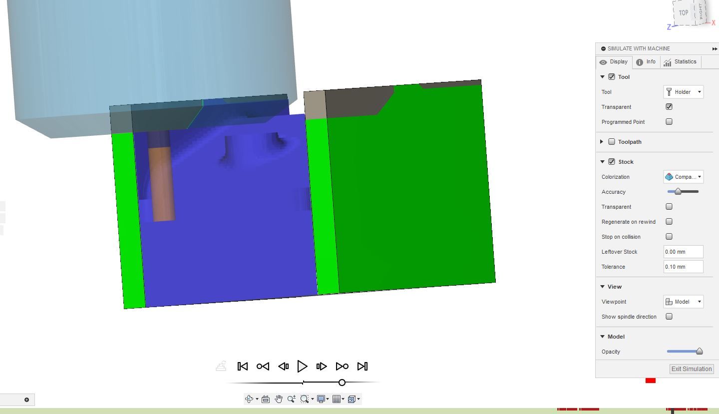

For small items that don't take long I'll probably just watch, those that run for longer I will just go and do something else and not even in the workshop so yes it is automated and will just run the program once you press start. The CAM software gives me a time each path or group of paths will take so I know when to come back and change tools for the next op or turn off the compressor if the job is done.
As I design in Alibre and do the CAM in F360 the first thing I have to do in export from Alibre and open in F360. Then I set up my basic part, size of stock and the orientation of the stock. I also pick a datum point which is where I will locate the work on the CNC, often top ctr for me, others may use a back corner.
I'll then go on to choose which type of cuts I want to use, the cutter, feeds and speeds, depth and stepover, etc These are what are listed down the right side along with the setup. There is a second setup and paths for when the part gets turned over to do the other side. I can duplicate or copy and past the details from the first op and just alter them slightly for the second so don't have to do it all again. The path of the tool and what it will remove is shown here, Blue is when it ios cutting, yellow when moving about but not cutting.

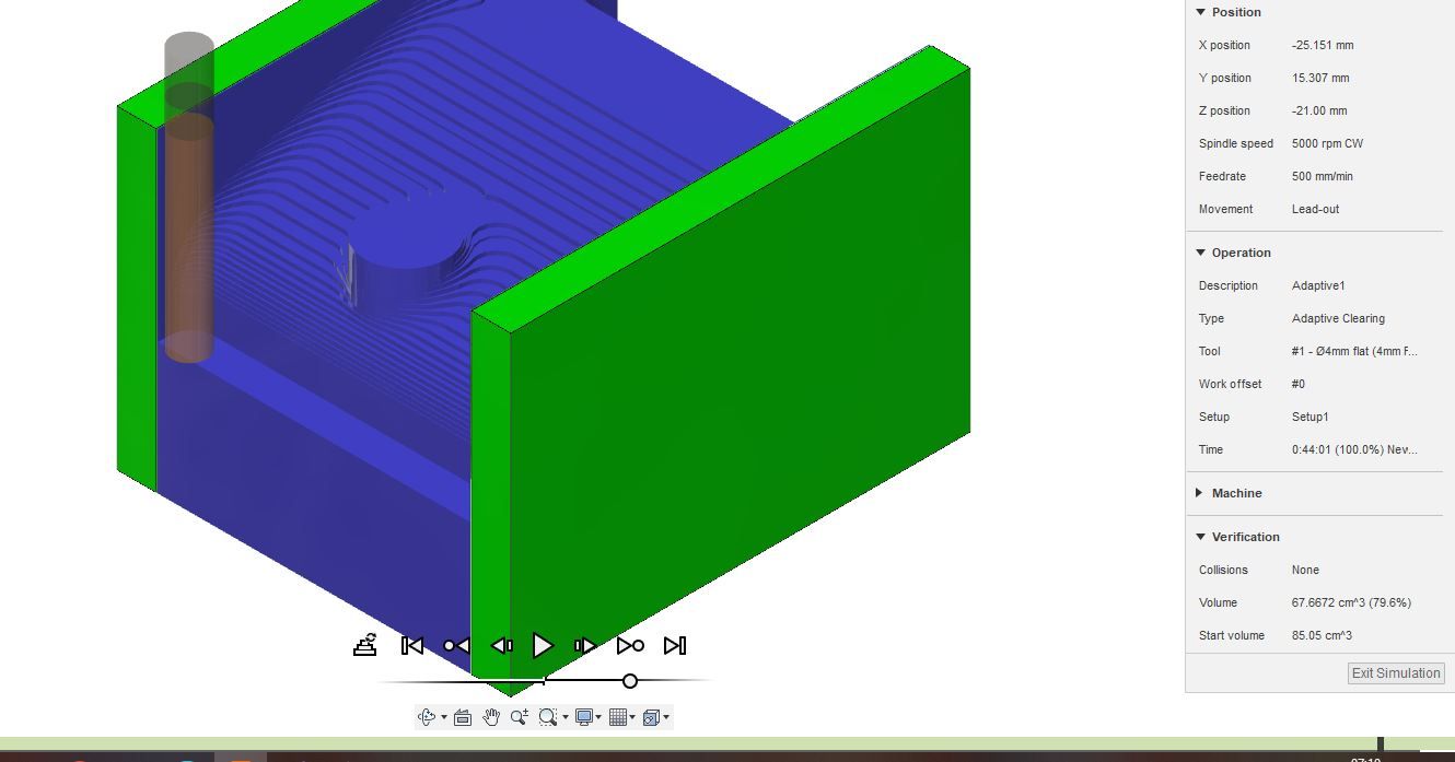

There is also a "simulate" option where you can watch the tool as it actually cuts the material. I use a contrast which has the waste shown in purple and the finished part in green. This gives a good indication of what the tool will do. Not the length of the tool, I extended it from my default setup for this as the 4mm tool needed to reach about 20mm deep.
In the image below I have reduced the tool stickout so that it is less than the depth of cut.
If I then run the simulation it flags up any crashes, 654 in this case which are all the red marks towards the end of the progress bar at the bottom of the screen. It also shows in grey where the tool holder has come into contact with the workpiece. So while it will show you some problems it won't stop you taking a 15mm deep full width cut with a 3mm cutter fed at 1000mm/min. Or setting up the part with the datum in the wrong place so it cuts in a different position, stay tuned for an example of that :-[.
This is a video that I did for something else that shows the simulation in action. First half was the way Bob was going about it working his way down and then a parallel path to do the top. Second half is how I tend to work with an adaptive and then suitable finish paths which was a lot faster and also spreads the wear over more of the flutes rather than just blunting the end.
