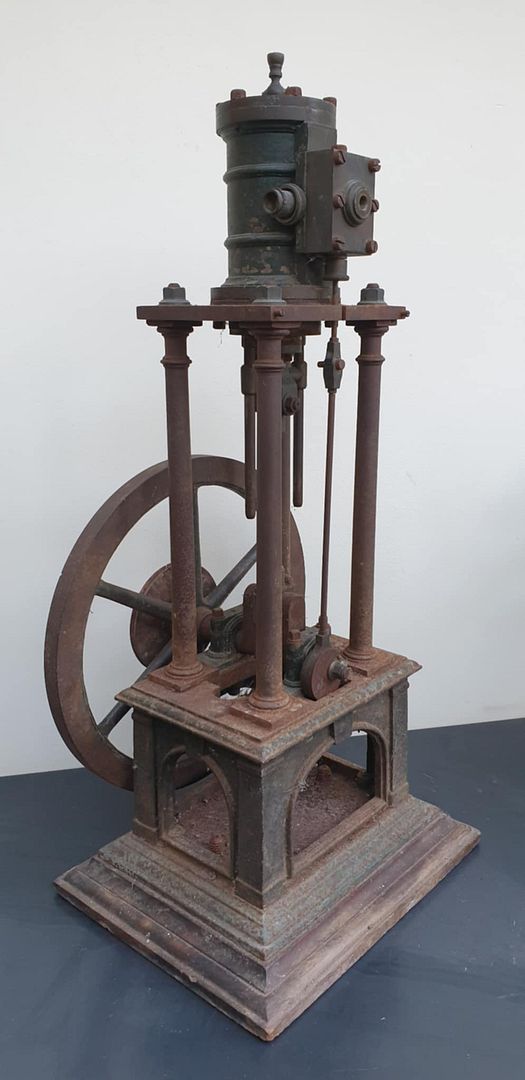

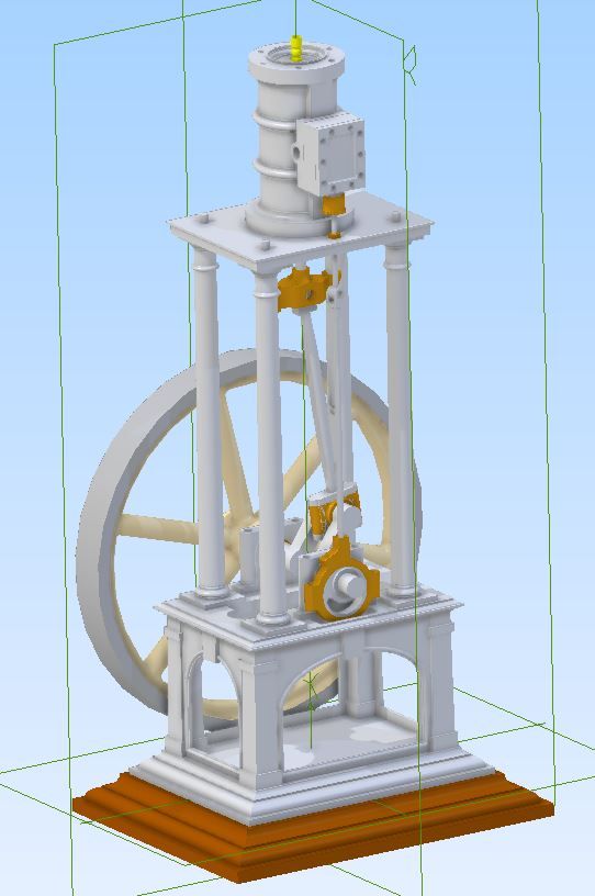

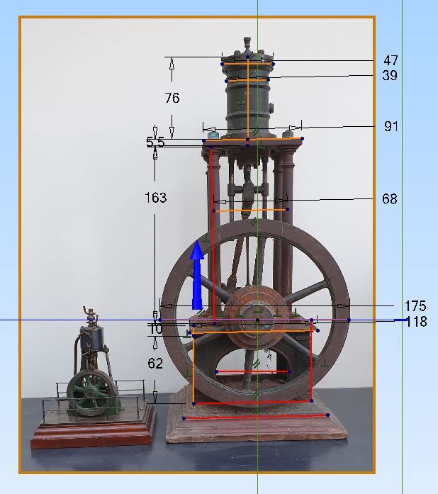

One of the collectors on The Stuart Models FB page posted an image of his new addition a few months ago and I thought it would make a good model.
No idea if it is based on any specific full size engine or was ever offered as plans or castings but the cylinder and valve chest do have the look of Stevens Model Dockyard about them so it may have been built using one of their sets of cylinder castings. I've named it after the guy who now owns it.
As it was on the Stuart Group and there was some interest from others who may want to build it I thought I should at least include one Stuart casting. The proportions are not quite right to use both a 7" flywheel and their 2" x 1" cylinder as this engine has a larger cylinder so I drew it around the flywheel as that would probably be the harder part for people to make. First job was to put an image into Alibre and once scaled to suit the flywheel pull a few dimensions off it. This image also shows it stood against an early Stuat No10 for an idea of size, mine will be smaller. I've changed a couple of bits I did not like the look of but it is basically the same.

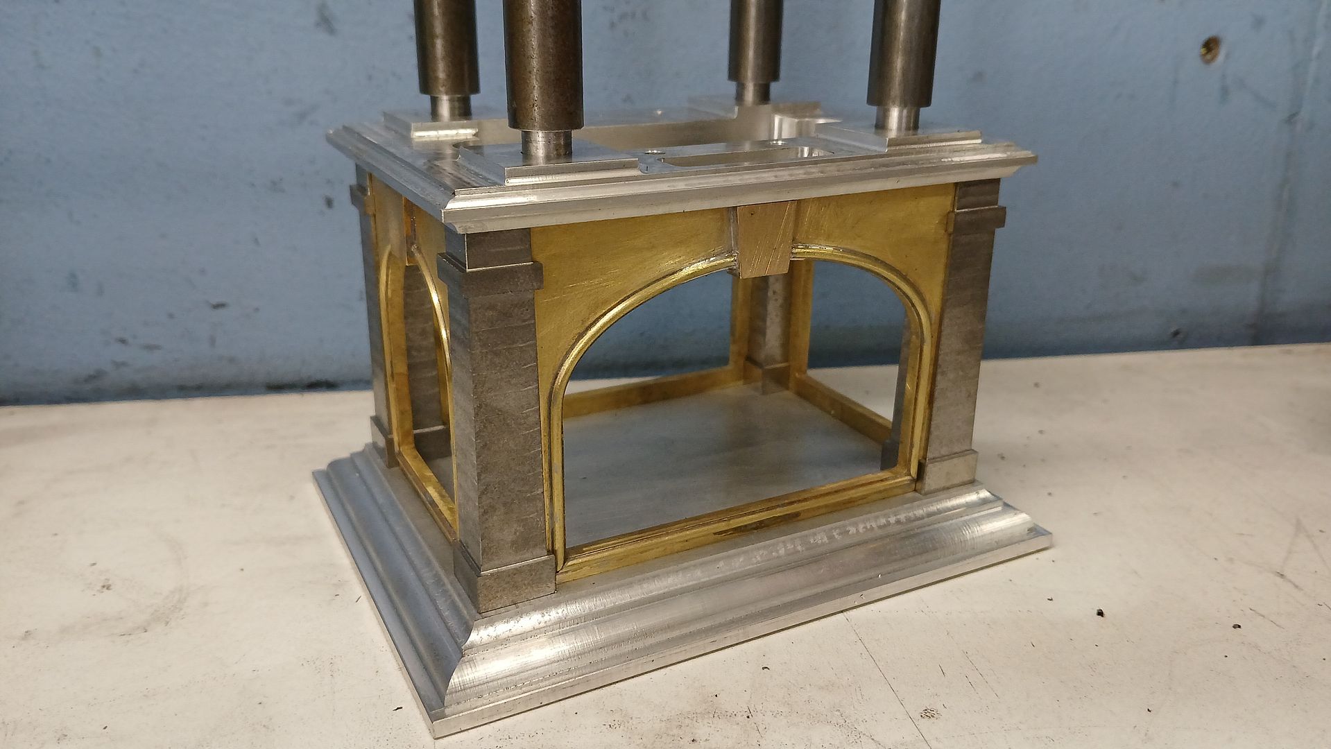

Over a couple of evenings the various parts were drawn up and assembled, had to spend quite  awhile playing with conrod length and cross head guide spacing to make sure the two did not clash but I'm quite happy with the way it looks. I will probably make my own flywheel but the image is with a Stuart one. All metric as is now my norm.

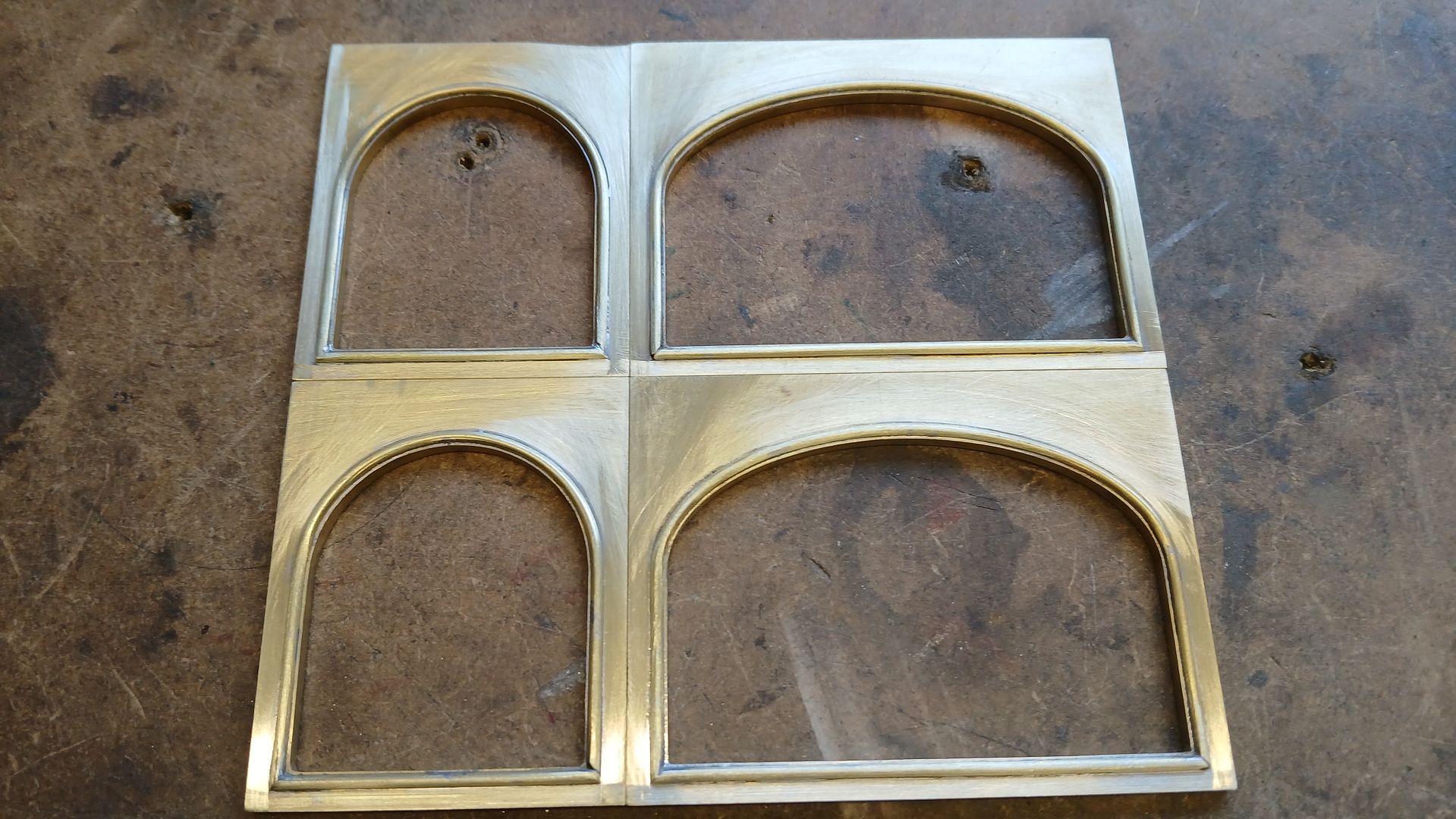

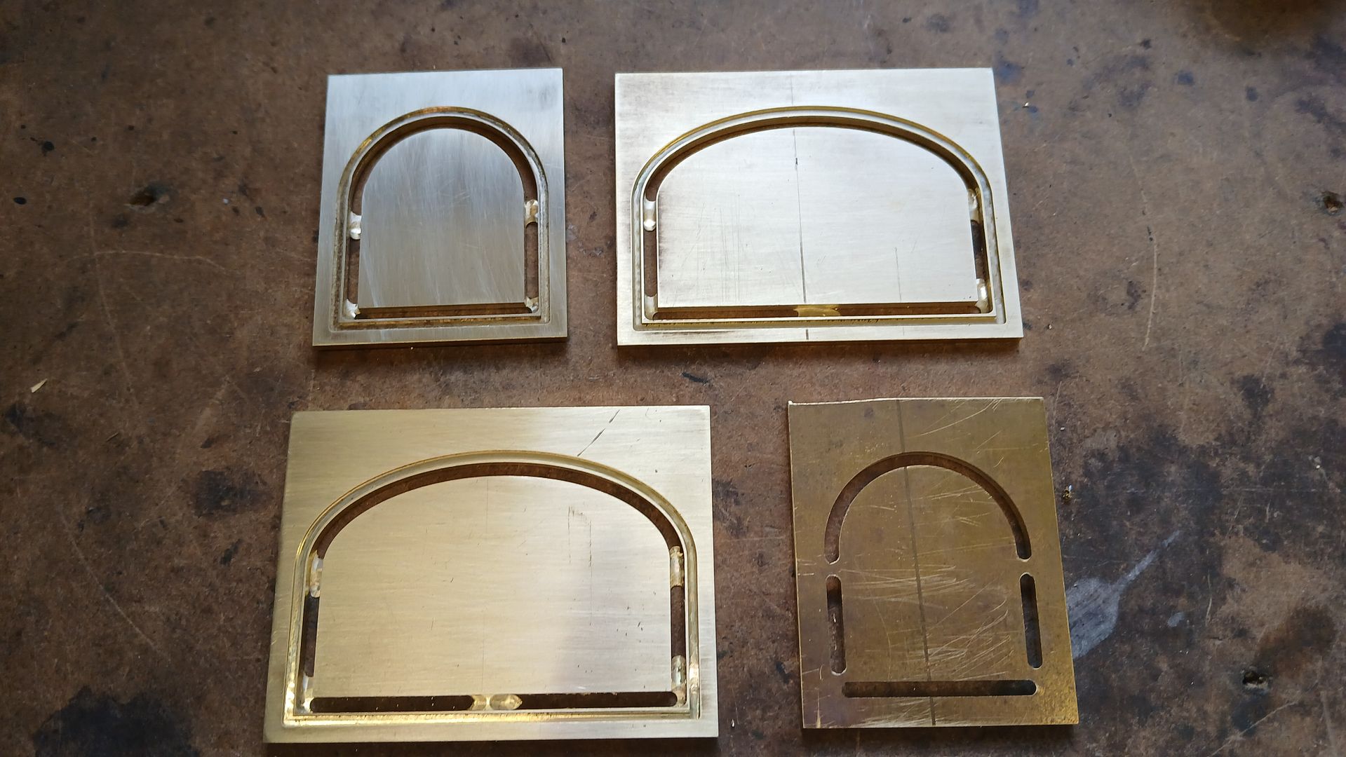

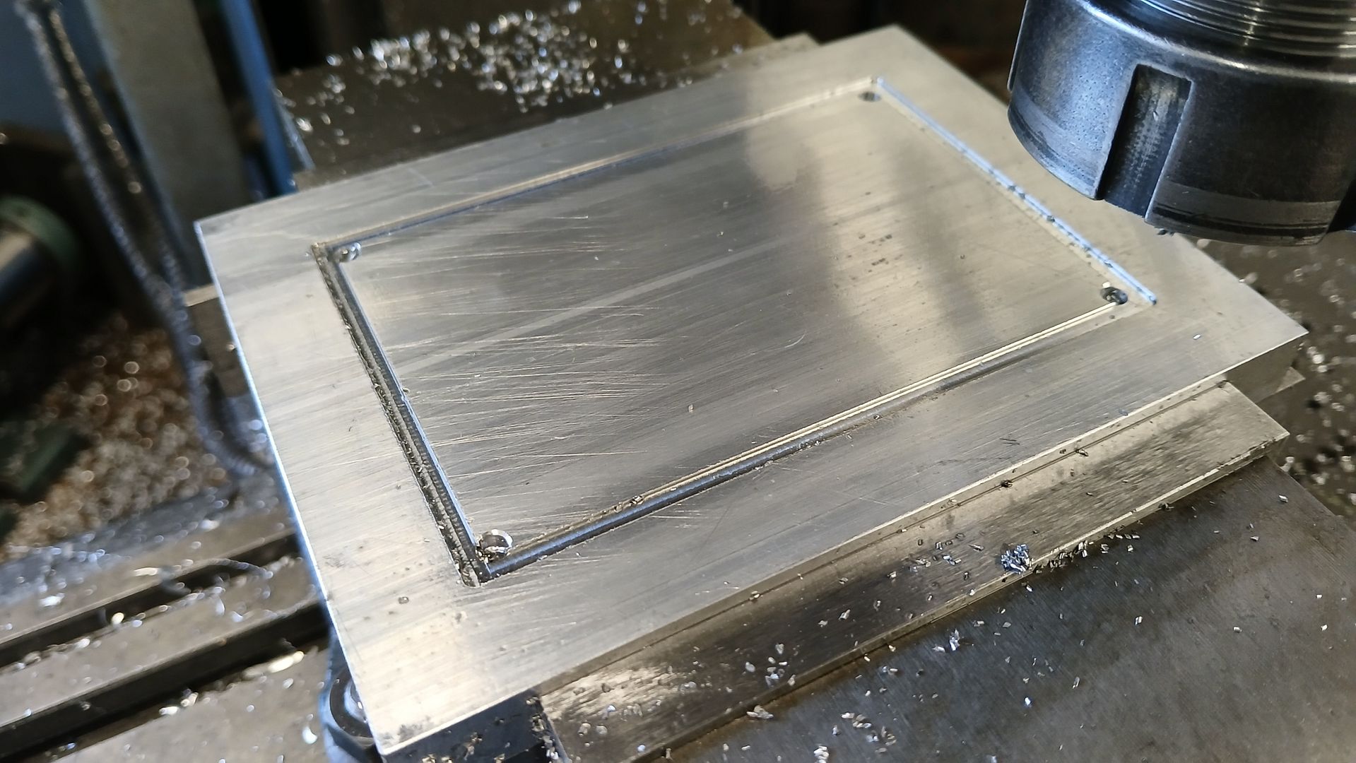

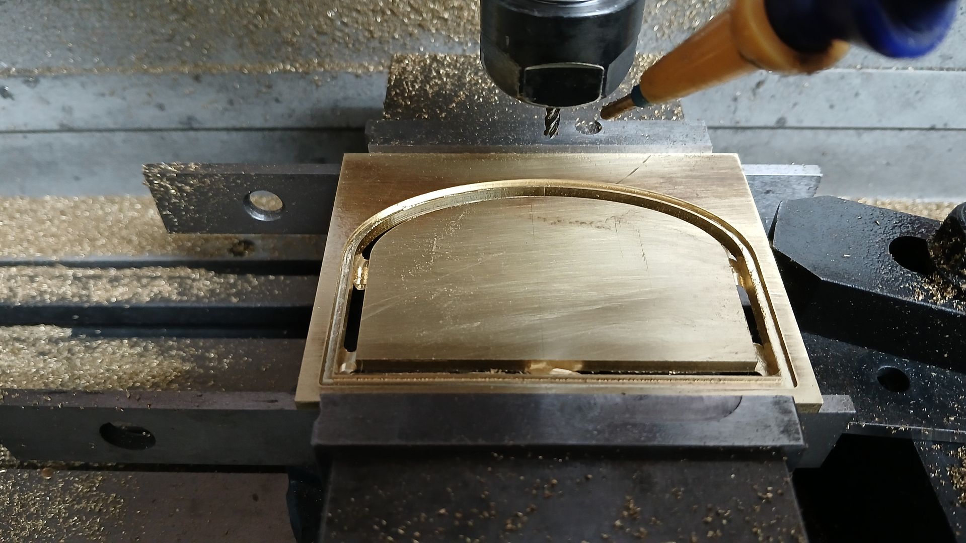

I made a start on the four panels for the base. The usual practice would be to bend up half round beading and fix around the openings. However 1mm radius beading is not available although not hard to make your own and it also has a tendancy to curl up when you want to to lay flat around a curve. Also the beading was set back only 0.5mm from the edge of the openings. After a bit of thought I came up with a cunning plan. Rather than use half round beading I thought I would try milling a 2mm wide x 1mm deep slot and simply solder some 2mm dia brass wire into the slot.
The four plates were sized on the manual mill and then over to the Cuts Nice Curves machine to do the slots and cut out the arched hole.
I use 4 or 5 tabs to retain the waste material rather than risk it coming loose and damaging the cutter or work, they are only 0.75mm high at the peaks so easily sawn through and tidied up with a file.

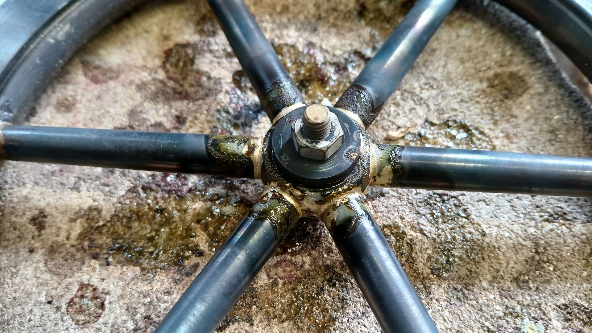

After straightening a length of the 2mm brass wire I filed one end to 45deg for the mitre joint, clamped that end into the slot and it was then easy to push the wire down into the slot with one hand as the other guided it around the arch and back down the other side. Marke and miter the end then just a straight length for the bottom.
A bit of flux and some soft solder fixed it all together then a quick cleanup of the small amount of excess solder and they are ready for the "key stones"

Thanks for the interest. It should make a nice model and a reasonable size at 350mm tall.
I know some have gone over almost exclusively to CNC but I just tend to treat it as another tool and if it is the best one for the job will use it so don't rush to get one. The smaller end panels could have been done on a rotary table and even the wider ones could have had the arch filed and the bead thinned to half thickness for the arch with the straight bits done in the groove.
There will be a few parts that make use of the CNC on this but all could be done in other ways depending on what you have to hand.
Someone on ME mentioned about using the CAd assembly to check for fits, so I made this quick video of what moves where.
<a href="https://www.youtube.com/watch?v=BCFlMAmTENE" target="_blank">http://www.youtube.com/watch?v=BCFlMAmTENE</a>

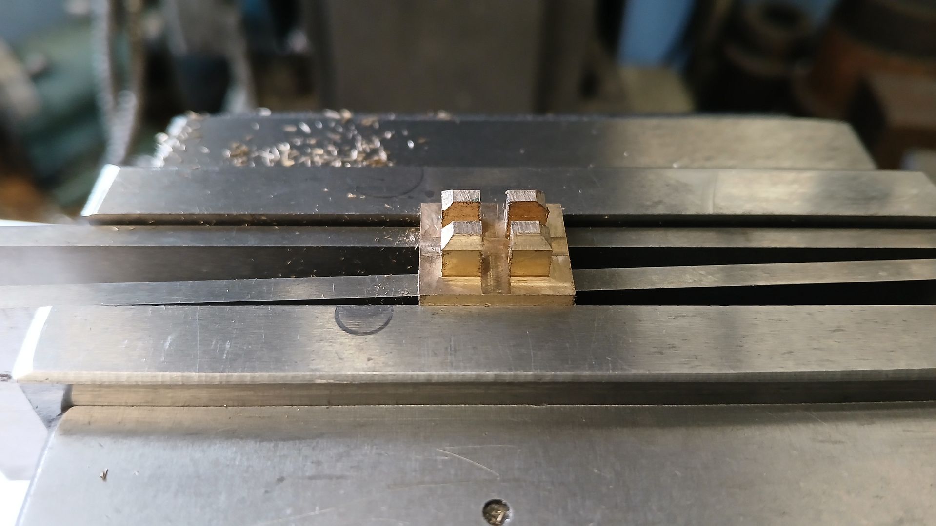

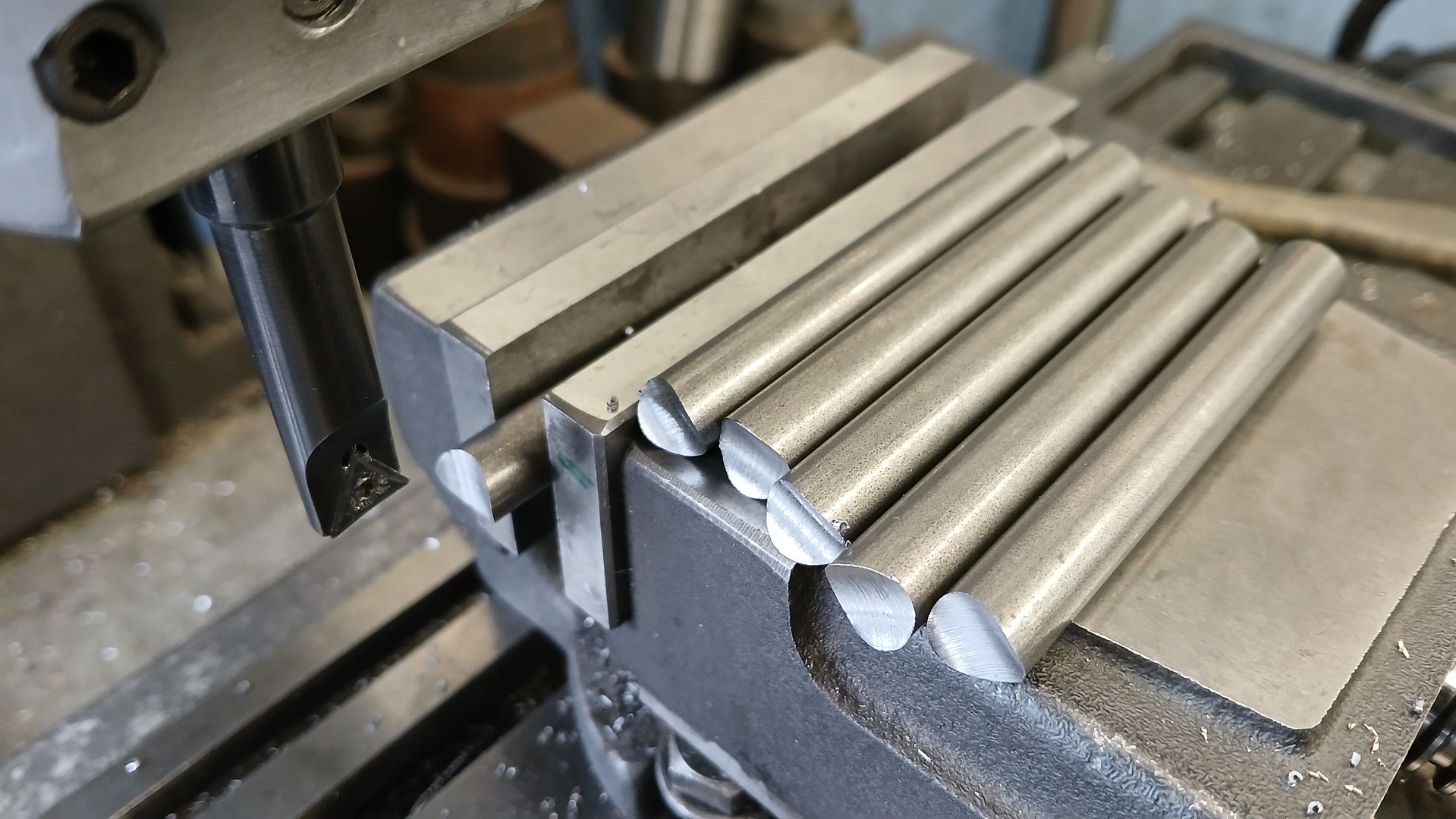

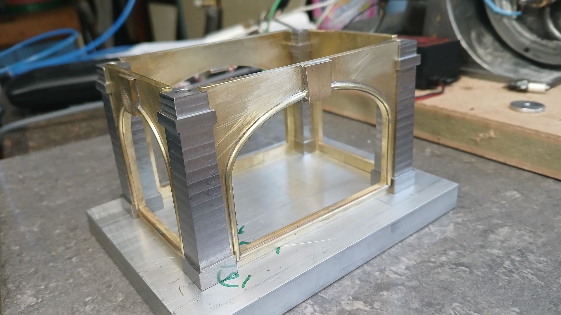

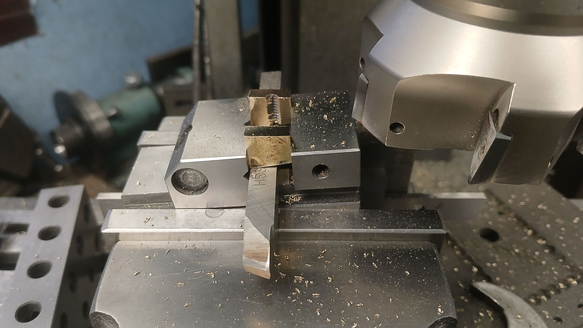

I used up a few scraps of brass for the keystones, first milling to overall size then with a small vice set at 5degrees milled the two tapering sides. After that a rebate wa scut so they slipped over the brass panel, there position was marked on the panel and the bit of beading underneath cut away before soldering into place.
I know they say measure twice and cut once but I measured the 14mm square steel that I had bought for the corner posts 4 times and each was 10mm too short :-[ So I cut up some cast iron and milled it to 14mm square then faced to length ond drilled it lengthways in the 4-jaw.
I milled the lengthways 3mm slots for the panels to go into then tilted the vice 0.75deg to cut the tapering sides and lastly the bead around the top was reduced by 0.5mm all round so it protruded the same 1mm from the face that the base does.
I still need to knock off all the external corners so they look more like castings but a trial fit shows it all goes together OK.
I made a start on the bottom plate. After milling to overall size the holes to attach the corner posts were drilled and a slot cut all round for the panels to just drop into.

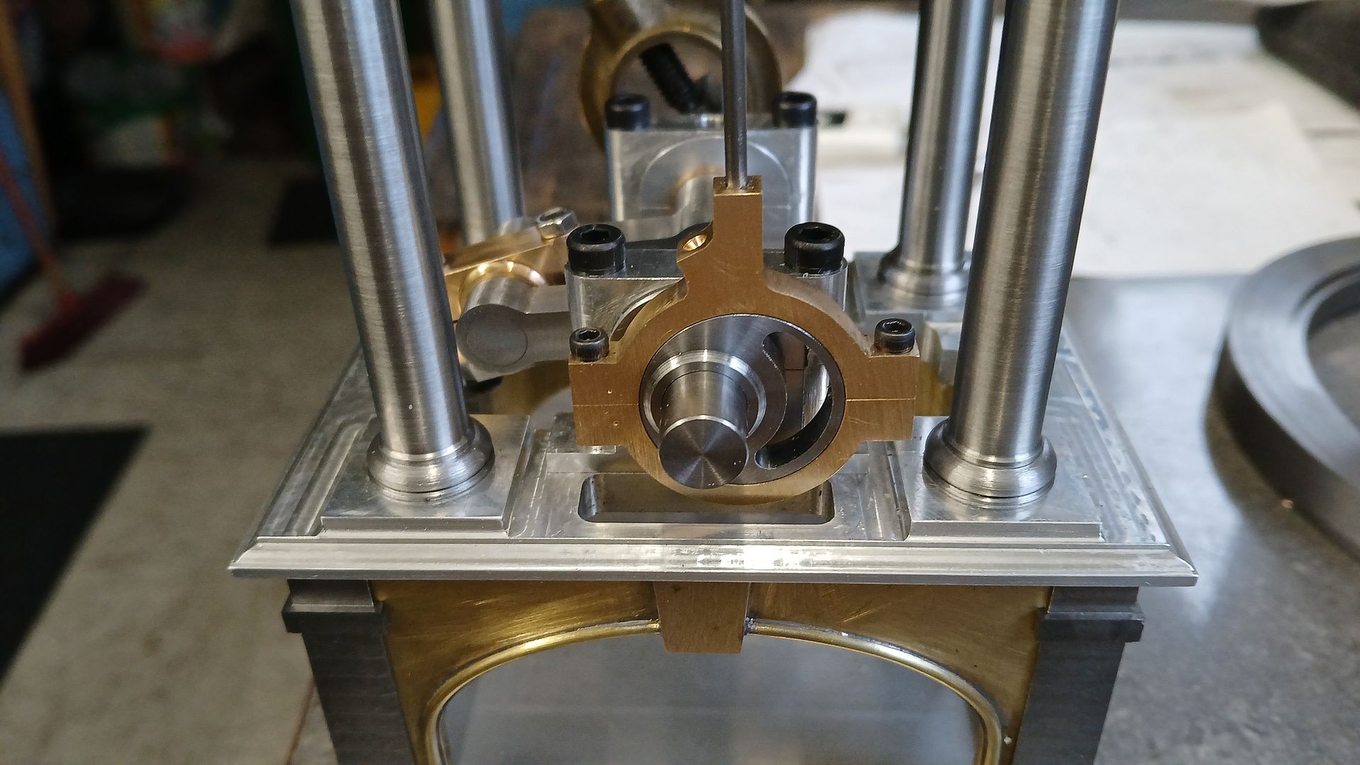

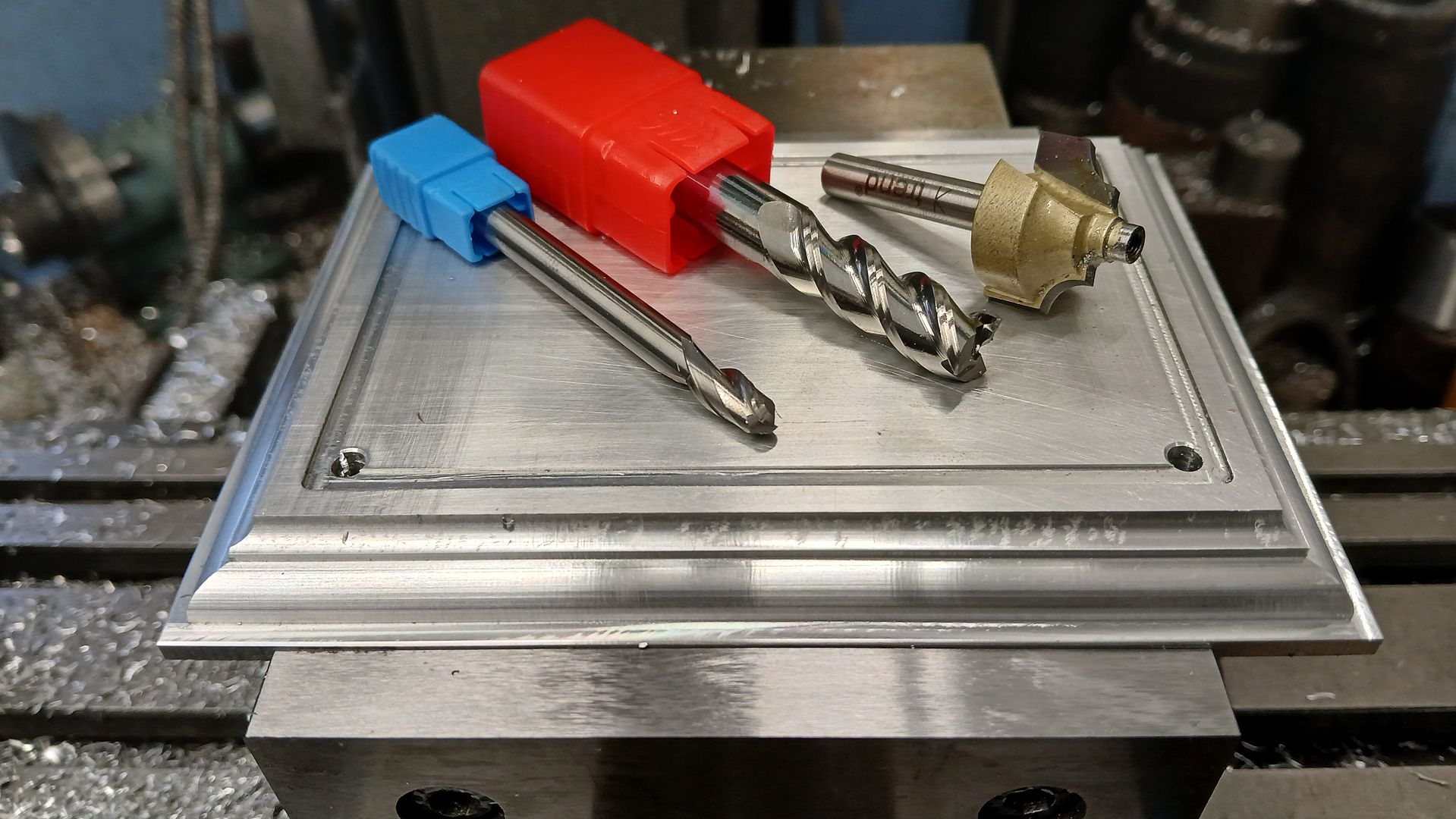

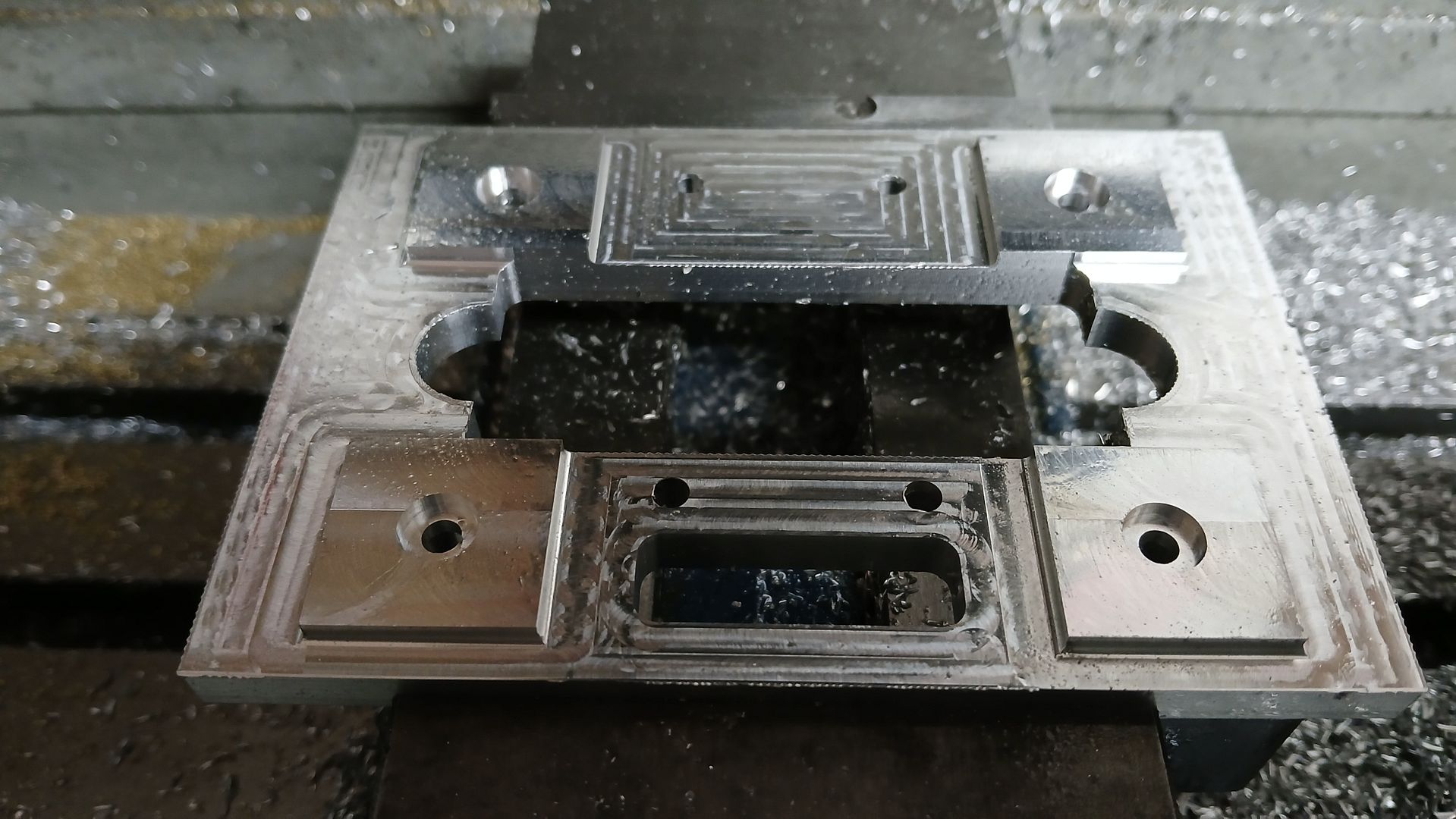

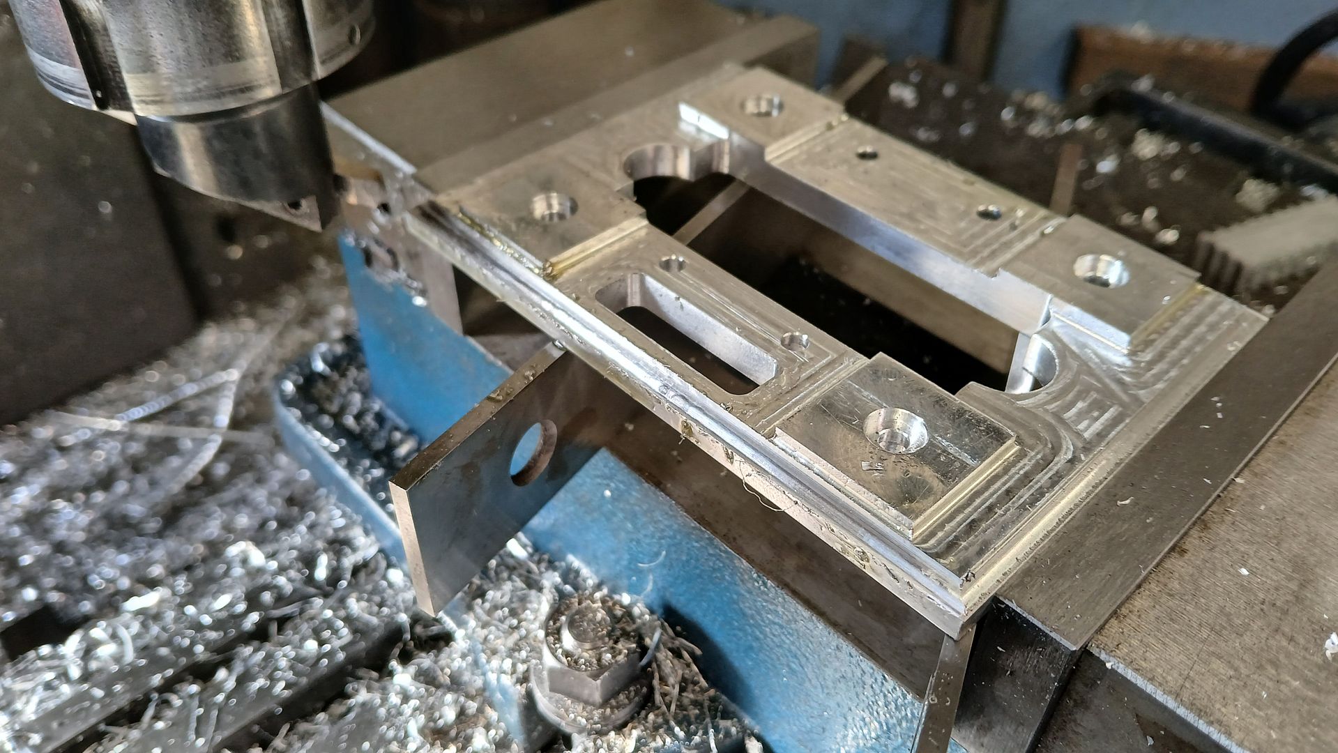

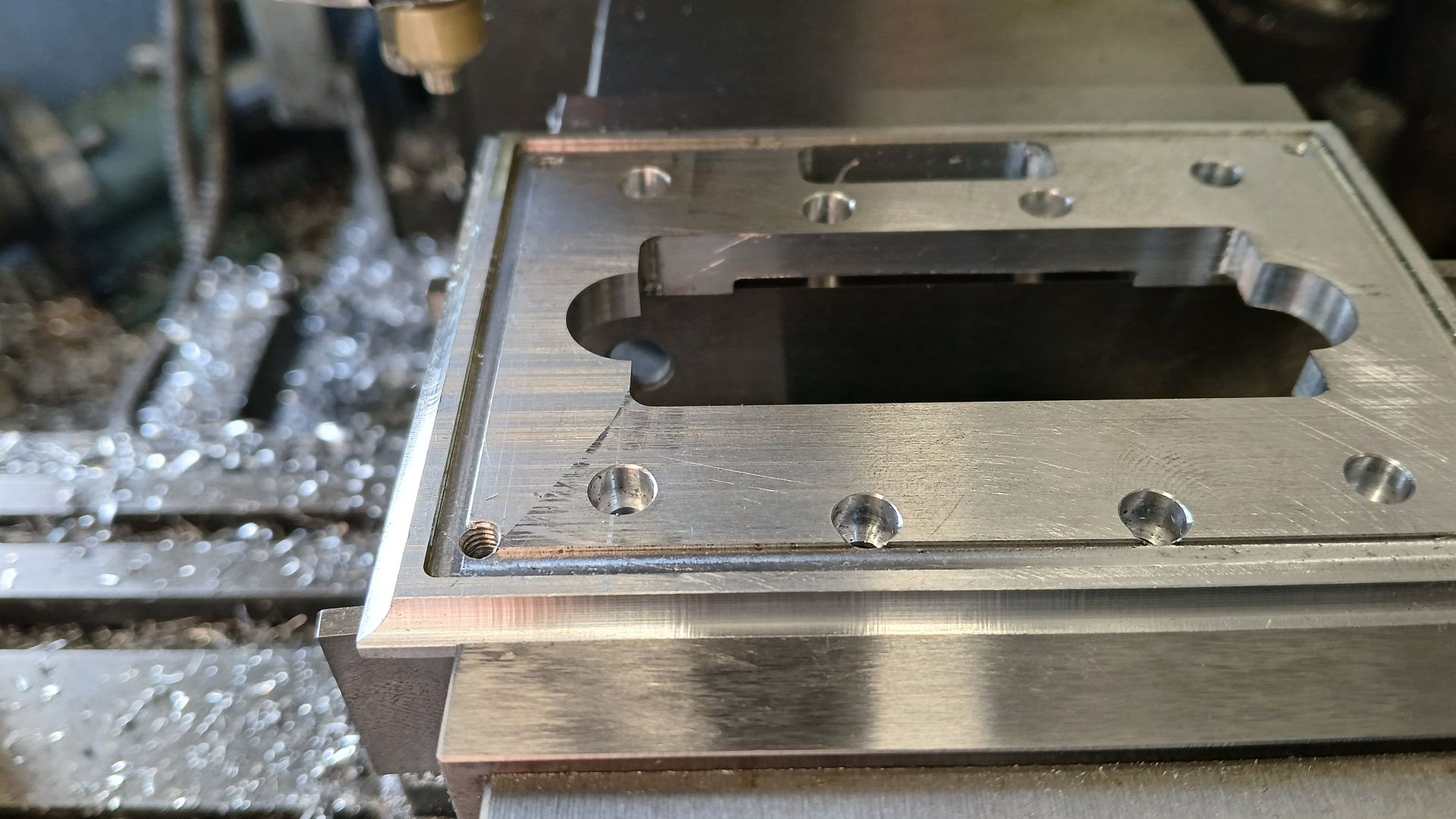

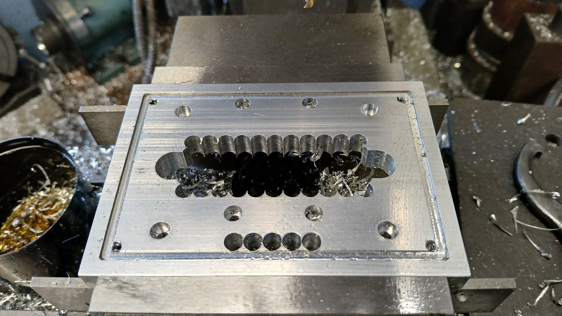

Turning the base plate over I used a 3-Flute aluminium specific cutter to rough out the profile then a 6mm ball nose cutter again intended for alumining to form the concave part of the moulded edge. After that I changed to a TCT rounding over router bit to produce the concave lower part and quirks. All cut very cleanly, this is without any burr removal, just a brush and wipe over.
After squaring up a piece of 3/8 aluminium I cut a similar slot and holes but threaded this time in the underside like I did for the base which will locate the tops of the panels and take long studs that pass through the columns and base to hold everything together. I also drilled and counterbored for some M4 cap heads which will hold the columns and bearing pedestals in place and finally stitch drilled out some of the waste material.
As I've not used the cNC much on the last couple of engines that I have completed I decided to use that to do the work from above which consisted of:
- A facing cut all over with a 25mm 2-insert cutter to reduce the 3/8" stock down to the 8.5mm thickness that I wanted
- multiple full depth contour cut to finish the large central cut out 4mm 3-flute ali cutter
- Adaptive to remove the material around the 4 column bases leaving 0.3mm for finishing with a 6mm 3-flut ali cutter
- Horizontal to finish the lowered areas with a 4-flute 6mm cutter with 1mm radius corner to leave a fillet around the column bases
- Adaptive to rough out the eccentric clearance slot with a 4mm 3-flut ali cutter
- Same cutter to finish contour that slot
- Same cutter again to do the 8mm dia x 2mm deep counter bores to positively locate the column ends.
Finish is better than it looks as the light has made the tool marks look like they are rough but you can't feel anything.
Then back to the manual mill armed with a flycutter and freehand ground HSS bit to do the flat Ovolo moulding around the top edge, not the best photo.
Then a cove cut to the underside with a wood router corebox bit.
I've made a start on the columns, just turning the bottom spigots and drilling and tapping the screw hole in the bottom.
The milled finish looks as it is in this photo without the light reflecting on the machining marks.

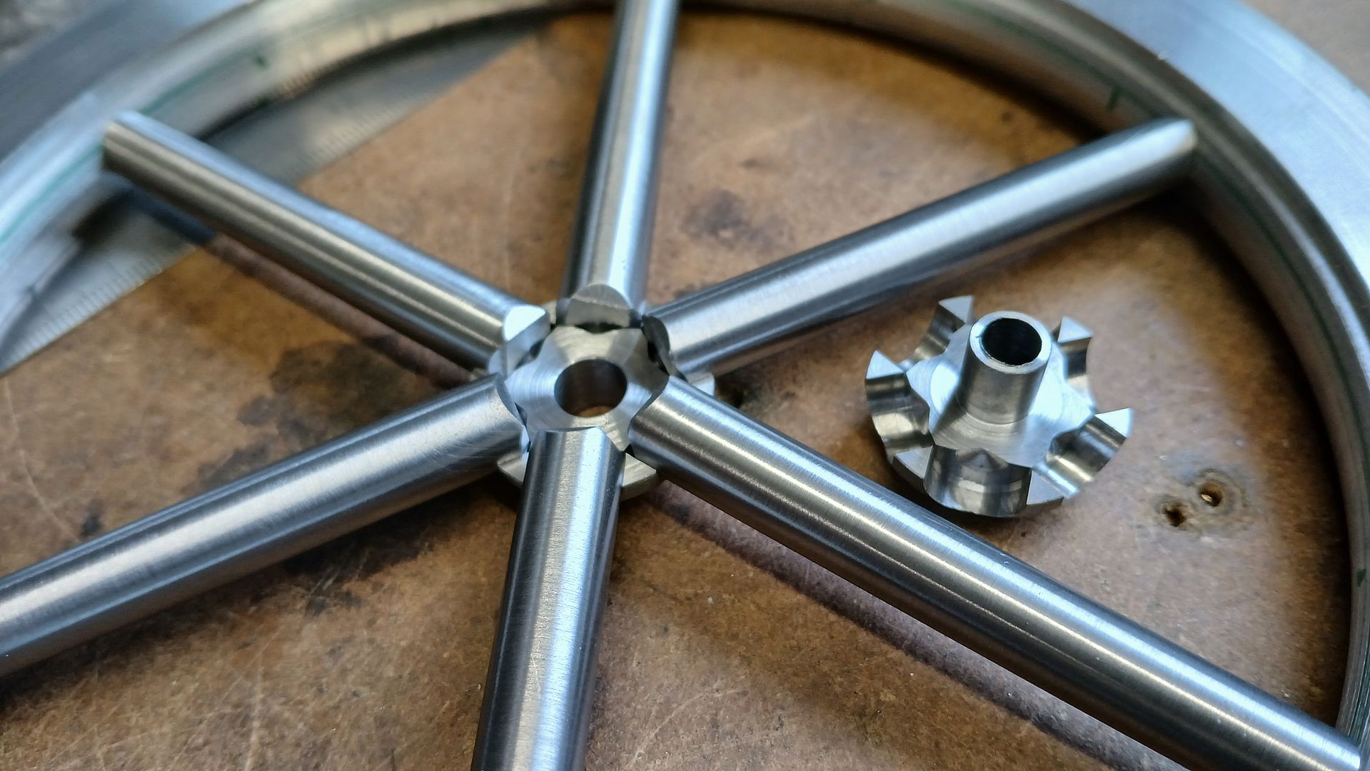

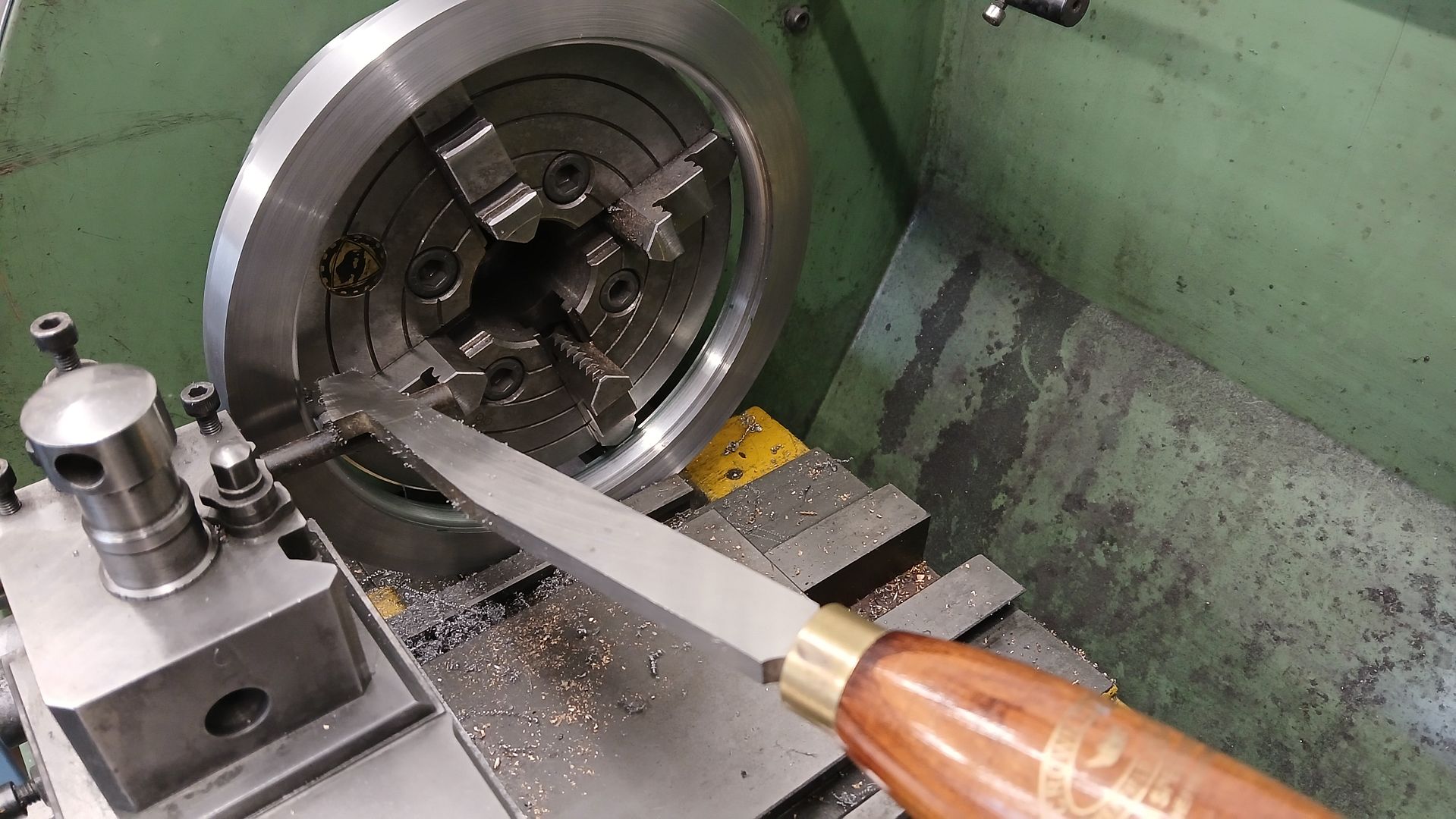

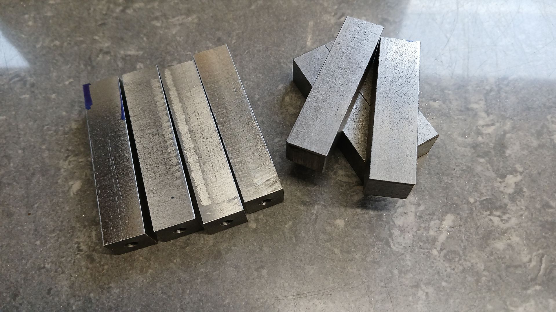

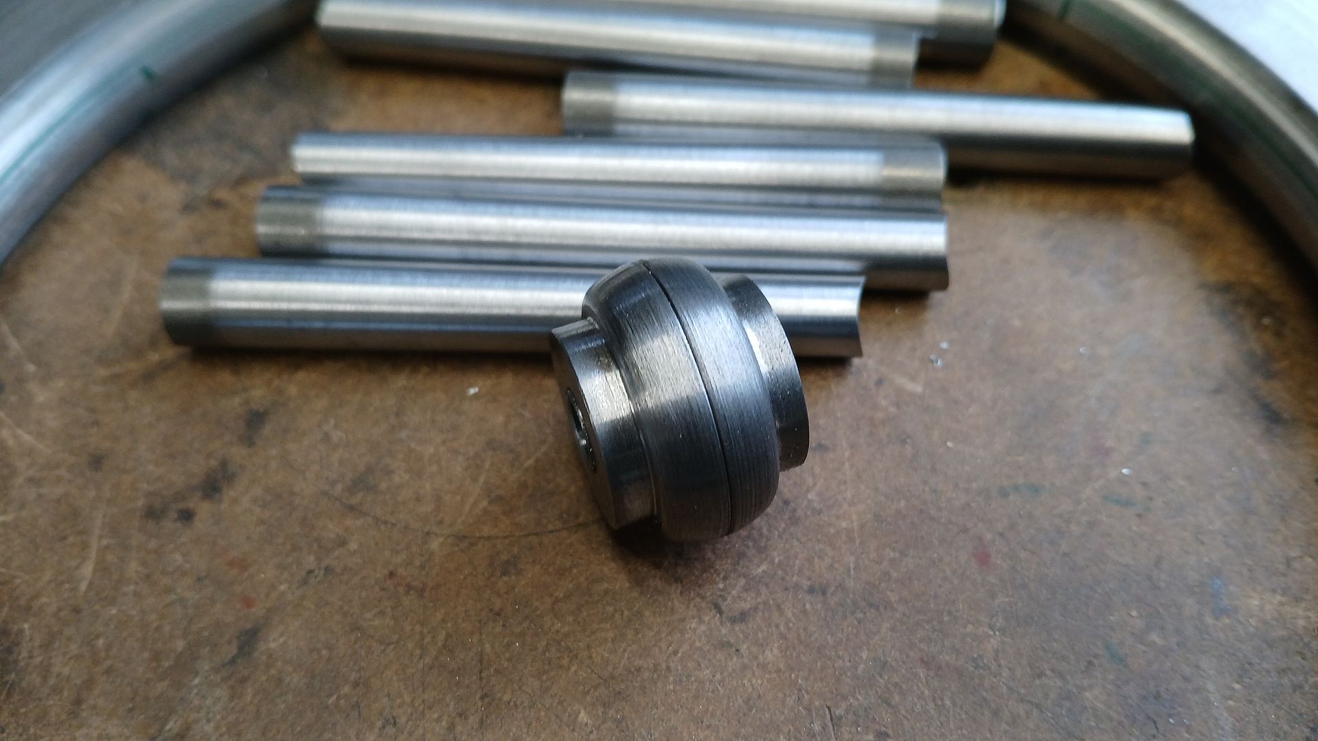

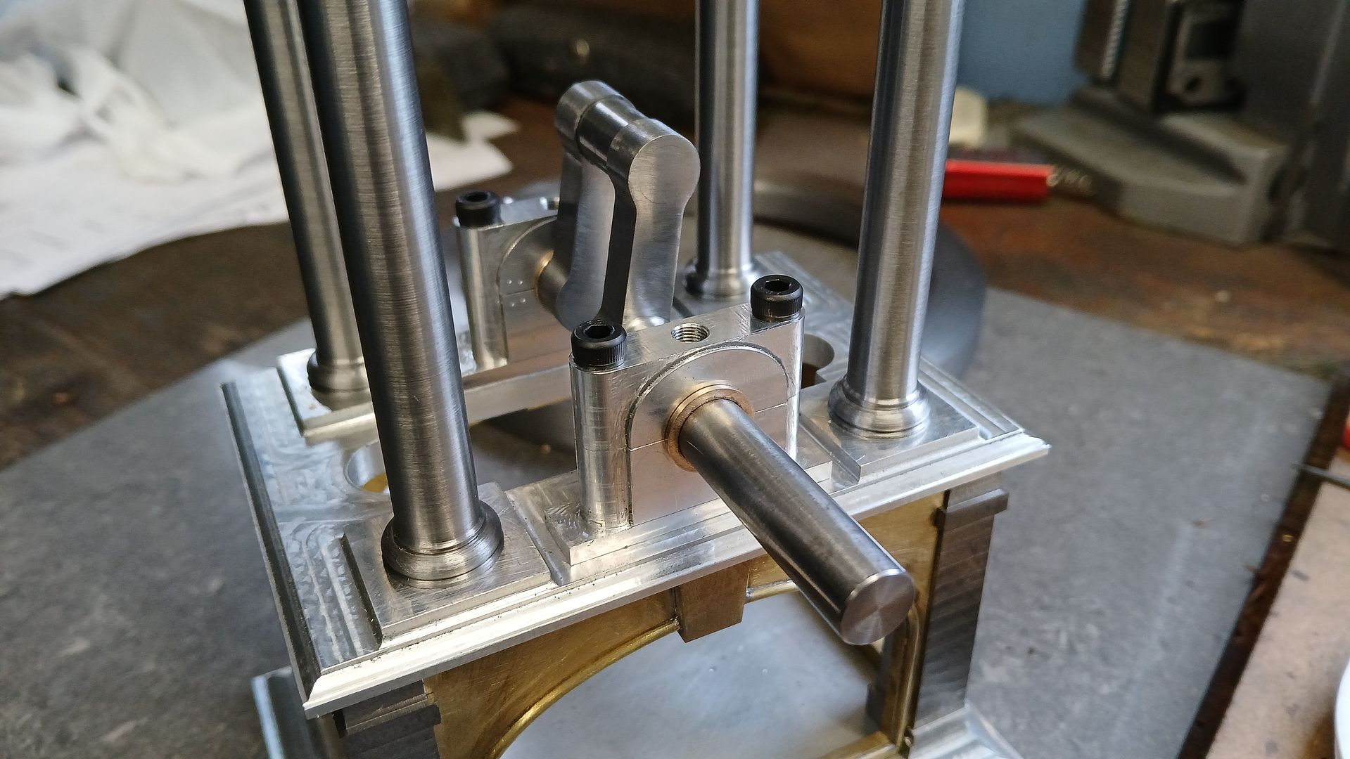

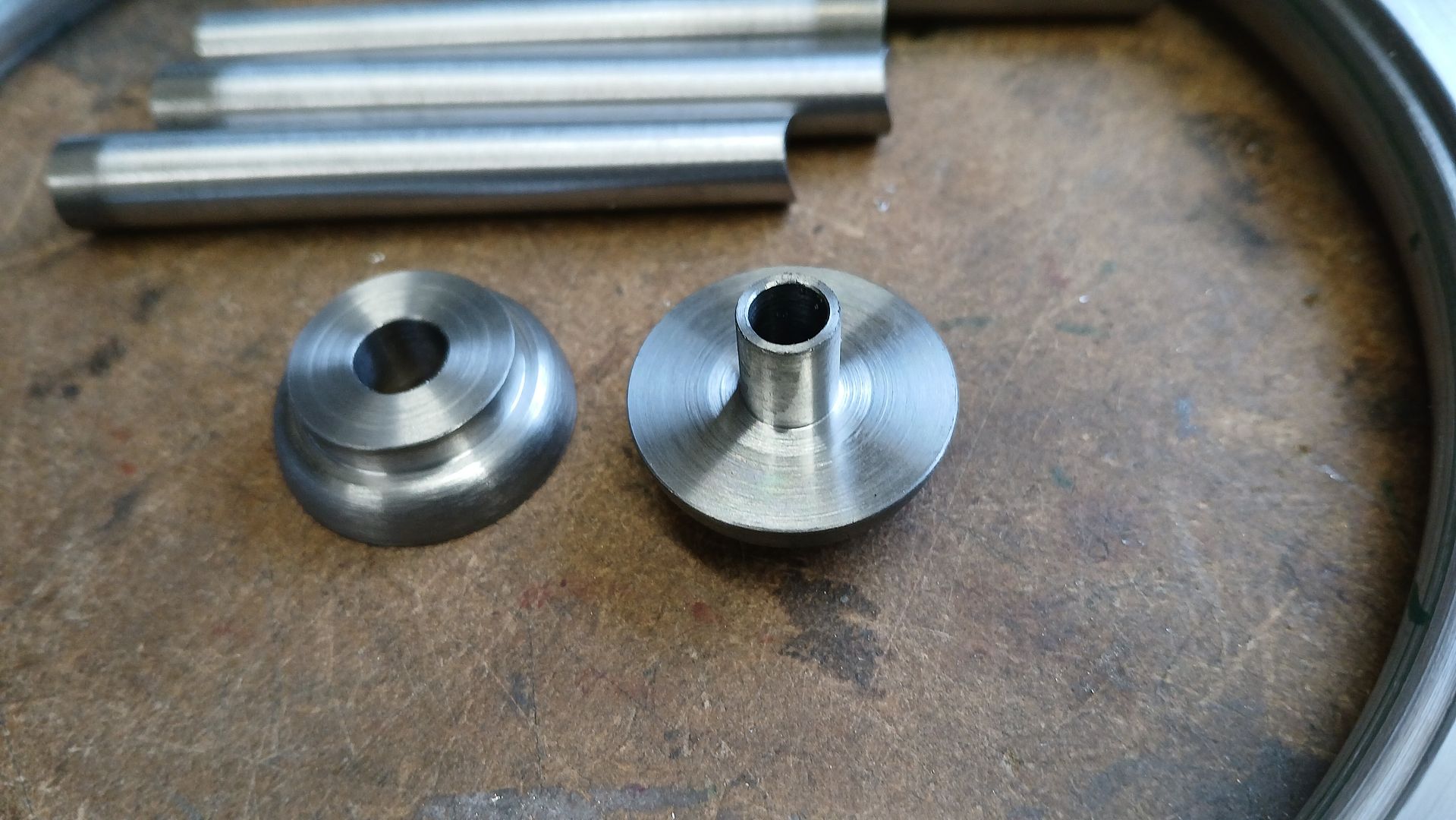

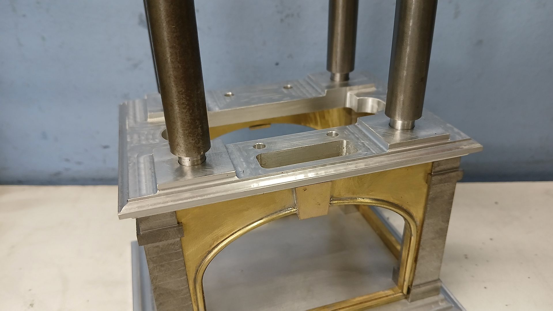

Next job working my way up the engine were the columns. As with other engines to save materials I opted to machine spigots at either end to locate the bases and capitals which were machined separately. I could then hold the 12mm diameter steel by the bottom spigot and with a boring head offset in the tailstock the taper and mouldings could be turned.
The bases and 2 part capitals were fairly straightforward with a mix of form tools and files to create the mouldings on the end of a bar before parting off and repeating the process. The squares were cut from the waste material out of the base end plate arches.
After glueing the bits together with epoxy and allowing a day to set the columns were all machined to one setting ensuring they all came out the same overall length.

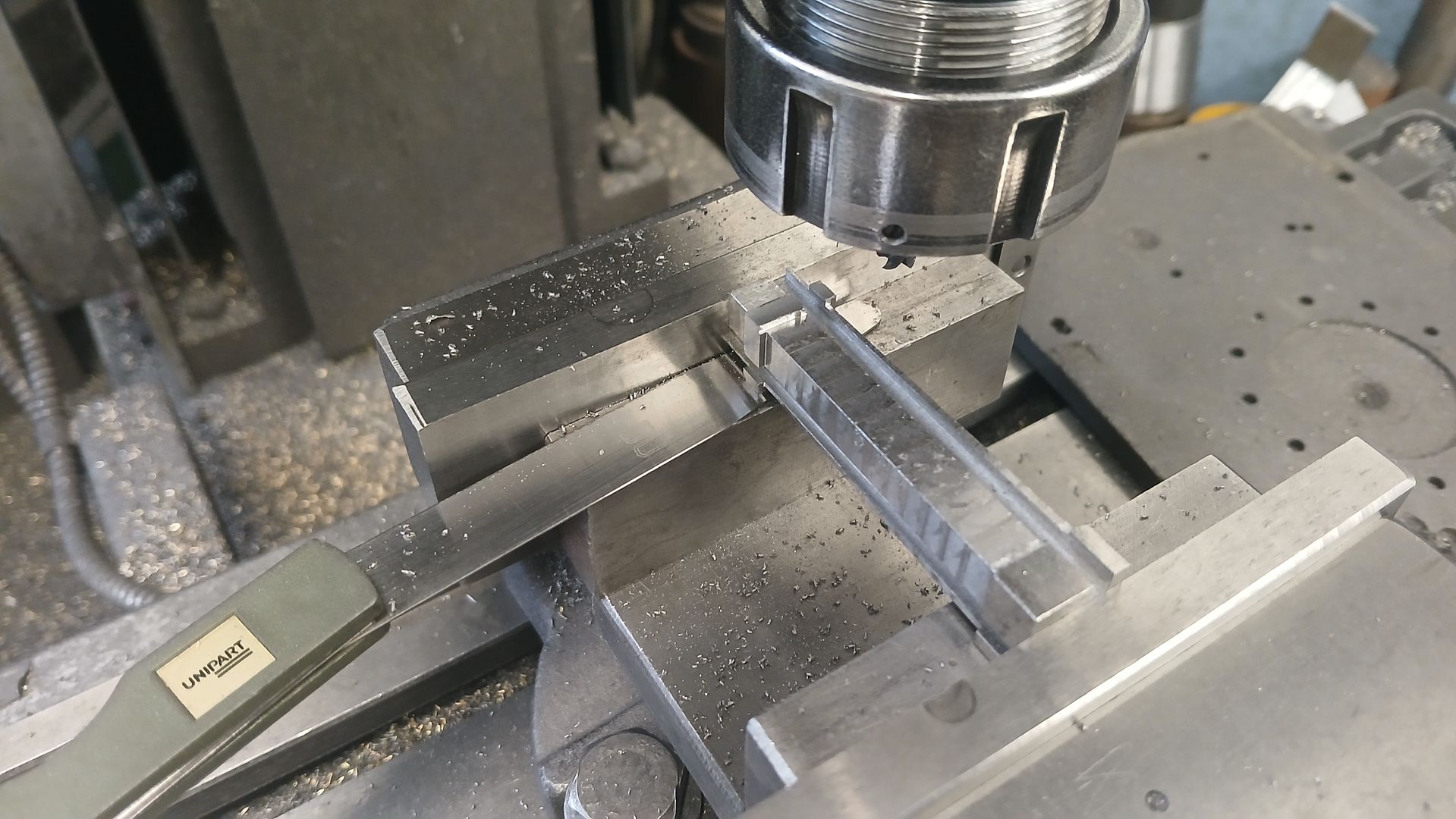

An old aluminium casting was machined up to 7mm thick and to the overall sizes on the manual mill before transferring to the CNC. I used that to form the four raised bosses for the column nuts, to bore the large 39mm dia hole and also drill the other various 3, 4 and 5mm holes.
Then back to the manual mill to cut the coved detail to the underside of the edges
A 7mm hex was milled onto the end of a piece of 8mm dia round and then a form tool from a previous job was repurposed to form the acorn nuts which were then sawn off, faced and tapped M4.
Starting to look more like an engine.

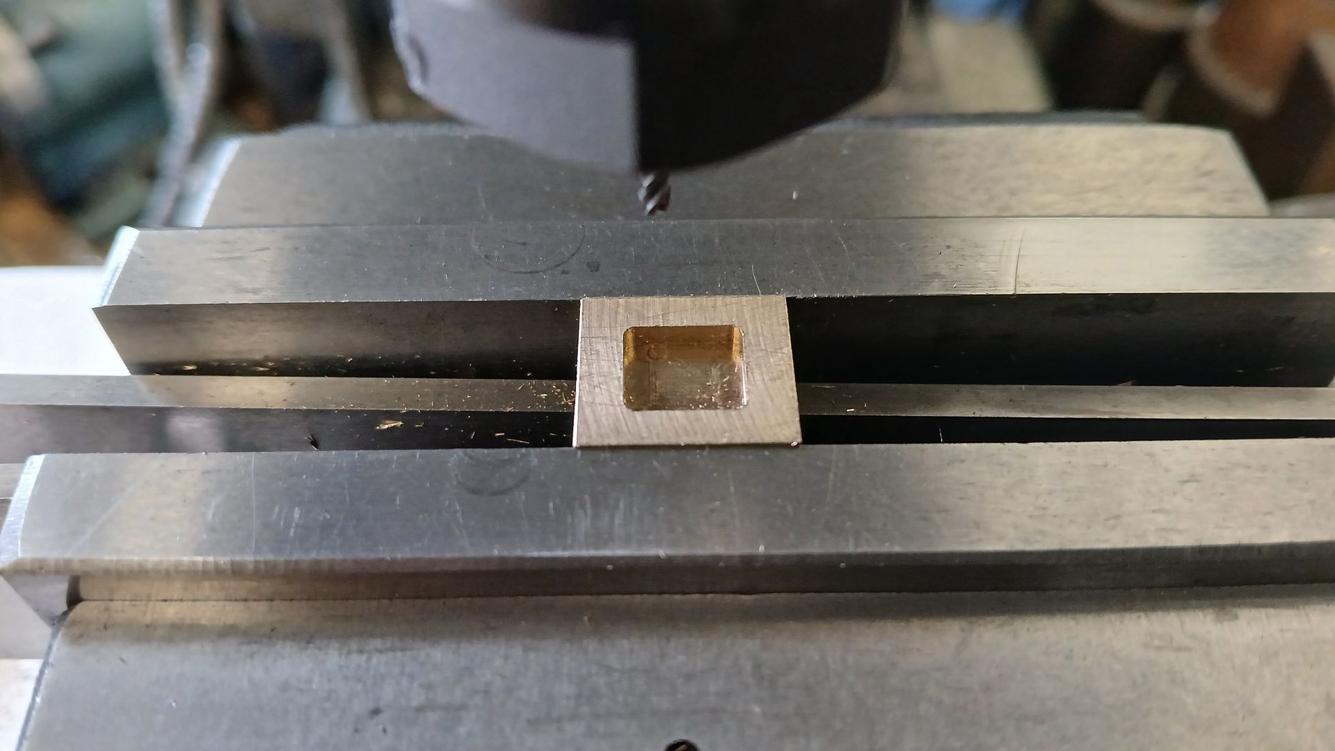

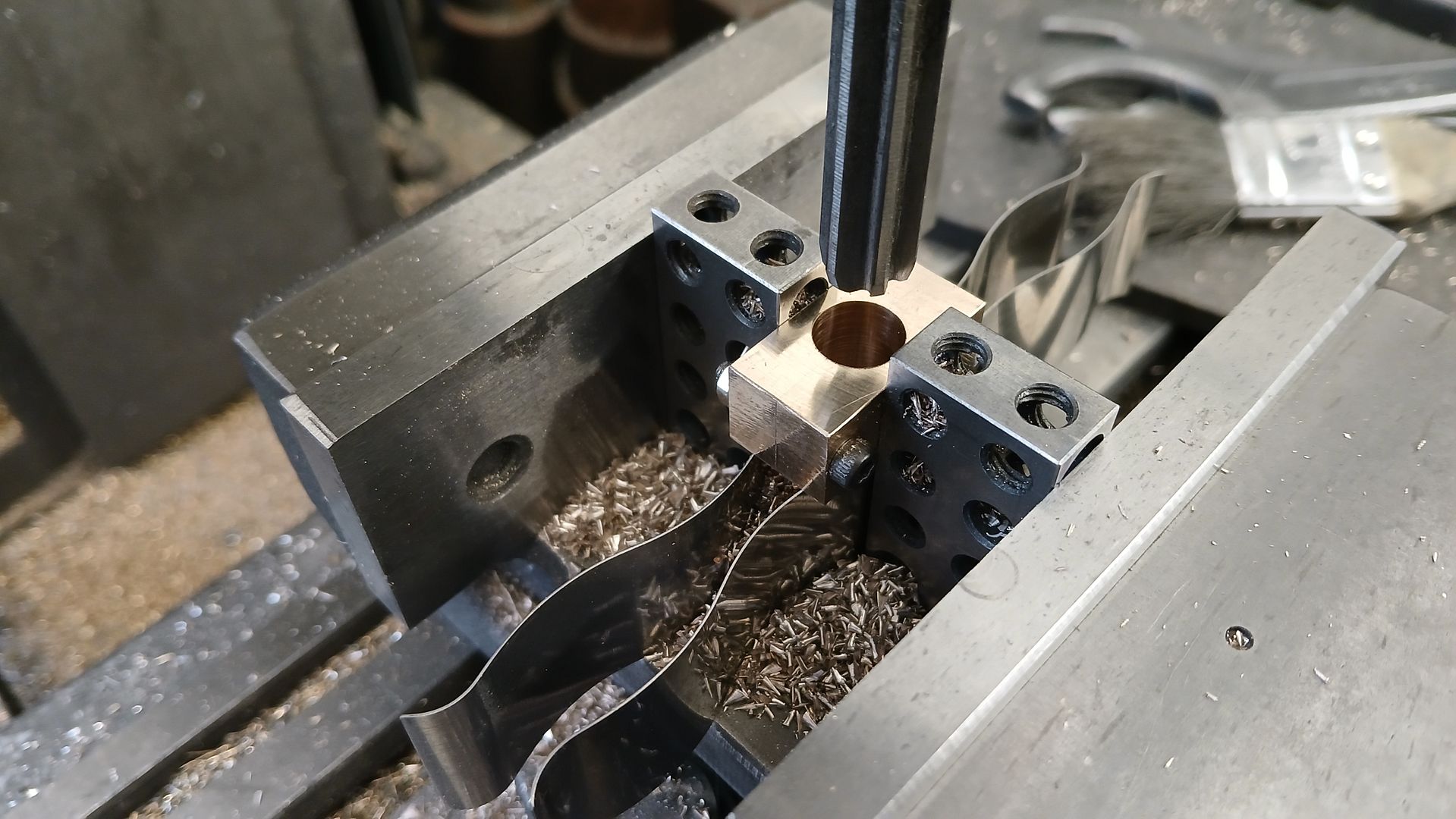

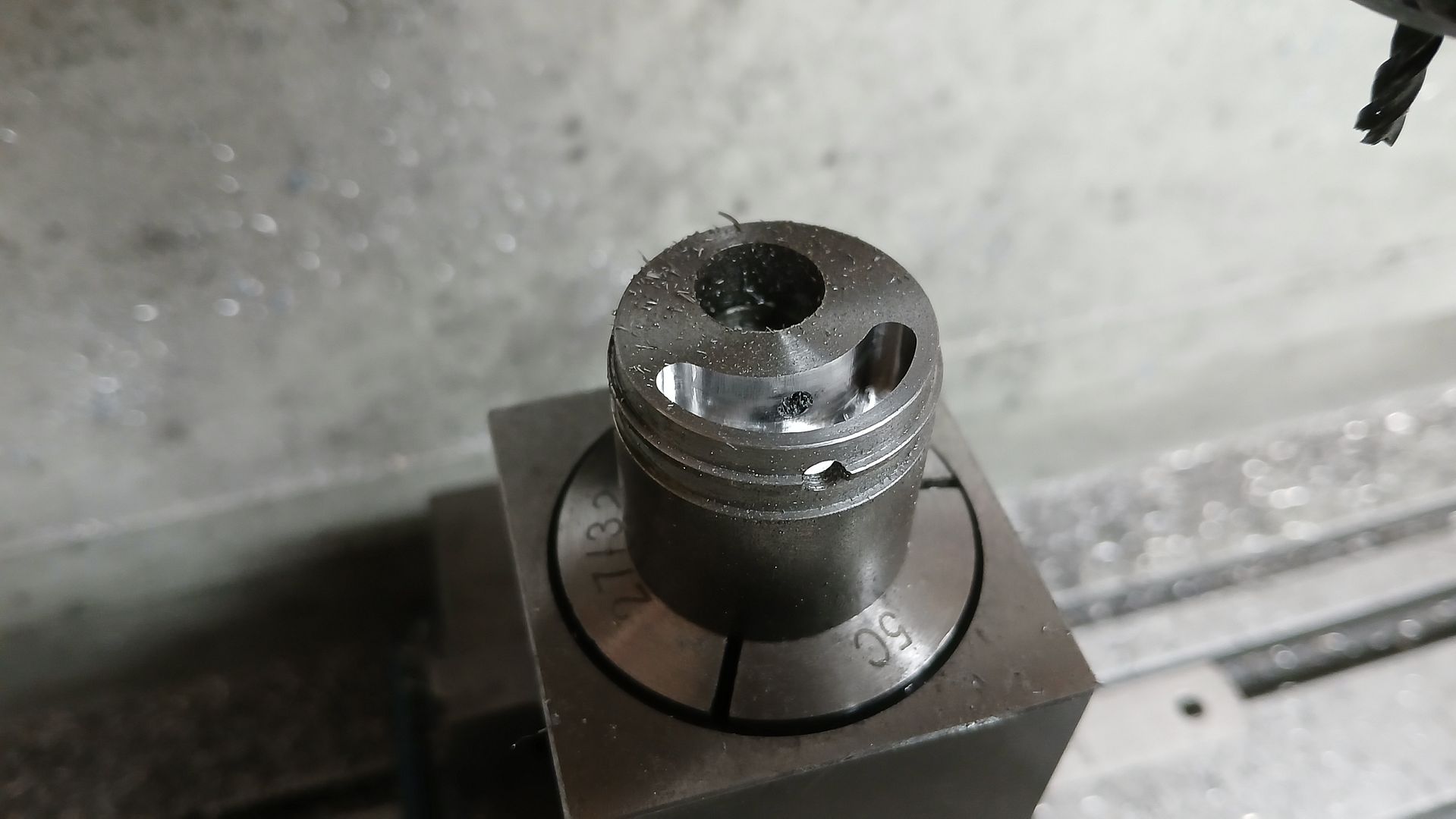

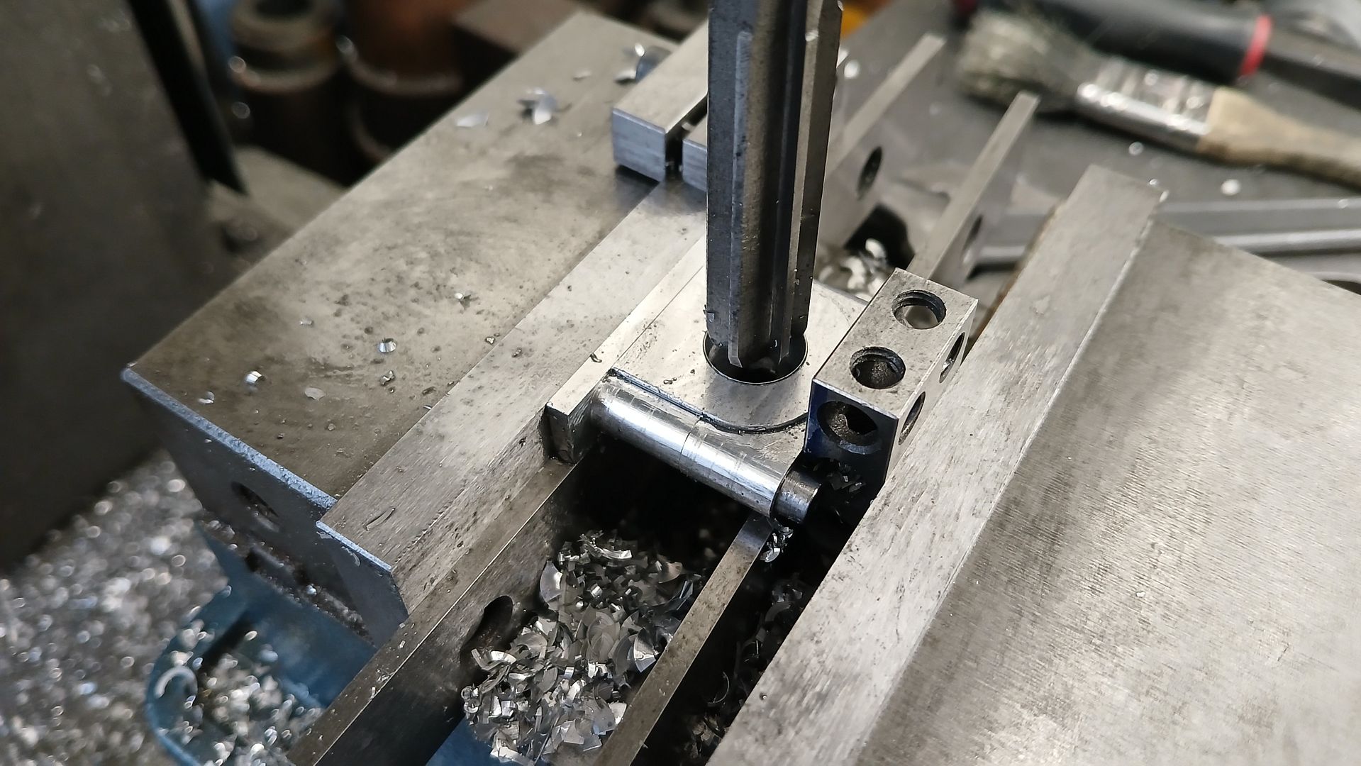

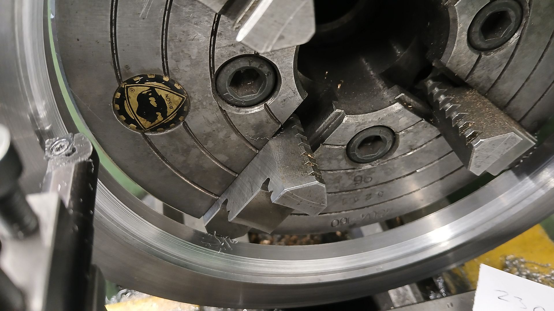

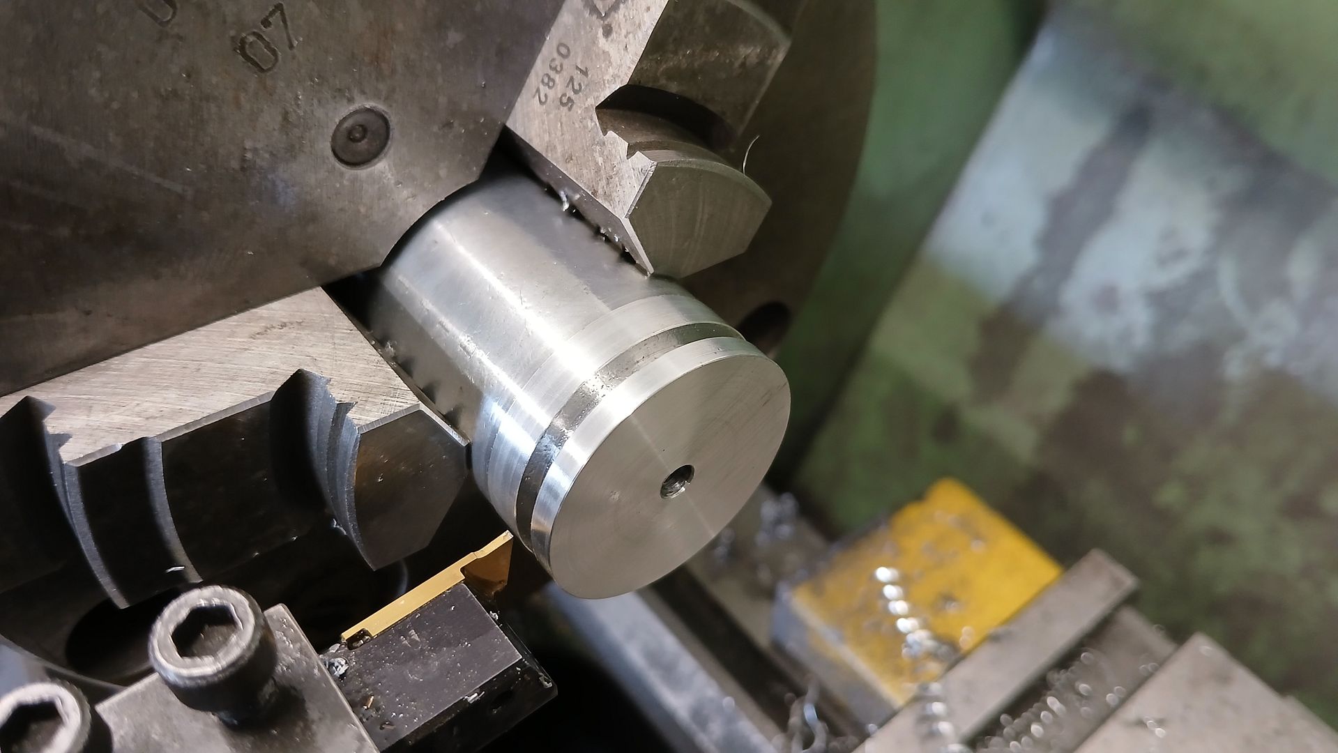

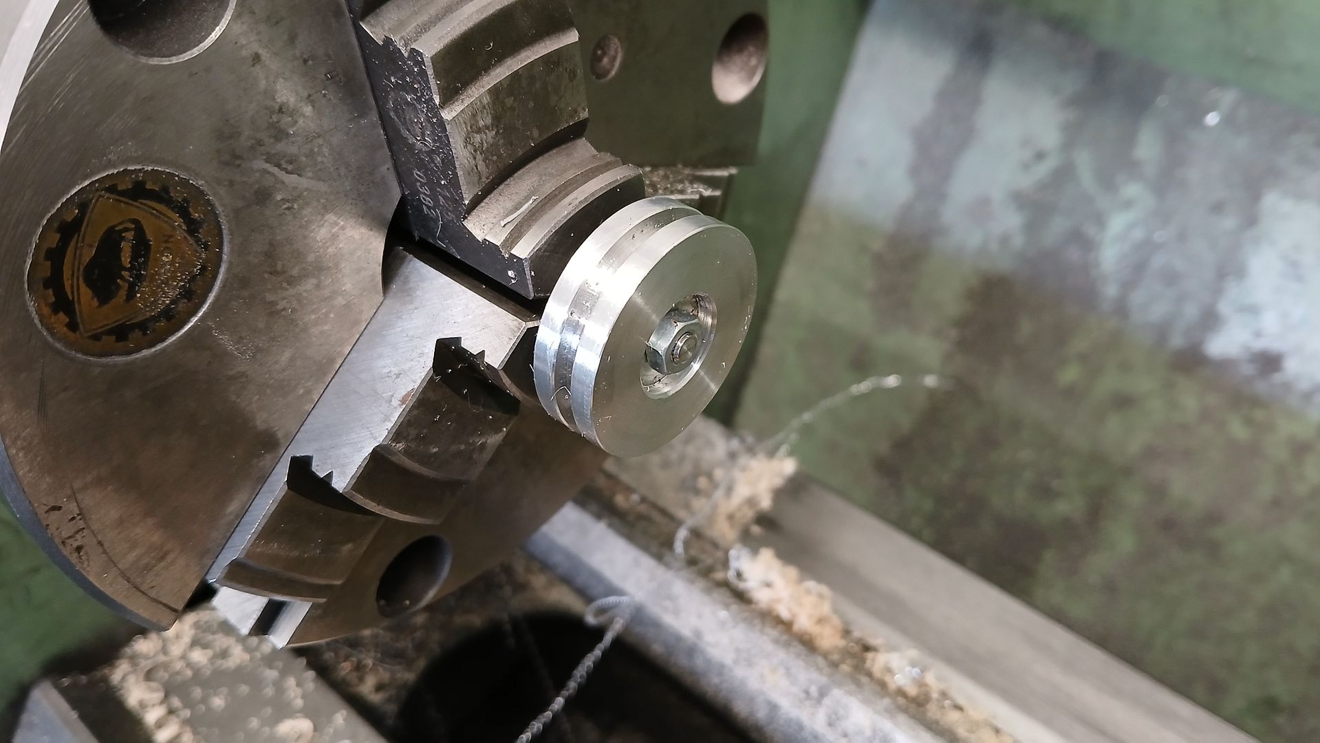

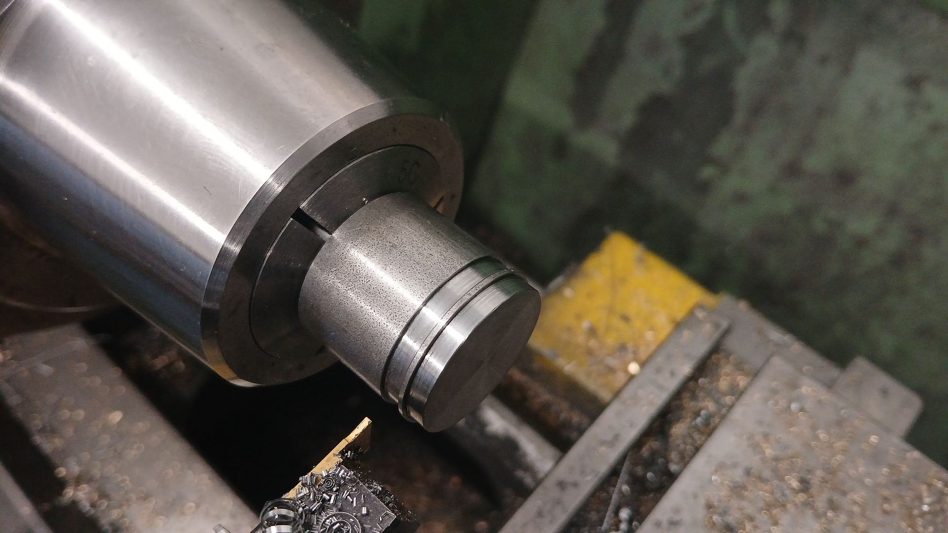

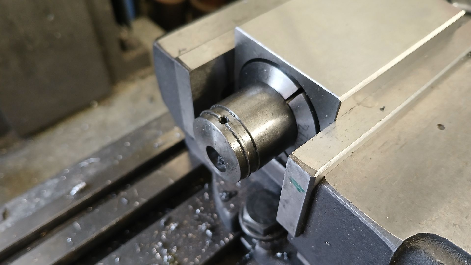

I was in two minds whether to fabricate the cylinder from Brass and Bronze using silver solder to hold it together or to JB Weld fewer pieces of cast iron. In the end the cast iron option was the one I went for.
A piece of 50mm bar was roughed out externally, faced and then bored to 30mm diameter.
I then used a parting and grooving tool to set out the position and depth of the various diameters that would become the flanges and decorative beads.
Further cuts with this tool removed most of the waste material and also cut the 1mm x 1mm step either side of the beads.
I then made a form tool from silver steel to form the 2mm radius beads around the cylinder.
A round nose tool took care of the stepped fillets at each end to complete the turning.
With the cylinder held horizontally a flat was machined to locate the central port face and also two blocks that would form the steam passages to each end of the cylinder which you can see sitting in place.
The inner face of these blocks and that of the port plock were milled out to form the passages and some further work done on the port block to form the undercuts and the exhaust boss. These were all then bonded into the slot with JB Weld and given 48hrs to set.
The port face could then be skimmed flat, the ports milled with a 2mm dia cutter and the stud holes drilled and tapped.
Each end had it's pattern of holes drilled and tapped and a notch was milled to link the passages to the cylinder.

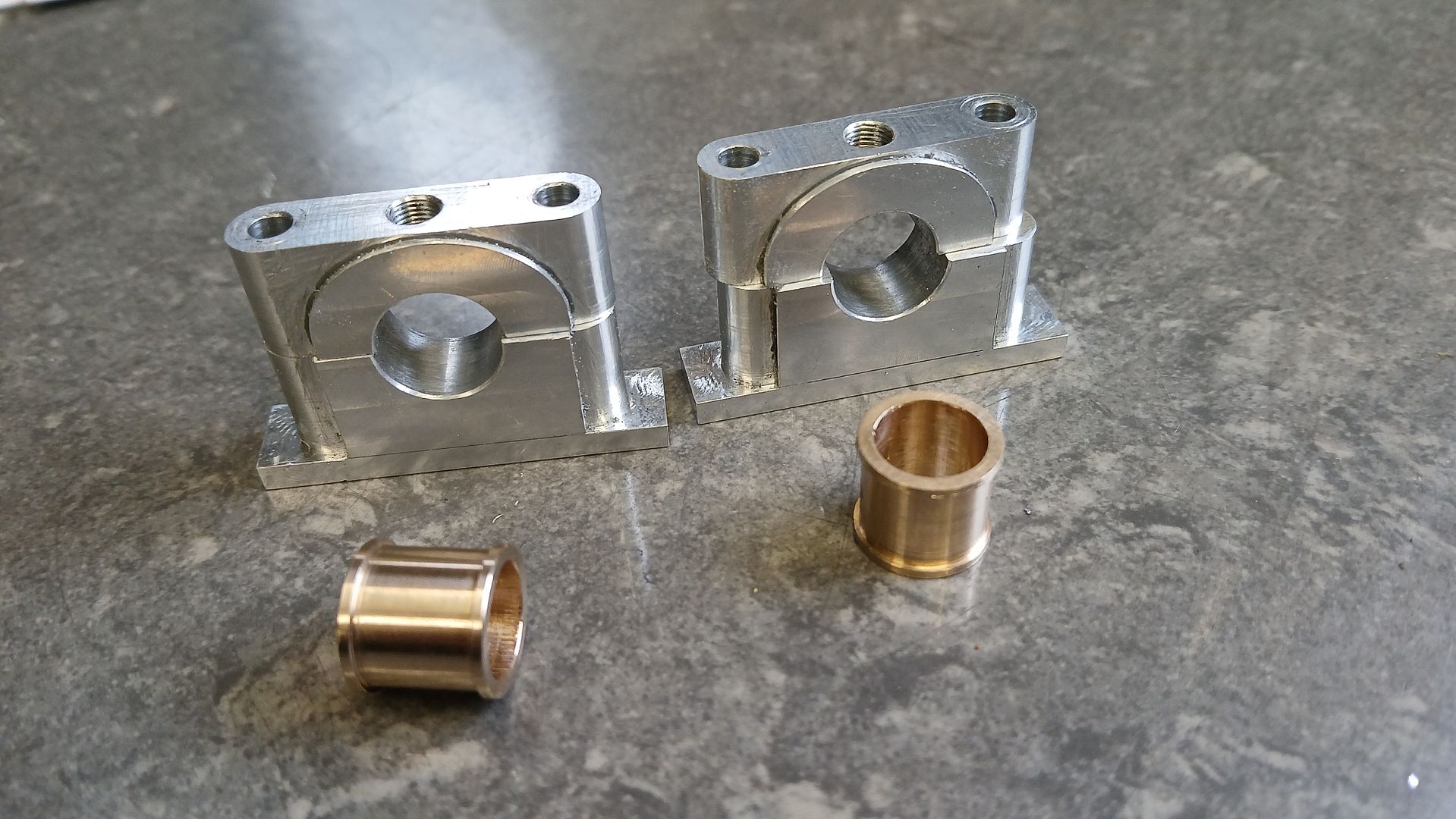

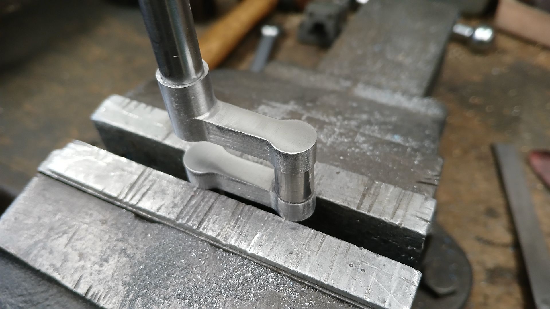

Thanks for the comments from those following along.

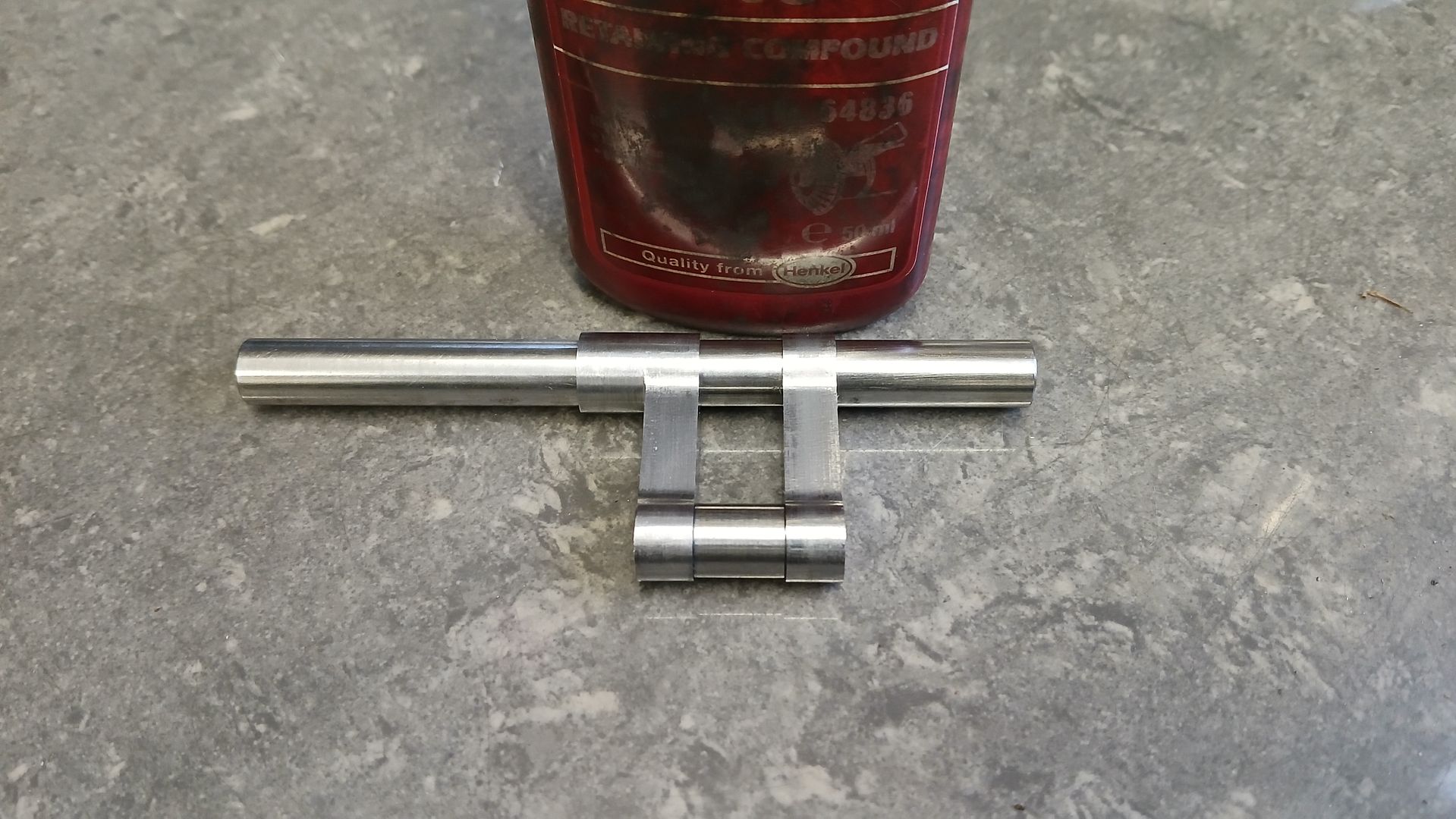

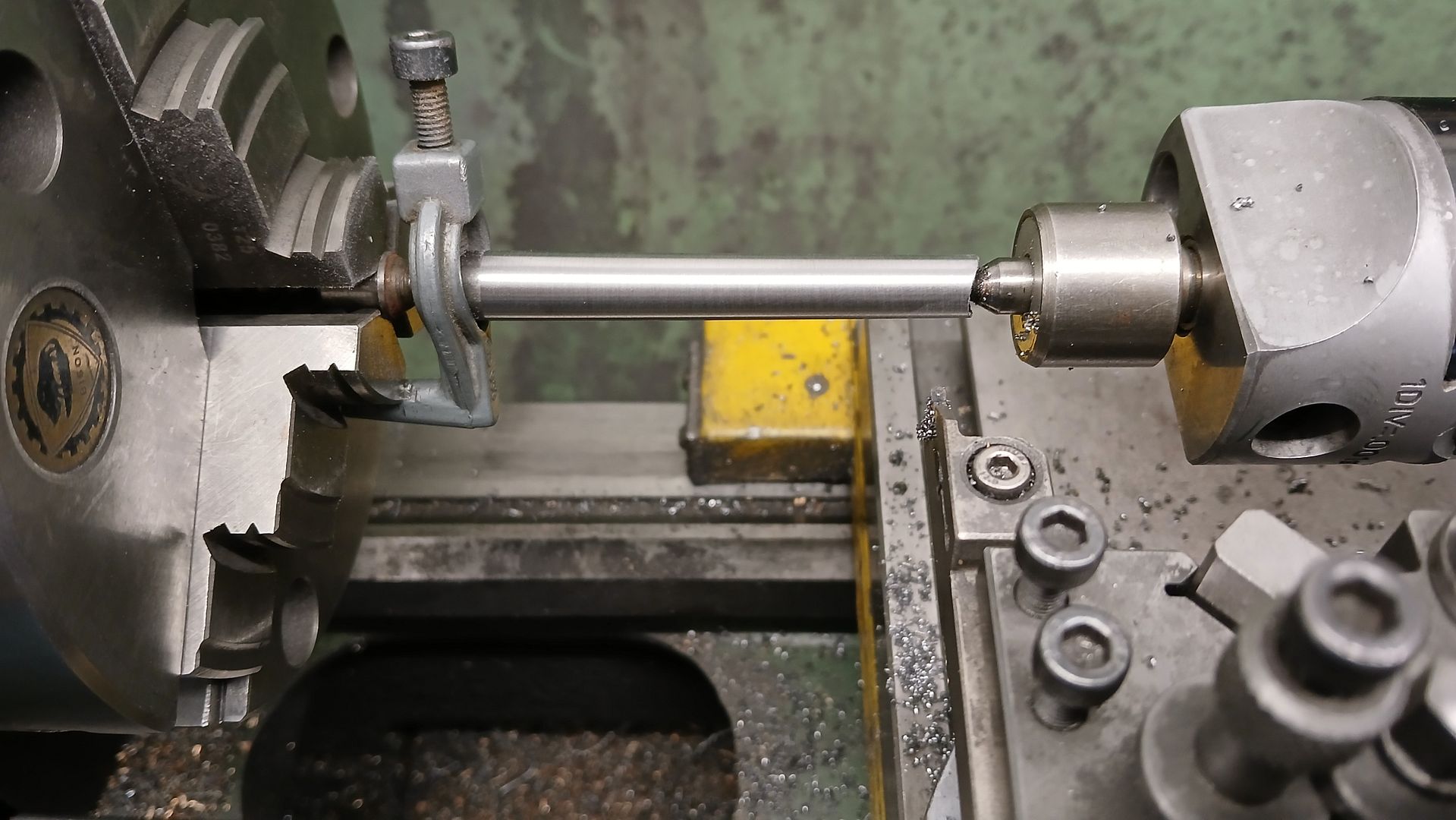

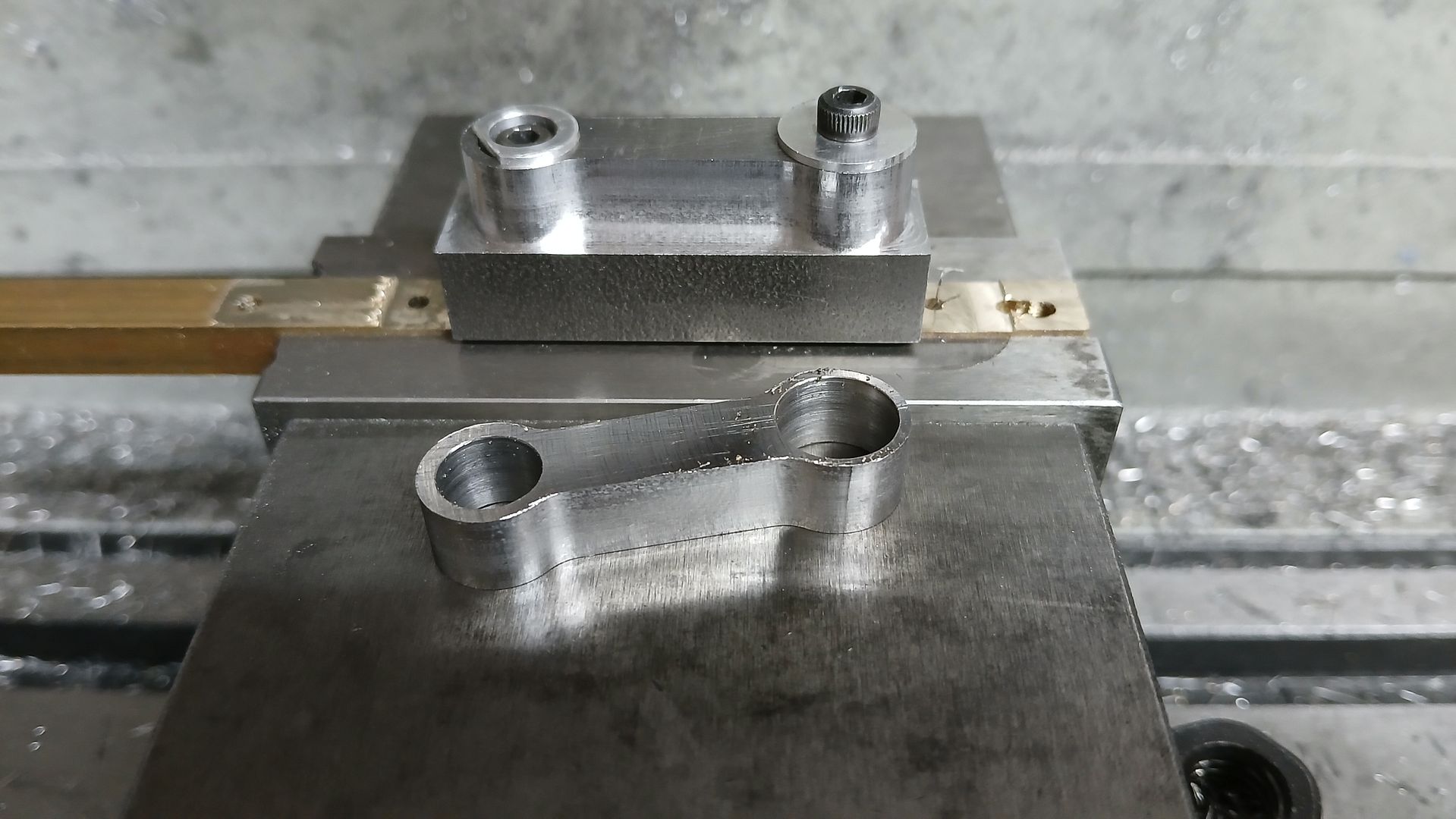

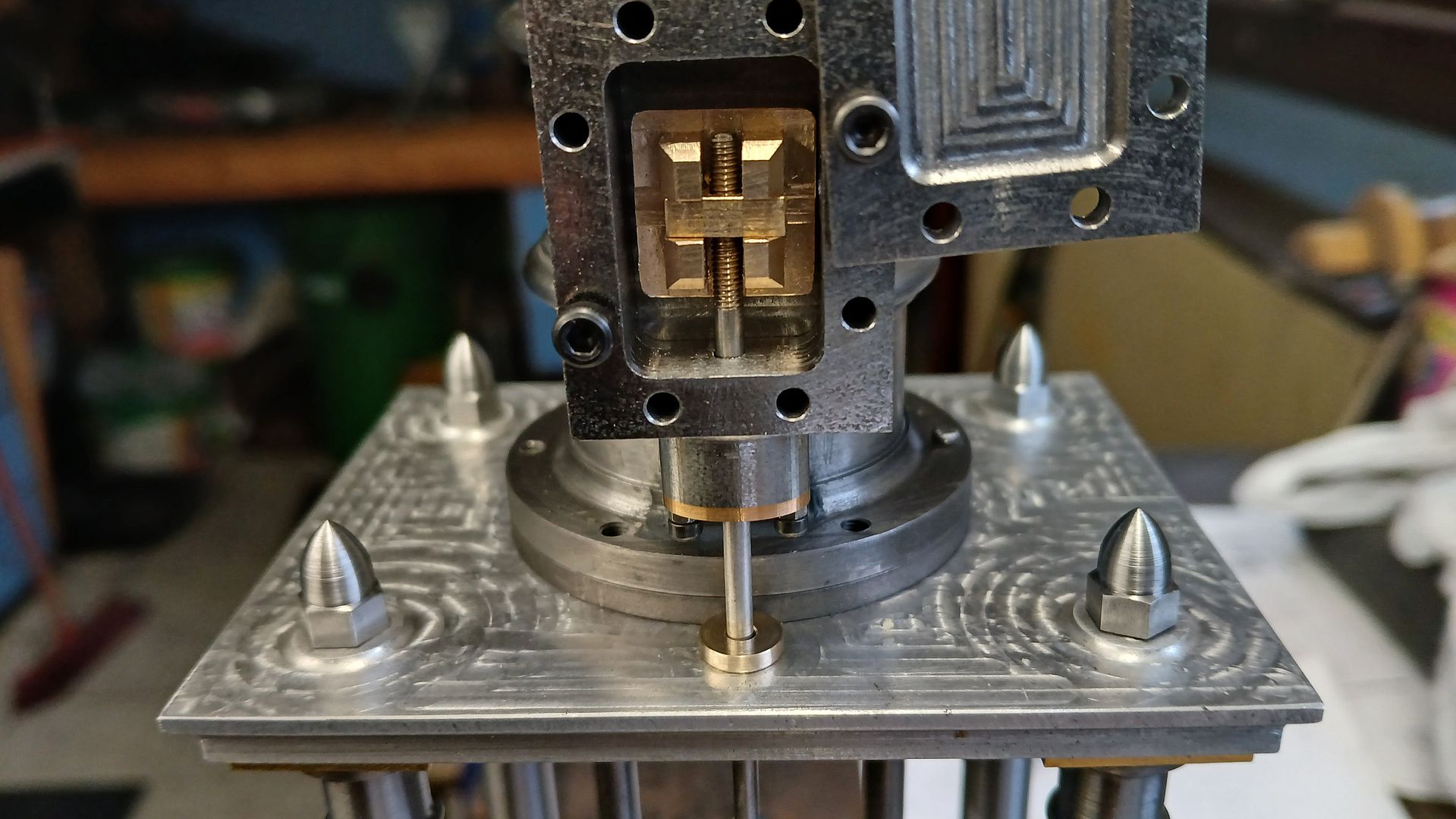

With the cylinder complete the various bits that fit to it were next.

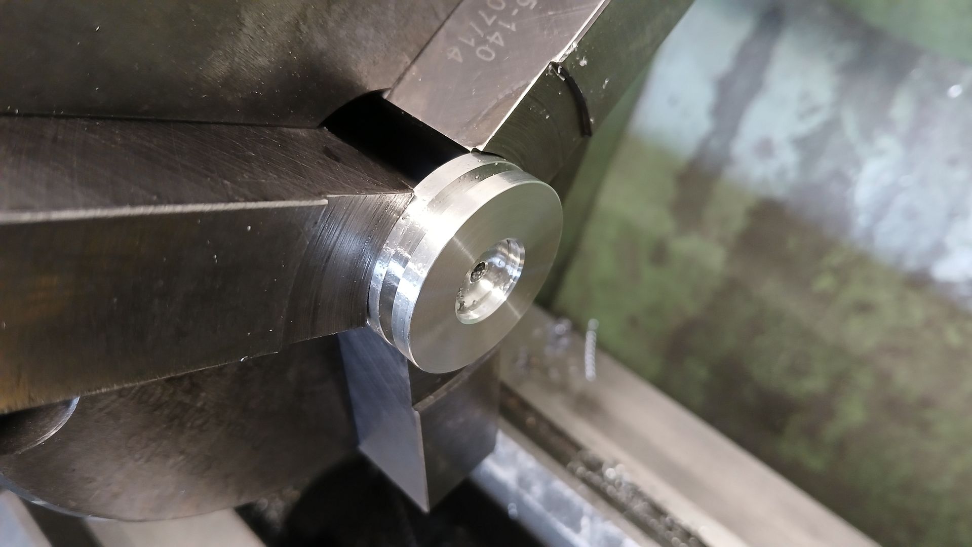

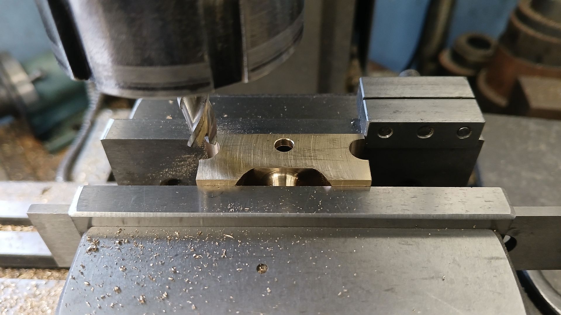

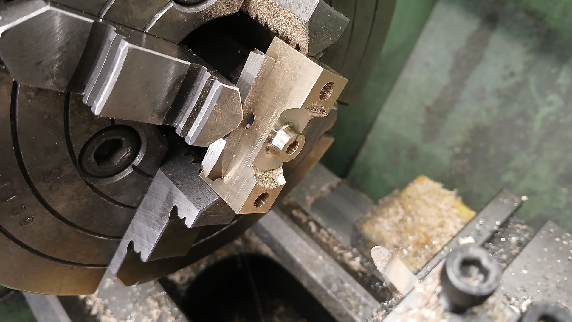

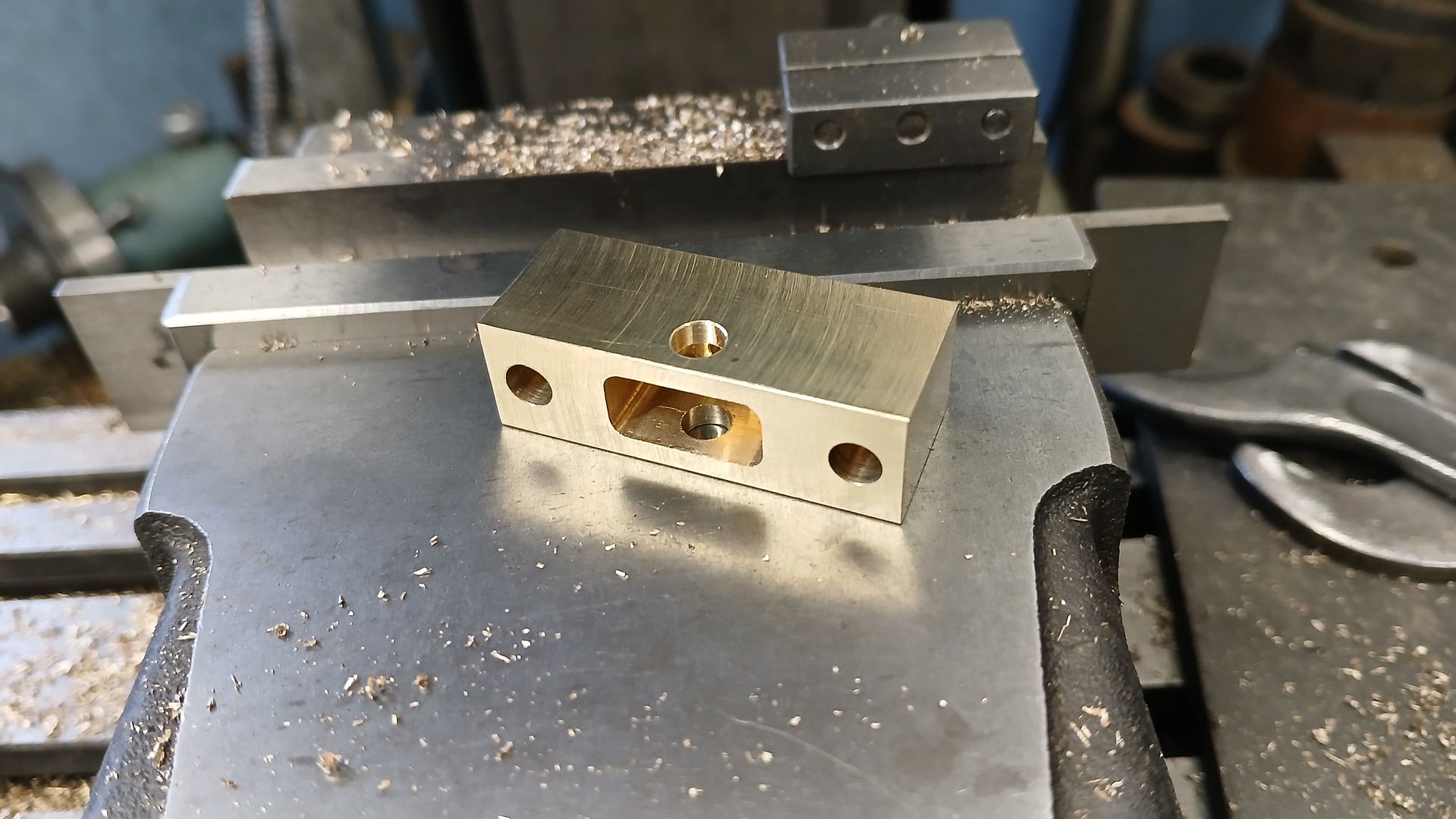

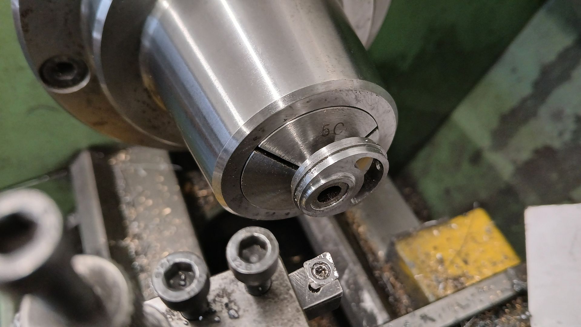

The lower cover is fairly straightforward turning, it is a bit thicker than your usual cylinder cover as there is an 8mm thick boss on the bottom which locates in the large hole in the entablature.
The top side just has the usual shallow spigot to locate the cylinder and was reamed 5mm for the piston rod

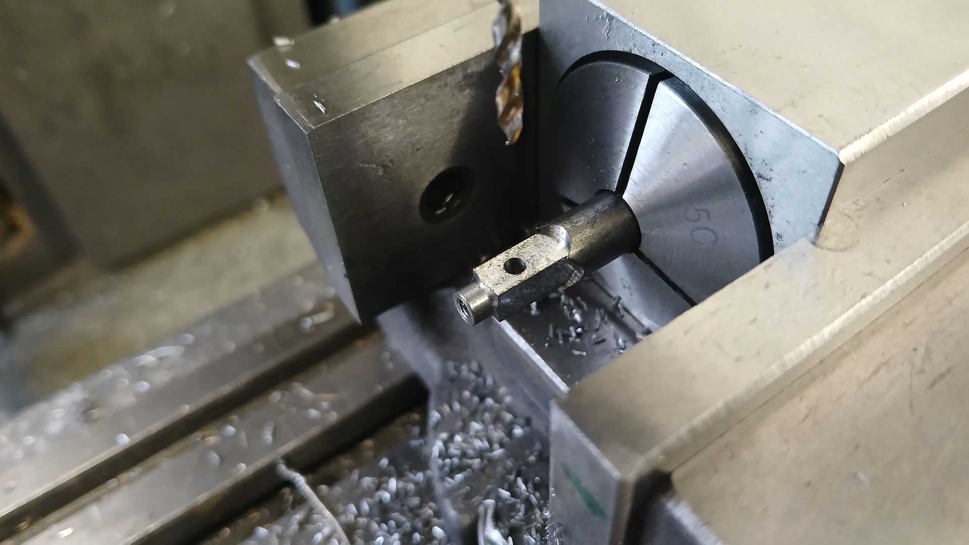

Some holes finish that part off, the two tapped holes in the thicker section are to take the crosshead rod guides

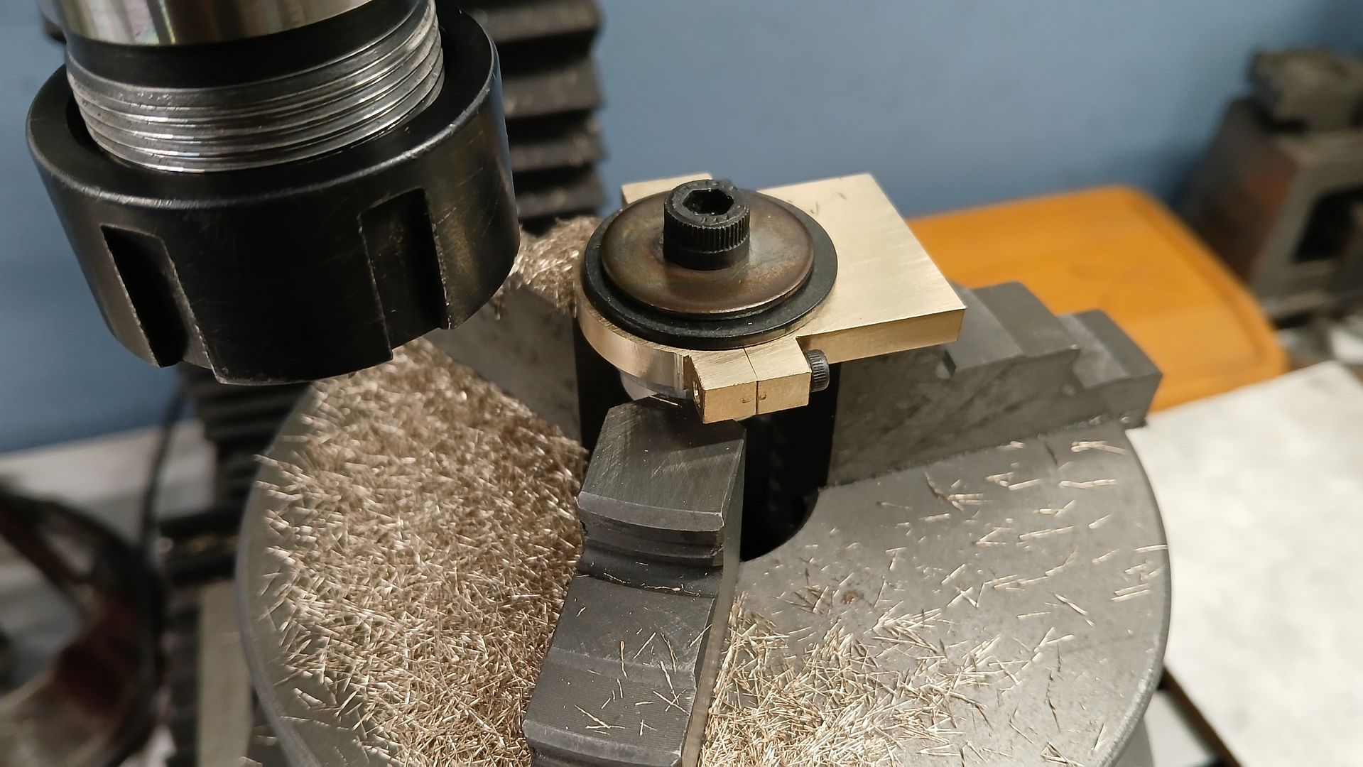

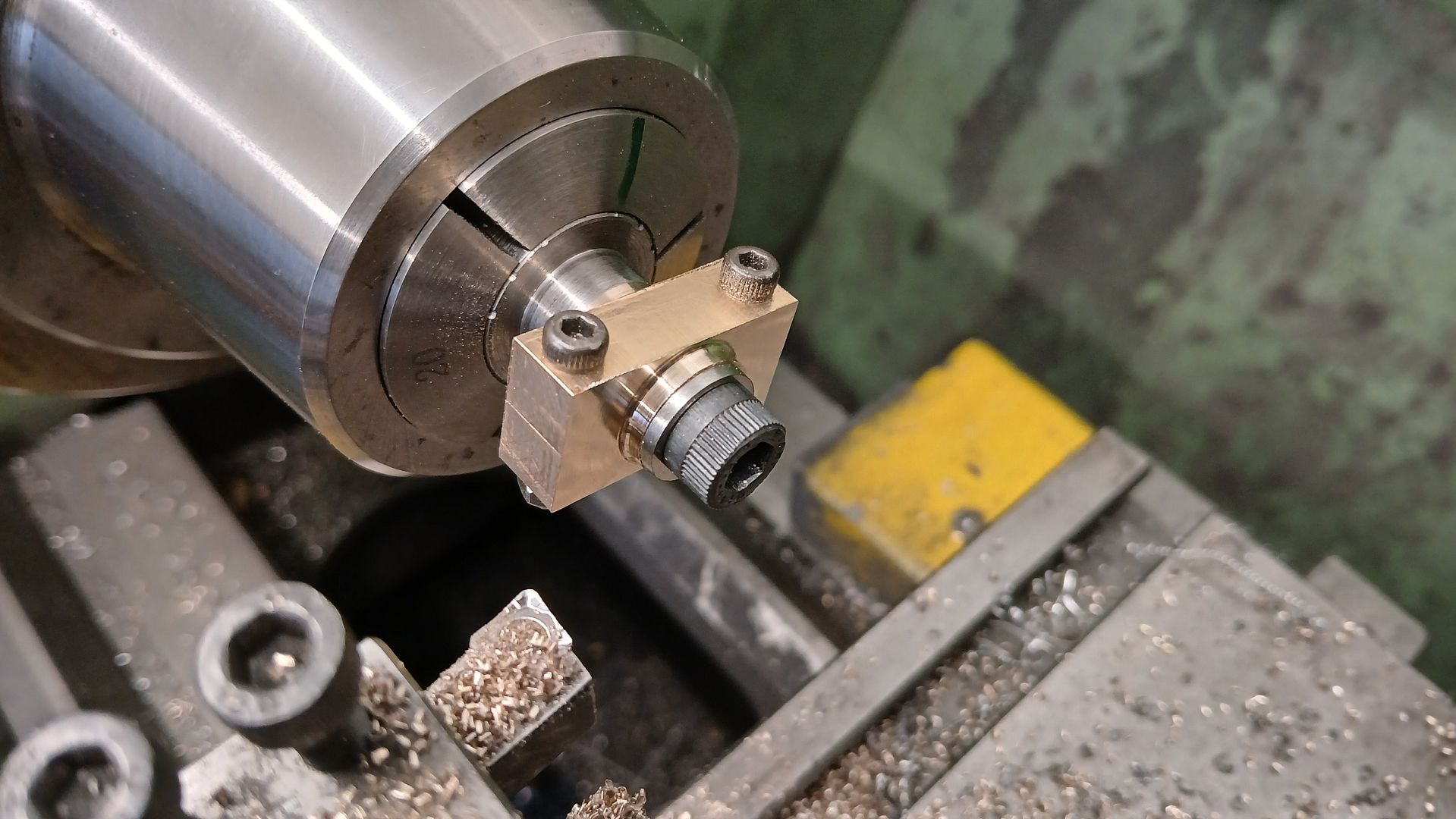

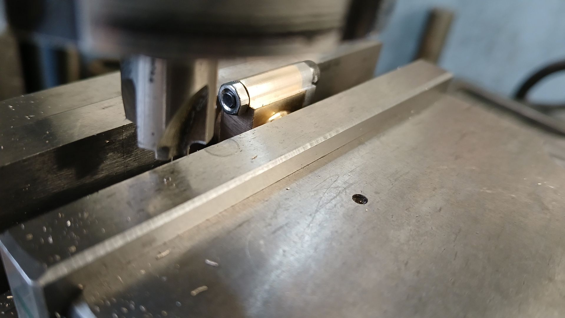

A quick modification of my beading tool by grinding one edge to 45degrees allowed it to be used to form the 4mm balls on the ends of the 5mm guide rods.

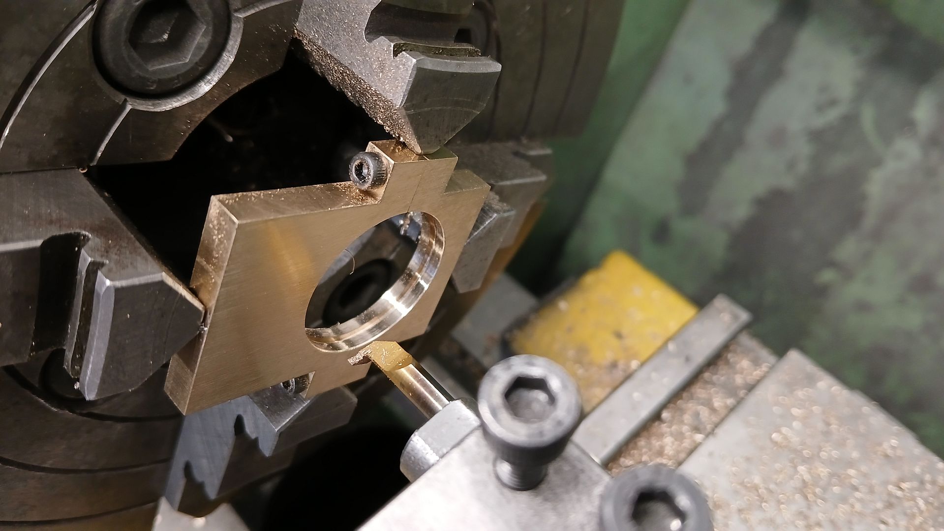

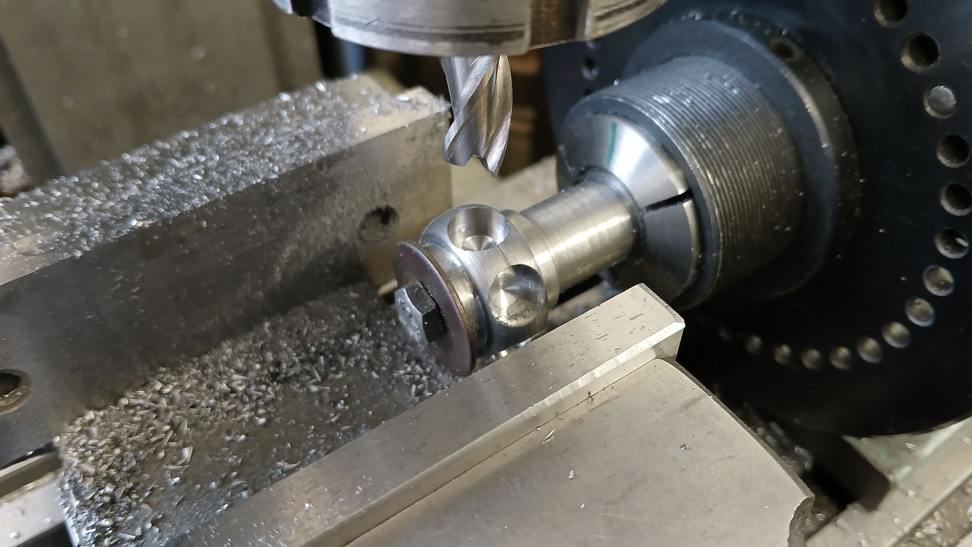

The top cover is rather busy with a lot of fine moulded detail to the "cast" part
The main turning was done on the lathe but rather than fiddle about with small form tools to turn the detail I used the rotary table to rotate the cover while I used various milling cutters to form the shapes including a 6mm dia bull m=nose cutter with 1mm convex corner and a 1.5mm radius corner rounding cutter.

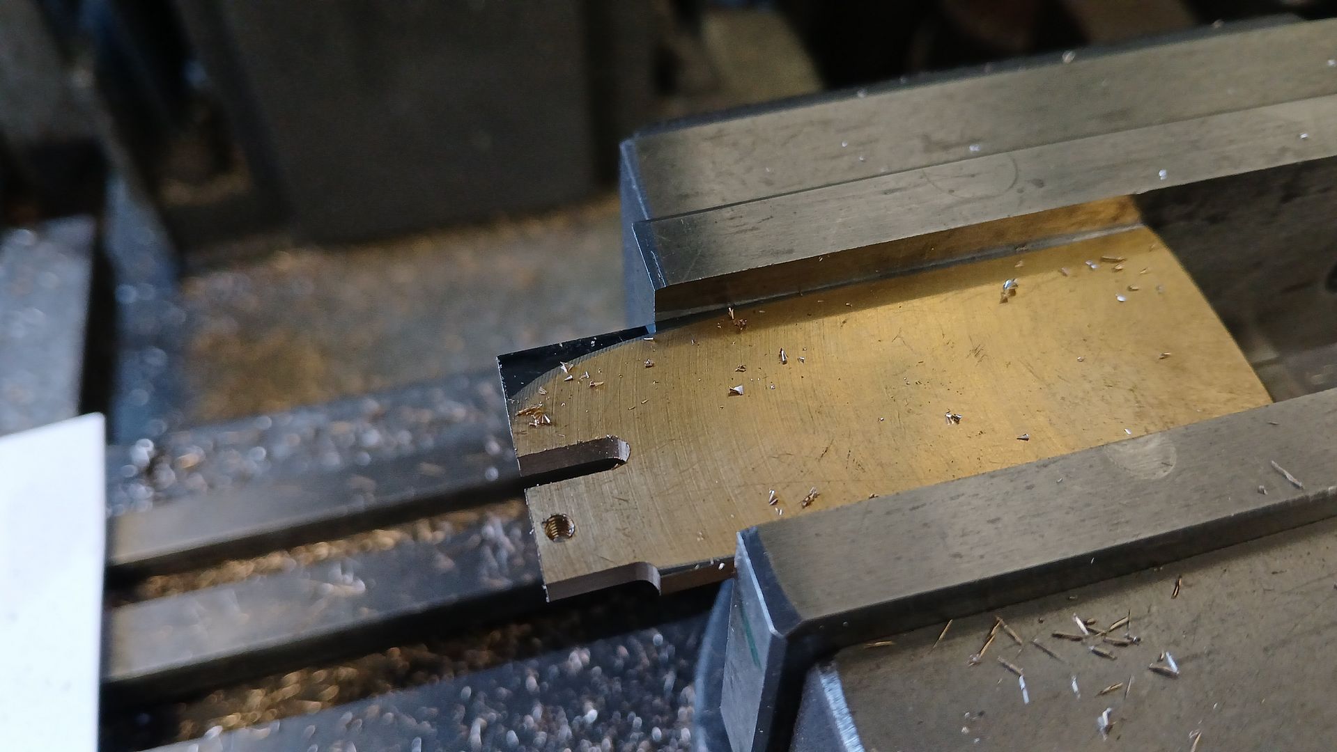

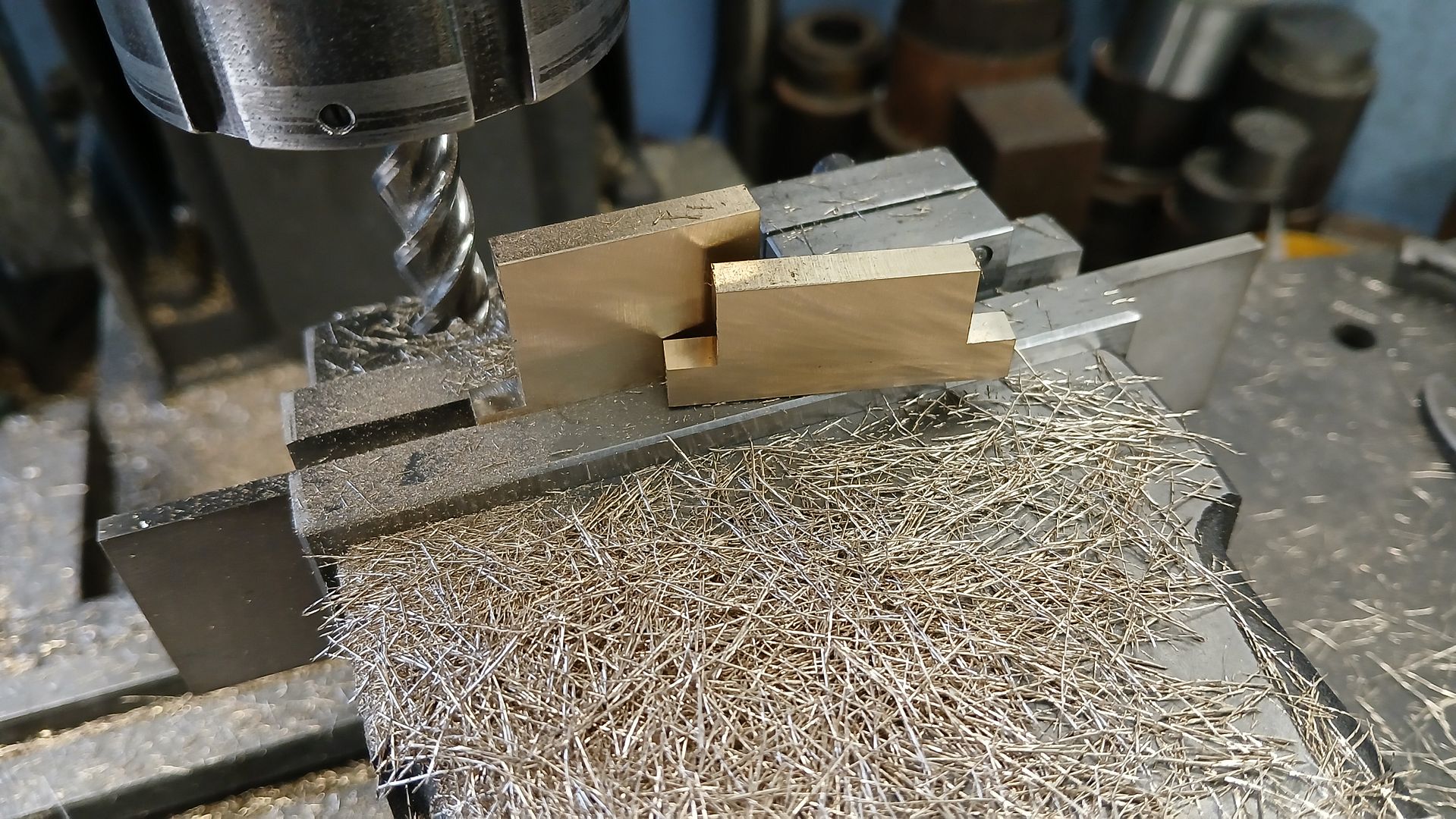

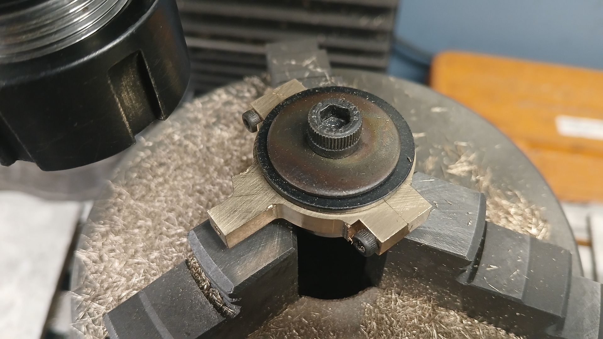

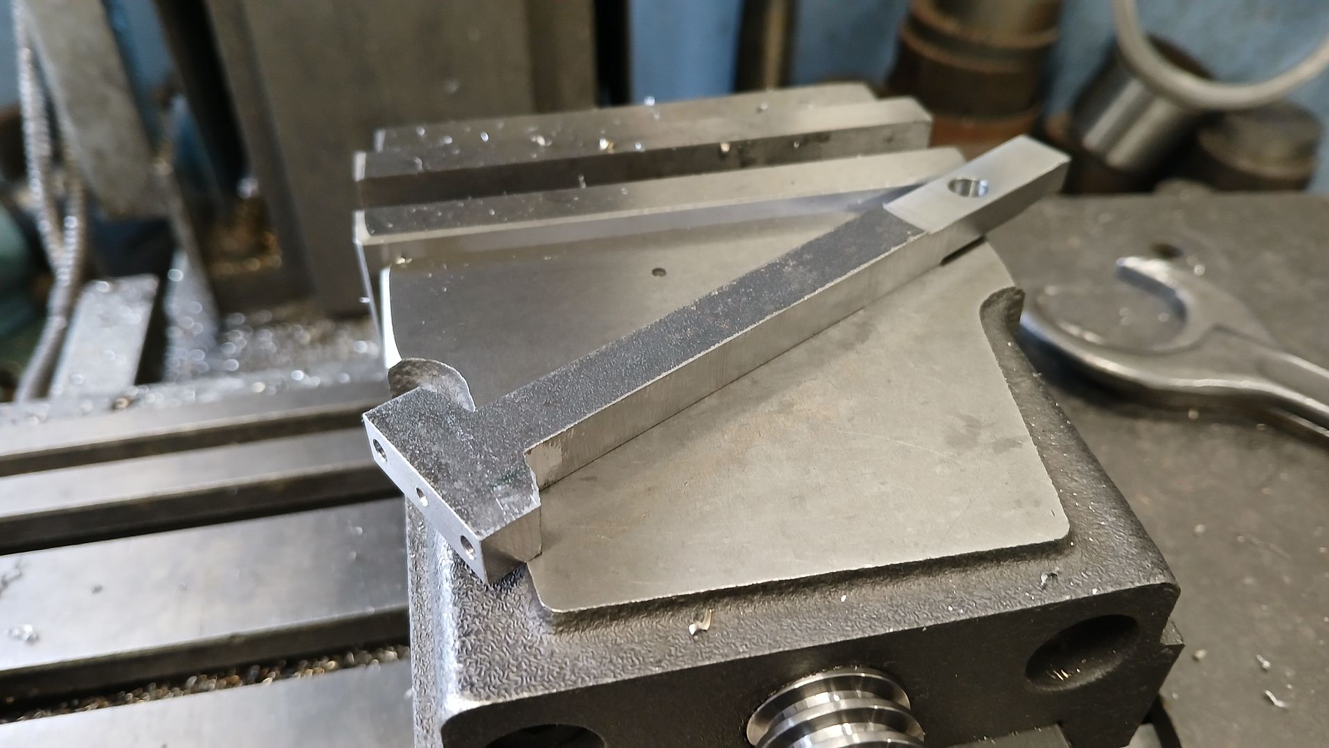

The valve chest and it's cover are much the same as any other just being rectangular bits of cast iron with some holes drilled in them.
A couple of minutes each on the CNC had the elliptical boss and gland shaped on the end of the chest and a decorative recess in the cover.

Those ellipitical glands look perfect, both the valve chest and brass part - are they machined together?
I need to make a similar shaped exhaust flange for the engine I'm working on; pencil, paper, some round stock and a file unless theres a clever way of making ellipitical shapes using a rotary table??
  • Posts: 11116
Re: Vickers Inverted Engine
« Reply #27 on: February 02, 2025, 07:25:16 AM »
Yes i did them together.
There are several options, rotary table, boring head, jig on the lathe. The later two require some filing of the small radius at each end
Though are the Centaur ones actually elliptical or a flattened diamond with rounded corners? In which case the rotary table can be used.
Post a photo of the mating surface in your thread and we can take it from there.

Beautiful work Jason! The cylinder looks like the one on my Mary beam engine. Elegant looking engine!
Online Sanjay F
  • Posts: 1980
« Reply #29 on: February 02, 2025, 09:49:59 PM »
Yes, will do, thanks - once I have have overcome the current issues  :)

Onwards and downwards to the bearing pedestals.
I started by milling some 6082 Aluminium into rectangular blocks, tapped the bottom halves M4 and drilled the tops 4.0mm. These were then screwed to a scrap block on the CNC to cut the oval shape.
<a href="https://www.youtube.com/watch?v=JatrMqbioyY" target="_blank">http://www.youtube.com/watch?v=JatrMqbioyY</a>
The pedestals have an arched shape on the side, I replicated this by JB Welding on some rectangles of 1mm aluminium to the bottom halves and some arched shaped pieces cut on the CNC to the tops. Once the JBW had set the pedestals were screwed together and drilled & reamed
The bronze bearings were basic turning and boring

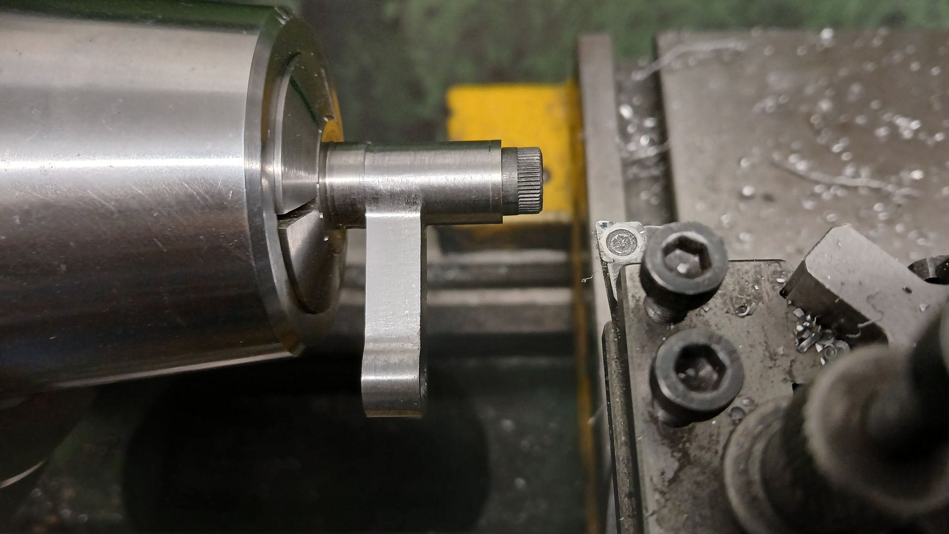

The crankshaft has an offset on one side so I made the webs for the built up construction two different thicknesses which were drilled & reamed on the manual mill. I then used the holes with some top hat bushes to secure them to a scrap piece and let the CNC cut the dog bone profile.
The web with the offset had the waste cut away with a hacksaw and was then held on a mandrel to round the remaining metal to match the CNC'd shape
The pin and rod were 10mm PGMS and it was all stuck together with Loctite 648 and left overnight.
The unwanted piece of shaft was sawn out and the faces filed flush.

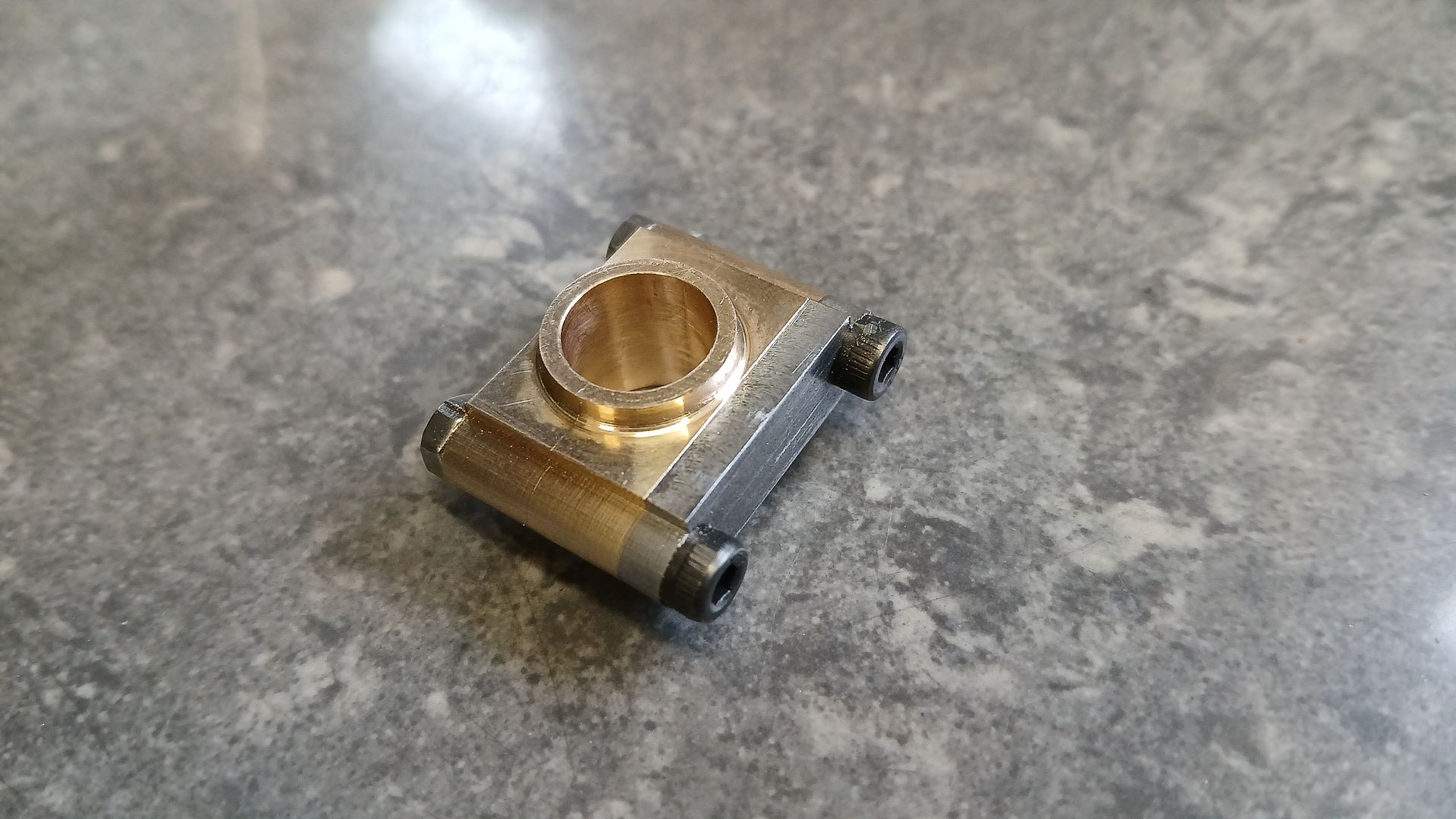

I then decided to do the big end. Two pieces of bronze were milled to size along with a steel bottom keep plate and drilled for the fitted bolts. capheads and nuts were used to hold the bronzes together for drilling and reaming.
Then onto the same 10mm mandrel used for the cranks to turn down each side to leave the round bosses.
Lastly the keep plate was added and a 3mm rounding over bit used to profile the sides

While down at the bottom end of the engine I decided to do the eccentric and strap next. For the strap two pieces of brass were milled leaving a bit of extra material on the one for the lower half. I then milled the flats before drilling and tapping for bolts. A non ferrous cutter with 3 flutes was used cutting a full 20mm height, may as well use all of the cutting surfaces you have paid for!
The two halves were then held together with some temporary cap heads to bore the hole for the eccentric and cut the 1mm x 1mm slot to accommodate the retaining rib of the eccentric The extra bit of material on the bottom half helps stop things being distorted by the 4-jaw but I did not overtighten to be sure.
A previously used arbor was altered to be a close fit in the strap which was then clamped in place with a couple of penny washers and a screw so that the outer profile could be completed on the rotary table. A bit of file work finished it off where I could not do the full arcs due to the screw heads being in the way
A narrow parting insert was used to turn the eccentric first getting the outer spigot a nice fit in the strap and then using the same handwheel setting to do the area behind the central rib. No measuring once I got close just using the starp as my gauge.
With the material held in a square collet block it was easy to offset and ream the hole for the crankshaft and then reposition the block to drill and tap for a grub screw directly inline with the highest part of the eccentric throw which helps when setting the initial timing as you can see the angle by where the allen key is pointing
The block also ensured the balancing hole was correctly orientated on the curre cutting machine which made quick work of it using a 3mm dia cutter
Last thing was to hold it on a piece of 10mm stock and turn the boss on each side using a tip with 0.8mm radius to leave a nice looking fillet.
In hindsight I would probably leave a bit more thickness between the counterbalance hole and the outer edge as it looks a bit thin in the flesh.

With the eccentric and its strap done the next logical part was the valve. Nothing too exciting just the usual rectangular block with a slot for the nut and another at 90degrees for the valve rod and a bit of eight reduction around the sides.
Flip it up the other way and cut the cavity with a 2mm dia cutter
A scrap of 3mm thick brass was found and three sides of the nut machined and the central hole tapped before sawing it off and milling the final edge. I find it easier to do it that way than fiddle with a small piece of material.
The clevis for the valve eccentric rod had the end turned before drilling and tapping M2.5 then over to the spin indexer to square it up and drill the hole. After sawing off and rounding the end a 2.5mm cutter formed the slot.
No photos of the valve rod but it was just a piece of stainless steel threaded M2.5 at one end for the nut and a small 1.5mm dia x 1mm long spigot turned on the other. This spigot located in a hole drilled in the edge of the "eye" to hold it in place while the two were silver soldered together. A small guide bush in the entablature stops the rod being pushed sideways by the action of the eccentric rod.

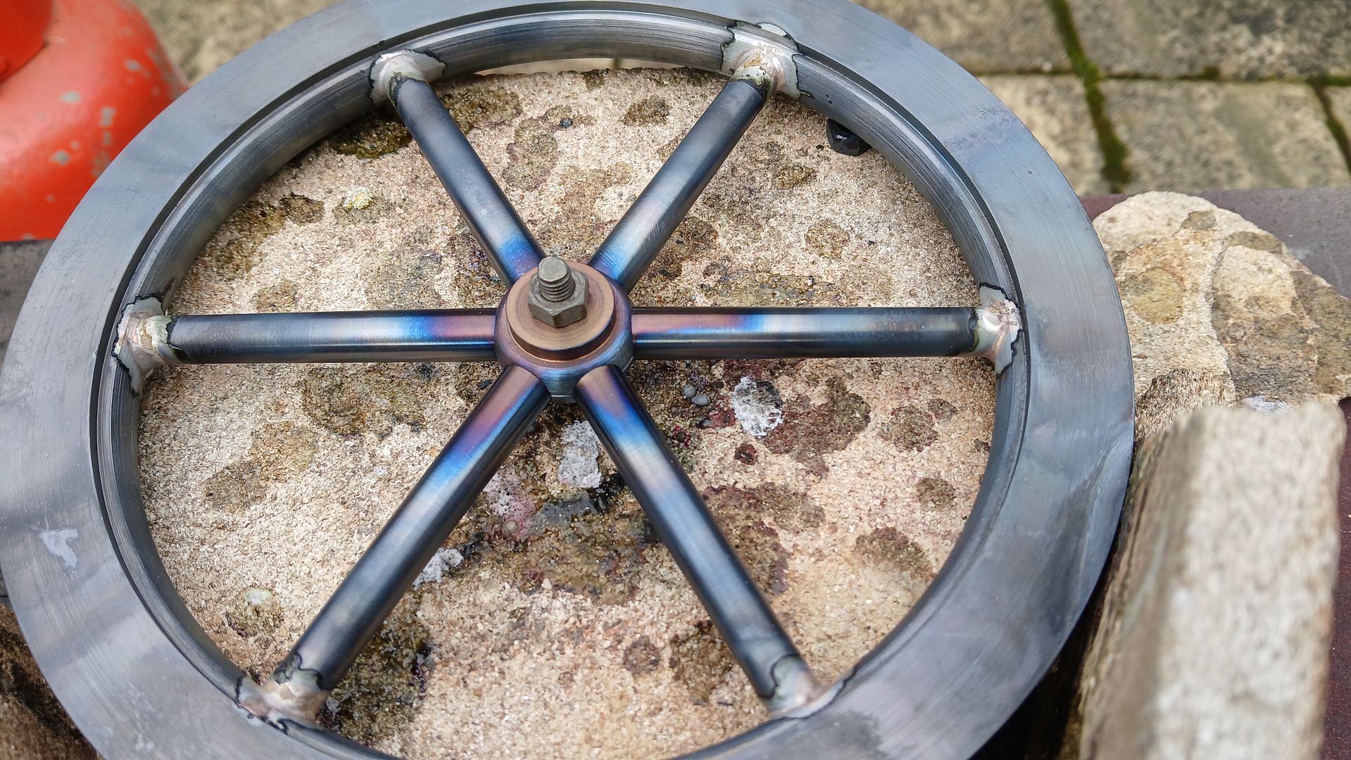

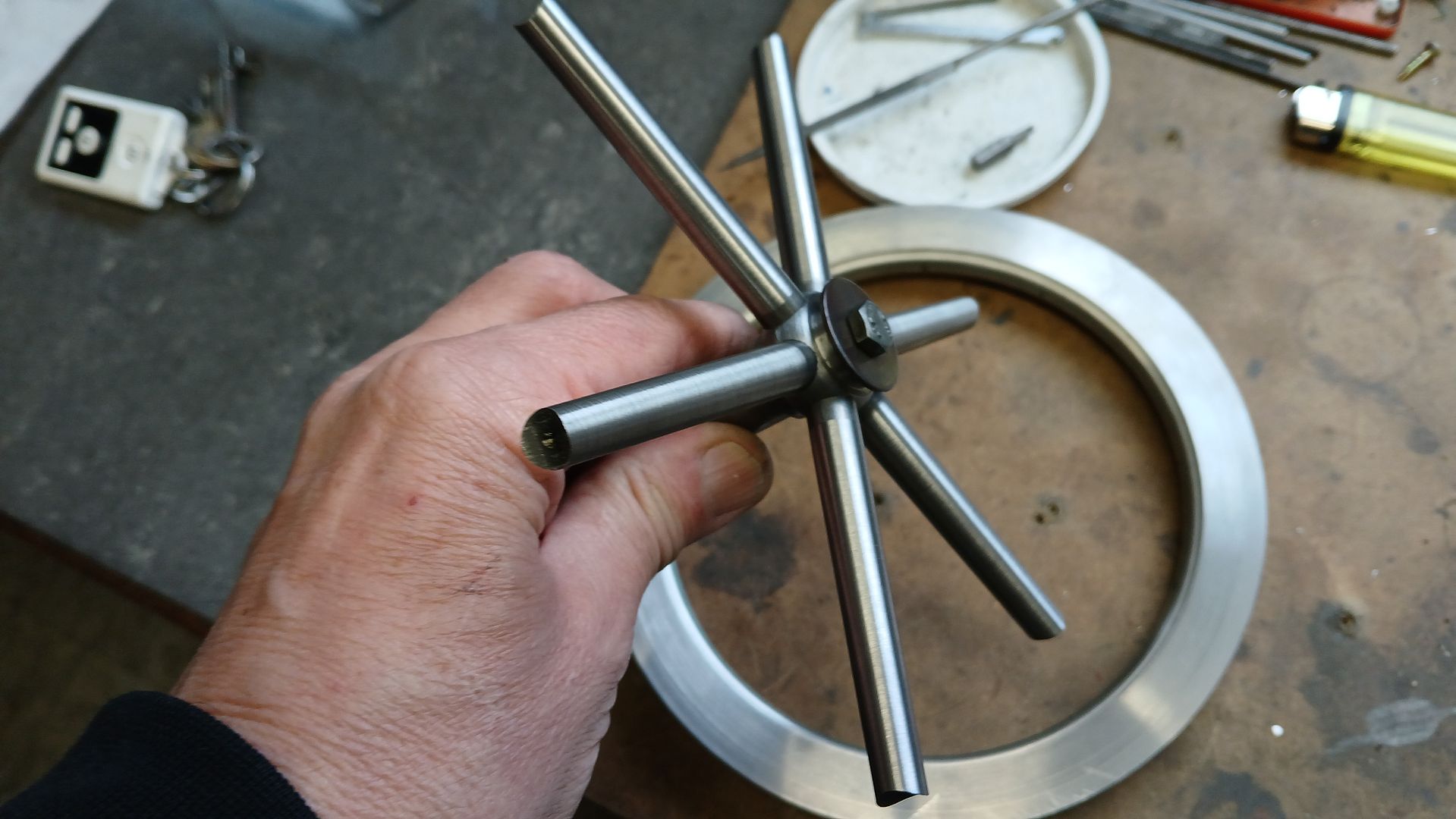

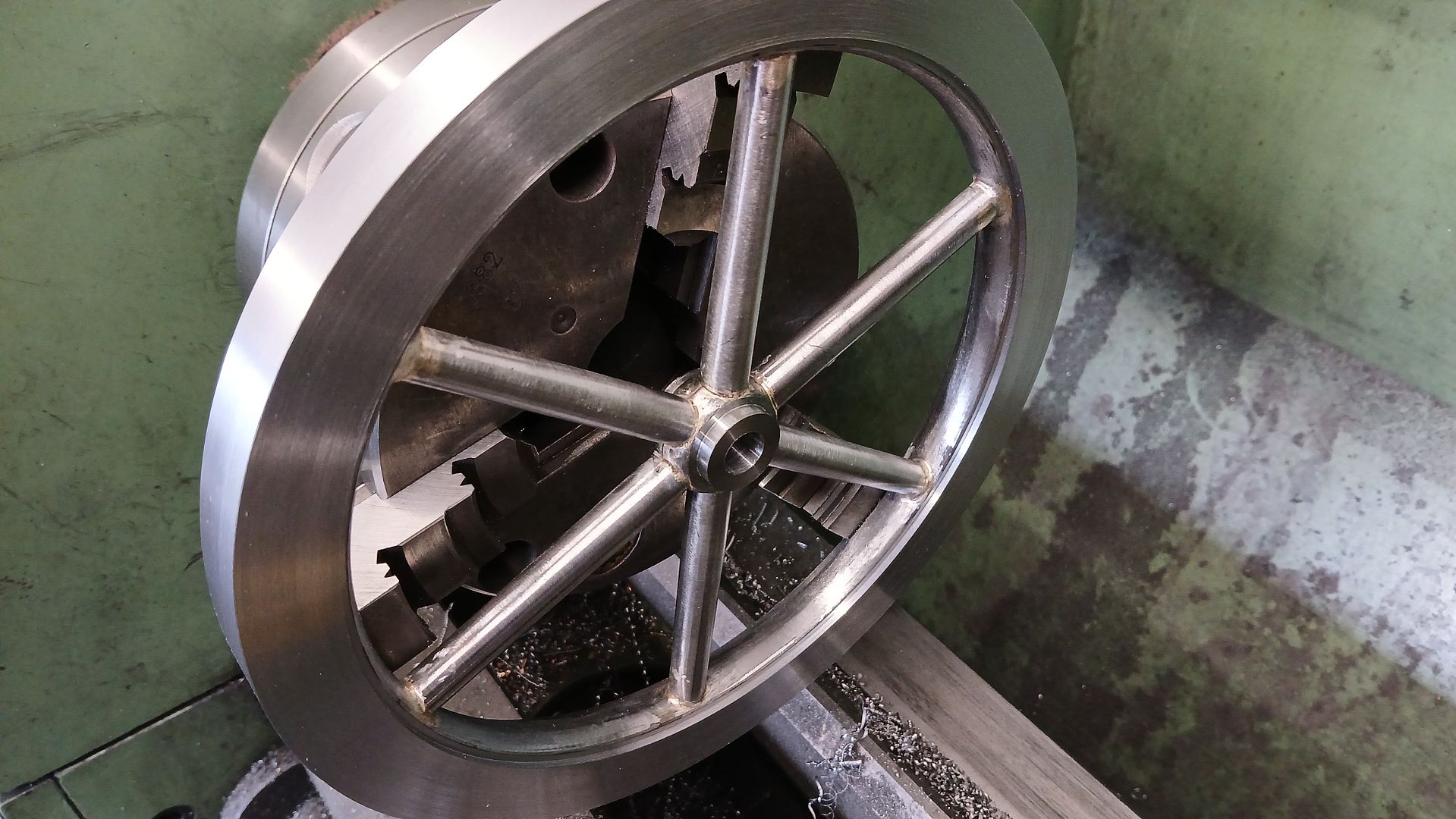

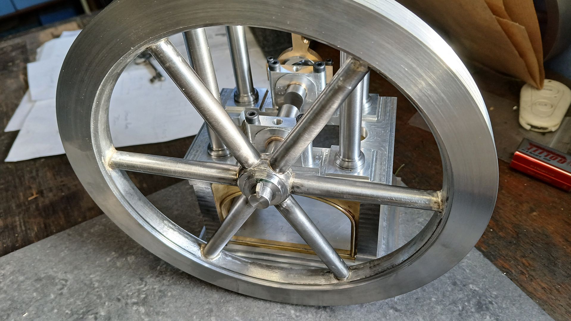

I had designed and scaled the engine to suit the generic Stuart 7" casting but decided to make my own as it keeps me out of mischief for a bit longer than just machining another cast flywheel would. As with several other engines, I started with some 203mm OD x 25mm thick wall steel tube leaving the diameter and width a bit oversize. The profile of the inner edge was done with a series of co-ordinate cuts using a 0.8mm tip radius insert in a boring bar - 22 cuts from each side. You can see the contours of these cuts best just below the boring bar.
With a piece of round bar in the toolpost to act as a tool rest a woodworking HSS scraper was used to take the tops off the contours and blend them into a smooth profile.
The 10mm bar for the spokes had a suitable concave curve cut on the end to sit closely against the profile of the rim.
Then after ctr drilling both ends the boring head was used to offset a small rotating ctr and the spokes were tapered.
The two halves of the hub were profiled in a similar way to the rim, a spigot on one locates the other and a 6mm hole allows them to be bolted together.
I then drilled 6 holes with a 6mm drill followed by plunging with a 10mm 3-flute cutter to form pockets for the other end of the spokes to locate into.
Quite a nice push fit into the holes and no spokes falling out which will mean no jigs needed for the next steps
The spokes were then machined to final length and a couple of chamfers were added as the bottoms of the pockets actually meet. I then redid the chamfers in the correct positions which should have been at the sides not top and bottom.
The rim joints were fluxed and silver soldered
Then when cooled the hub joints were done.
After a clean up it was back onto the 4-jaw to bring the slightly distorted rim to final size, skim the face of the hub and bore to fit the 10mm crankshaft
Lastly keyways were cut and a gib head key filed up from gauge plate.
Then it was time to play.

Starting with the piston this was faced and tapped M4 with a 3mm deep x 4mm dia counterbore and after turning to 0.5mm over diameter I cut the piston ring slot to the final inner diameter and width.
After cutting it off from the stock on the bandsaw I held it in my soft jaws to face to width and bore a counterbore for a lock nut.
It was then screwed onto the piston rod and the nut fitted - no need for scale looking nuts here, off the shelf plated or stainless will do. A few light cuts had it down to final size, I don't know what that is but it just "fits" the lapped cylinder bore with the right feel but probably less than  0.025mm smaller diameter.

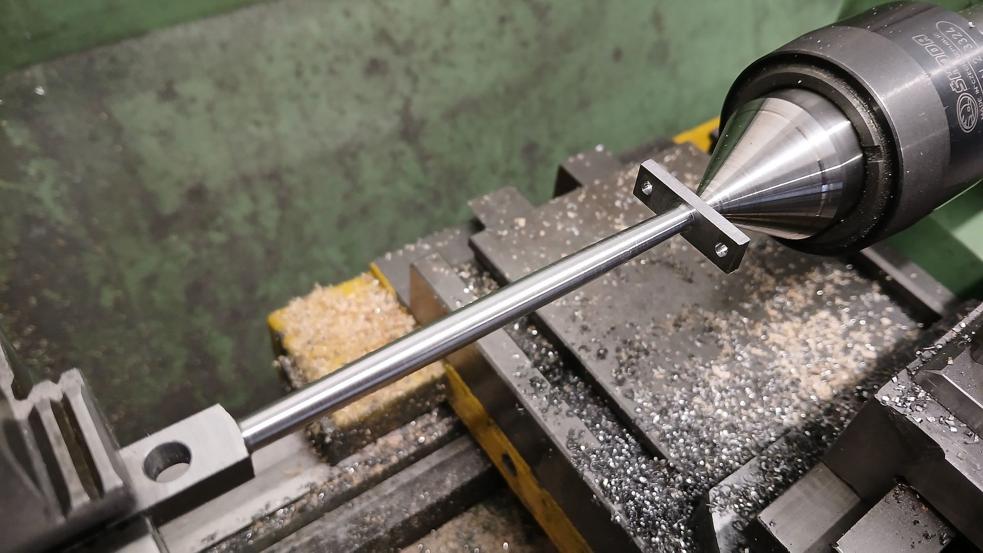

The conrod started out as an offcut of 8mm structural Hot Rolled steel flat, milled and drilled/reamed as required with a bit of extra length on the little end for chucking.
The turning was then done in the lathe, the end thirds being tapered 1.5degrees and then all blended with files and Emery. The chucking material was then cut off, the end rounded over and a bronze bearing Loctited into place.
The cross head had all the important holes reamed while it was an easy to hold rectangle and I also milled out the pocket for the conrod at the same time.
With some packing to prevent the pocket from getting deformed it was held in the 4-jaw to turn the top spigot where the piston rod fits.
Then a couple of scalloped cuts to make it look nice.
There is still some external profiling to do on the cross head but it was far enough along for me to see if the engine would run. Just knocked up the wrist pin and retaining nut then fixed the piston rod to the crosshead with a taper pin and gave it a whiff of air at 5psi. One quick adjustment of the eyeballed eccentric position and it was off :pinkelephant:  :cartwheel:
