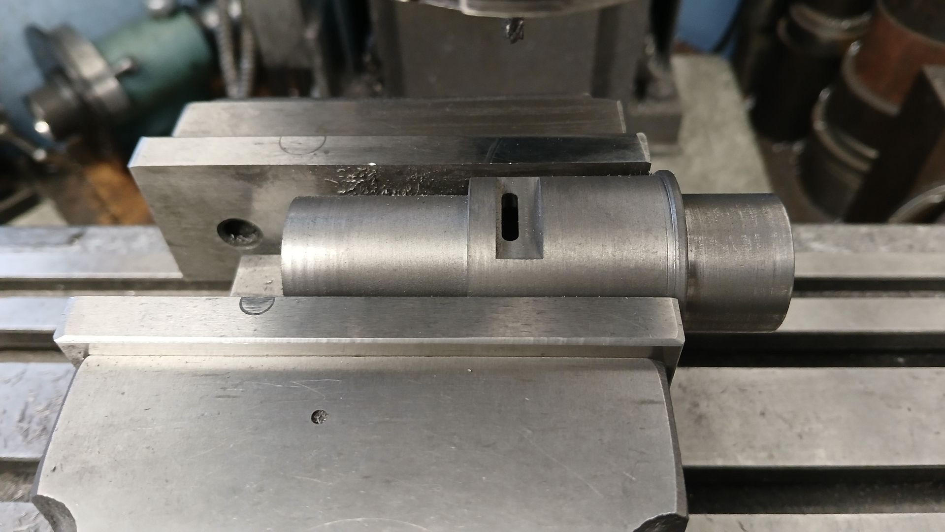

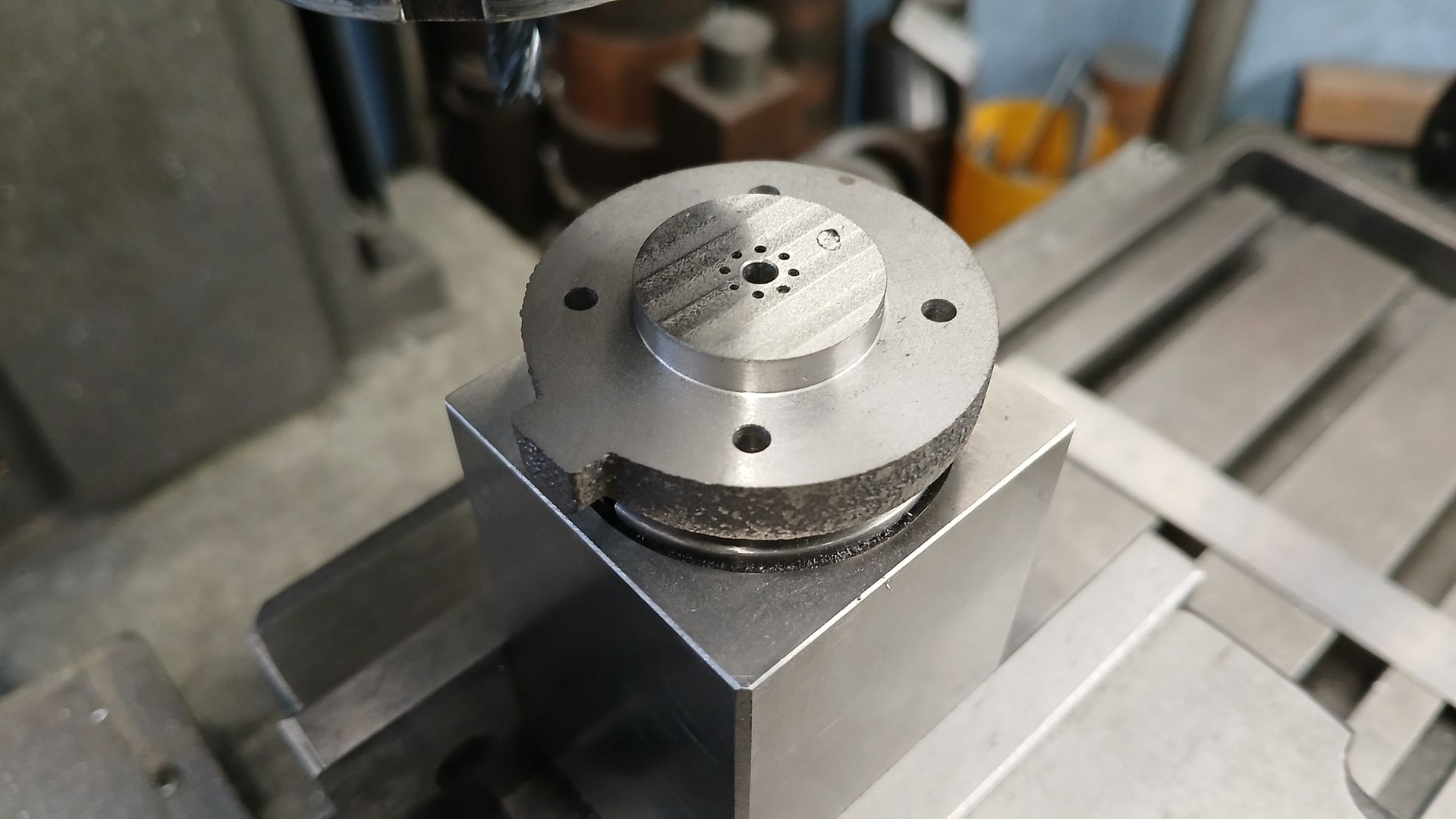

With a couple of other projects completed it was time to get back to the ideal.

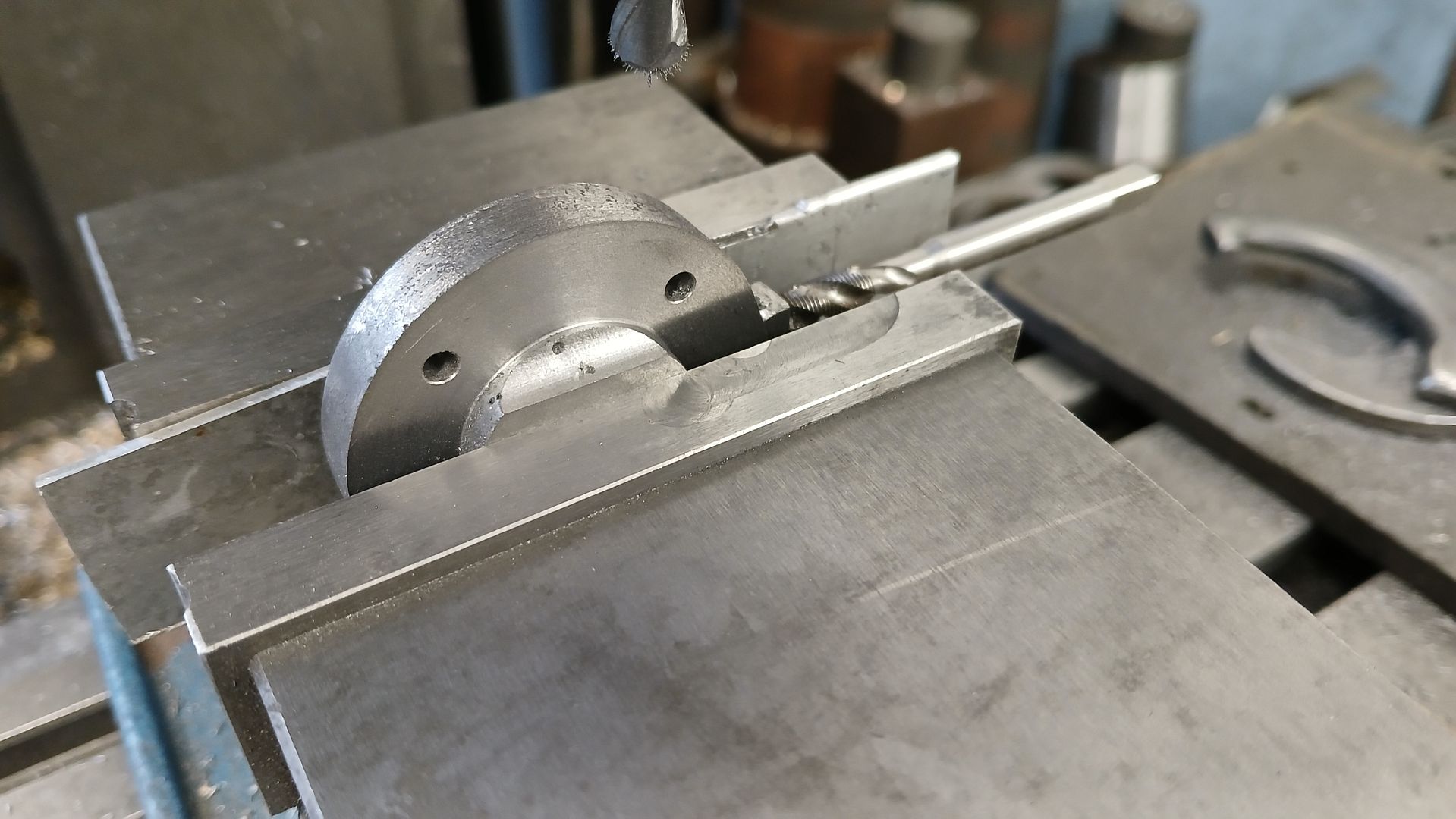

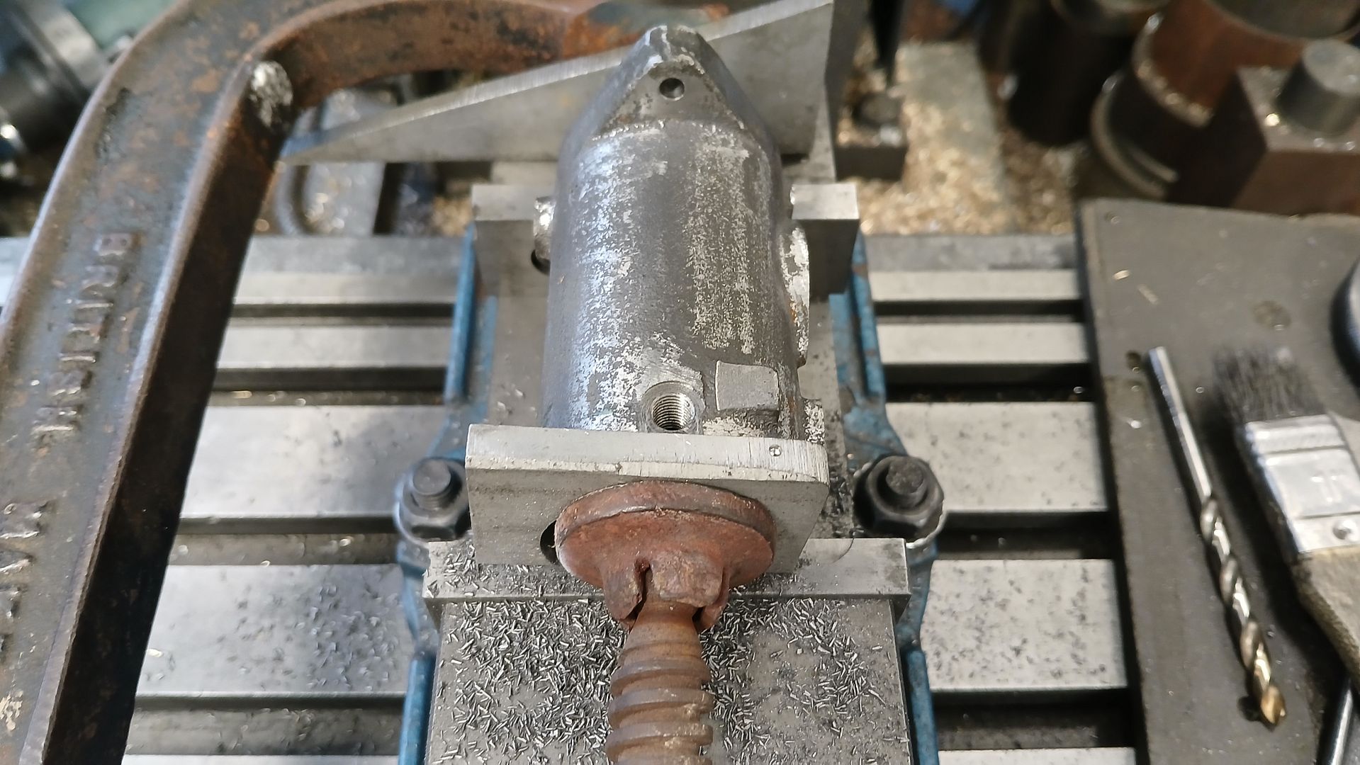

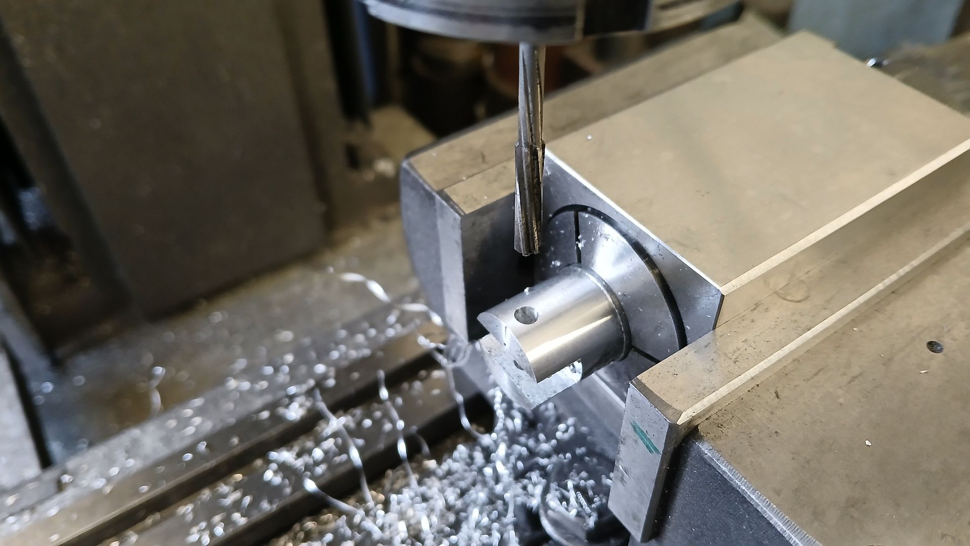

The cylinder head was turned to form the spigot that locates it in the cylinder, I also tool a light skim off the small boss on the outside to clean it up and that proved useful as a way to hold it for drilling the 7 air hole sone one smaller gas hole as well as the larger reamed hole for the valve. I also took a light cut off the face so the surface was totally true to the valve hole.
The gas entry boss was milled flat, a 1.5mm hole drilled to meet the smaller 0.7mm hole and then opened up and threaded M5x0.5 for a gas fitting.

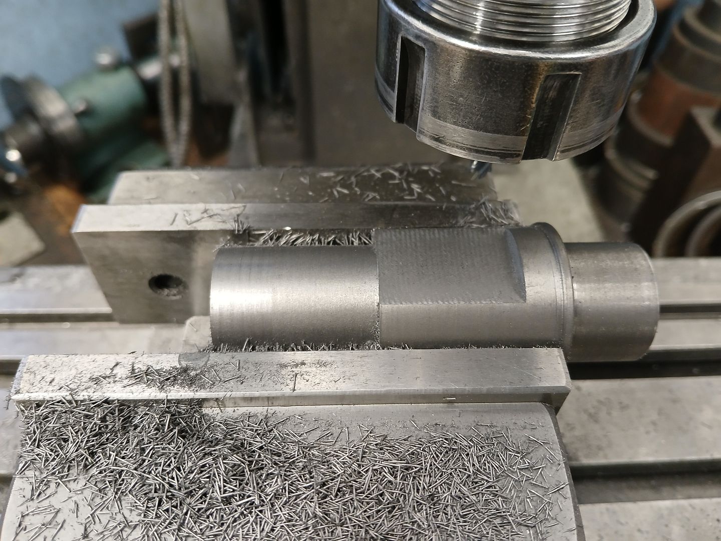

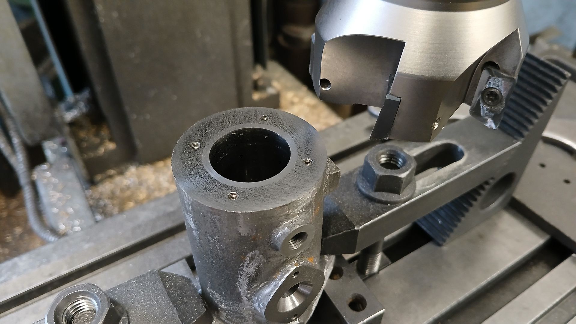

Jumping back to the liner the flat to allow the cooling water to flow to the lower inlet was milled
Then with the liner resting on that flat the slots for the exhaust were milled

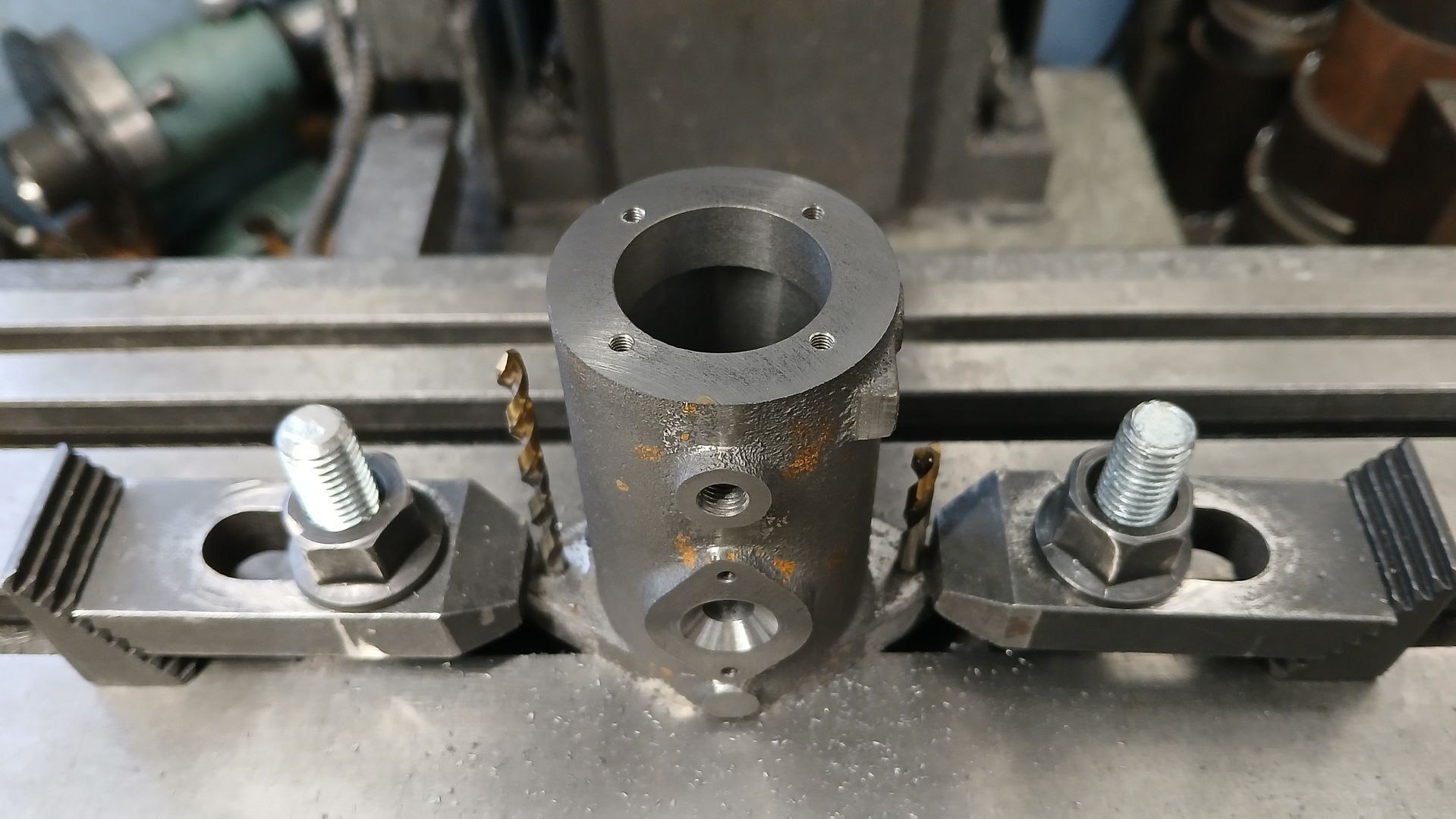

The four M3 holes to hold the head on were drilled and tapped and then the liner was bonded in place with Loctite 648 and set aside for a couple of days to dry right off.
Once dry the head end was milled to final length ensureing a completely step free joint.

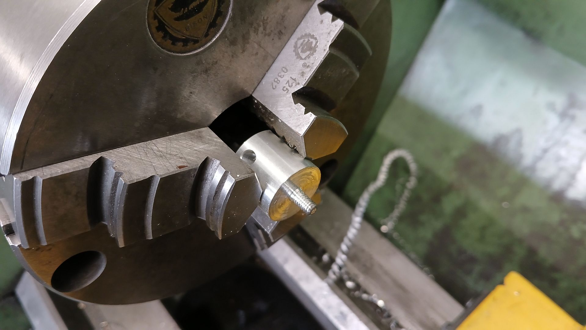

I did not take a picture of the piston as it is no more than a cup turned from 25mm cast iron bar with an M4 tapped hole in the end. This hole takes the threaded gudgeon pin carrier which I made from aluminium. I have gone for a ringless piston just running in the lapped cast iron bore.

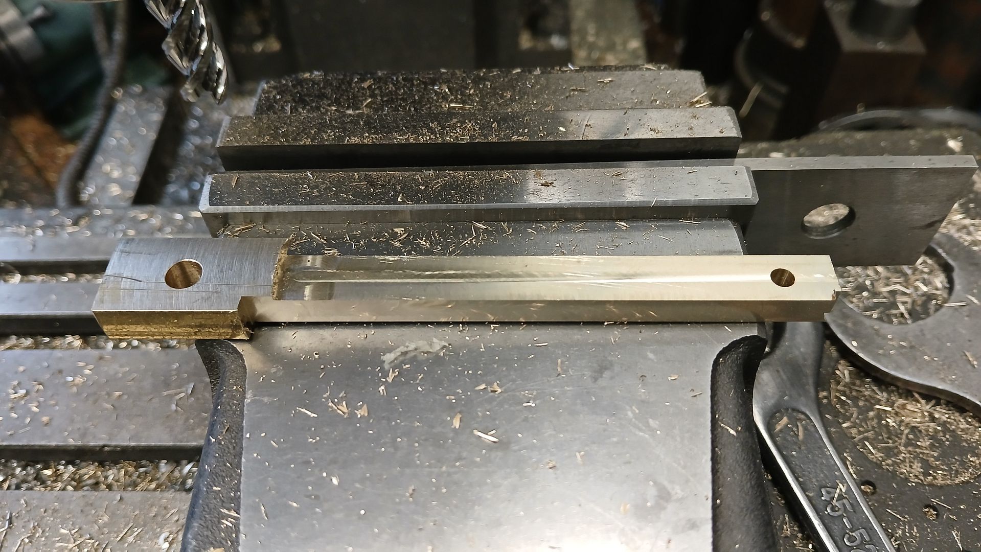

The original engine has a brass or bronze conrod so a suitable bit was reamed and roughed out

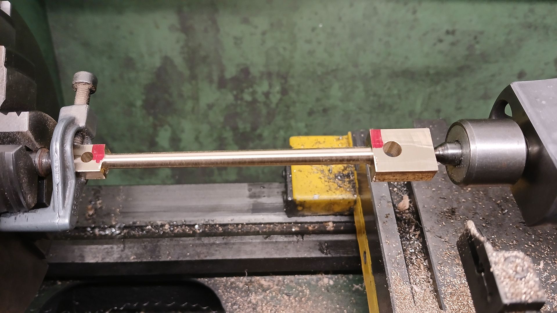

Then taper turned between ctr and boring head after which the big and little ends were milled to shape.
Some simple turning produced the crank pin, valve and gudgeon pin which gave me enough parts for a bit of a play. All seems to go round as it should and the inlet valve is making the right sort of noises.

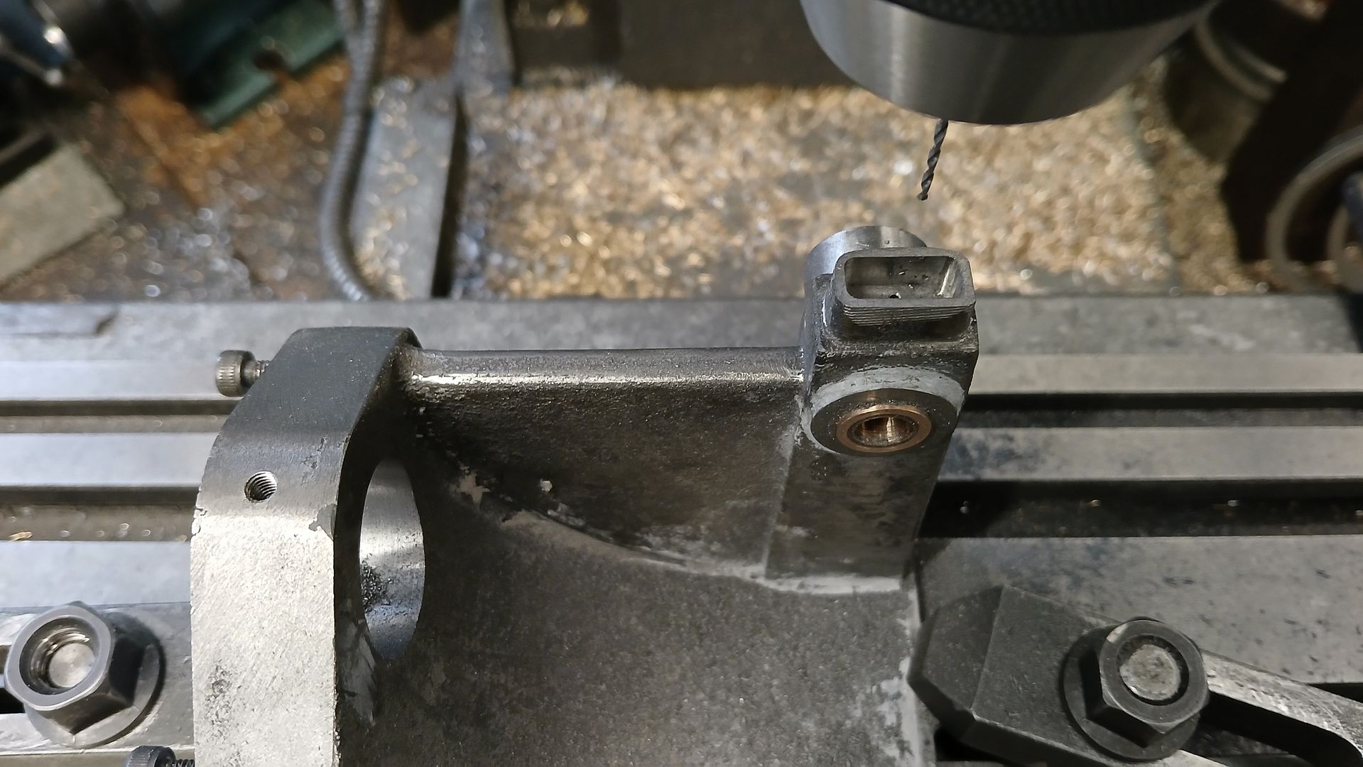

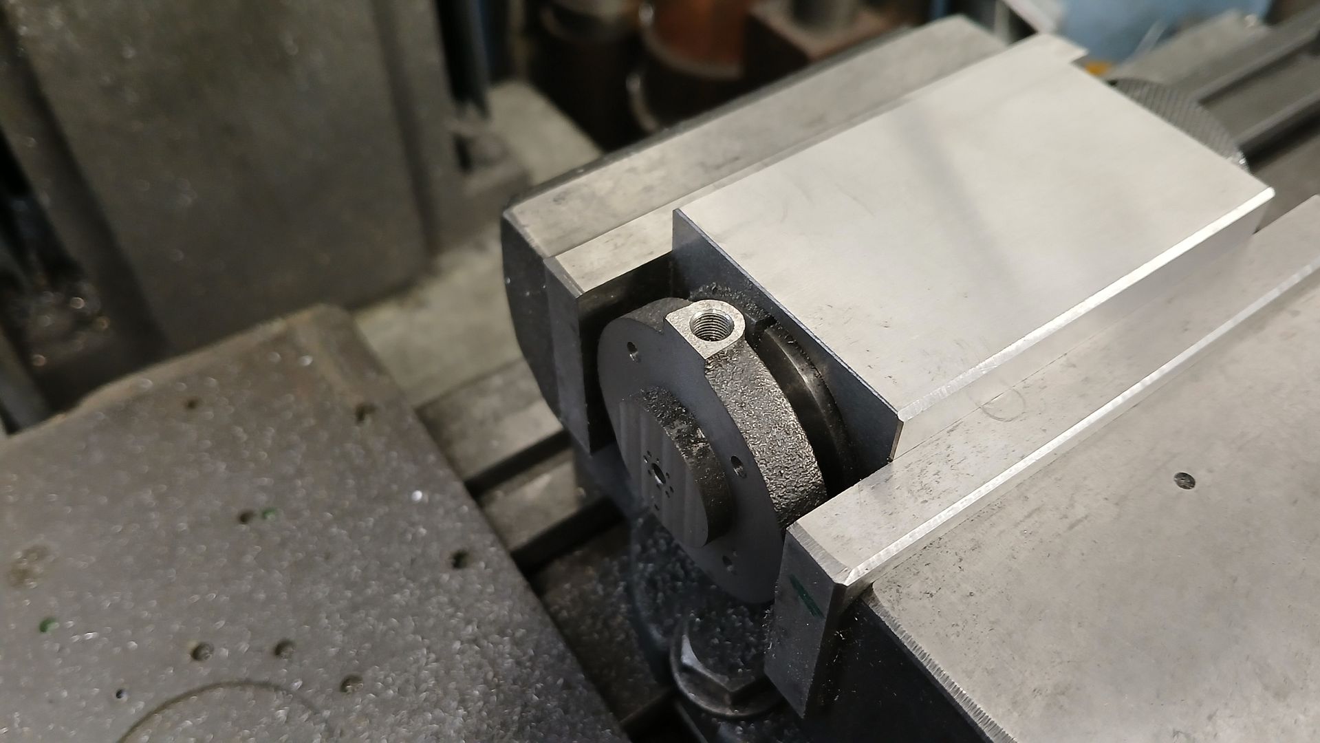

When I designed the engine I allowed for a smaller tapped hole for the hot tube and sized the raised boss accordingly. As it seems likely the engine will mostly get run on a spark plug I milled the boss off and spot faced at 10mm diameter. The hole was drilled and tapped, as it comes close to the end in order to avoid breaking into the water space I clamped a piece of scrap against the end just to stop any risk of the cast iron fracturing.
It was also necessary to mill some clearance into the side of the cylinder head spigot so that it did not obstruct the end of the sparkplug hole.

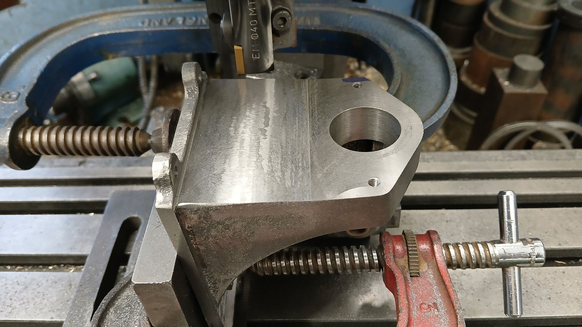

The final couple of jobs on the main bed casting were to drill & tapped the mounting hole for the cylinder oil pot and mill the oil pocket for the main bearing.
Where the cylinder mounting surface had been milled vertical tghere was a bit of a step where the machined surface met the cast one due to the draft angle so I milled away the step and blended the last 0.1mm or so with a file.
Also made an adaptor for a gas pipe and made & fitted a gib head ket to retain the offside flywheel. The crank side is loctited to the shaft and just needs a pin added for extra security.
