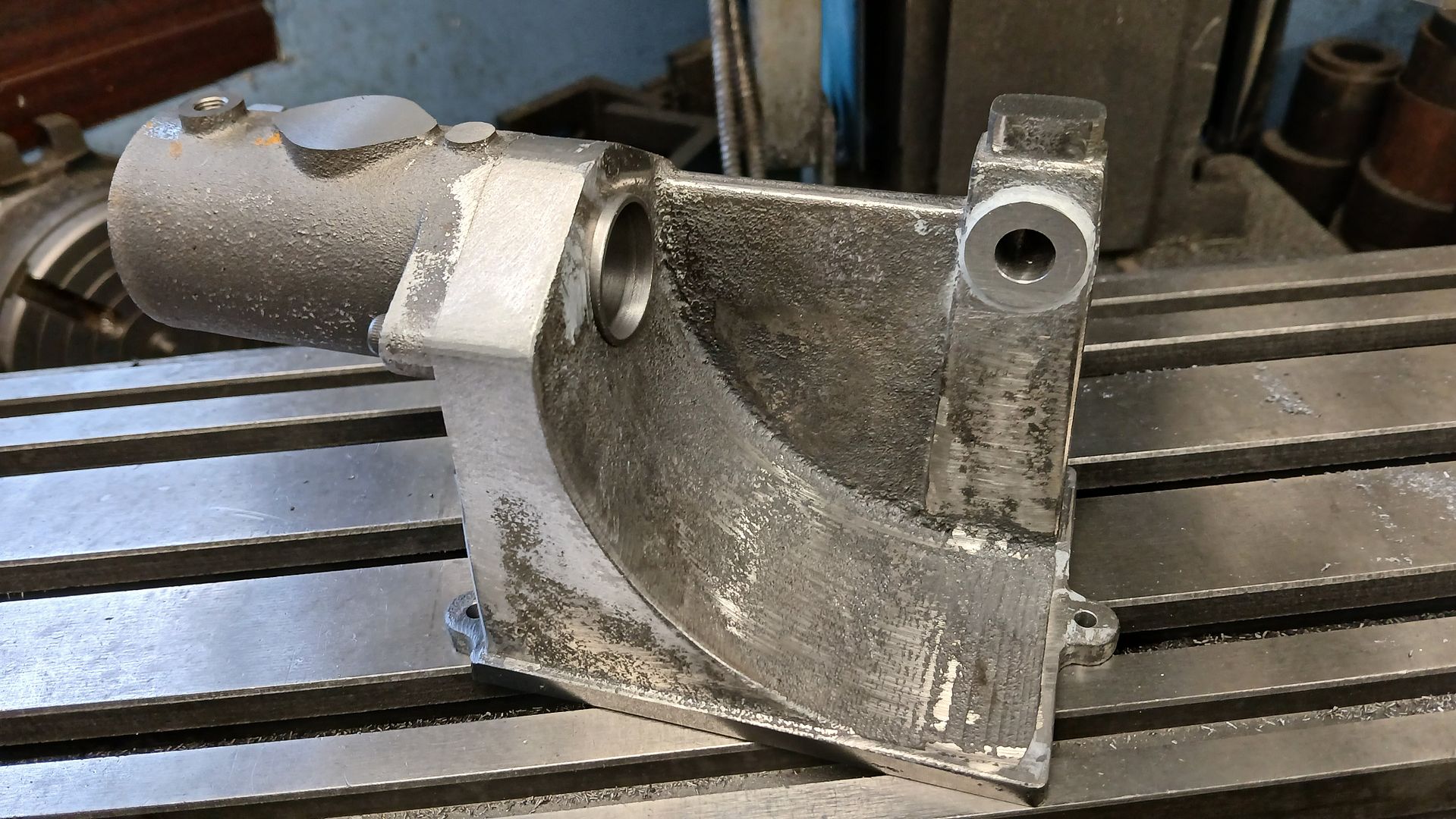

I had not intended to make a start on this one quite so soon but it would seem a third set of castings has found it's way to one of our members who is eager to get going. I only did a few quick preliminary 2D drawings for Graham to use on his engine and they lack the smaller details and are not checked against the actual castings so it really needs this engine to be built so that working drawings can be provided.
I made a start fettling the bed casting followed by flattening the bottom surface enough so that there was contact under the three feet and no rocking. I was then able to clamp this flattened base to an angle plate and checking that the cylinder mounting flange was as close to vertical as possible took a fine skim off the edge flange that runs full length down that side of the bed to use as a reference surface. It wa salso reassuring to find that this thin lip had no signs of chill.
I then used the height gauge to scribe the horizontal ctr line of the cylinder and crankshaft onto the casting. The width of teh cylinder mounting flange was divided in half and the position marked with a punch.
The bed was once again clamped to the angle plate but this time the ref surface was set flat against the mill's table. I used a ground rod to touch off at the very top of the casting and then moved down the required distance to see how things measured up.
The crank position was just a bit more than the distance the mill had been moved which was perfect as it allowed a small amount that was later milled off the cylinder mounting surface. I should say that during the design it was decided not to cast the boss that sticks out either side to take the crankshaft bearings as it would have meant some complicated parting lines. Instead a piece of bar would be JBWelded into place and then machined. So with teh ctr line of the crankshaft now located a hole was bored to take the previously turned boss, I also cut a small counterbore to just remove the draft angle so the step on the boss had something to bear against. There is a "washer" that foes on the other side to bring the boss back upto diameter.
After allowing the JBWeld to set the boss was milled to height before drilling and reaming for the bearings.
The bed was then rotated 90degrees on the angle plate and the ref surface checked for vertical, the punch mark located and the DRO zeroed.  I then milled a flat surface for the cylinder to mount on, the metal to be removed got thicker towards the bottom due to the draft angle. Have not yet decided if I will leave the step or blend it in.
At the same setting a hole for the forward facing part of the cylinder liner was bored and two holes drilled and tapped for the cylinder mounting studs.

The only other thing I have done to the base is to machine the other side of the crankshaft housing back to 19mm from the engine ctr line and then tidied up the JBWeld fillet. I tend to leave the excess filler/adhesive in place until after machining as it probably makes for a slightly more supported joint.
My cylinder came out really well with a good finish and no signs of layer lines from the pattern. We decided not to core this as it is quite a small casting and the cost of the extra material is minimal.
I set it up in the 4 jaw getting the head end as true as you can with a cast surface, the dti was used to get North & South and East & West even together with a square to make sure things were as true as possible.
The flange was then faced back to leave it the correct distance from the middle of the first cast boss and then it was bored. There are three diameters. 26mm at the head end, 33mm for the water space and 35mm for a small lip on the liner to locate it's position length ways.
I then moved the 4-jaw to the mill so that the two mounting holes could be drilled perpendicular to the face of the flange
The head end of the cylinder was milled flat but I left an extra 0.5mm so it can be taken to final length once the liner has been Loctited into place.
With both ends machined it was easy to hold in the vice and mill the various bosses down to height
The middle of the two water connections was located by holding a similar diameter rod in the chuck and moving the mill's table until the position looked right. Then swapped the rod for spot drill, tapping drill and tapped M6 x 0.75. Though 1/4 x 40 would suit if using 1/4" pipe. The other holes will be done once the liner is in place as they pass through it and the cylinder
I then made a start on the liner, first roughing it down to 1mm over diameter which gave me a clean surface to hold while I turned the spigot  that locates in the base.
At the same setting I bored the liner out to the required 22mm diameter.
Then turned it round and did the 26, 33 and 35mm diameters
