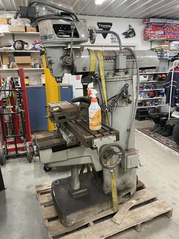

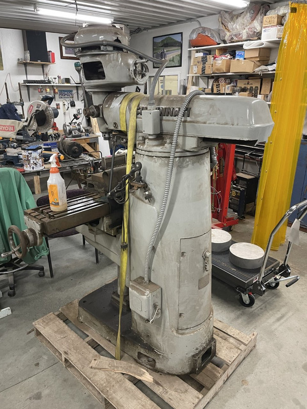

Mostly I'm just testing a photo hosting site - but to do it here are a few pictures of a knee mill I acquired earlier this year. Grubby but mostly in good order (and it was cheap). I'm currently making repairs to the belt drive and going overboard with those, but it should be back online soon.
As acquired.

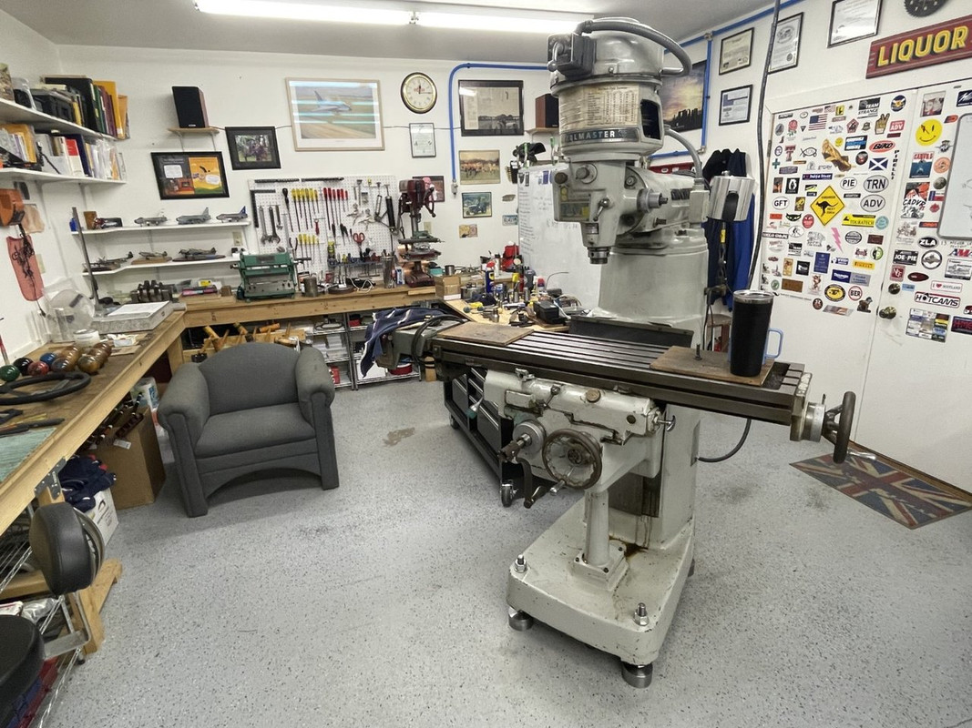

Cleaned and in place.

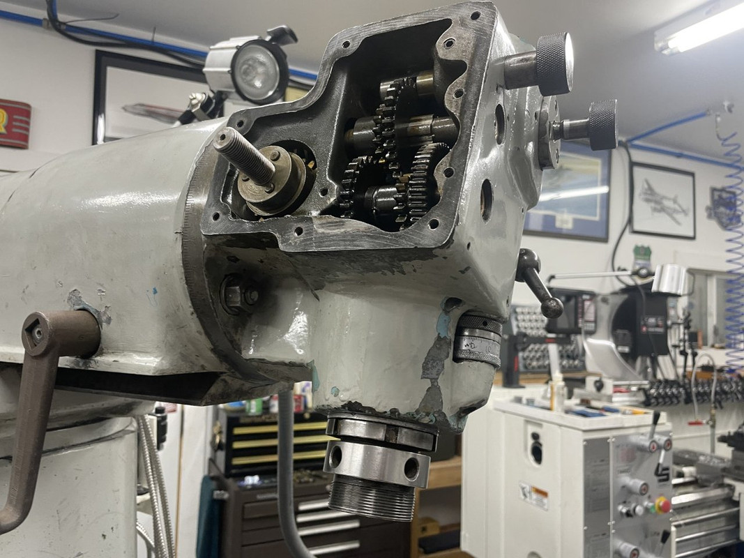

Head apart for maintenance.

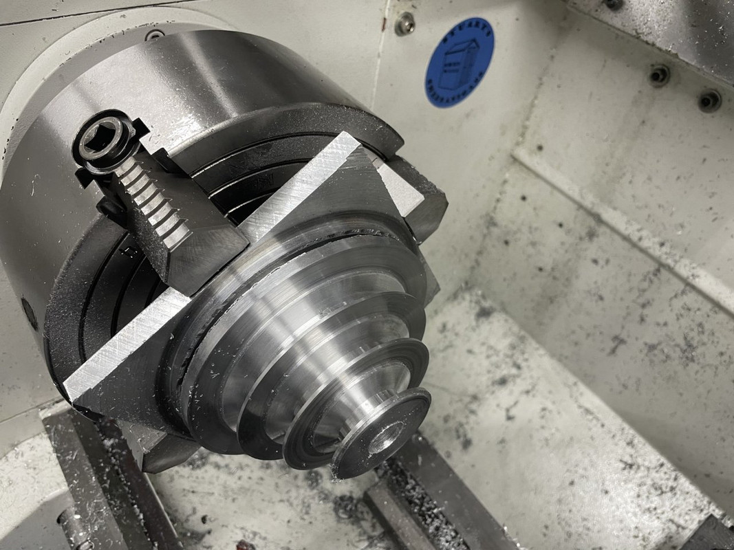

Making a new pulley sheave from a block of onhandium. Actually Alca 5 cast tool plate - it was half the price of an appropriate piece of round bar / rod.

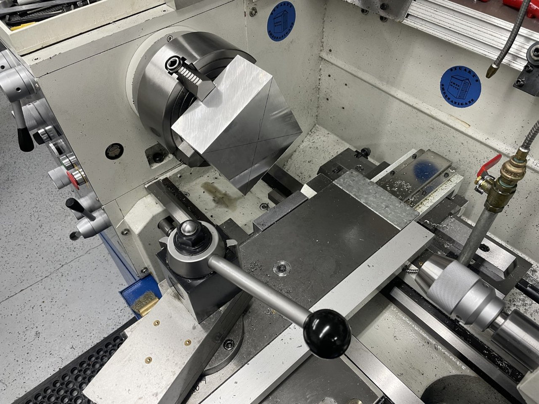

So more turning of the new pulley sheave
New sheave on the left, partially repaired sheave on the right, center boss for repaired sheave in the middle.
So the boss went in some dry ice, and the welded / turned sheave went in the oven.
That all worked, and I had a go at broaching and that worked as well.

The armchair is the perfect vantage point from which to gaze fondly at that beast of a mill...
Offline redhouseluv
  • Posts: 979
Re: Cincinnati Toolmaster
« Reply #10 on: March 11, 2025, 08:56:36 PM »
What a piece of kit, a monster, it would eat my mill for breakfast! Nice job on restoring it
