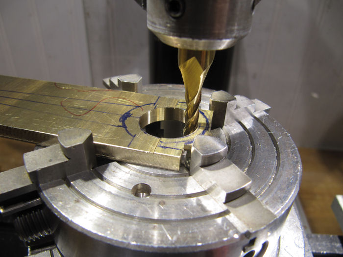

I've gotten a good start on the eccentric straps. Cut strips of brass flat bar, notched the ends of the end caps, and drilled/tapped the pieces so they could be bolted together:

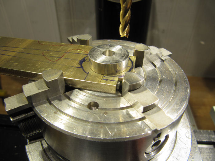

Then set up the four jaw chuck on the rotary table, and centered up the first bar with the center of the eccentric hole on the center of the rotation - took a few tries and tweaks of the jaws to position it, but got lucky that the flats on the bar were reached by the sides of the jaws so they would squeeze down and hold it. Then drilled a starter hole for the end mill. One the left, is the plug gauge I made when I turned the eccentrics a while back, turned on the same bar and at the same time/same handwheel settings as the centers of the eccentrics. I'll use this to gauge the size of the holes, which will save taking the parts out of the chuck and removing the caps to test fit them on the eccentric, which has raised lips on the edge to retain the strap.
Then after a lot of round-and-round turning of the rotary table, got the first hole out to size
When I got close to the final size, I frequently raised the cutter and checked with the gauge and the calipers till it was a nice fit:

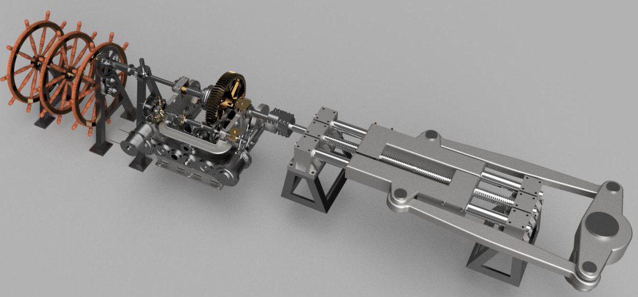

Another background project over the winter was working out the design of another steering engine, to go with the one I built to match Michaels full size engine a couple years ago. Since then I've found original blueprints for a few other engines, on the US National Archives site and the MIT library site, as well as catalogs and patents from other companies. There were quite a few variations on the mechanism, and I learned that some, like Michaels German one, had the extra gearing and clutches to let the same machine do both steam-assisted steering and totally manual steering if the engine or steam supply went offline. Other steering engines only did the steam assisted steering, and on those ships they had a separate manual steering setup, with disconnects on the shafts. Some of the Navy ships would have several options as backup. What I designed is the second type, without the manual steering option, which removes a set of gears and clutches, simplifying the engine quite a bit. This engine looks more like the one I saw at the engine show at Mystic Seaport several years ago, as well as ones made by Hyde Manufacturing and also by Herreshoff. Here is a CAD screen capture of what I've come up with. This may be the next build after the crane model is done. Or the build after whatever else I decide on next...  This design uses the same 4-port D valves for reversing with a single eccentric set that most steam shovels used, where most of the steering engines used a spool valve setup instead - I prefer the D valve style for the models more, much easier to get a good seal.

Or maybe two. One of the plan sets I found was for the steering engine on the battleship Arizona (of Pearl Harbor fame), I have been studying those plans to figure out its mechanism. The plans show all the parts, but not a good view of how they all go together, so going to take some investigation. May need to draw the parts in CAD and see if the 3D parts go together in a meaningful way. I also have the plans for the propellor turning engine from the Arizona, that one is a lot more straightforward. Years ago I drew up the steering engine from the USS Kearsarge - that one all makes sense, but its a huge and complex engine. The engine itself is the chunk in the middle, tow the left are the manual steering wheels (about 8 foot diameter, three to allow a whole bunch of sailors to apply muscle), on the right is the screw shaft mechainsm to actually turn the rudder post at the far right. Huge mechanism in real life!
