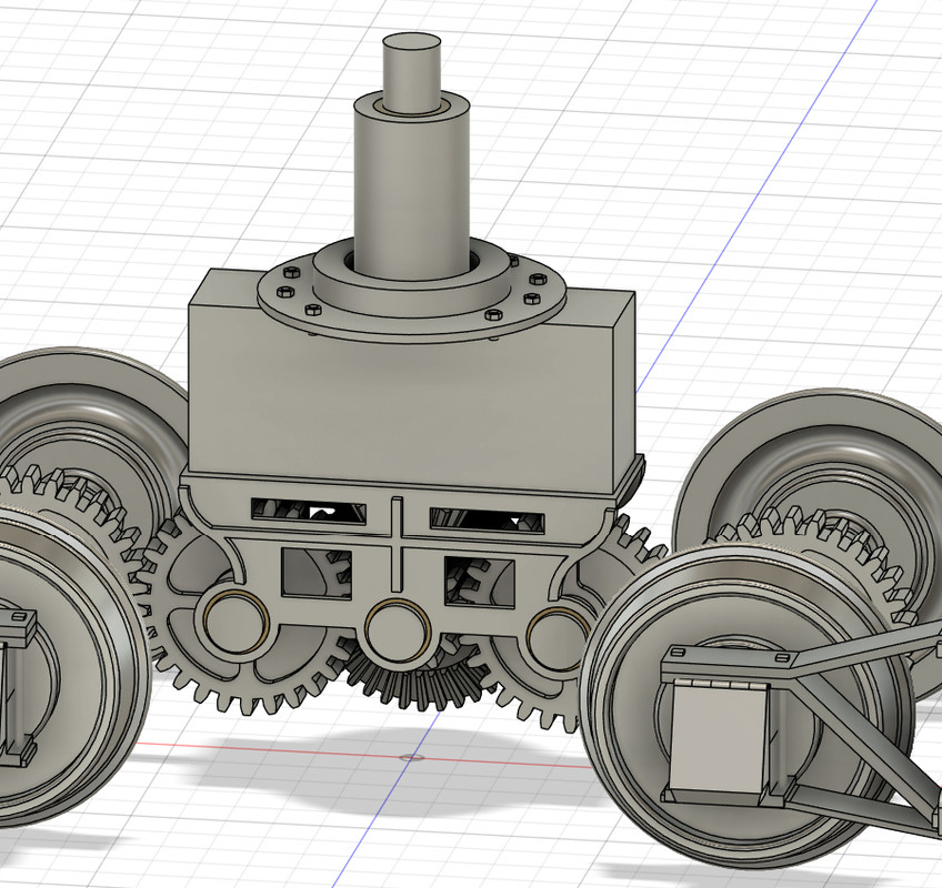

Part of this morning was spent with the roofers, fixing a leak in the new roof where it joins with the old one - this time I got the owner/head-roofer to show up and oversee things directly rather than just dealing with the minions. That went much better, they redid flashing/etc, and hopefully its all fixed, since Monday or Tuesday the drywall starts!
Then back in the shop for some more playtime - starting in on the big gearbox that sits in/under the center of the main frame, taking a vertical shaft from the centerline of the cab down through some bevel gears and out through some spur gears to the front and back wheelsets. As a reminder, this is what its all going to look like:

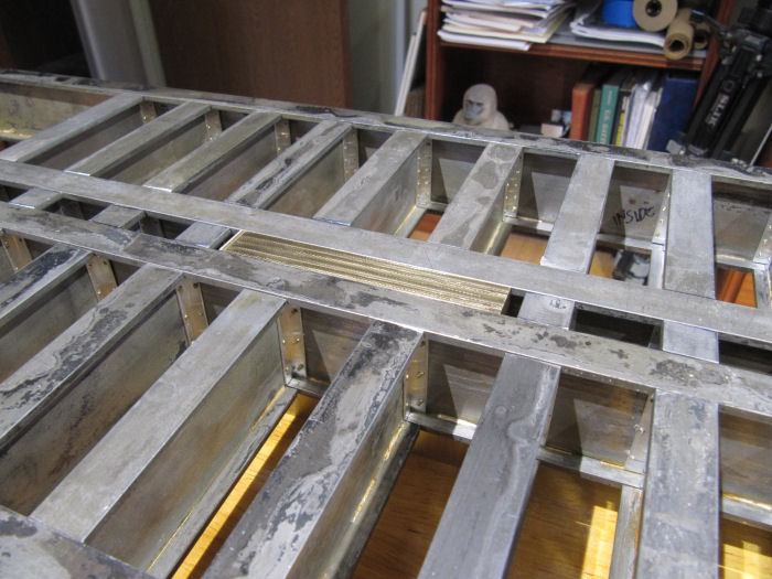

To start, made up the upper block that holds the vertical shaft and the lower plates:
The notch at the top allows it to sit flush with the top of the I beams when inserted from underneath. There will be screws down through the top of the webs and into this block. I got lucky and found an offcut from another model that is nearly the perfect size for this block. Here is where it will sit in the frame - remember that the webs on the bottom of the frame were milled back to make room for this block.

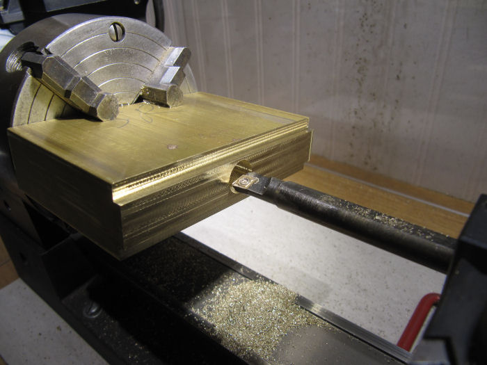

Easiest way to bore a 1/2" hole through the center of the block was to chuck it in the large 4-jaw, centered up on the chuck, and drill/bore through for the vertical shaft:

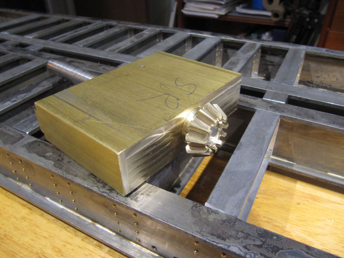

A test fit of the shaft and the smaller bevel gear - this is one of the first pair cut, using a M1.75 cutter.

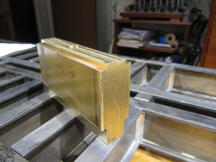

More shaping on the block, cut in rebates on the bottom sides to hold the lower plates:
Then cut the lower plates from some 3/4" thick bar, initial cuts on them after overall sizing was to cut matching rebates at the tops of each to fit the plates to the bottom of the first block. The spur gears will sit in the center gap:
Next will be a LOT of shaping on the lower plates to make them look like the cad drawing at the top of this post...
