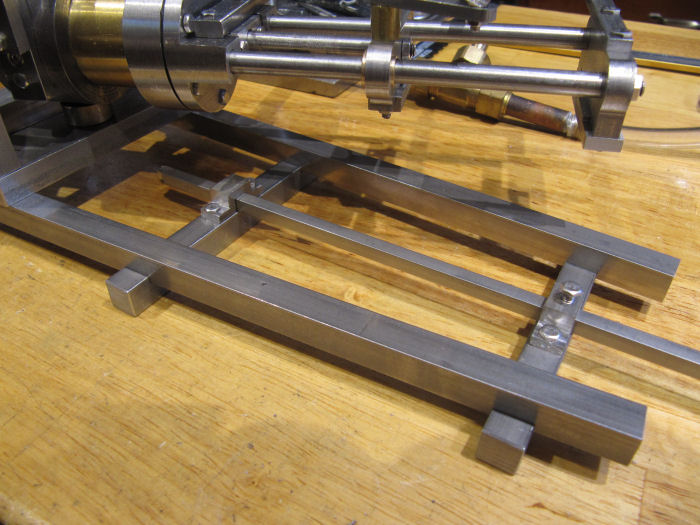

Got the crossbars for the frame notched, using a vise on a rotary base (the Sherline base for their small vise also fits the larger 2x3 vises available elsewhere with some little adapter sleeves for holding them down)
Test fit of the cross bars. They will be silver soldered in place later, after the rest of the parts are made and fitted to them.

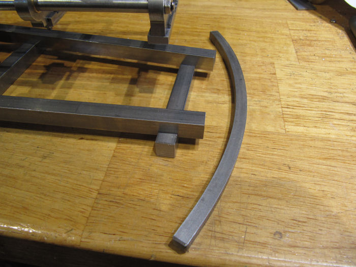

Here is the arch bar that will support the outer end of the guide rods. Took a piece of smaller square bar and ran it through the ring roller - just fit in, had to prebend the very end to get it to start. One pass through at the largest opening put just a little too much arc in it, but that was easily corrected by squeezing it in the bench vise.
Next up will be to make the collection of vertical pars to hold the arc bar, the front stand-off, and the worm gear...

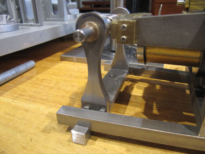

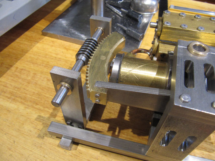

Made up the holder for the worm gear out of some flat bar and bronze bushings. The uprights will get some more shaping to make them look nicer, tapering in the sides and rounding the top, may add some slots like the cylinder holder has too. The bracket is bolted to the crossbar underneath, with the holes for the screws slightly oversize to allow adjusting the mesh of the worm gear.

Chris, that looks good. Very stable and compact.

The worm gear supports went for a spin on the rotary table to shape them a little nicer...
Then milled up the brackets to hold the adjustable post out the front of the frame that holds the machine away from/to the tree
Here they are installed, with a piece of bar for the post. The post still needs the crossbar at the end.
Getting close to done - parts still to make: end bar for the post, supports for the arch bar supporting the guide rails, um, think thats it? Also need to silver solder the joints on all these parts. Then a display base with a 'tree' holder in it, and we can fire up the LoppenElfer 1900!   :Lol:

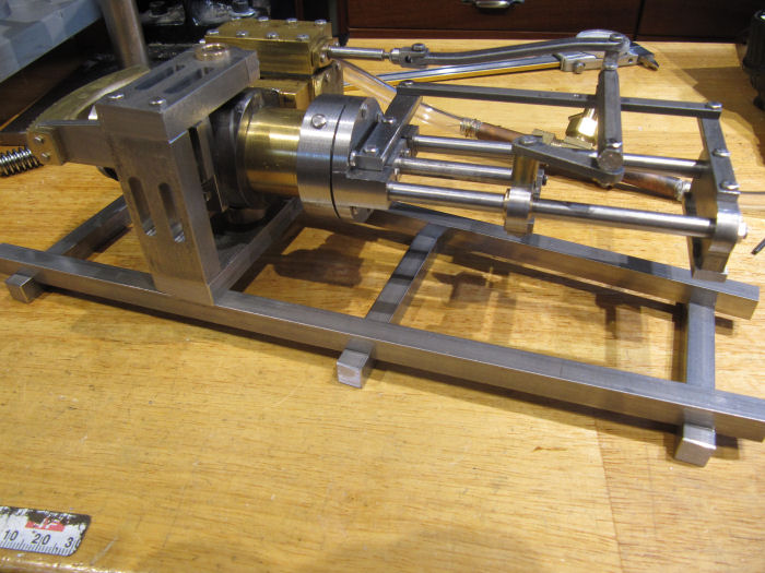

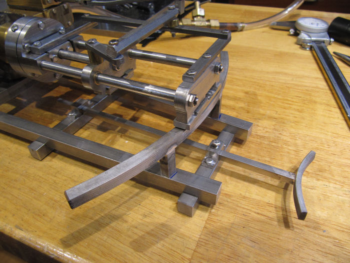

Got the end bar for the tree post bent and soldered on, as well as the legs for the curved saw support bar:
That leaves making the handwheel and a stop collar for the worm shaft, plus soldering up the main frame, then the display base. Close!
