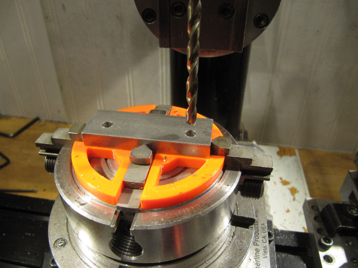

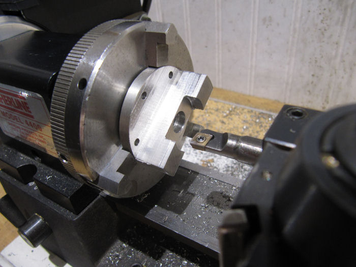

Today started in all the milling/drilling/tapping work on the parts, started by milling the flats on the center ring, one side a narrow flat with holes for the connection to the swing gear later on:
and the other side a wide flat for the steam chest. That side has holes in the side of the ring, so the steam chest can be notched and side drilled for the mounting screws. Don't want to bolt through the chest, since that would interfere with all the other passages and ports.

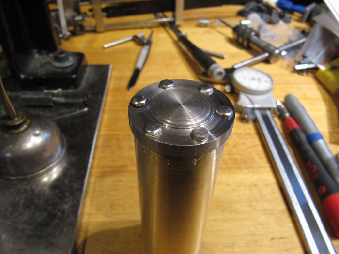

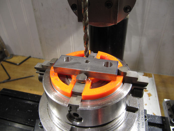

Also drilled/tapped the cylinder end and rear cap:
That means I can get started on the shaping of the front flange/cap, which has also been cross drilled for screws to hold it to the end of the cylinder. Lots more to do at that end...

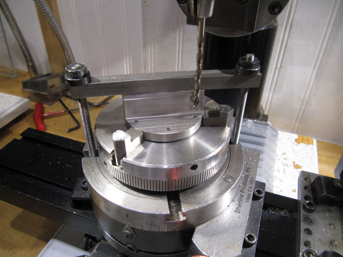

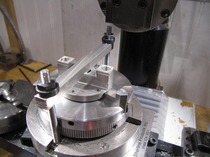

Started in on shaping the front end cap today. It has a tall ridge across the middle to take the guide rods, so started with a thicker piece of the bar and milled off the sides. Since it wasn't that deep in the chuck, the mill had a tendency to rock the part while cutting, so I put a bar across the middle to hold it down flat. Both sides were taken down the same.

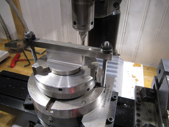

Then drilled the mounting holes while it was still in the chuck and aligned:
With the mill table still locked down in that position, switched chucks and drilled matching tap size holes in the end flange, lining up the holes so the center ridge in the cap will end up horizontal.
I'll get those holes tapped next, then continue on with the shaping of the cap...

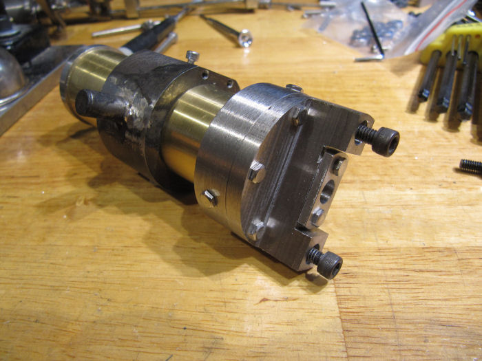

More shaping on the end cap. Drilled/counterbored for the piston rod and gland, and cut the center out more to let the gland be recessed below the ends of the rod supports, leaving room for the nut on the piston rod end where it will go through the moving crossbar later.
Also turned the blank for the piston rod gland, and rough cut out the crossbars for the guide rods. Next time I'll start drilling all that stuff...

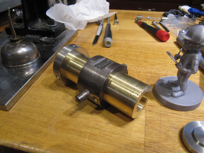

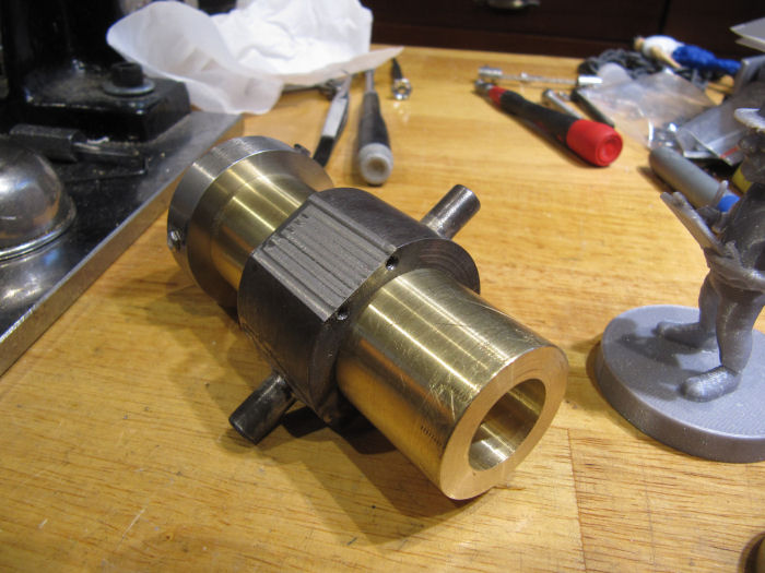

This morning I started in on the guide rod assembly. First was to drill the holes in the cap for the inner ends of the rods. The holes go in .2", then switch to a deeper hole with a 8-32 thread. i'll put a threaded end on the guide rods to screw into the cap. The outer ends will bolt to another plate.
Here is the cylinder with the cap in place, after also making the piston rod gland.

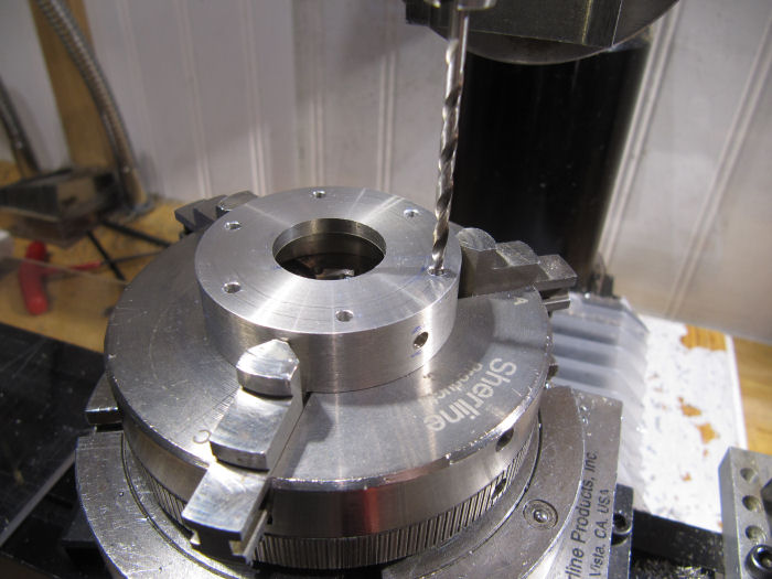

While the rotary table was set up for the guide rod holes, also drilled the two plates - one for the outboard end, other will slide back and forth on the guide rods with the piston. It has larger holes for bearings, and a center hole to attach to the end of the piston rod.
Next up with be the guide rods themselves, and the bearings for the sliding plate. The two plates have the holes offset, since the blade mount will be at the bottom of them. Also need to put holes for the valve links in some of these parts.
