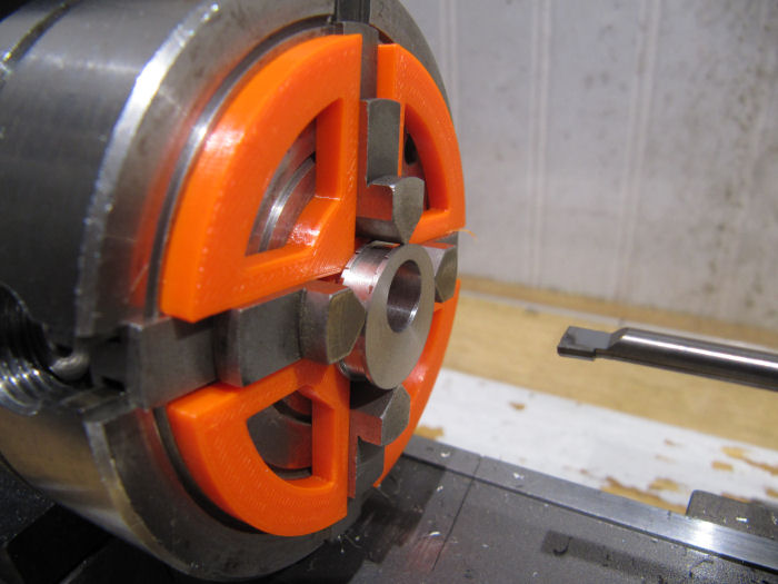

Result looks great - but I got Scared when I saw the picture of the Parallels in the Chuck  :o  Imagine them flying out when the Chuck starts to spin and hurting somebody like yourself  :old:
Per          :cheers:

Thanks guys!
Yup, I always pull the parallels before spinning up!!

Thats why I like to use chuck spiders, spacers that fit around the jaws. You leave them in, and they can't slip out without removing the part.

I'm going to have to look into that! Do you make your own?

Yes - drew them up in Fusion and 3d printed them. You can also make them from some aluminum sheet or bar, just mill in slots to fit around the jaws. I made mine clost to the diameter of the chuck so I could use them for large diameter parts when the jaws were reversed, but you really only need it to be larger than the hole in the center of the chuck. They center is solid to hold the 'wings', so there is a limit on how small a part you can grip unless you have the wings connect out at the rim. I put the holes in the wings just to speed up the printing time. I made a set of three, different thicknesses so I could stack them for different spacings out from the chuck for different thickness parts. Very handy accessories!

I'll have to print a couple and try them out!
