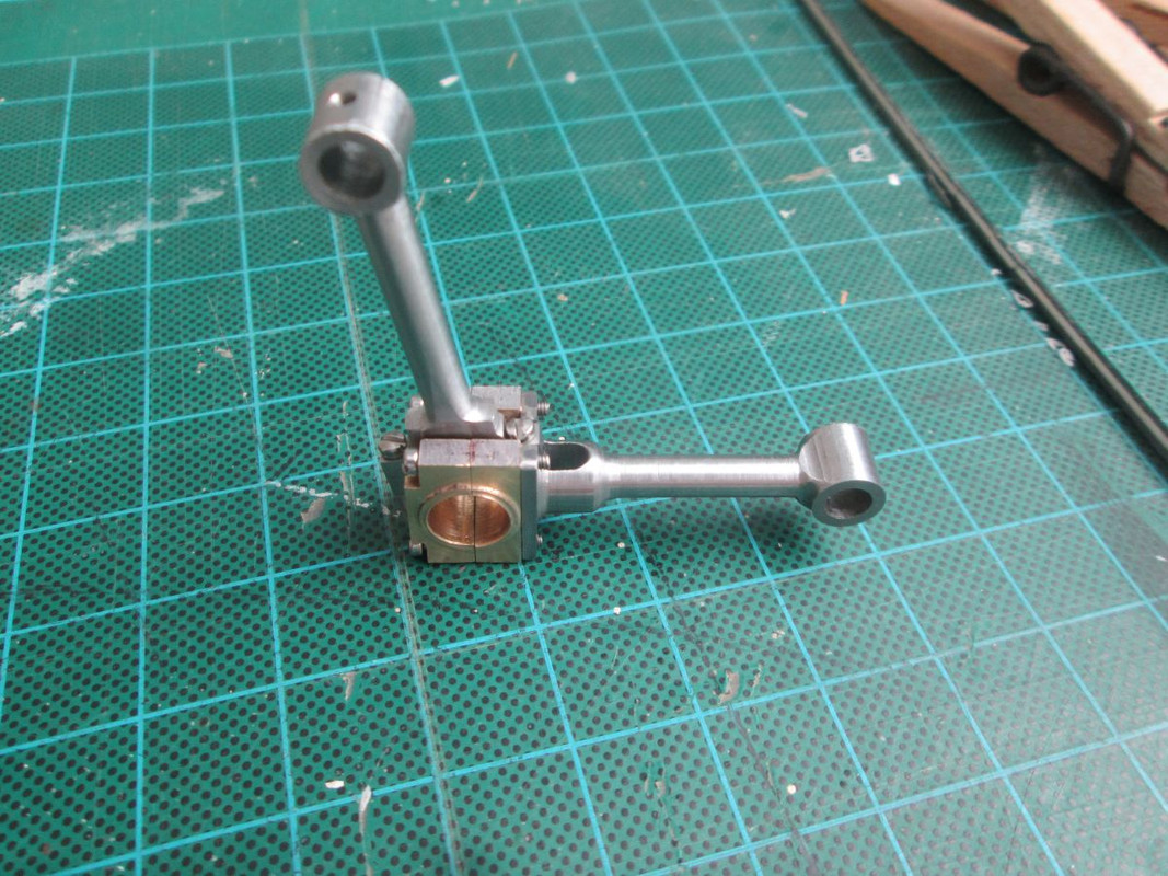

Work has been continuing apace (where apace is synonymous with slowly) on the “fork” rods. The steel uppers are done, and I finished the second of the bronze lowers this afternoon, which gives me enough parts to reproduce the exploded rendering from the factory literature. Two more bronzies left to do, maybe three if I decide I'm not satisfied enough with the first, practice one.

« Reply #280 on: September 14, 2025, 05:13:50 pm »
Thank you very much guys! Always appreciated. :cheers:
Mike - The grid squares are 1/2" (1.27cm). The pin-pin rod length is 1.5" (3.81cm).

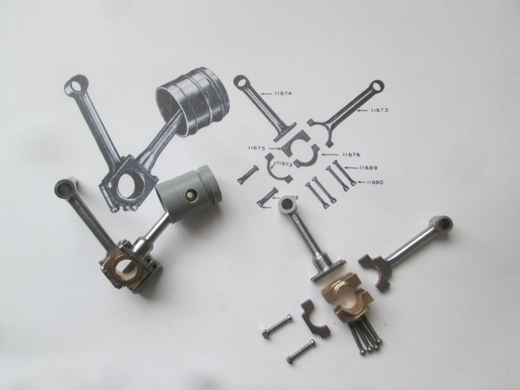

« Reply #281 on: September 19, 2025, 10:57:02 pm »
After seemingly endless delays, interruptions, mistakes, and lazy days off, I've finally completed the full set of connecting rods. Here's a family shot (those are 1" markings on the ruler) and a few process shots of work on the bronze big ends.
After they were reamed to 0.3125” on the mill, they were parted off the bar and the two halves clamped to a just slightly over-size bit of rod, mounted in a collet on the lathe, and the OD finish  turned to 0.374” to form the journal for the knife rod. I never did take a photo of this last step.

Great looking set of con rods, Ron!  It may have taken a while, but the results are great!  :ThumbsUp: :popcorn: :popcorn:
Looks like a very interesting set of operations, too.
