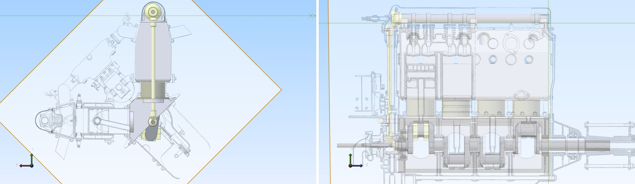

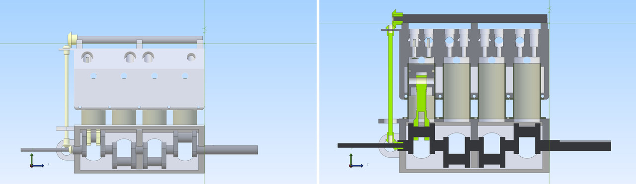

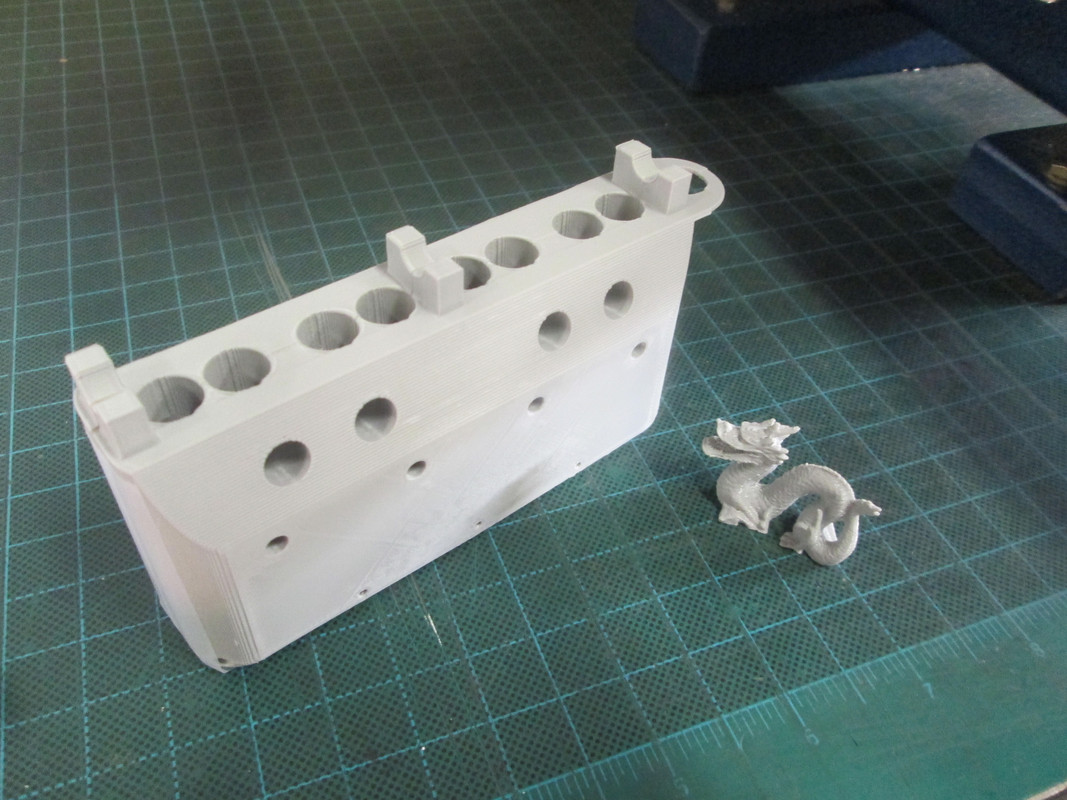

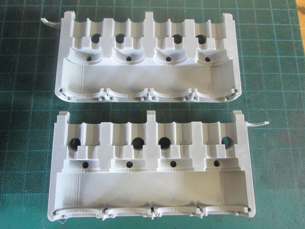

The materials that Mike (Vixen) so generously sent to me have been invaluable in moving the design of this model forward with much more fidelity to the prototype than I could have achieved otherwise. Less squint scale and more to scale, although I admit I will never be purist in this regard.
One of my motivations for getting into the 3D printing world was for its application in Rapid Prototyping. To that end, I asked Mr. Bambu-zle to make a pair of cross-sections of my design work so far on the “Monobloc” so I could evaluate the feasibility of machining it as I intend. In the prototype this is a one piece casting, with the steel cylinders screwed into the upper part of it from below. My plan is to hollow out the area below the valve seat plane from the solid, with the cylinders later screwed to a separate bottom plate. The resulting open volume around the cylinders will serve as the cooling water jacket. In this way, I hope the “one piece” look will be preserved, even though it won't in fact be one piece. I think this will be doable. In the image below, the lower “ridge” represents that separate bottom plate; it won't be there during the machining process.
The cylinders will have a flange that will fit flush into those sockets on the bottom.
The Quality Assurance Dragon is busy looking for nits to pick.

I am so pleased the Hispano Suiza information has found a new home with someone with the desire and ability to build a fine replica of this historically significant engine. You have made a great start by capturing the original 2D blueprint drawings into a modern 3D drawing package. From there you have been able  to 3D print parts to evaluate the machining processes that will be necessary to realise the 'mono-bloc' cylinder block in metal.
It's just a pity you were not able to invest the extra trillions of dollars needed to get a printer which produced high tensile alloy castings and carbon steel crankshafts.   :lolb: :Jester:
Seriously though. The printed parts look to be about 4.5 inches long, I guess this is your chosen scale, dictated by the machine shop inventory. Because all the valves lay on a single plane and inline with the cylinder axes, I can envisage how it may be possible to machine the 'monobloc' in one piece, with the cylinder liners inserted from below. Just a thought, it may give you more options for the cylinder/ cylinder head sealing, if you were to extend the cylinders to the top of the combustion chamber.  :thinking:

Yes, the basic block, minus the flange sticking out that supports the upper end of the cam drive, is 4.4”. Scaling the drawings used for tracing based on a cylinder bore of 0.75” leads directly to that dimension, as well as a crankcase length that allows the option of line boring on the Taig lathe. A 1” bore diameter doesn't work out as well.
Extending the cylinders to the base of the very top of the combustion chamber as you suggest  is an option I've considered, though the drawing shows the other option. I don't yet have a strong preference. Just one of many details to work out and decide on before cutting metal.

3D printed parts are perfect to check any set up at the machines.
