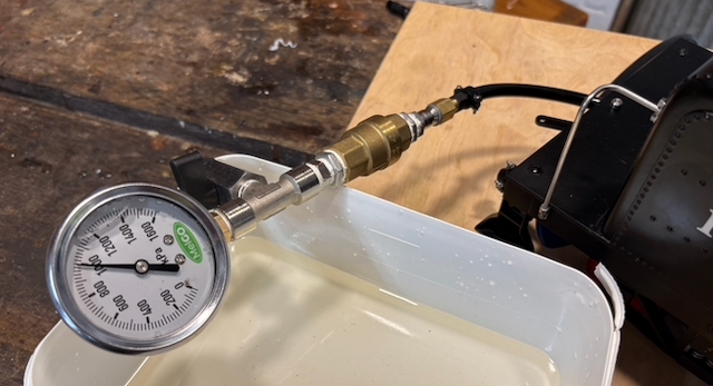

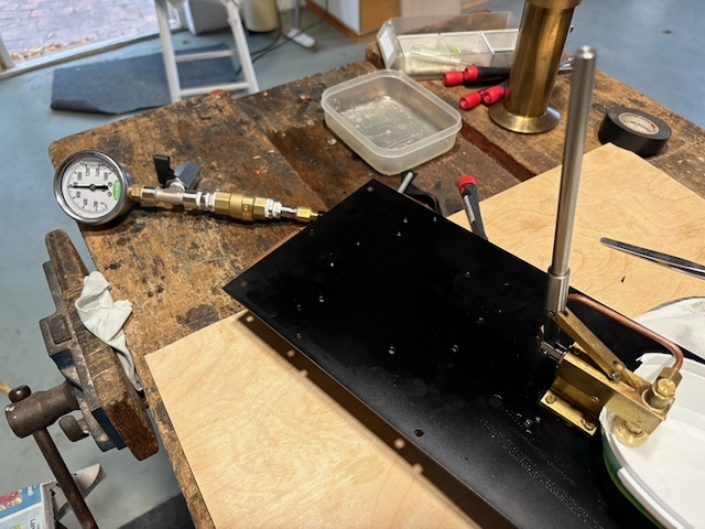

Today I pressure tested the hand pump and high pressure plumbing.

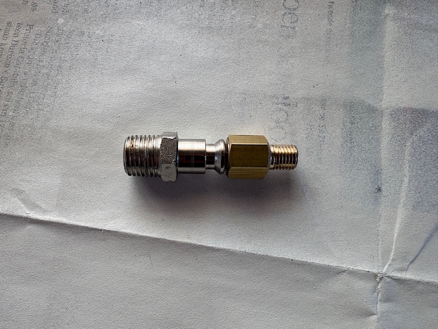

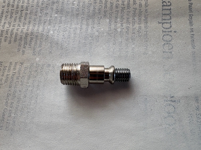

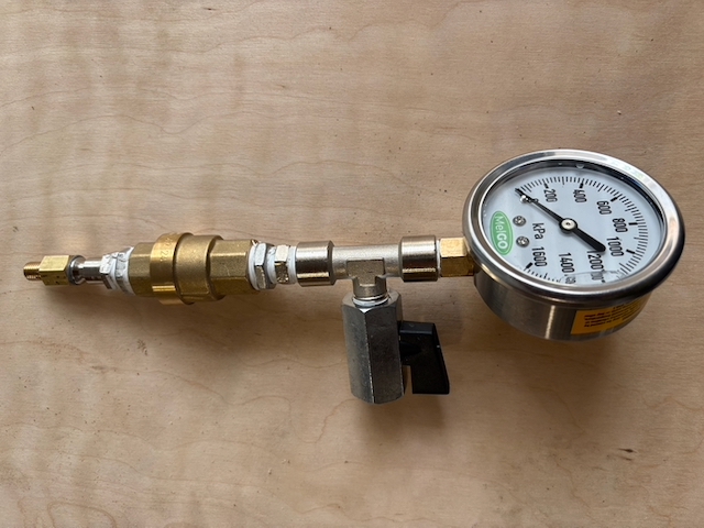

Following Blondihack's lead, I first made a boiler simulator, consisting of a pressure gauge, a standard irrigation non-return valve and a blow down valve. All have BSP taper threads.  The available (pneumatic) adapters also only have BSP taper threads. I do not have any BSP taps and/or dies and they are expensive! So I modified a  pneumatic quick release connector that only costs about 2 dollars into a BSP to M8 metric adapter.
This adapter was then screwed into and epoxied to a brass adapter that accepts the M8x1 union nut and brass nipple at the end of the high pressure rubber tube.
And this is the complete boiler simulator:
After fiddling a bit with the pump and plumbing, the maximum pressure reached was about 800 kPa, or 115 PSI. At this pressure the nipple joint popped out of rubber tube. The hand pump was not close to its limit yet.
Conclusions from the test:
1. The hand pump is more than capable of pumping water into the boiler up to its maximum working pressure of 100 PSI.
2. The rubber tube is way too soft and acts like a balloon. A flexible high pressure rubber tube will have to be found.
3. The nipple joint for the rubber tube may need some barbed ridges to prevent the tube from sliding off.

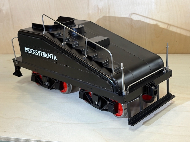

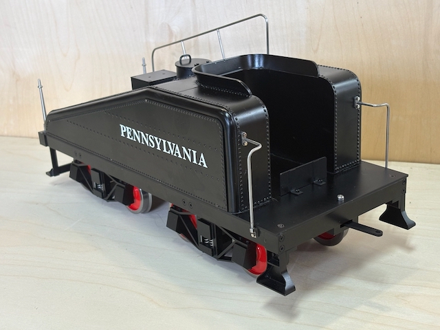

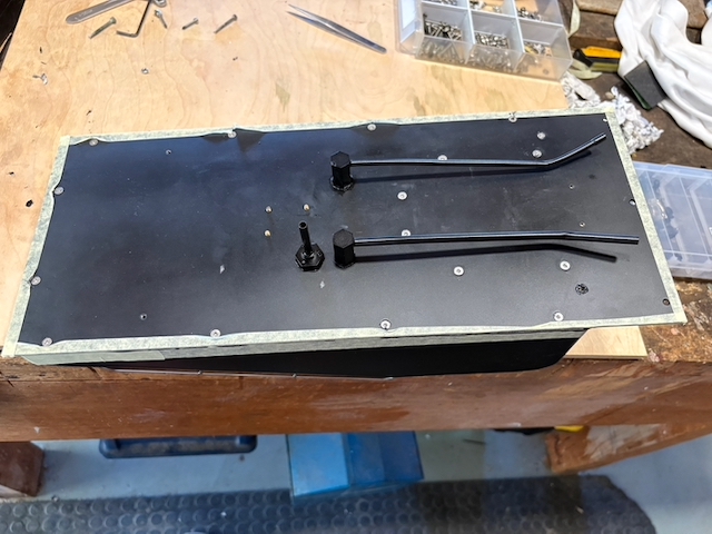

The tender tank must be sealed during assembly. Generous amounts of SikaFlex sealant was used on the inside of the tender to seal any potential leaks in the soft solder joints, and where the screws for the steps and railing protrude into the tender.
The tank ready to be bonded to the floor:
The floor, with the pump and plumbing installed and sealed, screwed onto the tank. Holding thumbs that the seal between the floor and the tank will be watertight!

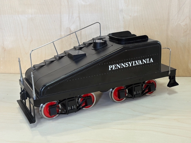

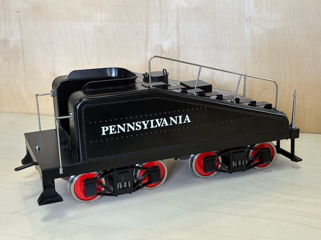

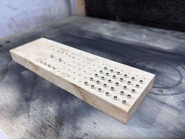

To complete assembly of the tender, all the visible screws in the trucks, frame and tank were replaced with scale bolts from Knupfer. The heads of these stainless steel and brass bolts were first spray painted black.
All the bolt heads ready to be sprayed black in the spray booth:
Finally, the tender is fully assembled! The e-clips holding the trucks under the frame installed for the very first time!
When pouring water into the tank, the axle pump suction pipe made my heart miss a beat or two, as it is of course open. With the suction pipe sealed off, the tank thankfully seems watertight!
