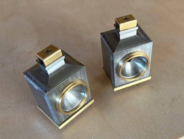

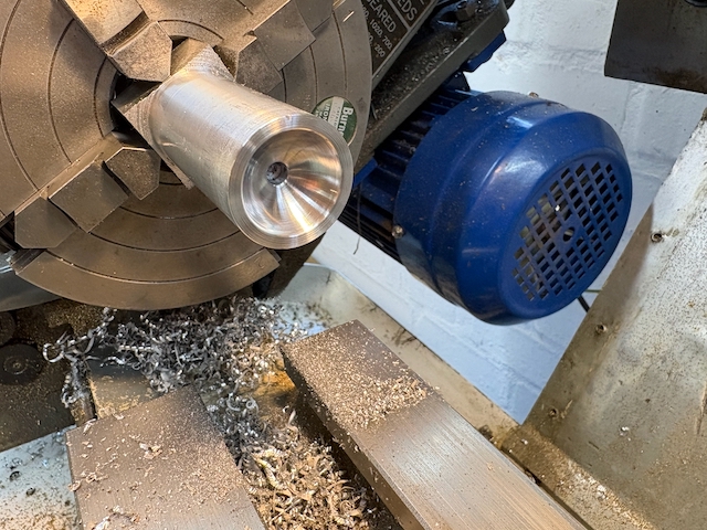

I made an indirect start on the engine by first making the headlights for the tender and engine. I was wondering how to make the curved aluminium reflector, until I consulted Kim's build. Using pre-calculated X and Z DRO coordinates for a ball nose cutter gave excellent results!
The same technique was used with a 3mm ball nose cutter to round the tops of the top covers, as these will be very visible.
The lenses were made from 1mm thick clear polycarbonate sheet, which I could cut with my CNC router.
Two headlights ready for painting:
I modified the inside of the headlights behind the reflector to make room for a PCB that carries a coin battery, a push button toggle switch and a LED. A small hole on the side of the headlight gives access to the switch with a piece of paperclip wire. No need then to route wires from external batteries and switches.

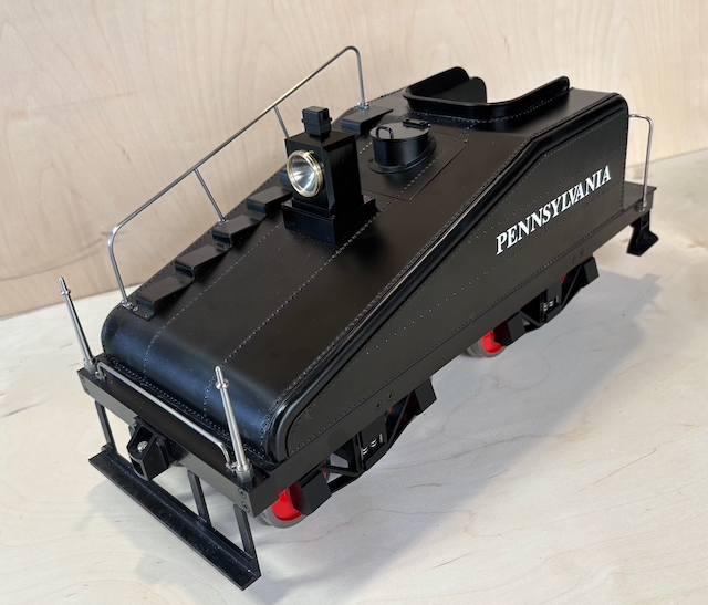

The headlight detail provides a nice sense of realism to the tender:
