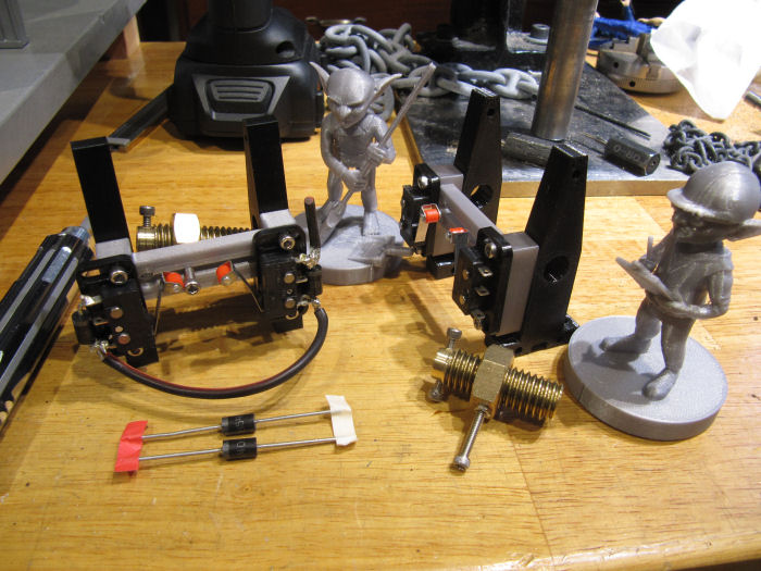

The 3d printer has been put to some good use, making up the mounts/guides for the limit switches. The shop elves also created a couple of new helpers so they can sub-contract THEIR work...  :rant:
These switches are left over from another project several years ago, one set of the switches has the diodes and wire stubs in place, the other doesn't yet, so next I'll be getting out the soldering iron and wire stripper. The diodes face opposite direction, and are hooked across the Normally Closed posts on the microswitches. When the arm from the threaded rod hits one switch, it opens that side, so the power can only go one way across the diode, so it stops the motor from turning any more in that direction, but lets it keep going for the other direction. These will be connected in line to one side of the motor. If hooked up the wrong way, the motor will be able to keep going but not return again!
And when I asked the shop elves and new elf-trainees for a hand with the wiring, this is what I got. Shoulda seen that coming...
For any interested, I found both the hand and gnomes on Prusa's model site. The switch holders I drew up in Fusion.

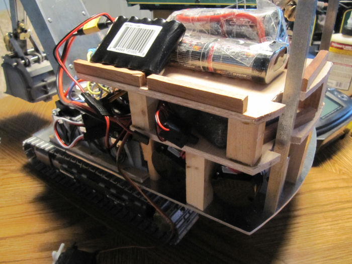

So, the battery/radio trays have been made from some of that synthetic metal called 'wood'. Nothing fancy, just a couple ply panels and glued on legs, with some edge pieces to keep things from sliding out. The lower shelf is holding the radio reciever plus some ingots of lead to counterbalance the weight of the booms.

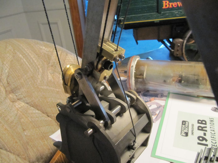

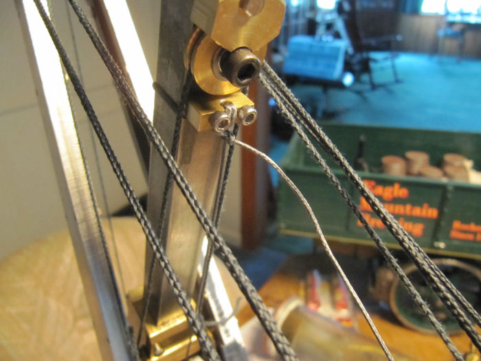

Then turned my attention to the final mechanism needed, the bucket door trip line. The approach I am trying out is to have a line running from the back end of the dipper stick
down the length of the dipper stick to the latch on the bucket door
with a loop in the middle to pull on the line to retract the latch and open the door. When the door opens, the long line goes slack so no problems with pulling the trip line too far. In the center, for now, is a simple loop to test things out and see where it needs a fairlead:
More fiddling needed, but the approach looks to be working. The other end of that line will lead back to a servo in the cab to pull on it.
