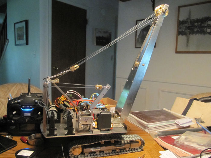

While I was back in the shop working on the Kearsarge engine, the elves snuck down the hall and got out a spool of kevlar kite string to rig up the boom on the Ruston shovel with some pulley shells they made for the sheaves. First they strung the tilt pulleys on the main boom. Here it is tilted up as far as it would be used on the shovel configuration (remember that this machine could be set up as a crane, dragline, shovel, etc with different booms).
and lowered back down to about 45 degrees (for changing configurations, they could lower it right down to the ground, but for the shovel setup this was enough)

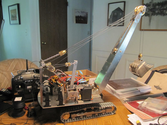

Then to check for conflicts in the cabling, they set up the bucket hoist cable. The drum mechanism is not completely built yet, so the inboard end of the cable was just tied off after going around the motor shaft. Also, since the dipper stick is not made yet, the bucket is just hanging in midair! But, you get the idea of what its going to look like. There was one conflict on the cable routing found, so the inboard end of the tilt pulley was moved over one hole in the gantry crossbar, all clear now. In this picture, the boom tilt is in the middle of the excavator range of movement.
So far so good!  Pieces left to make: dipper stick and its pivot/slide assembly, spring and pull rope for the door latch, servo mount for the pull rope, two sets of cable drums with limit switches, battery holders, then after all is tested, adjusted, fixed, reworked as needed, will make the cab shell. Sounds easy!   :shrug:

Thanks Kim!  The old manuals I have for the original shovels show the routing, but since I am not using the same locations for the winch drums as the original did, a couple minor tweaks needed. All was good out on the booms since that part matches the original. String is a LOT easier to move around than the original steel cables, I'm sure!
