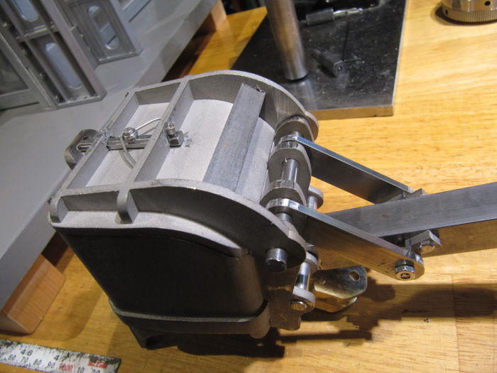

Now that the Kearsarge windlass engine is done (waiting for some replacement chain before posting final pics/videos), its back to this Ruston radio-controlled steam shovel build...
Started with making the brackets and diagonal links to go from the end of the dipper stick to the base of the bucket to hold it in place:
Also, added this square bar to the bottom of the door to give it a little extra weight to help it swing shut and latch:
Next up will be the brackets/pulleys on the dipper stick for the crowd cables...
