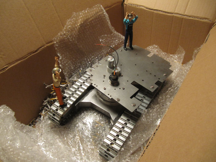

they were able to elf-handle it out of the box and onto the table...

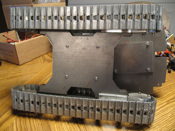

and they flipped it over to get a better look at the underside too

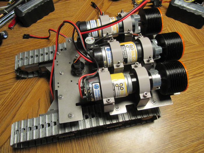

It may look like the motors are too big, but the cab for the RB-19 is wider/longer than the top plate the chassis came with, so plenty of room for the motor, radio, and overhead pulley system it will need. The chassis has a slip ring built in for the wires, so it can spin the cab round and round without messing up the wires to the track motors. I have a bank of speed controls for all the motors (6 of them), plus one servo for the bucket door tripper. There is one motor for each track, one to spin the cab/boom, one to tilt the main boom in and out, one for the bucket crowd movement, and one for bucket hoist. A friend of mine who casts bullets gave me a box of 1 pound lead ingots he had left over with lead that was too soft for his use, I'll seal them with epoxy and use them for counterweight on the back of the cab. The main boom is 18.75" long, dipper stick is 14.75" long at this scale. The manuals I have include detail parts drawings with enough dimensions to make everything accurate.

Should be a fun project! This chassis is something I COULD have made, but Magom had it all ready to go out of the box, very good engineering on it, and saves me a LOT of time just to make the tracks. When done, it should be plenty strong and heavy to do some digging in a sand/gravel/dirt pile, though not enough to dig through sod. Have to set up a sandbox for it! I have some Gauge 1 gondola rail cars for it to fill, also have an old RC offroad truck that could be refitted with a new body to add a vintage dump truck.

Did a little playing around with laying out the parts (radio, speed controls, batteries, motors, etc) on top of the cab floor plate (allowing for the fact that the RB-19 cab is a little larger) and decided on a plan forward for it all. Well, at least an approach to making the plan!   :Lol:
I'll put the electronics/batteries on the floor level, and make another floor above it to hold the gearmotors/cable drums. Otherwise things would be too crammed in and hard to work on. The cable drums dont have to be aligned directly to where they leave the cab - they can be routed through a pulley or two if need be. I really want the layout to be structured such that its reliable and easy to maintain. The motor floor will be removeable from its supports to allow easy access to the electronics level.

Measured the chassis top plate, which is the cab floor, and drew it in Fusion with the outer walls extended to match the RB-19. Printed that out full size and cut out the outside to use as a pattern. Laying the motors, drums, and radio parts on top of the paper pattern shows me that I dont need two levels. Thats great news, much simpler. All I  need to do is stand the speed controller racks upright, and make a holder for the main battery above the motors, easy to do. There are six speed controllers, with all their wires, so they are bulky.
