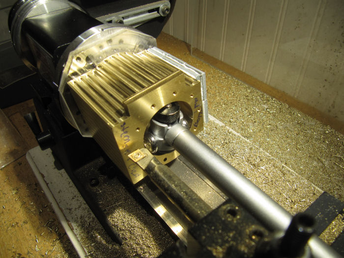

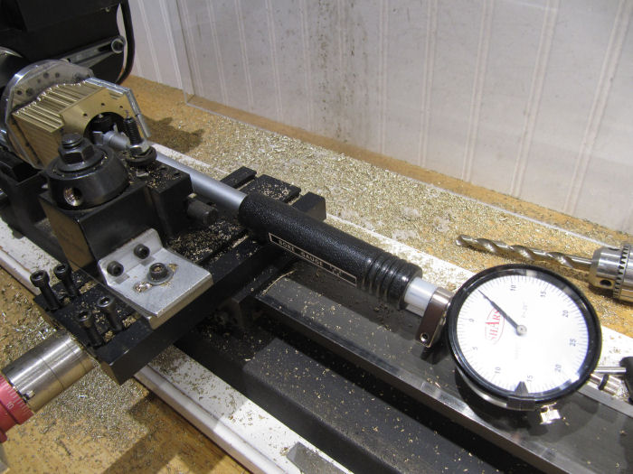

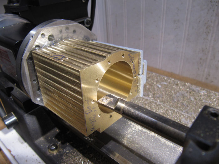

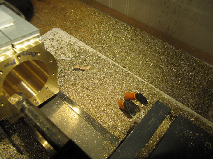

More time turning the crank with the boring bar has the first cylinder block bored out to size. I stopped near the final size to check the straightness of the bore with the dial bore indicator, made a minor tweak to the headstock to get it lined up better, and finished it off.
One down, one to go!
Then started in on the second block. Partway through I noticed that the shop elves are practicing their form for the Swarf Diving event at the summer Olympics...
After fishing him out and sending him off to get his passport renewed, back to the boring work. Second one is close to final size, time to stop and check with the bore indicator to check that nothing on the headstock has moved:
Good place to take a break, will finish off the bore after lunch...

« Reply #888 on: May 26, 2024, 04:37:02 PM »
Very cool bore indicator, Chris!  When'd you pick that up?
Oh, and nice work on the cylinders too!  :Lol: :ThumbsUp: :popcorn:
  • Posts: 18987
Re: Kearsarge Windlass Engines
« Reply #889 on: May 26, 2024, 04:52:23 PM »
Got that one a year or so ago. During the Ohio engine as I recall? The instructions for it stunk, so it took a while to work out all the accessory bits for different size bores. This one has parts to measure from 0.7" to 6", using different length arms for the various diameters. For the Sherline its a must, since any time the headstock is removed for riser blocks, etc, the alignment can change. They have a keyway, but that just gets it close. For the mill I have one of those two-dial units to set the tram.

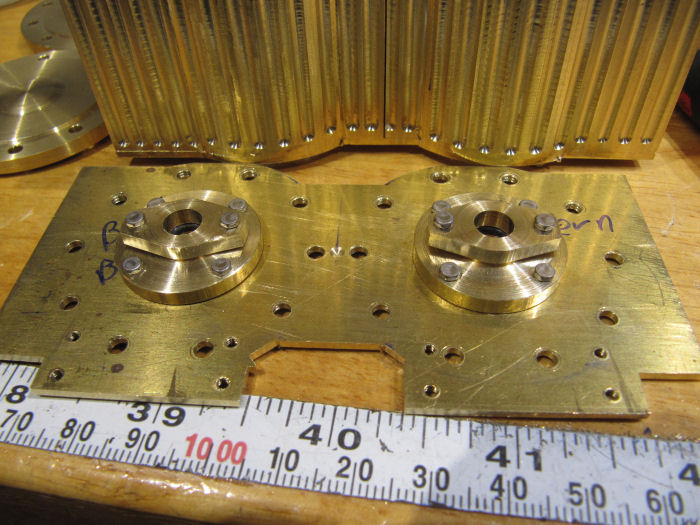

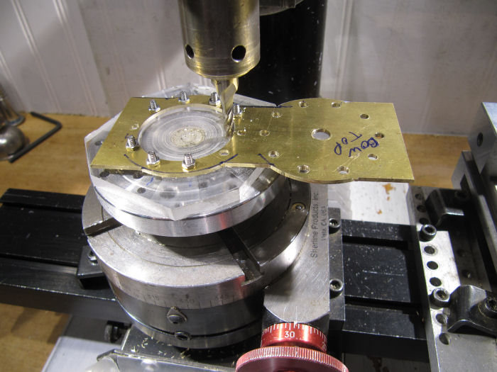

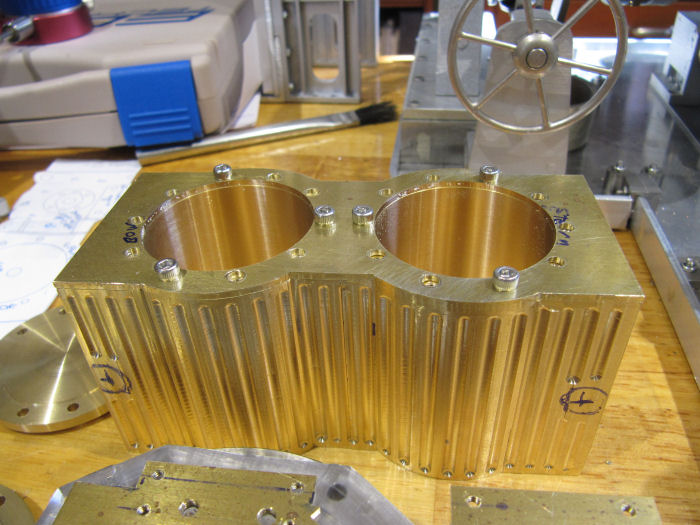

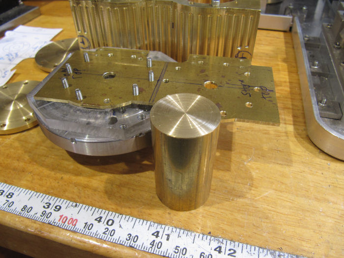

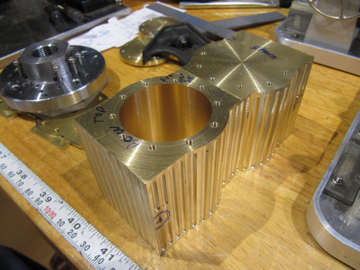

After getting the cylinders bored out yesterday, next task was to get the top plate bored to match. That was done with the plate screwed to the faceplate just like the cylinders were, but the opening was done on the rotary table with an end mill, since I didn't want the other end of the plate zinging around on the lathe.
Bolted up to check the fit...
Then on to the bottom plate. It is not bored through like the top one is, the original engine used a blind bored cylinder block with just the piston rod gland at the bottom. Here is the bottom plate ready to drill the mounting holes for the gland, plus the 'kit' for the gland - a short length of brass round bar.
After some turning and drilling/tapping, the glands were bolted up (no gaskets yet between the gland and the plate). The seal is with a Viton o-ring inside the gland set.
Almost done with the cylinder blocks, right?  Um, wrong! Long way to go on them. Still to be done:  steam chests/lids, ports/passages, vertical/angled columns and their bases, exhaust flanges/pipes, gaskets, ...
