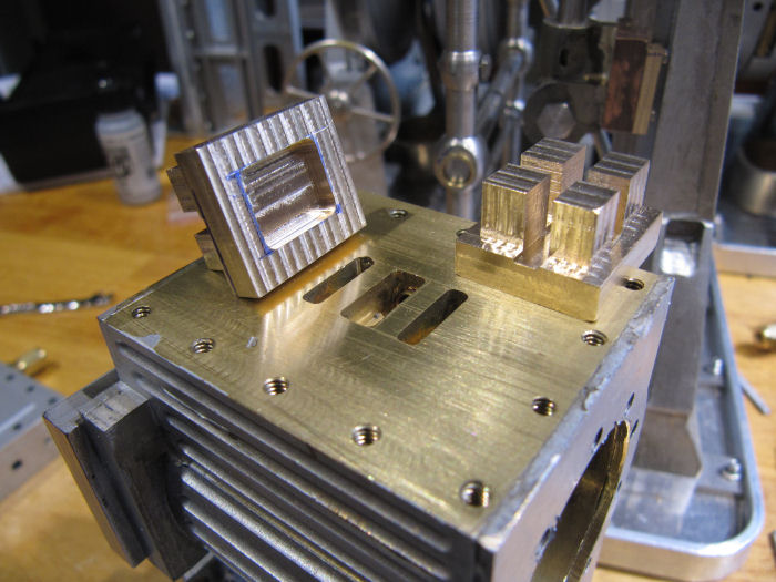

Shaped the cavity on the first slider, cut it off the bar, then did the other the same way:
Some more shaping on the other sides, and they are ready for lapping...
After that will be making the valve rods, adjusting nuts, and glands. But, that will all have to wait for Monday, next few days have another event coming up that takes priority to playing in the workshop.

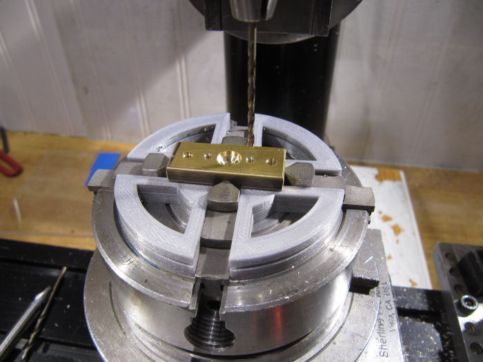

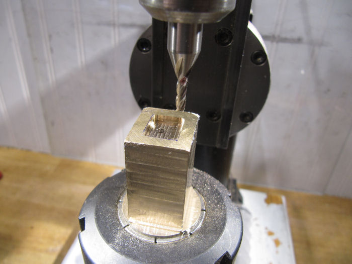

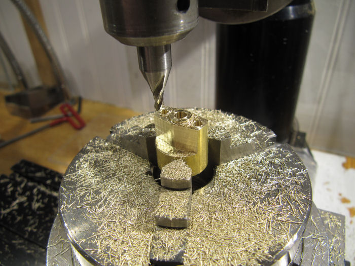

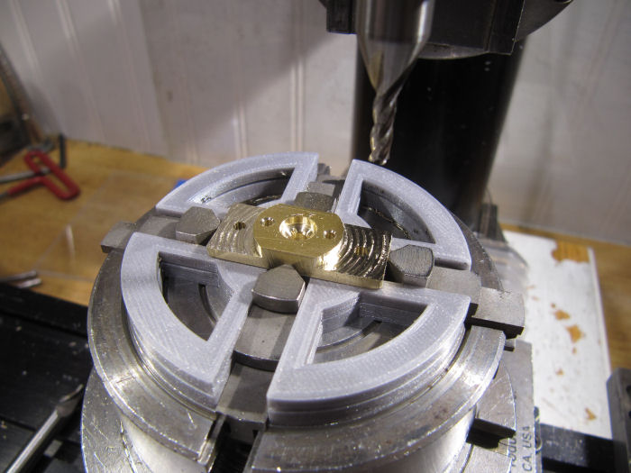

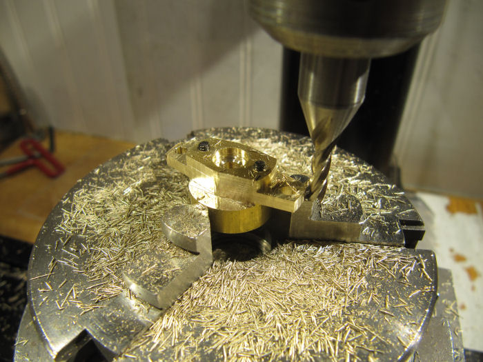

Okay, back in the shop after the trip up to Maine over the weekend to drive the steam and gas Lombards at the logging museum for their first summer event. Great fun!  On the way up, stopped in to see Ron Ginger at the WW&F Railway Museum to see him and the progress they are making on a new passenger coach and a locomotive, and on the way back stopped in to visit with 'Steamer' Dave, who had helped me greatly with the Sabino and Ohio engine builds. I'll be posting some videos and pictures that others took at the event once they are done editing and posting the videos.

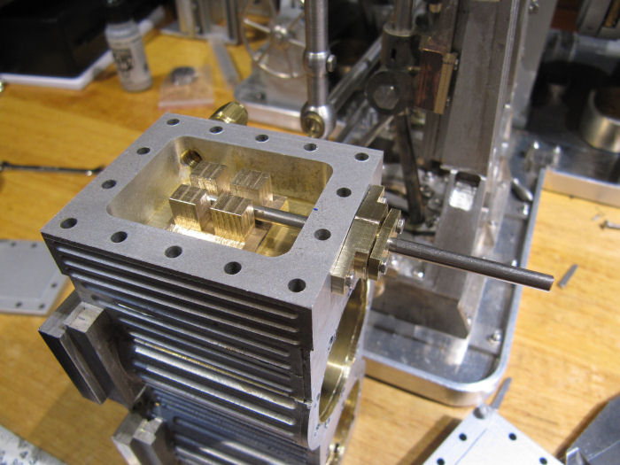

So, back on the Kearsarge engine: next up was to make the valve rod glands. As my usual method, am using o rings around the valve rods, and a two piece gland. Started out with some offcut chunks of bar from the 'scrap' bin, chucked up in the 4-jaw and drilled/counterbored the holes for the rod and the o rings. Then moved the chuck over to the rotary table on the mill, and drilled the mounting holes: one set on the outer ends to hold the gland bases in place, and an inner set to hold the gland caps.
Milled the ends of the base down thinner, then did the same steps on the other base.
Took a short length of round bar, drilled the rod hole through and turned in the little step that will press into the o ring on the first cap. Moved over to the rotary table, and drilled the clearance holes for the mounting screws to match the bases. Then milled the sides in to form the tapered wings:
After parting off the first cap, repeated the milling steps on the second and parted it off. The leftover bit of rod, with the holes in it from the actual parts, then became a handy holding fixture to finish off the bases on the mill
Here is one set screwed onto the bottom of a steam chest, with the blank for the valve rod in place (o ring is in there too)
There will also be a bracket/arm coming out to support the valve rod against rocking, need to make that still.
