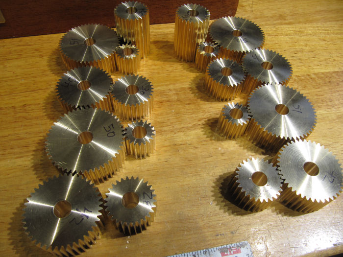

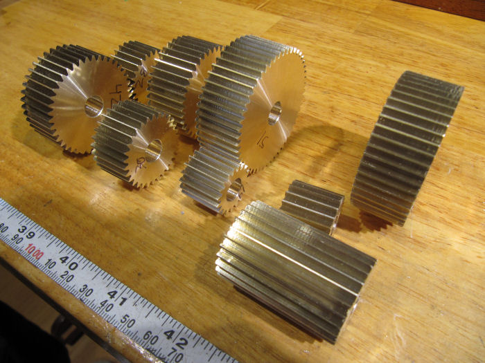

All the gears are successfully cut!   :whoohoo:     Here are the sets, one for each model:
Here is one of the sets arranged about like it will be in the finished model. The input shaft comes in at the upper left, the output shaft goes out at the upper right. The long gear at the bottom right is the reverse idler, it will connect the two right hand gears. Some of the gears will be fixed to the shafts, some will be free-spinning when the respective clutch is not engaged.
Next up will be to cut the dog clutches...
