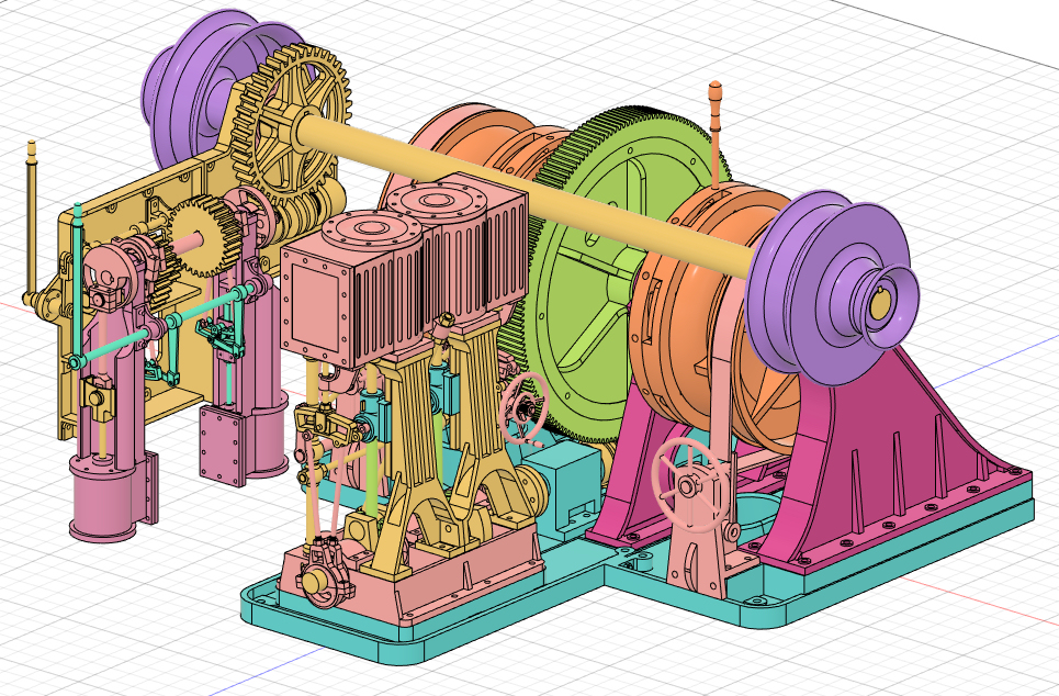

A while back I changed the CAD version to use a valve setup like the feedwater pumps do, with the two slide valves, which should work, but the valve block is just too large and chunky to look good. Probably going to rework it at some point to make the valve block smaller to be better in scale with the saw - I had just copied it from the pump model as-is, it needs to be 1/3 or 1/2 the size to look right. Trick will be to keep enough flow to make the saw perform well with enough power.
In the meantime, I have gone through the other plan sets/cad models, and think I've settled on a chain/rope windlass set, based on plans I found at the National Archives a while back from the early 1900s battleship Kearsarge. It has a pair of two-cylinder steam engines, a 8x8 and a 15x14, one driving the rope drums and one driving the anchor chain drums. They sit nested in a small deckhouse on the ship, should make a fun pair to model one after the other. I've started making up the paper plans from the CAD model at 1:10 scale, which works out to a .8" bore on the smaller engine and a 1.5" bore on the larger one. Here is a screen grab of the CAD model, minus the deckhouse walls. The smaller engine would mount to the port side wall, the other rope drum projects through the starboard side wall. The chains would come through holes in the fore side wall.

Nice!
