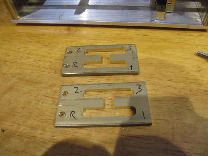

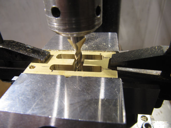

Getting really close: after lunch out with friends, went back into the shop and marked out the locations for the shift gate, using the lever to move to each position and marking off the end/center points on the plates. Over to the mill to cut the slots went pretty quickly:
then back to mark which leg did what:
Next step is to head up to the engraving machine and cut in the letters/numbers. I'll fill the letters with paint to make them stand out. After that, last parts will be to make the detents (might do them with a single sping loaded rod, or two ball bearings, not decided which way yet. Also am debating whether to hang a RC truck differential off the output shaft to show the direction/speed, or might just make the front half of a drive shaft yoke fitting. Should have this wrapped up in the next couple days!

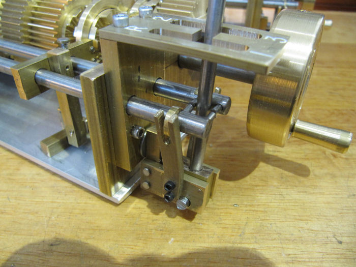

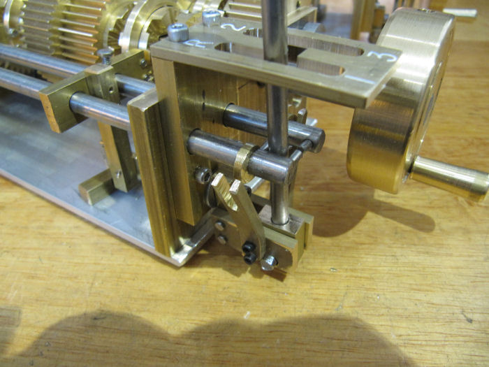

So, I put my crack(ed) team of engineers on the problem of how to handle keeping one control rod in position when the other is being used. They had the emergency team standing by in case of explosion or someone being sucked into the machine:

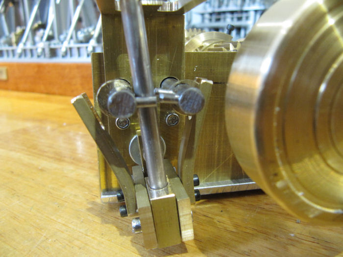

Bottom line is that the detent idea was thrown out. It would work for most cases, but if the end of the rod was bumped, it could still move out of position and jam things up. So, new plan: add a couple of arms to the lower gear shift lever bracket that would move back and forth with the lever, and engage the unused rod with a yoke around a projecting piece on the rod:
This is working quite well. It prevents the unused rod from moving at all, and only lets go when the lever is almost fully engaged on the new side. Here is a view with the lever moved towards the camera, showing how the yoke comes off the projection:
And a view from the end, showing the same yoke setup on both sides:
All working well, time for some final shots and a video!

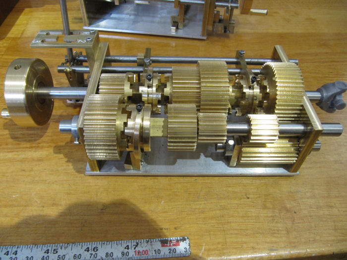

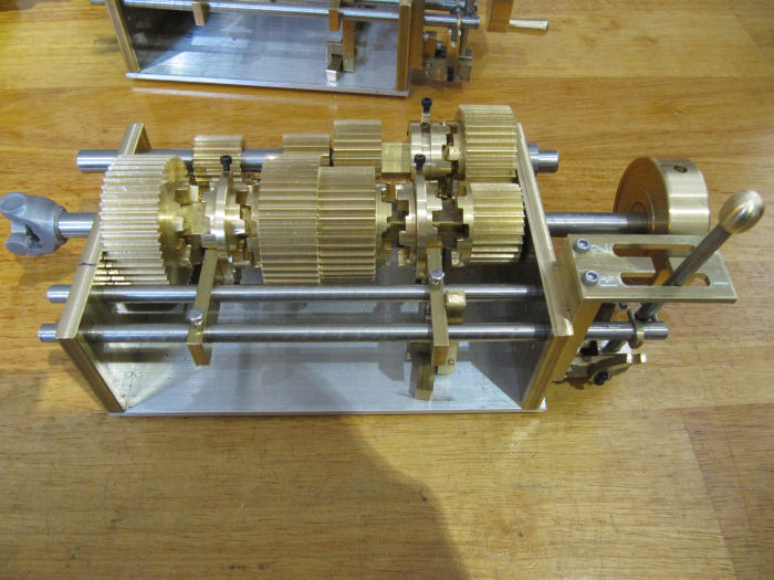

Here is a couple shots of the finished transmissions:
All appears to be working well, once in a while it takes a double-clutch if the dogs line up with each other and wont mesh, since there are no syncros in this design.  Next step was to take a video showing how it all works:
