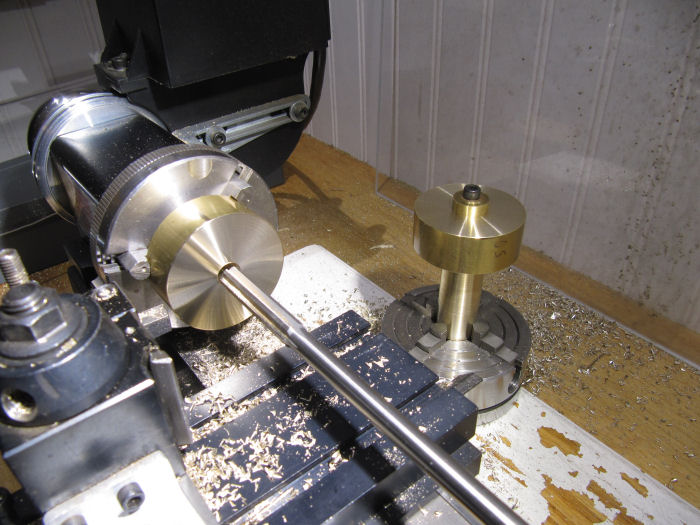

Got all the blanks trued both sides and trimmed to thickness, have started drilling/reaming the shaft holes in them, ready for turning to diameter on the arbor that will also be used for cutting the gear teeth (background).
Its repetitive work, but its Cotta be done!   :Jester:

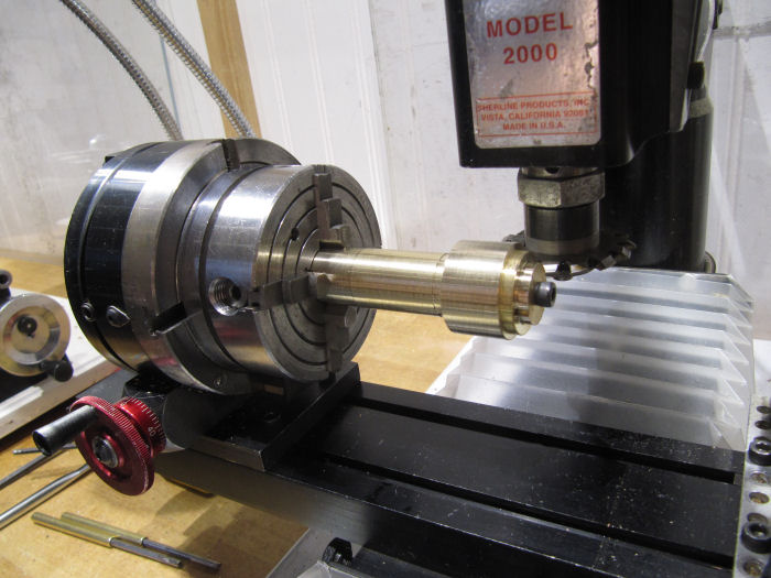

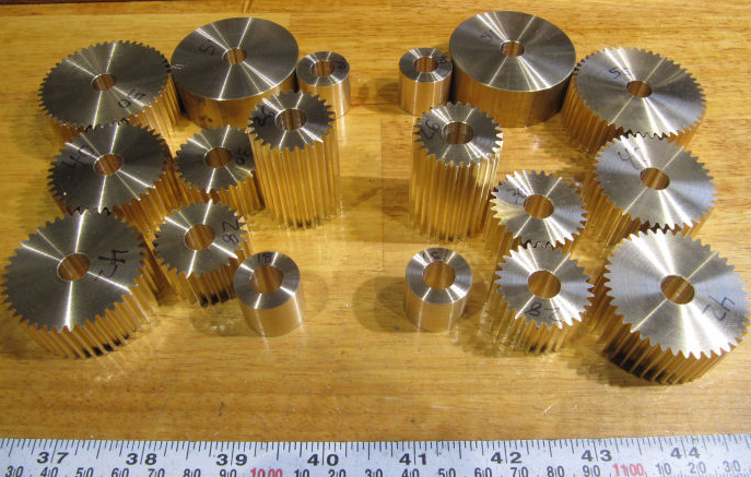

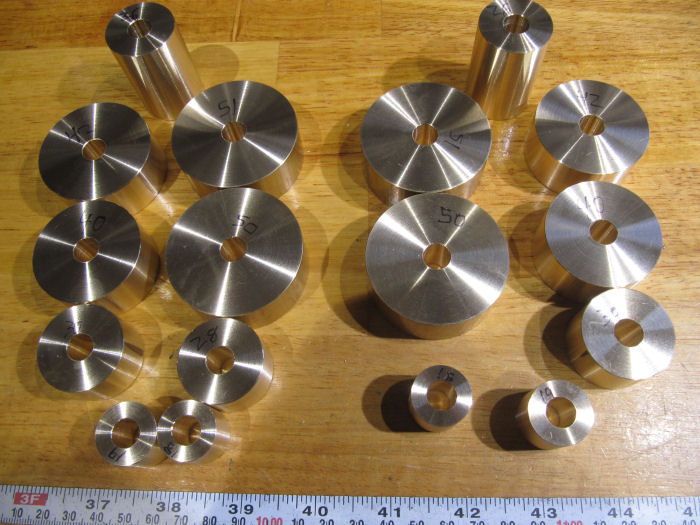

All of the gear blanks have been trimmed to length and diameter now, here are the sets for the two copies of the model I'm building (minus one that is already over on the arbor on the mill)

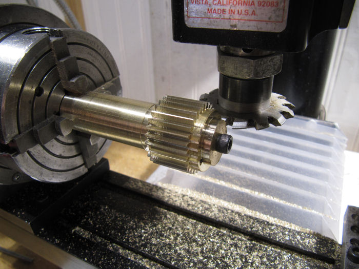

Here is that one set up ready for cutting its teeth:

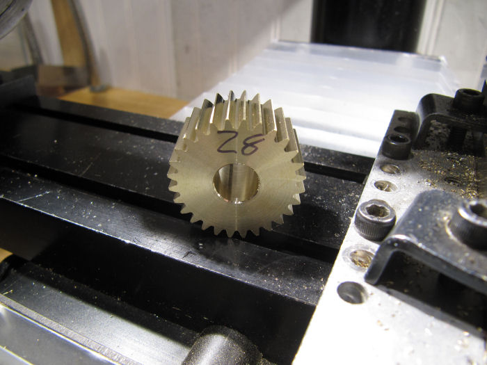

And back and forth and roundy round with the cutter. I have made up the advance lists for the rotary table for all the gears, so as each cut is made another tick mark on the list to keep track of what the next movement is. For this gear, its two full turns plus 28.6 ticks from the previous location. The spreadsheet kept track of all the numbers and rounded them off to a tenth of a tick for me.
One gear down, 17 more to go!
I'll be taking breaks between gears to keep the brain sharp (as sharp as it gets anyway), getting distracted partway through one is not good. Keeping the list of moves and checking off each tooth helps. :cheers:

Definitely  helps to be focused and  follow the same steps in the same order!  I write out the nbr turns and what tick to stop on for each tooth, and check them off after each cut, since I  am using a cranked rotary table, no sector or dividing wheel. Just as accurate, just a different process.
So far four gears are cut, all goid so far!
