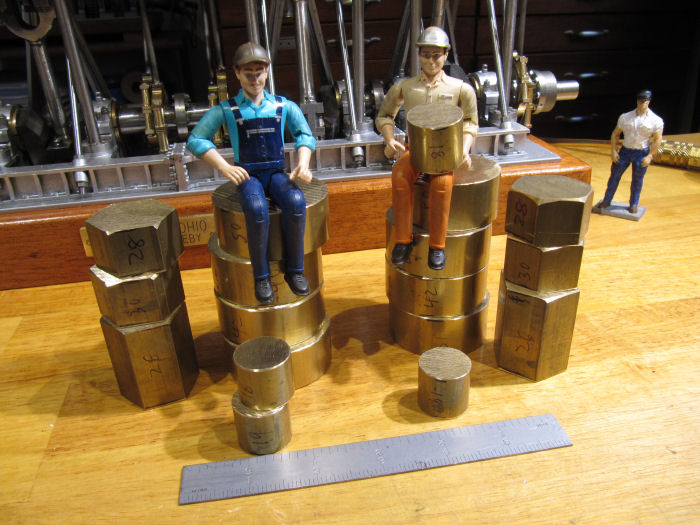

Now that they are back, they have been playing on the bandsaw to cut me out the raw bar stock for the gears. Two sets, since I'll be keeping one model and sending the other up to the museum:
As you can see in the picture, some of the blanks are from hex bar stock - normally I wouldn't buy hex bar, but I got a huge deal on it as an offcut drop bar from the supplier. A quick rounding off on the lathe and they will be perfect for several of the gears.
So, next up will be to trim all of the blanks to length on the lathe, and bore center holes to hold them on an arbor (already made) to turn them mto final diameter before starting the gear cutting. Most of this project is an excercise in gear cutting, which will be done with a vertically mounted rotary table over on the mill with a set of M1 gear cutters. All the gears will fit onto 3/8" diameter shafts. The sliding clutches will be made separately, the moving pieces of those will be on square bar bored to fit over the main shafts. The case will just be a minimal base, enough to hold the shafts and the shifter.
