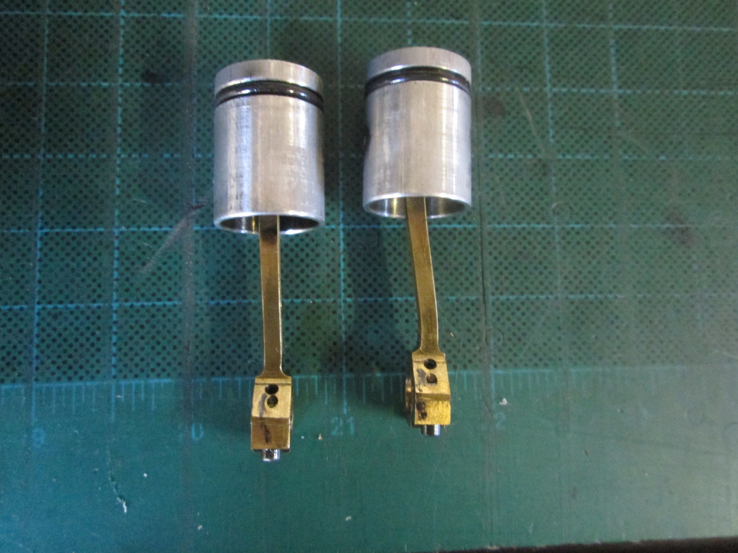

Well, the engine converted itself to a "display only" piece when it broke the crankshaft today just outboard of the 2nd conrod, bending at least the #3 and #4 conrods in the process. I guess a third main bearing would have been a good idea.

Same here.   Most of your unique engine will be undamaged and can live again. So pick up the pieces, analyse the failure. Was it crankshaft whip? Was it a big end bearing failure? Was it a hydraulic lock (fuel or coolant) in one of the cylinders? Did the bigger flywheel contribute due to out of balance loads? Would a smaller flywheel at either end of the crankshaft have helped? Would a centre bearing have helped? What else are the bits telling you?

Here are a couple of pics showing the break. In the close-up you can pretty much see the smooth surface where a crack propagated, ending at the rough surface left where the crank pin just snapped. It's perpendicular to the plane of the throws, suggesting a vertical flexing between TDC and BDC. Even a tiny stress riser would be enough to get the party started. I was careful to leave a small radius at each pin/web junction, the failure appears to have been just about at the inner end of that radius.
The only other damage as a results seem to be these two bent conrods.
