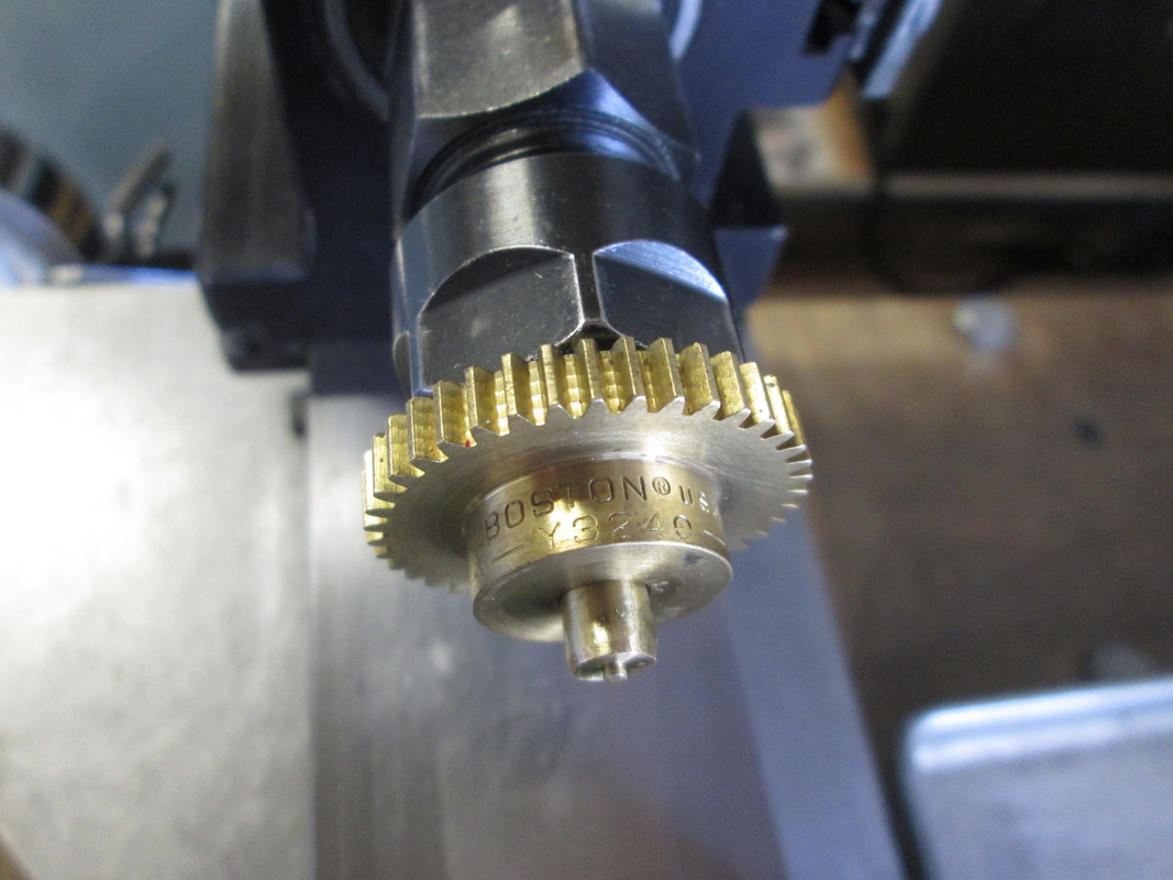

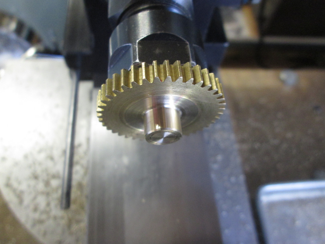

My ebay sourced 40 tooth gear arrived yesterday. The first step was to get it loctited to an arbor rod, then leave it overnight to cure. Part of that rod will also serve as a sleeve, to reduce the bore from 1/4” to 3/16” to match the camshaft. This morning I turned the hub down to 3/8”, then turned the gear around, clamped the hub in a 3/8” collet, parted of the excess rod, and drilled/reamed to 3/16”

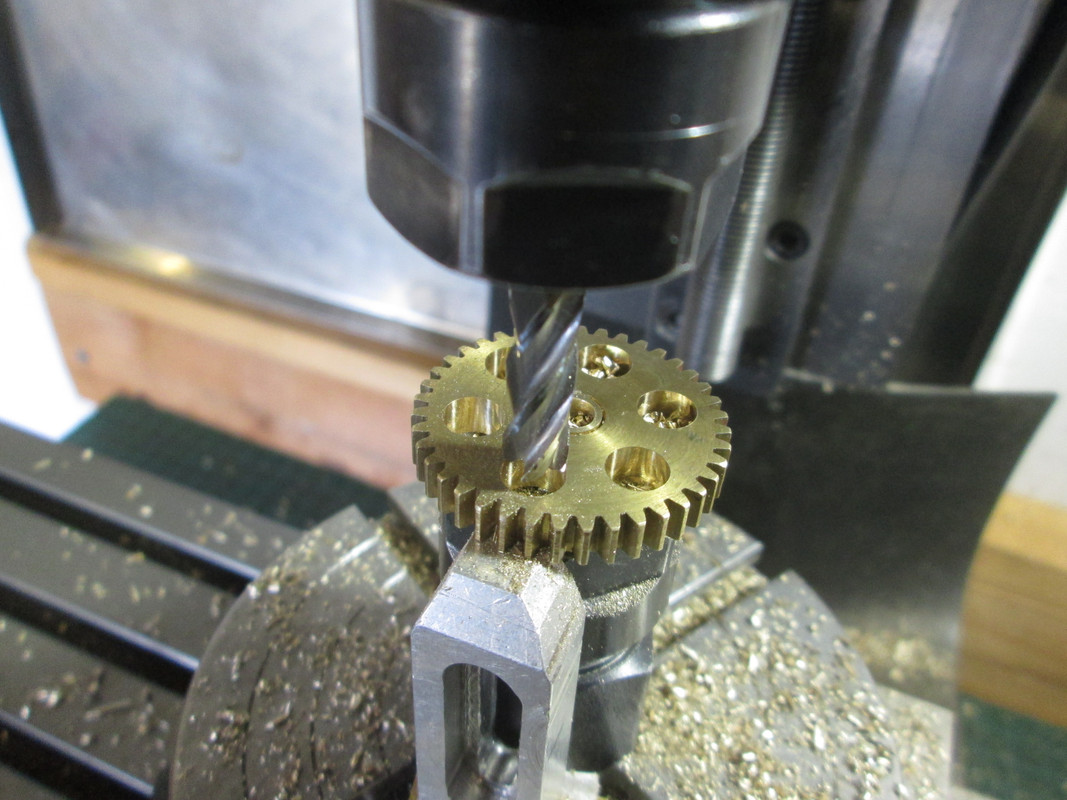

The gear was then moved to the rotary table on the mill, and six 1/4” “lightening” holes were drilled using and end mill. Since I was drilling out near the edge, I used the “support” seen in the photo, just for comfort. I do still have to drill and tap the hub for the set screws. It will go back on the arbor rod for that.

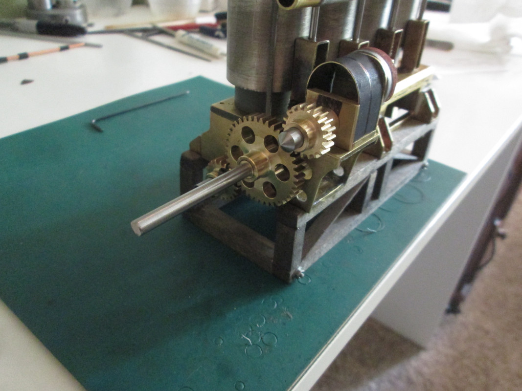

And here's the gear train in place, though not fully fastened. The gears turn and mesh smoothly, so I'm happy!
