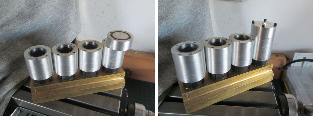

« Reply #29 on: August 07, 2023, 07:14:02 PM »

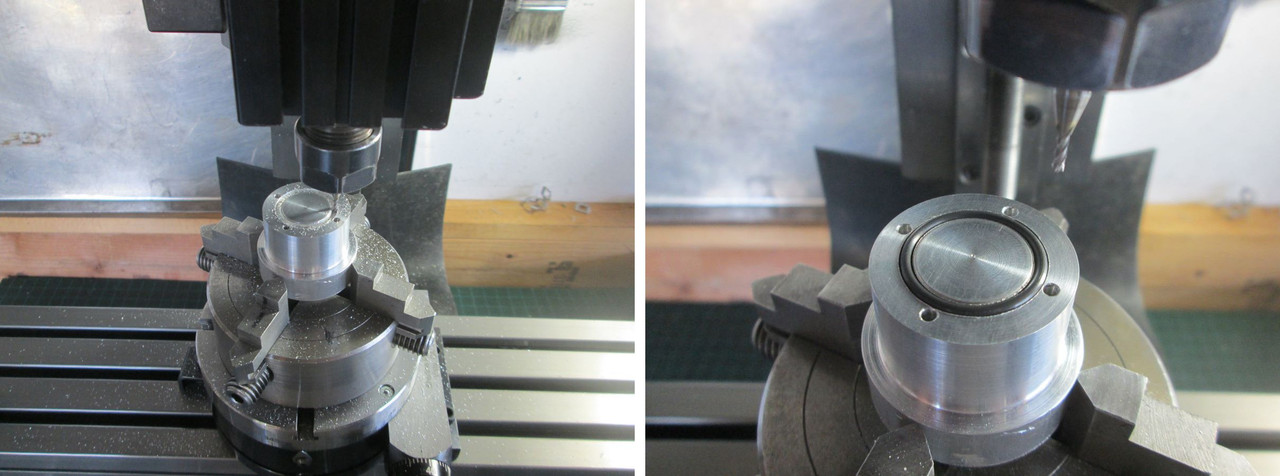

In order to facilitate getting the crankcase drilled for the cylinder/cylinder head fixing studs I made up the drill jig shown on the left below. The lower boss fits snugly into the crankcase openings, while the bore matches the cylinder gauge. Those two tools then work together to ensure the crankcase opening is lined up under the mill spindle. From that point, the drill jig served mostly as a check on my crank counting, though it did also eliminate the need for center drilling. Once drilled, I went back around to tap all those holes 2-56.
I used a similar procedure to drill through the four cylinder jackets and the first of the cylinder head blanks. The head blank was turned to OD first and given a shallow boss to register into the crankcase, so it was transferred to the mill still mounted in the 4Jaw.
I somewhat belatedly decided to treat this engine to an 0-ring for the head to cylinder seal. After drilling that first head blank I sent it back to the lathe thinking to cut the o-ring groove there, but that was chattering too much with the only suitable tool I had handy. So I went back to the mill, and this time mounted it on the rotary table so that the groove could be cut in with an end mill. This was the better plan.
So here is the current state of play. All four cylinders are complete and have their jackets, and a start has been made on the first cylinder head. Next I'll get three more head blanks to this stage. The SHCS are temporary and will be replaced by studs and nuts in due course.
