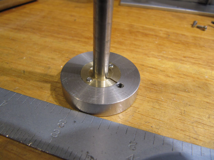

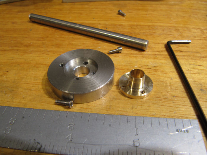

  • Posts: 18381
Re: Another MEM Corliss - Jason's build
« Reply #8 on: February 20, 2024, 03:04:45 AM »
D) Taper lock.
Easy to cut if you have a compound slide to  bore the hub at about 5 degrees. Very strong joint, no wobble, and it can be taken apart. I can post details if you want to try that route.

  • Posts: 18381
« Reply #12 on: February 20, 2024, 02:07:57 PM »
For those interested, I just posted my writeup of the taper locks here:
https://www.modelenginemaker.com/index.php/topic,11770.0.html
It was done originally for Live Steam magazine, but I retain the rights to it per the authors agreement with them, so I am allowed to repost it here without copyright problems.
Just an option - there are many ways to attach the flywheel, as others have said. Here is a picture of a small taper lock that I did for my current build, on a crank disc that is just 1.75" diameter. The big thing I like about taper locks is that it does not mar the shaft, so no problems taking it apart and still getting the shaft through bearings.

Offline Krypto
  • Posts: 121
« Reply #14 on: February 20, 2024, 04:35:15 PM »
The taper lock setup certainly looks much better than a grub screw, imho. Thanks for posting that guide Chris!
