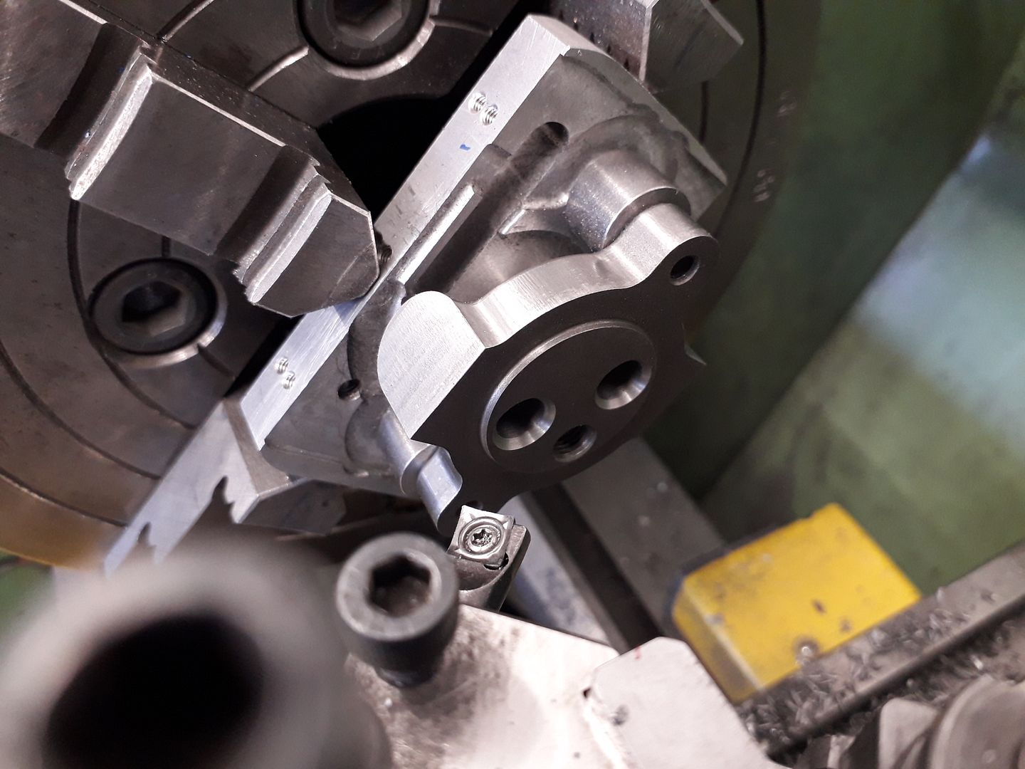

anyway 2019? I think, I bought a partly machined kit from a freind at a swap meet while on holidays in california. it sat in the cupboard for a bit, then last week i did some closer investigation into what was ok and what wasnt.
theres a crank there, the throws are soldered together at the wrong spacings. theres some valves too, theyre tapered and badly finished. no gears. the base has had some machining, mostly close to size, so far usable. the cylinder had neen bored, and sort of faced. its saveable
the flywheels are machined. both roughly the same size etc. usable.
so, I messed around and set the cylinder up on a mandrel nice and accurately, and machined the flats that bolt to the base, id say thats the reference surface , so, that done, ive machined the casting to length and started drilling some holes. at this point the switch on my mill fell apart. ill have it fixed by tuesday hopefully.
tonight I machined the fan shaft. converting to BA as unc bolts are impossibe to get here. tapped the grease cup thread 5/32 x 40 as it seems more workable than 1/8" .

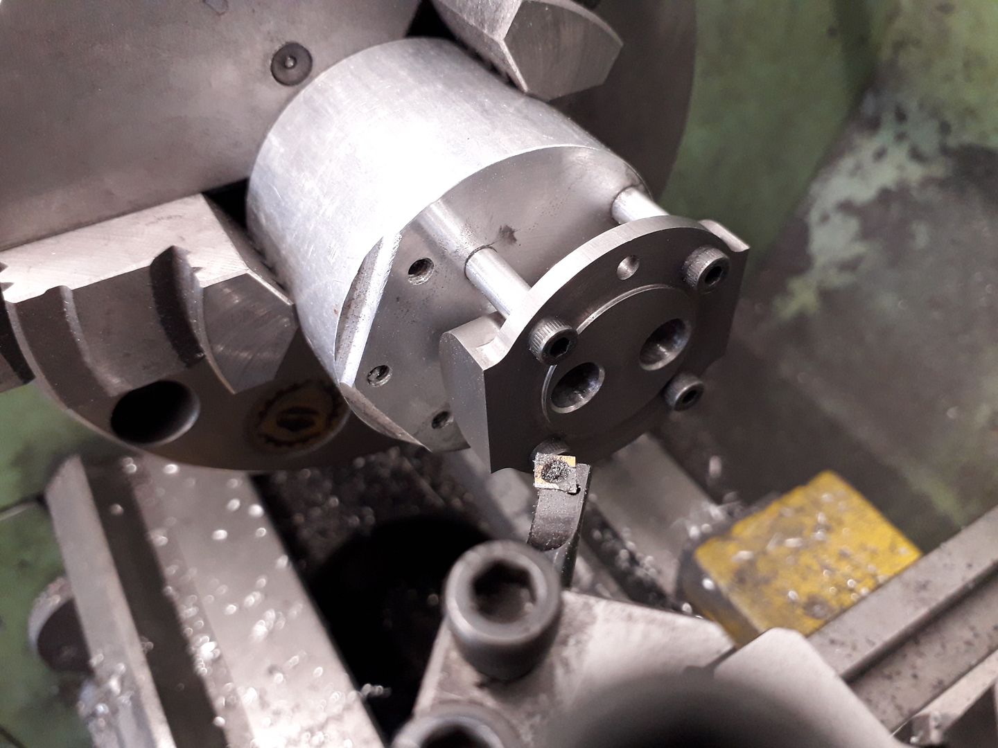

milling machine working again, so some more progress. I guess I need to get the cranshsft in before i bolt the cylinder to the frame, so as to get it somewhere aligned.
the bore has been machined  6 thou under, what the best way to hone that to size?
order of opperations should be, make crank, fit in block, then line up the cylinder to the centre line, I think.  anyway , a quick update for tonight.
