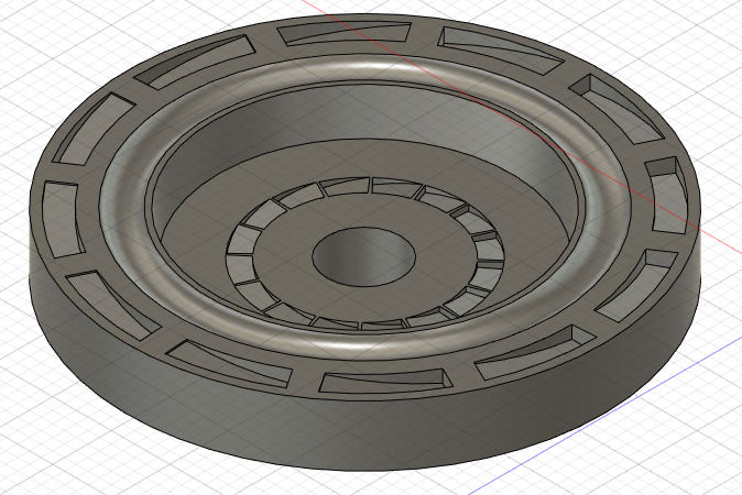

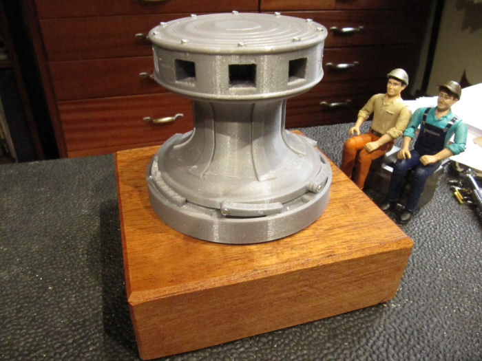

This is a model of a capstan (used to haul ropes for cargo, docking, etc) from plans for the battleship Kearsarge in the National Archives, drawn in 1897. The main parts were all 3D printed, with metal axles and internal pawls. In one direction it is direct drive, the other direction it uses an internal planetary gear set to reduce the speed of the main drum, which gives more power to the drum.
Here is a short video of it in operation - there is a small piece of blue tape on the main drum to make it easier to see the difference in speed when the top is rotated in either direction. Those square holes around the top would have long wooden push bars inserted into them so multiple rows of sailors could line up and walk the capstan around.
<a href="https://www.youtube.com/watch?v=G_chiDV-um0" target="_blank">http://www.youtube.com/watch?v=G_chiDV-um0</a>
Some pictures of the internal mechanism, taken from the 3D CAD model I drew from the original plans. Here is the base, showing the outside ratchet recesses that keep the load on the rope from pulling the capstan around backwards. Near the center is another smaller set of ratchet recesses that keep the internal gear plate from moving in one direction, allowing it to spin the other way.

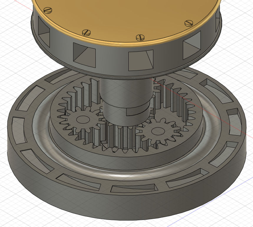

This shows the planetary gears on the inside, they are held by a plate with ratchet blocks that drop down into the recesses in the base.

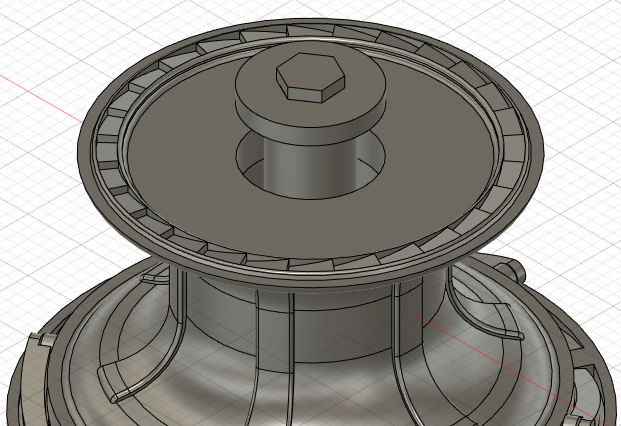

This shows the top of the main drum, with yet another set of ratchets, these go the opposite way, and control the way the top section acts on the drum. In one direction it engages the drum, the other way it free spins, allowing the gears to operate. The center post is fixed to the bottom plate, the drum and top section spin on the post. The top section has a tube sticking down that holds the sun gear in the center, so that gear spins with the top section.
Pretty slick mechanism - the original would have been mostly cast iron, with steel and bronze for axles and bearings. Manually operated rather than with an engine, but I figured people here would still find it interesting, not many realize that some capstans (not all) were two-speed mechanisms. Modern sailboats have miniature versions of these to help pull in the sails, in the 6" to 10" tall range with a crank handle that fits into the top. Inside they are basically the same as this, interesting that they date back to the 1800s. Fun little side project, the 3D printer did all the hard work, I just had to make the few metal parts for the axles and internal pawl blocks (a pawl is the moving part of a ratchet that makes the clicking sounds).
