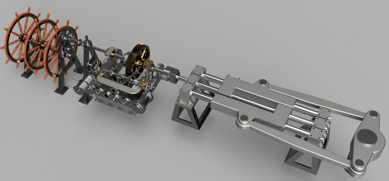

I've got the CAD design/plans from the USS Kearsarge steering engine I could send you, its a larger (much) version than the one I built from the German river boat last year:

Many thanks for the offer Crueby but I think that is beyond my skill level.
