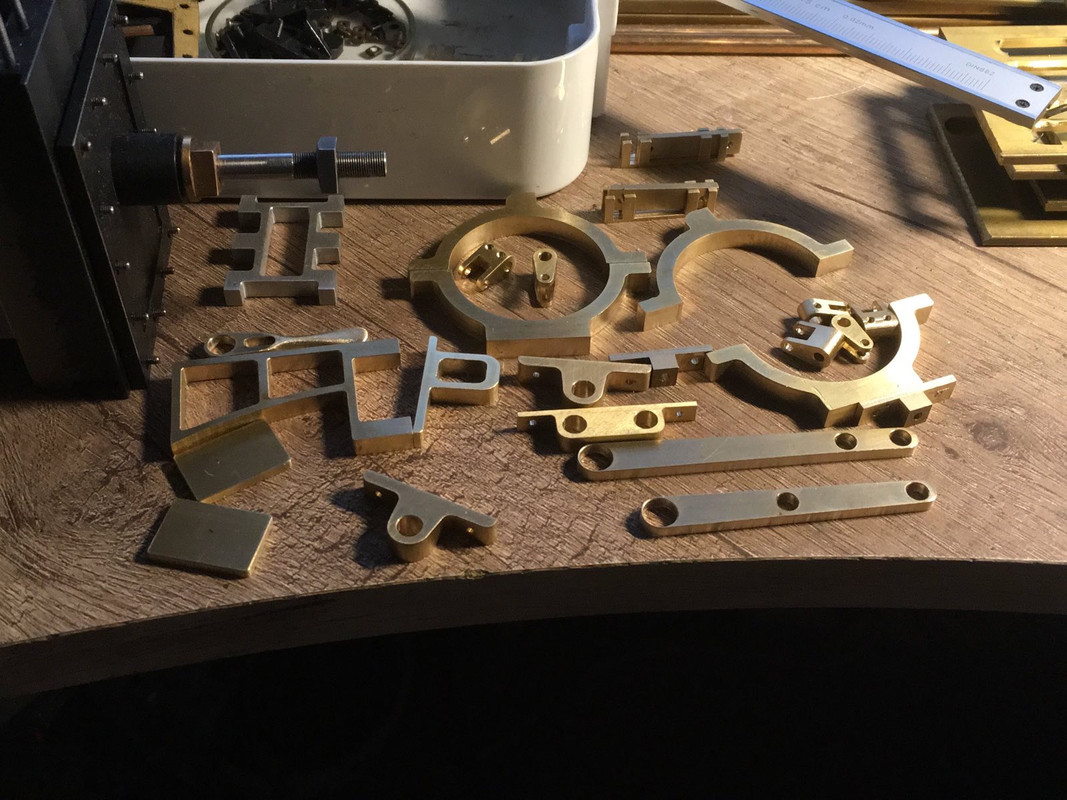

« Reply #12 on: October 18, 2023, 07:11:44 PM »
Offline rarach22
  • Posts: 392
Re: Greene steam engine
« Reply #13 on: November 01, 2023, 12:45:31 PM »
Ufff…..
