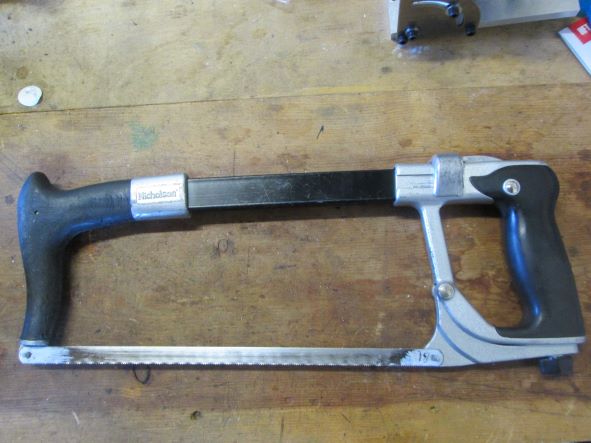

« Reply #12 on: February 07, 2023, 12:05:09 AM »
This Nicholson has served me well for many years. No provision for rotating the blade though. I rarely need that, but keep an old cheapy Craftsman around for when I do.
