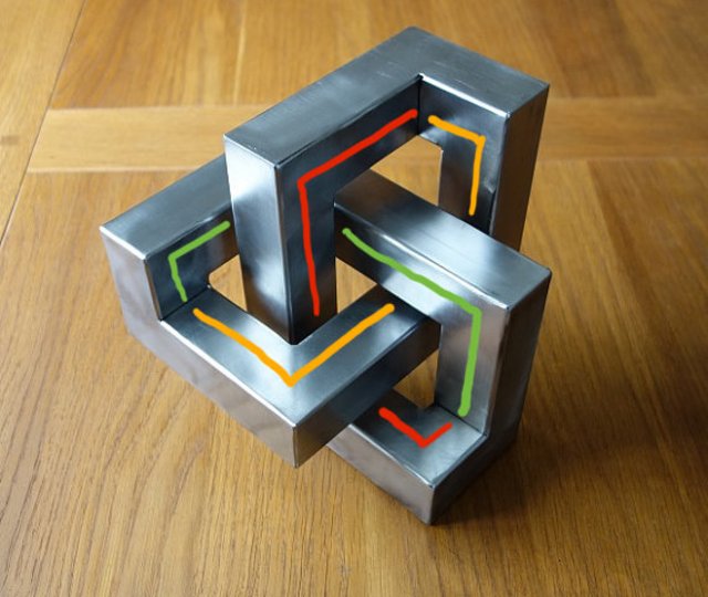

I bit the bullet and have drawn up what I intend to make and will use some timber that I have lying about. It an Australian hardwood, SPOTTED GUM, mainly used for polished floor boarding but it does machine and polish up very nicely. (I have made some gear stick knobs for Jaguars out of it - but that is another story).
I will machine the pieces to 18mm x 18mm square in the 3 different lengths. Getting the 45 deg angles will need to be done very carefully as I would like the joints to be free of any gaps.
The overall size of the cube will be 130mm x 130mm x 130mm.  I have attached the drawings via a PDF file so unsure if that will publish. If not I will scan and attach.

« Reply #1 on: January 28, 2023, 06:12:41 AM »
I have scanned my drawings and attached to see if that is better.

In your first diagram you show shapes C,J,M,R (94 mm long) and F,P (58 mm long) as angled on one end but seemingly square on the other end.  When I look at the second diagram it appears they are angled on both ends, but these angles are cut on orthogonal faces.
Is this correct?
Is this correct?
Quite correct, I missed a line of 'F" and "P" and also 'C' 'J' 'M' 'R' on the cutting list
The angled cuts are on different faces.

Revision 1 for the cutting list. I have drawn the shape to better show the cut on different faces.

Hi , On the isometric drawing it would be interesting to see all the hidden lines on the back faces of the square timbers , shown dotted to see where they actually go/end up ??
