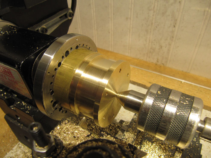

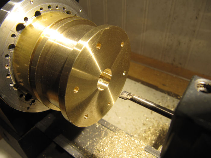

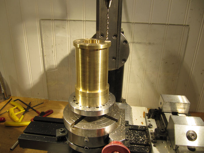

So, yesterday the outside of the cylinder was shaped. Today the cylinder was bored out to 1.25". Drilled first to 3/8", then used boring bars to take it out to final size. The smaller boring bars needed at first chattered a bit when extended out all the way to reach the bottom of the bar, but the final 1/2" diameter bar was smooth as silk. Some wheel weights were stuck on the side where it had been flattened to balance it out enough to run at normal speeds.

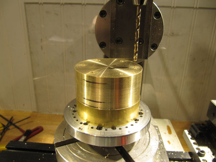

Then over to the mill to drill the bottom gland mount holes
That was the last operation where the cylinder needed to be on the faceplate, so it was swapped over to hold the bottom gland piece. That was drilled to match the holes in the cylinder while the rotary table was all set up in the right place.
Back over to the lathe to turn the outside - I wanted to take the sides in the same diameter as on the cylinder so the flat side will come out the same width as on the cylinder. The center of this piece needs to be taken down smaller to allow room for the mounting nuts/studs, but I wanted to keep the flat side wider to look more like the original castings do. So, that work will be done on the mill.
First though, drilled/bored out the center to 1/2" for the piston rod. The rod has flat sides, but the hole here is round - the gland cap will have the flattened sides only, which will be some careful milling later.
This face is the one that goes against the cylinder. The other side will be counterbored out larger for the packing gland, that will be done after parting it off from the bar.

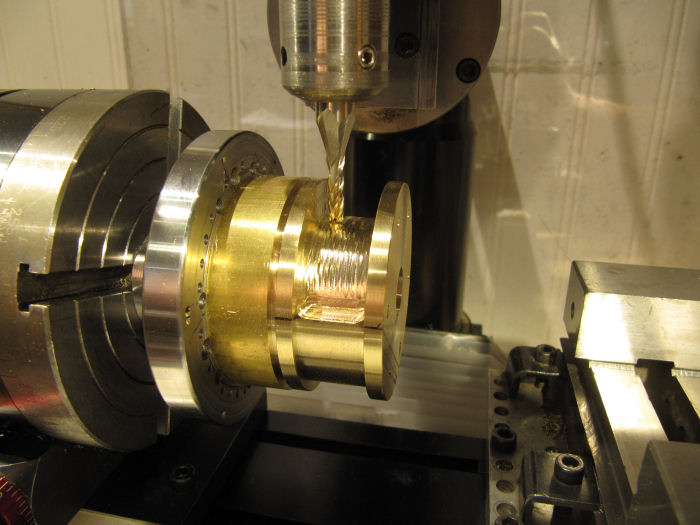

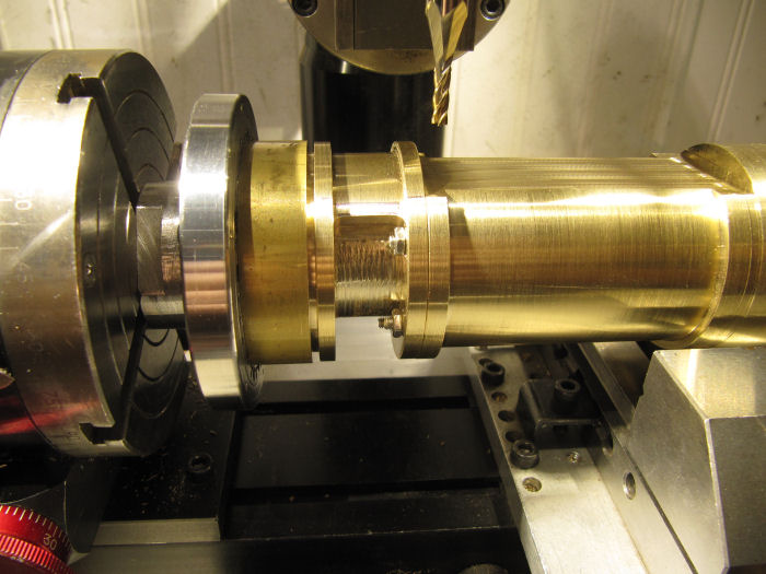

While still on the faceplate, moved over to the vertical rotary table to mill the center section of the sides down to size, leaving the flat side.
To get the flat lined up properly with the one on the cylinder, I bolted the cylinder in place. Next time I'll take the time to line up the flat on the cylinder level with the mill table by rotating the assembly on the rotary table, then mill off the flat on the base piece.
So far so good!
