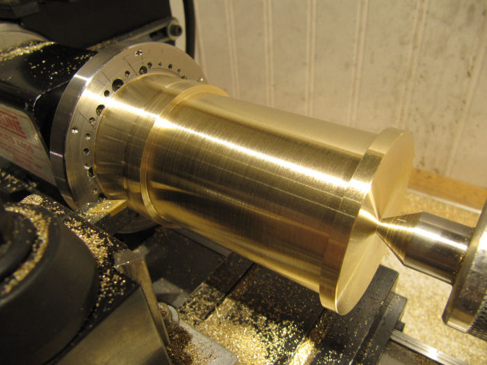

Hi all,
This is a project I've wanted to do for a really long time, one of the Stuart Turner steam hammers. I remember seeing them in the ST catalog (remember catalogs?) back when I was just getting into machining, but never built one. A year or so ago I found out the ST sells the plans sheets separately from the kits, so I picked up the one for their steam hammer. The price for the kit seemed too high, since I can make just about everything from bar stock, but the main curved column would take a lot of time/material to make, so I ordered just one of those from their replacement parts list, and I'll make the rest myself. The current owners of ST said they didn't have any in stock, and hadn't cast any of that kit since taking over, they are currently updating the pattern to work with their new process (don't know what that is, just repeating what they said) and they should have it cast around the end of the month. They have been very responsive to emails, hoping that is a good sign.
 In the meantime, the shop elves have been studying the plans and plotting out how to make things. Hope I can read their handwritten notes, their writing is really small!
The cylinder will be first, I did a little doodling in Fusion to sketch out how to make it from bar stock, and given the size of bar I have on hand it will likely turn out to be a slightly larger bore than the original but the same general shape. The one change I am going to make is to make the valve be a D-type slide valve rather than the spool valve, I like the D valves a lot better, much easier to get a good seal.[/font][/size]
So, on with the build! Started by cutting a couple lengths of some 2-1/4" brass bar, for the cylinder and the stuffing box below it. A flat plate will be attached to the side of each to form the mounting flanges. Started out with them drilled/tapped on one end to mount on a faceplate, and turned the outside of the cylinder.
Then moved the cylinder, still on the faceplate, over to the mill to cut the flat down the side:
