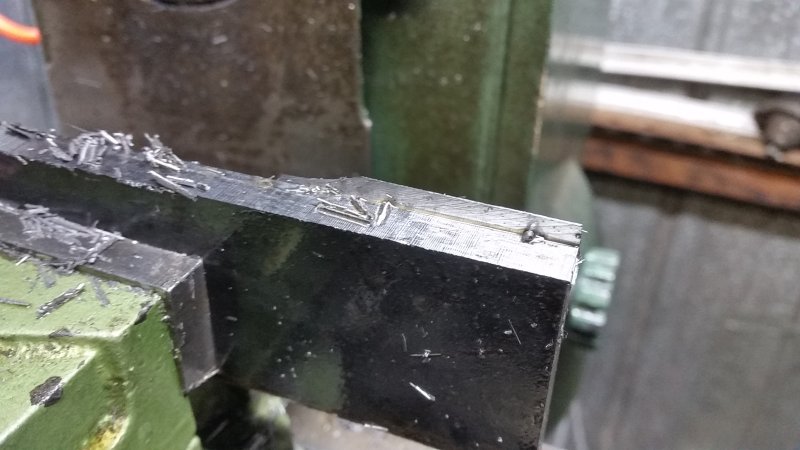

I did some testing with the NOS 3 1/2 inch 7/16 wide cutter on some 10mm flatbar. Speed was estimated to be 98 RPM, and I went for 1mm DOC. The cutter was as close to the spindle as possible.
I once again got some bad chatter and producing metal needles. I have read this can happen because the feed rate is too low i.e. the teeth are rubbing instead of cutting.
Tried reducing to 0.5mm DOC and still no good.
Tried reducing the RPM to 74 RPM and the chatter was replaced with sort of squeal, but now the cutter was producing curled chips. The test flat bar had an increasing DOC due to previous milling attempts but the cutter was "happily" going through until it reached a max DOC of 4.5MM. At least I know it was the cutters and not the rigidity of the machine.

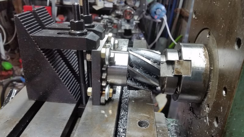

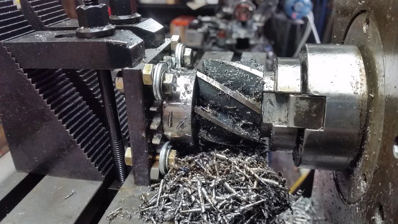

I have a picture where I was using a 2 inch shell mill to chomp through 1.5 inches of mild steel at 7mm, I believe this was utilising the full power of the machine.
The Shell mill cut absolutely wonderfully but most of the horizontal side milling cutters are straight tooth and I suppose are harder for the machine to drive
