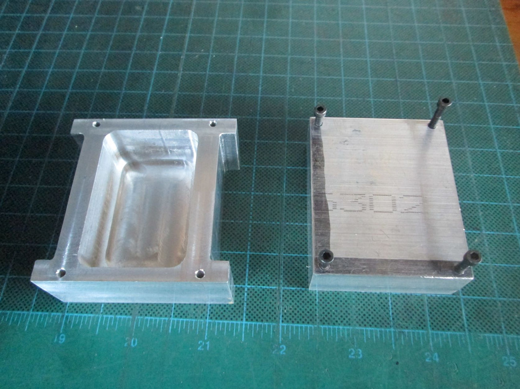

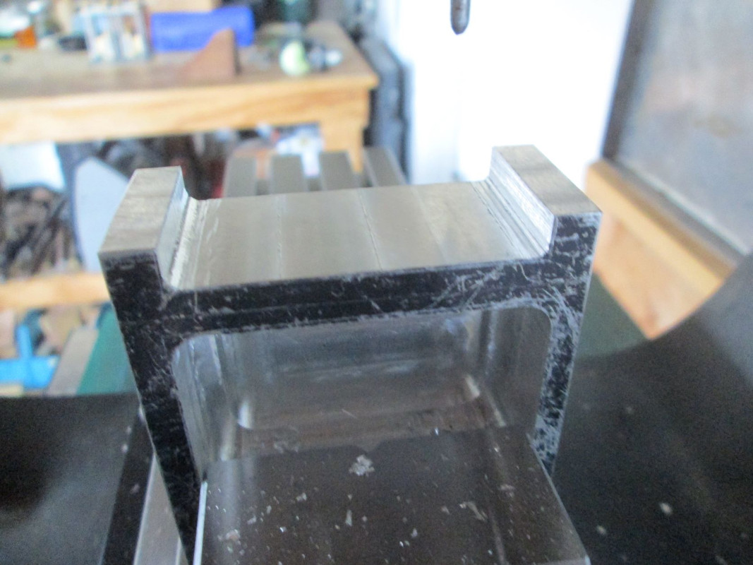

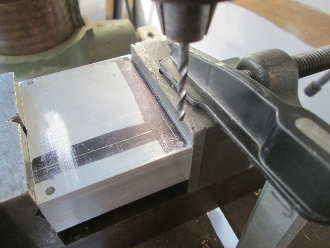

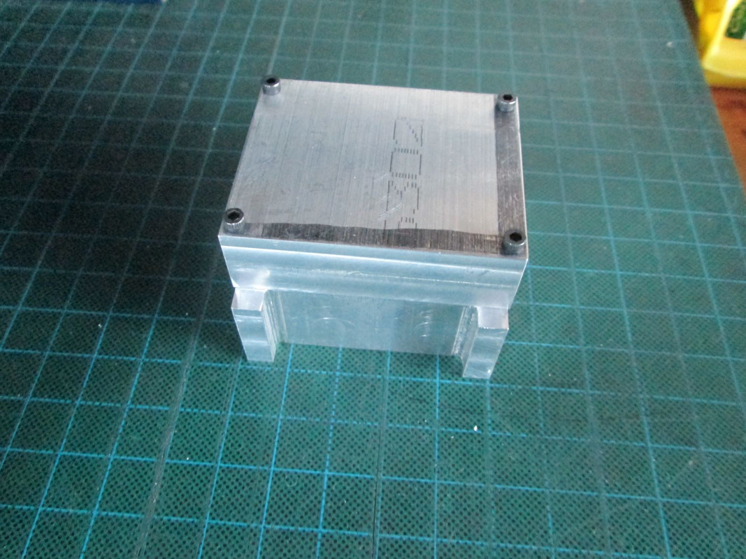

A few more build photos before pausing for our Thanksgiving Day here in the U.S.

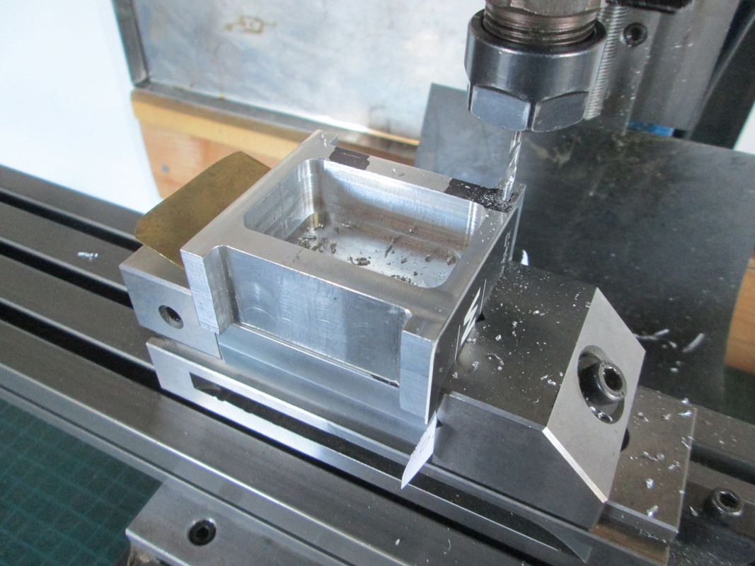

With the center of the oil pan/lower crankcase roughly scooped out, I then removed material between what will become the “legs”. I finished with a small router bit to leave a radius on the inside corners, a trick I've used before, and that I learned from one of Jo's posts.

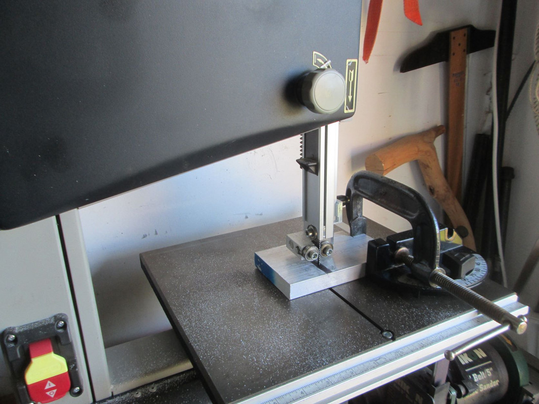

Then I turned my attention to the upper crankcase. My little wood cutting bandsaw was used to cut a blank of a piece of 3/4” thick aluminum.

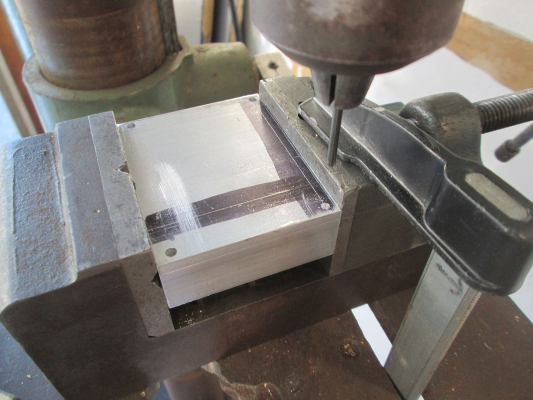

After squaring that up and bringing it close to the final outside dimensions, I clamped both it and the oil pan in the mill vise to drill for the 4-40 fixing screws, drilling through the pan and into the upper crankcase with the tap drill. A piece of paper, a bit of old credit card, and some thin brass were enough to shim out the dimensional differences between the two parts.
I went over to the drill press to clearance drill the holes through the upper crankcase. I used the shank of the tap drill to get lined up, clamped the vise to the table, then switched to the clearance drill and poked it through.
With the holes in the pan tapped, the two parts can now be fastened together for machining to the final outside dimensions, as well as later for drilling/boring for the crank bearings.

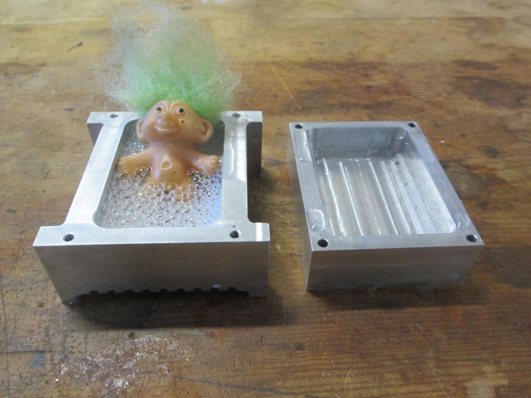

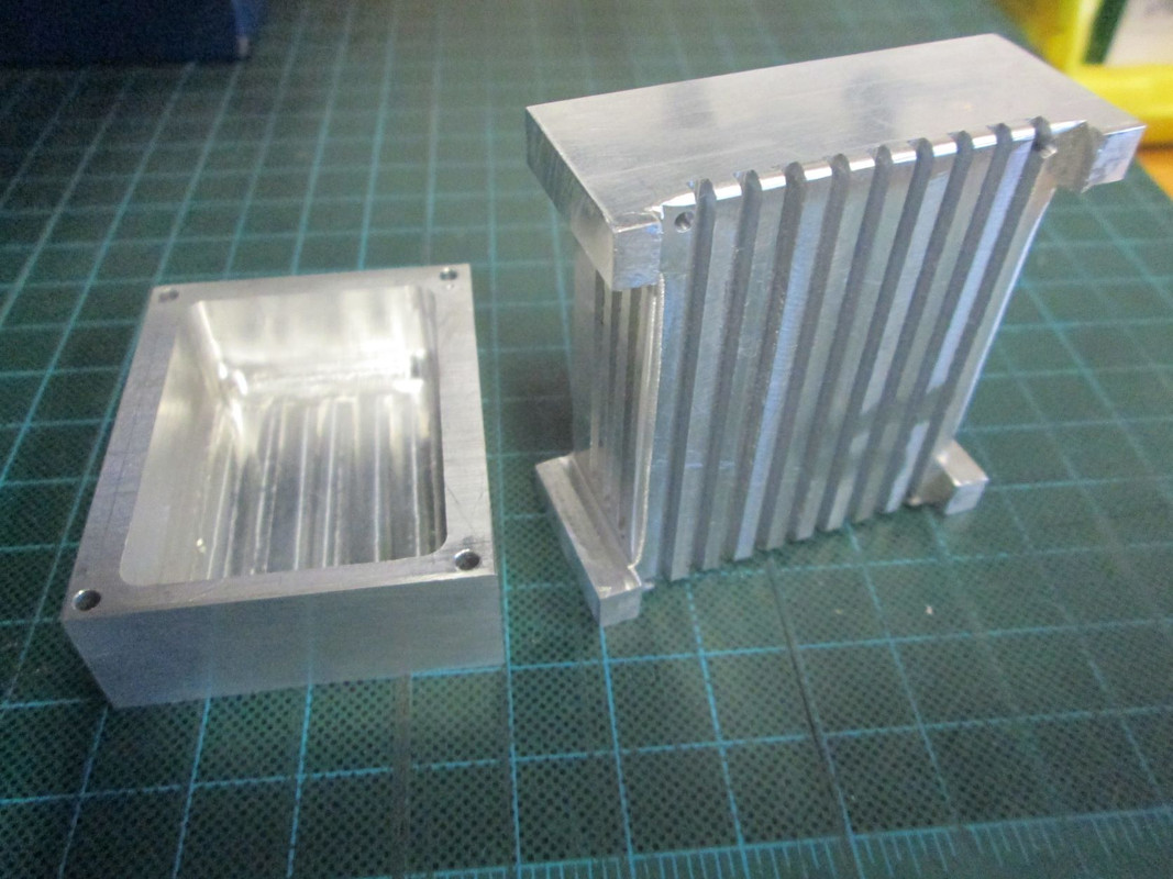

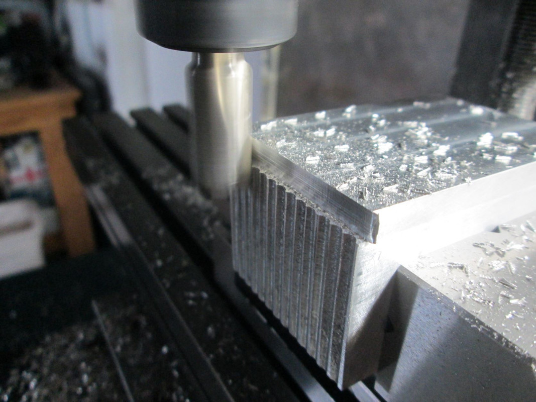

With the holiday over, I've gone back to working on the two crankcase halves. Both are finished to outside dimensions, insides dimensions are close enough for the time being, and I got the (mostly cosmetic) fins cut into the lower part. Alfa oil pans do have fins on the bottom, and sometimes the sides as well, and anyway fins always add visual interest.
However, I have discovered that the local Troll thinks I've made a couple of bath tubs for his personal use. He likes to alternate between a hot and a cold bath, but being a Troll, he complains that the hot is not hot enough and the cold is not cold enough, while also proclaiming loudly that the Laws of Thermodynamics are just a hoax.

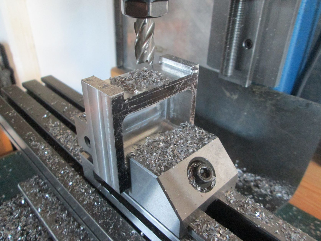

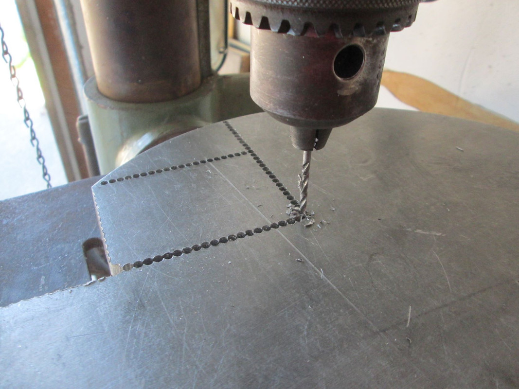

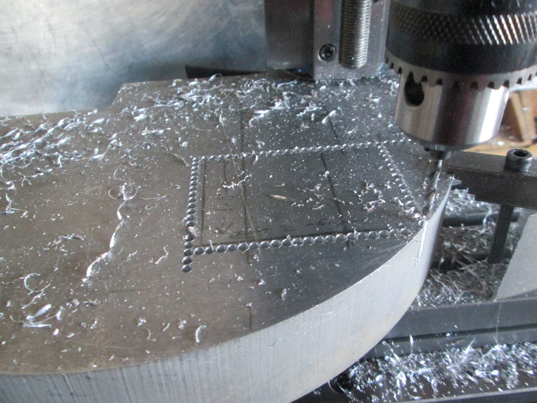

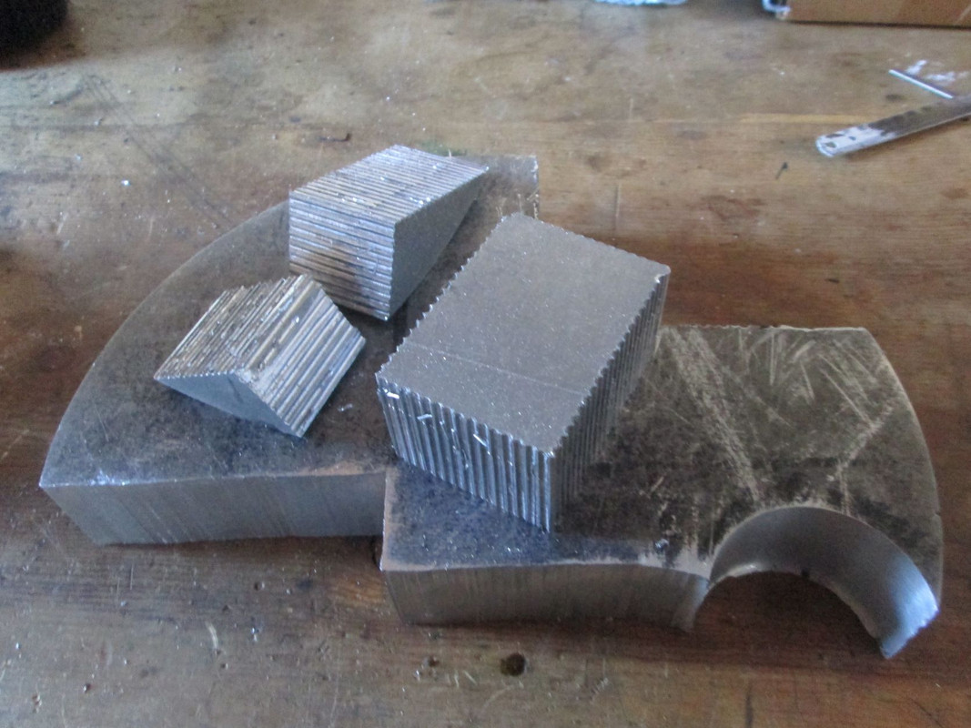

Next I want to start work on the cylinder block. The blank is essentially just a simple rectangle, but would need to be cut out of a much larger hunk of 1 1/2” thick aluminum. The blank for the cylinder head will also come out of this stock. My little bandsaw can cut aluminum, and has been quite a champ about some of the stuff thrown at it, but this would really be asking too much. So instead I decided to go the chain drilling route.
I first set it up on the mill, so I could get a good set of starter holes that were evenly spaced, straight, and parallel. Using a stubby #35 drill, I poked a set of approx. 1/2” deep holes around the outline and out to the edges so I could get in later with either the bandsaw or a hacksaw. This was more than a little tedious, but worked fine.
Then I went over to the drill press to extend those holes the rest of the way through. This was more of a problem than I anticipated, because of the habit of aluminum to load up the bit and grab in deep holes. At first I pecked, withdrew, stopped the spindle, and cleaned off the chips. This was ridiculously slow, so I tried being more aggressive and quickly broke a bit. Eventually though I found the mojo and things started moving along, still tedious, still slow, but not AS slow. I found the right “pecking” rhythm, and also found that I could use a gloved finger to clear the chips from the bit without stopping the spindle (most of the time). Eventually I got the lines completely drilled.
The bandsaw was happy to deal with this job, just cutting through the thin webs between holes, and I was left with a jaggedy but nearly square cornered rectangle, although well oversize (I wasn't taking any chances on being under!).
Back on the mill, I used a 1/2” end mill to finish each face and bring it to the proper dimensions. Still a bit more of that to do. In this last photo I'm side milling the end of the block to get a good squared off surface to stand it up on later.

One trick I forgot to mention is that for the final deep drilling, I used a drill bit one or two # sizes smaller than the starter holes. That little bit of clearance around the upper end of the bit helped a lot to reduce (but not eliminate) the tendency to pack the hole full of chips and bind up.
