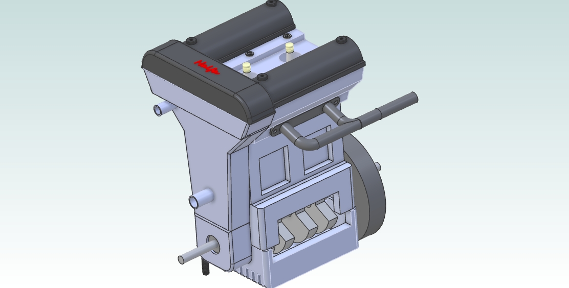

Anyway, I started by drawing up a twin version, with 0.75” bore and 0.88” stroke, and perhaps an open crankcase as I had done with the 2-Bits. This I call the Halfa.

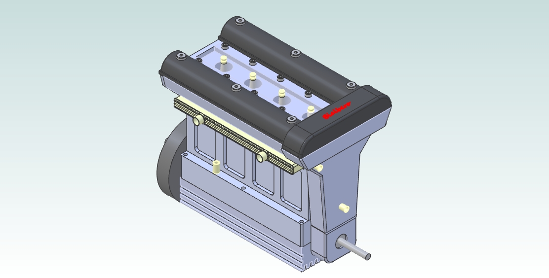

With that looking good, I decided to see about stretching it to 4 cylinders. That ended up with a block length of about 5 inches, which I wasn't sure wouldn't be just a bit too long for my Taig lathe if I wanted to use a between centers boring bar to line bore the main bearings. Not being at home to check, I decided to shorten it by reducing the bore slightly, which allowed closing up the bore spacing a little. This left me with a bore and stoke of 0.625” x 0.74”. This engine I call the Bialbero.
Now I figured it would make sense if the two variants shared most of their parts and key dimensions. So I redrew the first version of the Halfa by cutting the Bialbero design in half, keeping the smaller bore and stoke, etc. The only change was to relax the bore spacing just a tad. This is technically Halfa-v2, but as it is now the primary twin version , I just refer to it as the Halfa, and this is the version I'm going to start building.

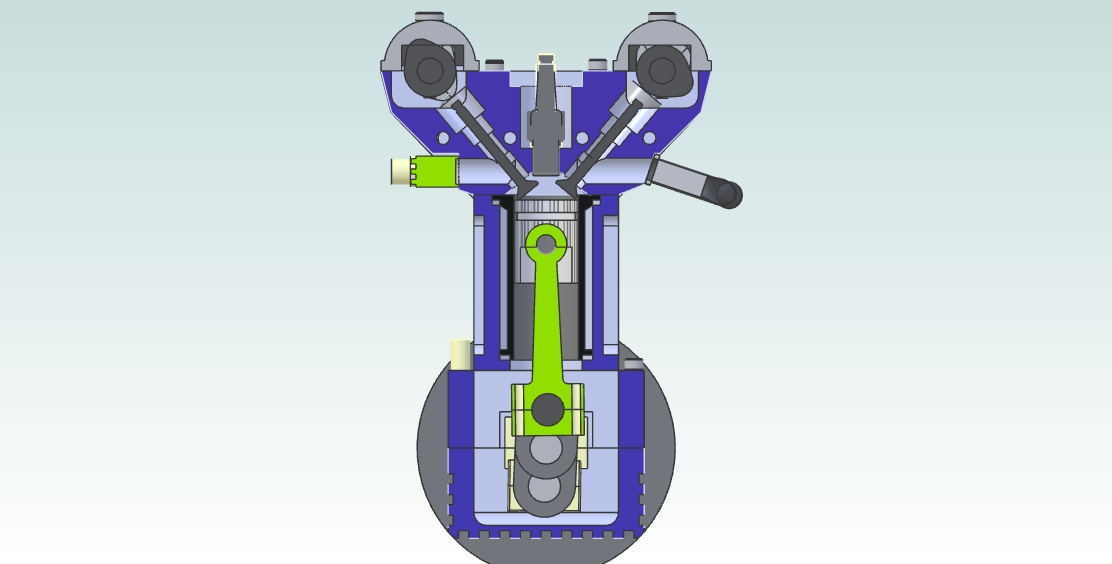

Here's a cross-section image of my engine. In the center you can see the conrod/pistion assembly within the cylinder. The dark black outline is the cylinder liner wall. The blue areas are the block. The grey between the block and the central region of the liner is the water jacket. Water will entirely surround the liners. The small grey squares just below the upper and lower flanges are not water spaces but will take o-rings (not shown) to provide a seal between the liner and the block. The cylinder head will compress the liners down onto the o-rings.

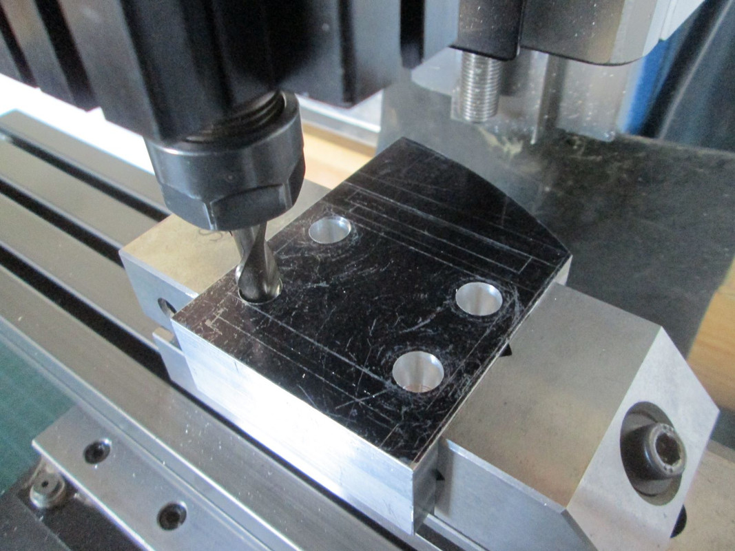

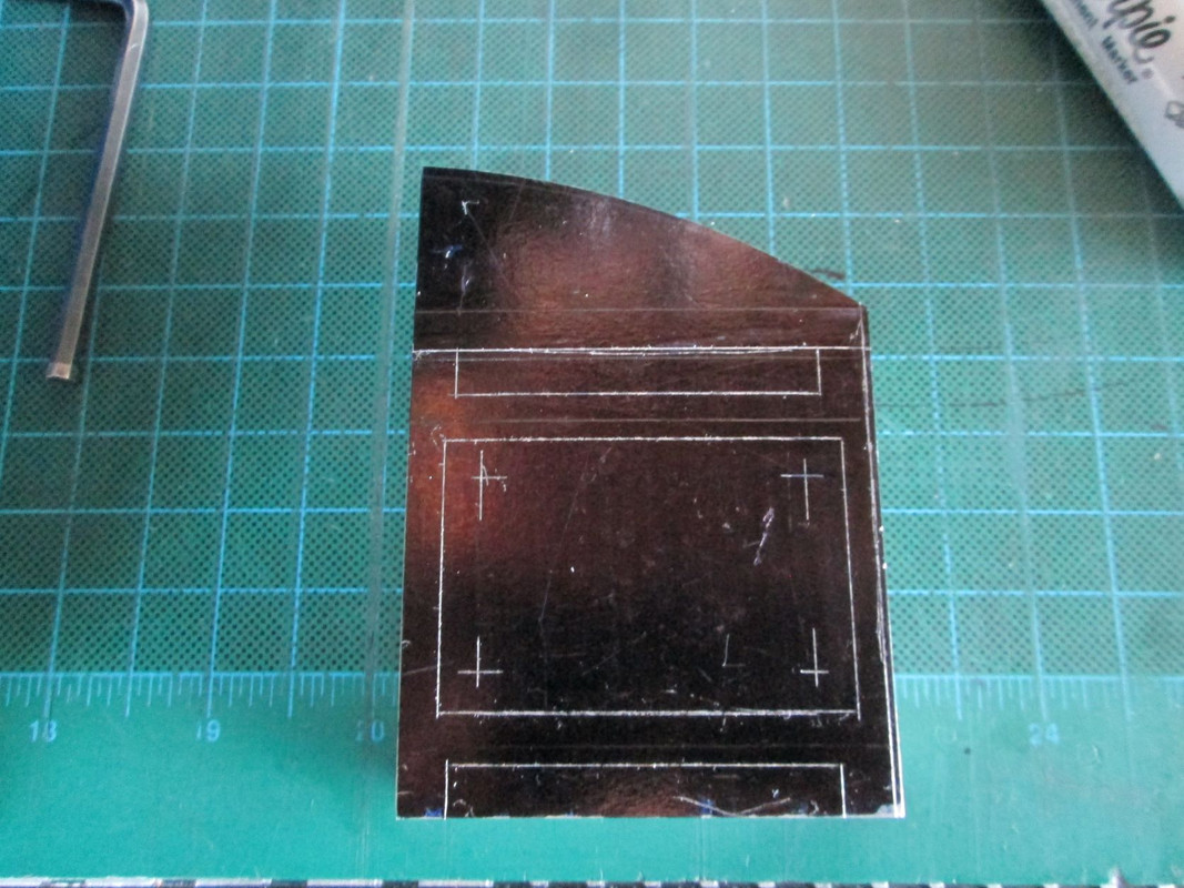

When I got home from the recent travels, I still wasn't sure whether I should start building the 2 or the 4 cylinder version. Arguments could be made either way. But when I went out to the shop, I soon realized that I had a block of Aluminum that I had set aside for yet another potential project that was just the right size to get the oil pan (which also serves as the lower crankcase) for the 2 cylinder Halfa out of. That was enough to push the decision that way and get to work.
I started by getting the perimeter outline and the outline of the inner cavity marked out with guide lines.
Then I set it up in the mill vise and drilled the corners of the cavity with a short 3/8” drill. Then I chewed out the bulk of the cavity with a 3/8” endmill, staying about 0.020” from the edges and about 0.050” above the final depth. This is so I can go back in later with a smaller ball nose end mill (which I don't have yet) to leave all the corners with a nice fillet. The pics are all post clean-up, but that little carving session generated a lot swarf! Took a lot of crank cranking too. One good argument in favor of the little guy; twice as much of both for the bigger one.

Regarding the Halfa engine cross section; how are you proposing to adjust the cam/ valve gap? That adjustment can be a problem with overhead cam engines, more so with models as there is so little room.
Are those four drillings in the cylinder heat part of the cooling system?
  • Posts: 1703
Re: Halfa, a DOHC inline Twin
« Reply #10 on: November 21, 2022, 09:12:36 PM »
Hi Mike, Thanks for the feedback.
That's somewhat TBD. One thought is to machine the bucket tappets to fit, and count on never have to adjust for wear. Another is to use small shims, as done with the real Alfas. Any suggestions are welcome.
Are those four drillings in the cylinder head part of the cooling system?
Yes, that's right, and they are connected by crosswise runners at each end. Water is fed to the rear left corner from a passage leading up from the block, makes its way across the runner and through the four lengthwise passages to the crosswise runner at the front, where it exits to the radiator at the opposite corner. (or it may be better to run the flow the opposite direction?) They will all be drilled, with most of the ends either blind, plugged or otherwise covered and sealed. The passages are small and few, but I ran them as near to the combustion chambers and exhaust valves as I could. Hopefully they will provide more than just an illusion of cooling to the head.

Hello Ron,
Bucket tappets are as good a way as any in a model,  forget shims. Make a handful of bucket tappets and select a size to fit. It does mean lots of camshaft removal/ refitting, but you get that with a full size engine anyway.
Head cooling is never as big an issue with a model compared to full size.
The aluminium head is a good heat conductor so you don't need the water passages close to the combustion chamber.  Bigger drilling further away may give better cooling
« Last Edit: November 21, 2022, 09:29:11 PM by Vixen »
  • Posts: 1703
« Reply #12 on: November 22, 2022, 12:37:59 AM »
Thank you for the tips and suggestions, Mike. Very helpful indeed.  :cheers:
I suspected that what you say about head cooling at model size and usage might be the case, but it's good to get that suspicion confirmed by someone more experienced. I'll take a look at moving those passages up higher where they can be made larger, but the crosswise passages in particular may run into something else. It gets a little crowded inside that head.
