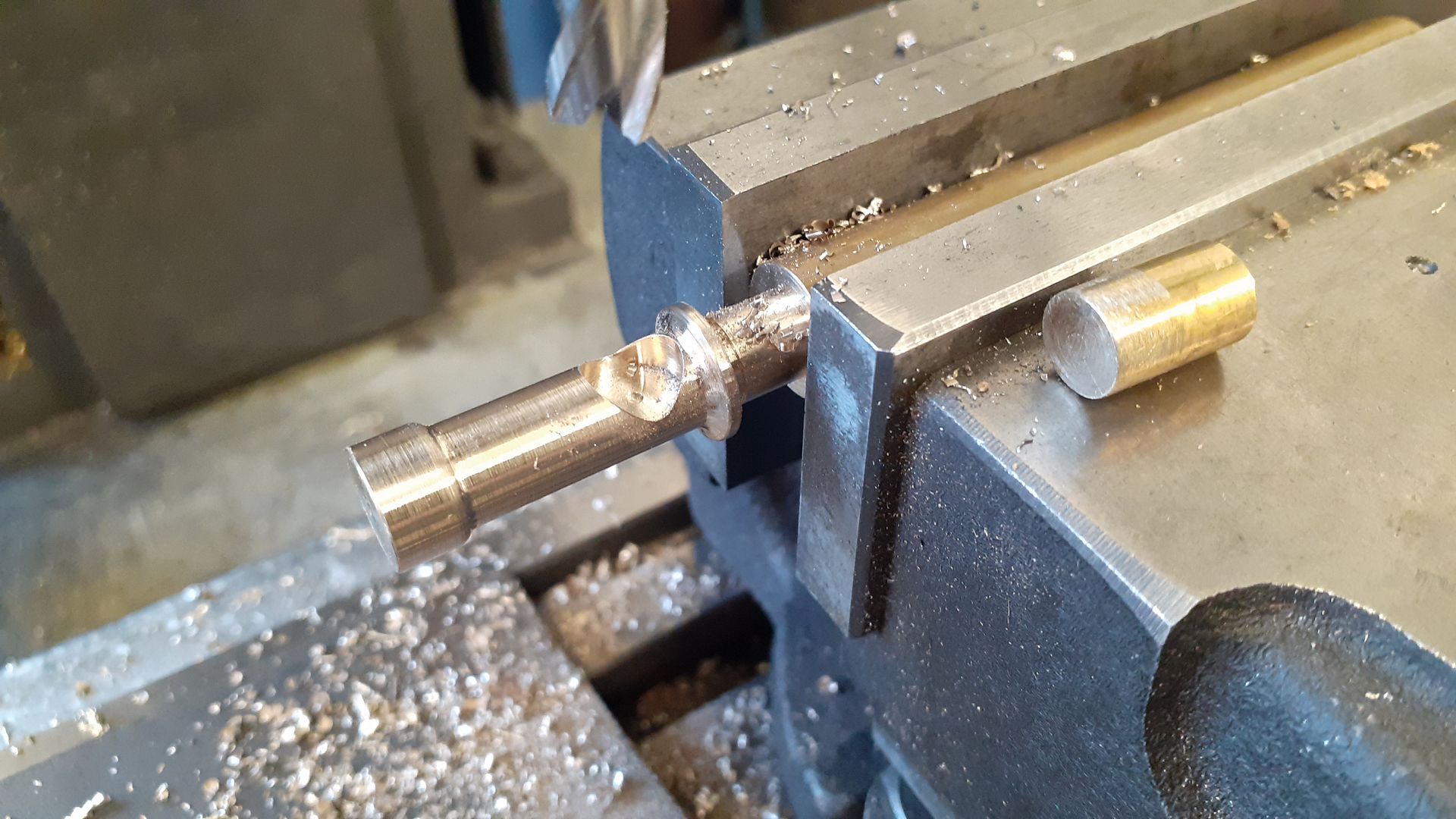

I started the cross head by turning the two smaller diameter lengths either side of the larger diameter central section then moved over to the spin indexer to add an 8mm counterbore and 5mm through hole.
After silver soldering in a piece 8mm diameter brass that had the end reduced to 5mm into those holes it was back into the lathe to drill and ream 6mm for the slipper. With that done it was back to the indexer to tap the larger boss M5 x 0.5 for the pump ram and the smaller one was tapped M3 x 0.5 for the valve rod. The last job before parting off from the parent bar was to mill as slot to clear the crank pin.
The pump body was constructed in much the same way - Turn the outside, add some locating pockets, solder in some stubs and then finally machine.
The last bit of machining I have a photo of is the cross head slipper that was turned to a sliding fit in the yoke's 6mm bore and then cross drilled and reamed for the 4mm crank pin.
With all the bits roughly assembled I set the eccentric by eye  and gave it a try, after increasing the pressure a bit it was running but not as smoothly as I would have likes but good enough to strip down and then sort out the bugs on final assembly. I actually found one of them as I took it apart, on setting the eccentric I had got it a bit tight to the bearing and this was causing some drag. These are all the bits.
I put it back together carefully checking for smooth rotation as each piece was added and found that the end of the crank pin was just touching the outer edge of the hole in the yoke which was putting sideways load onto the piston rod and pump plunger. With a little machined off the offending pin all went together well and on trying it on air again I could now run at less than 5psi and get down to a nice slow tick over.
